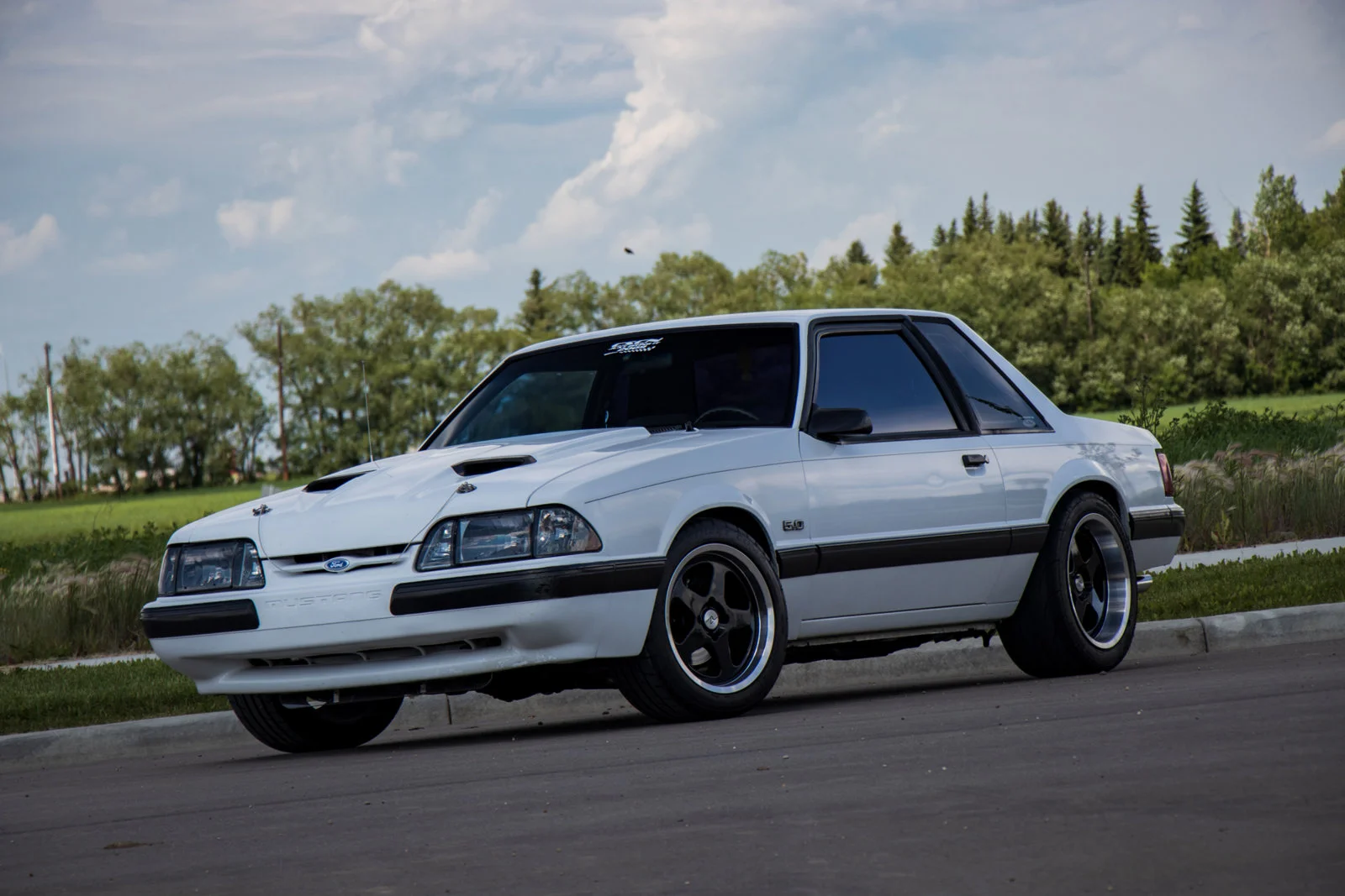

This is something I need. Not want... need! Haha! Did you have to buy an install kit? How much did this cost altogether? Crossmember? I’m assuming you went with the 8031 bell... I can’t believe you have to buy the bell housing for close to $800 AFTER buying that transmission. Clutch fork?... I am hearing 94-95 clutch fork. Which gearset did you choose? What is your differential gear ratio? First gear in my 3550 is a blip and then it’s done I think I want a taller first. Also top gear for the 3550 is probably close to the .63 stock but I do use top gear. I will attach my top gear pull video. I need the .80 fifth gear that the magnum has. As you can see I really want and need a magnum t56. Very happy for you. Maybe a pic of your ride?.. or install pics?

It isn't cheap. I'm in Canada so in CAD it cost me $7500 for everything. Only thing my kit didn't come with was a shorter driveshaft so I had to measure once the trans was in and then take my driveshaft to get shortened. Yes SN95 clutch fork which I had to modify because of my longtube headers. I opted for the close ratio version so 1st gear is taller. I'm running 3.73's out back. Stifflers trans crossmember. QuickTime SFI bell, not sure the number. Did a McLeod RST dual disc clutch and love it.
