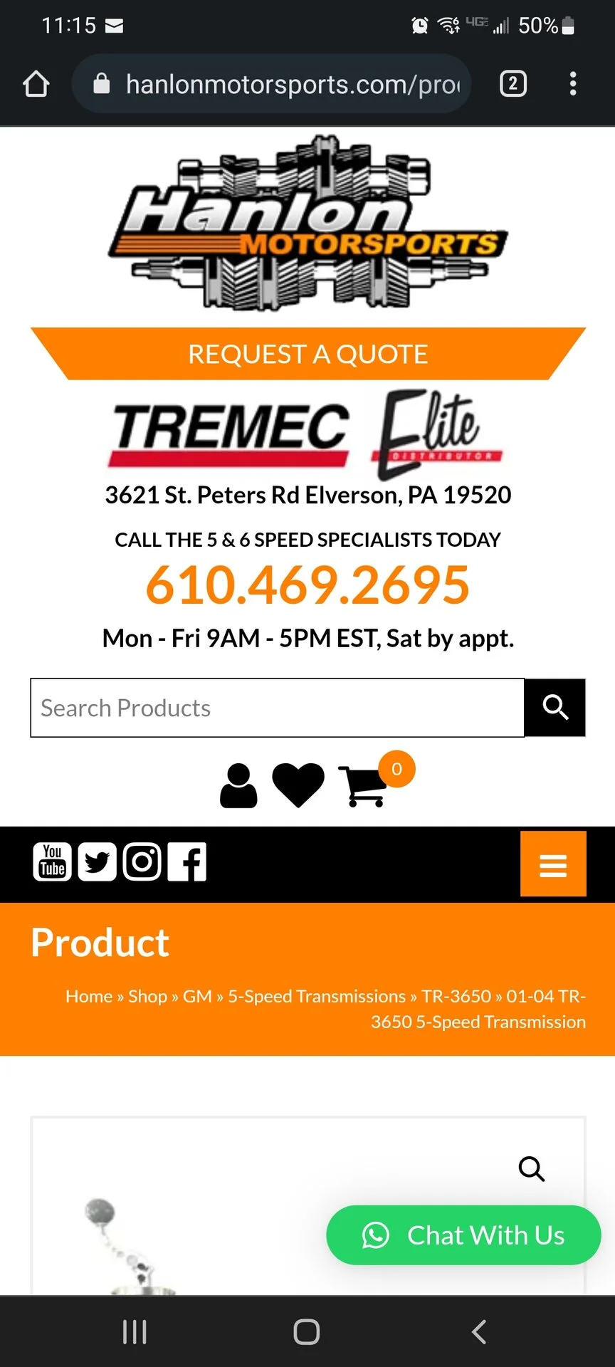

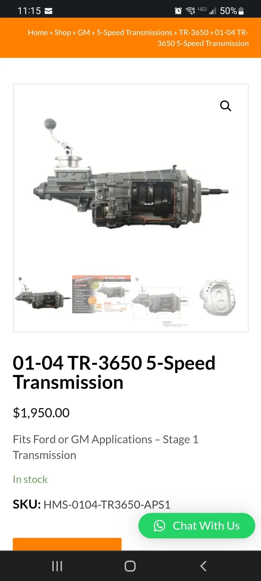

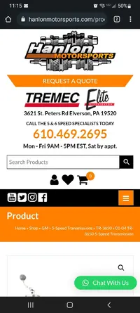

If anyone wanted to know...this is the TR3650 by Hanlon Motorsports. Cheaper option.
If you're really weighing your options call Hanlon. Bob, his son, or his wife would be glad to help you figure it out.
