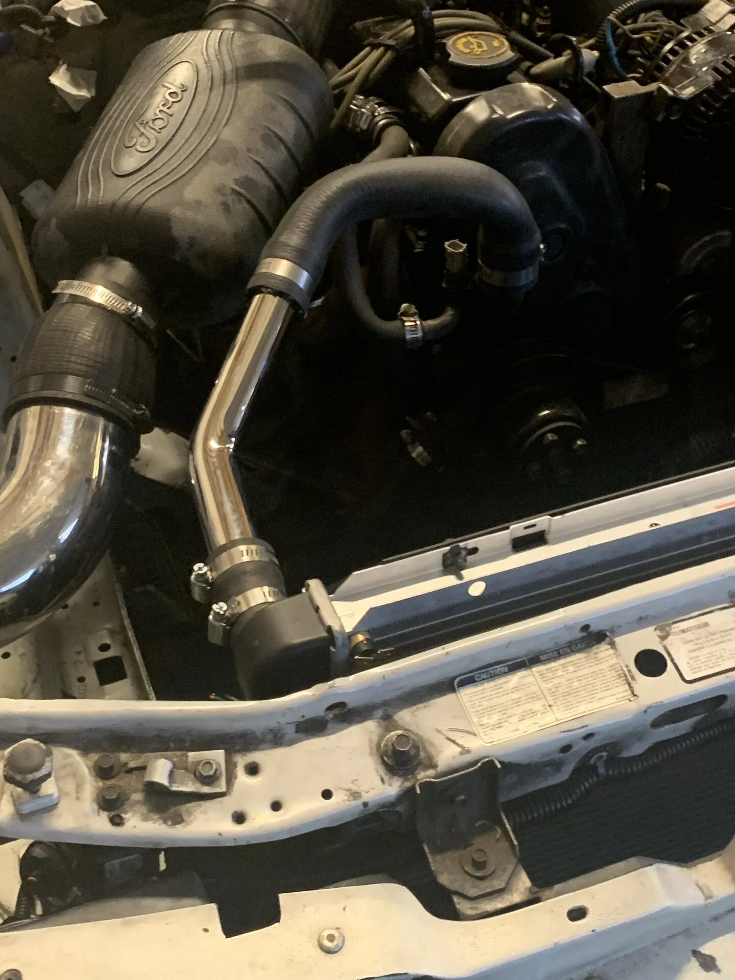

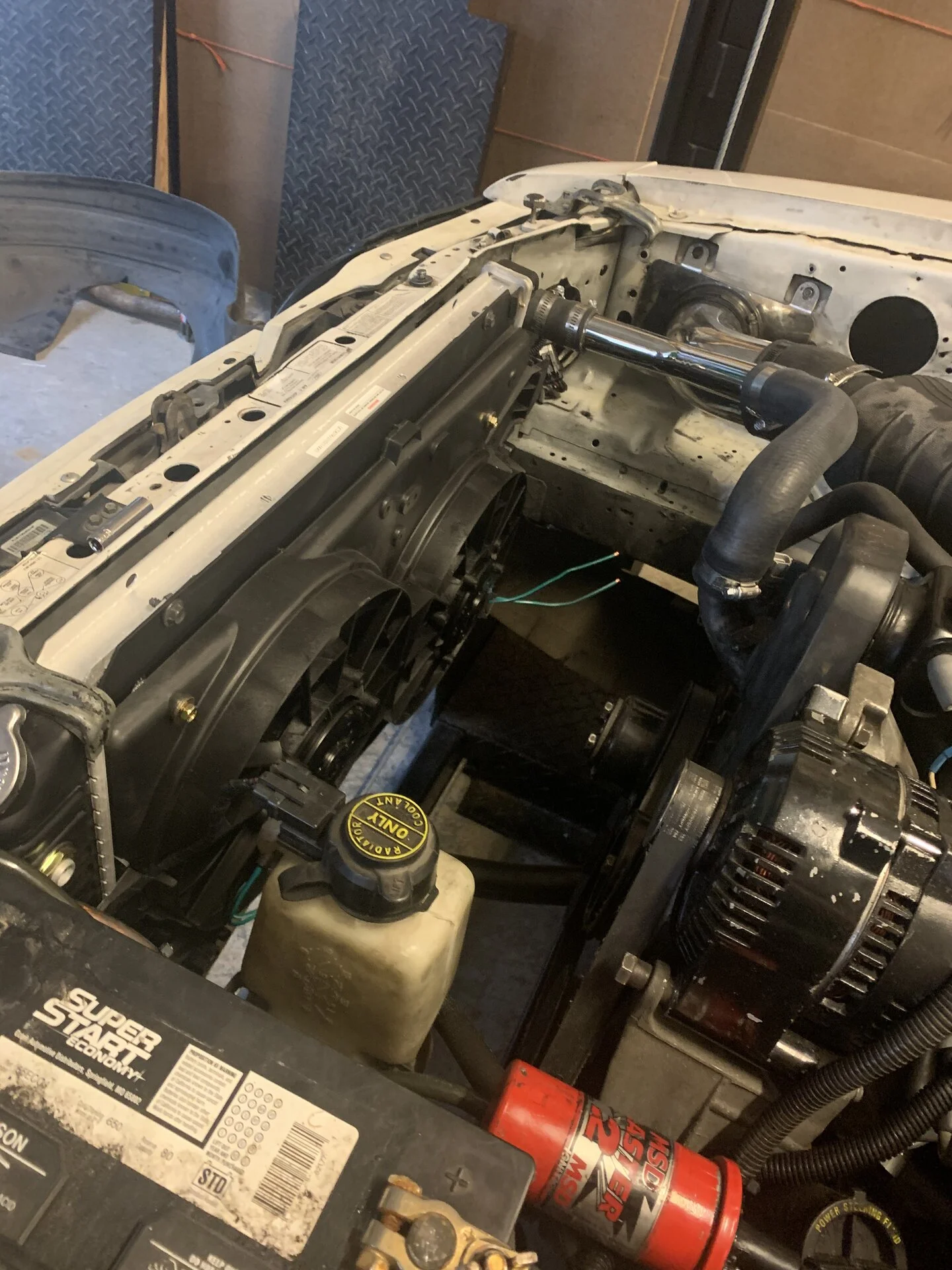

Took a break from wiring the other day and dropped in the radiator, contour fan, and lmr mounting kit. The kit was pretty nice!
Hacked some hoses together, to complete the cooling system, just needs coolant.
I think the chrome piece came from a hose kit I had for the v8 setup, but it fit in nicely on this 2.3…

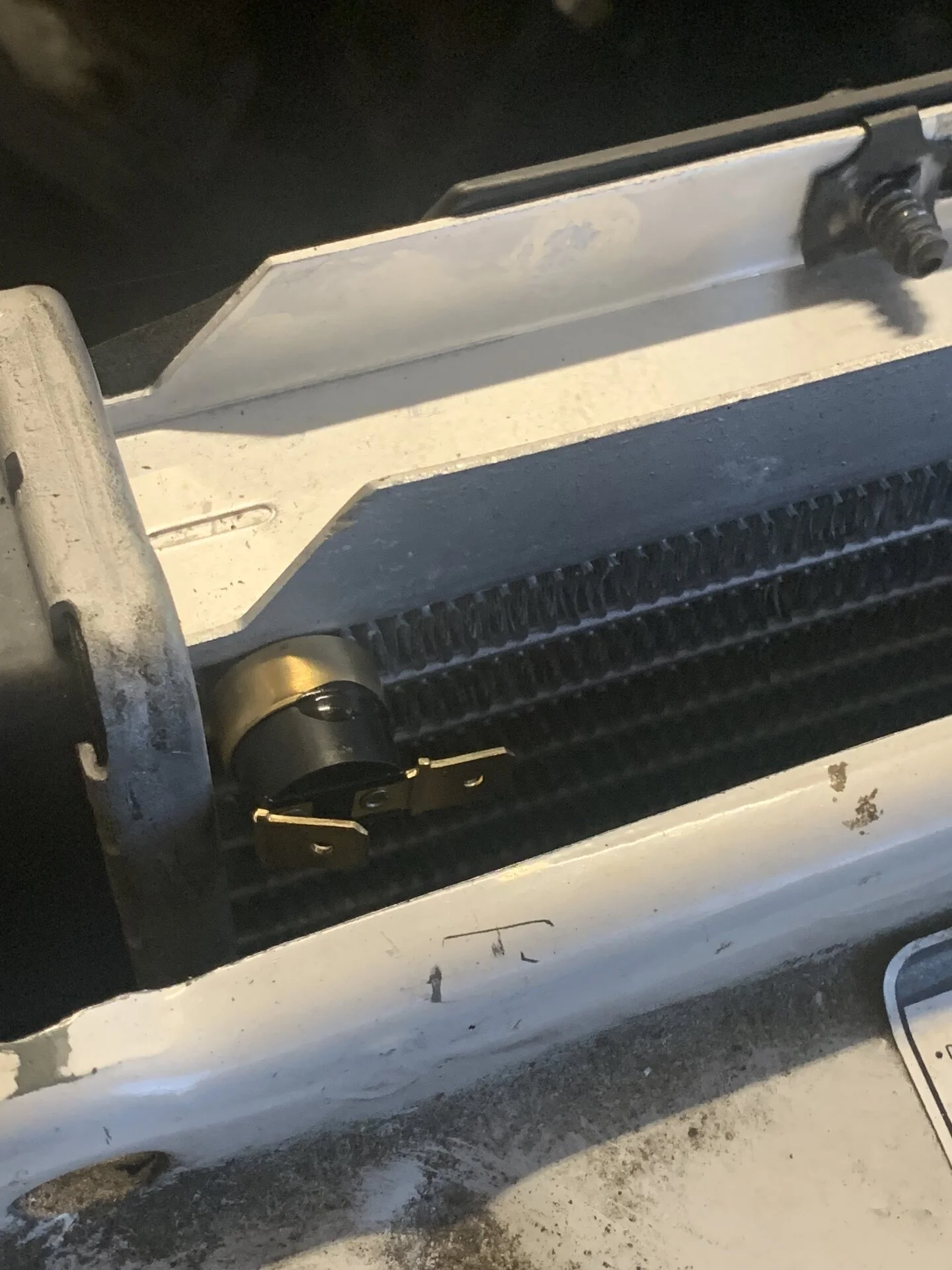

Going to use a relay to trigger the fans on/off, using one of those radiator fin probes.
