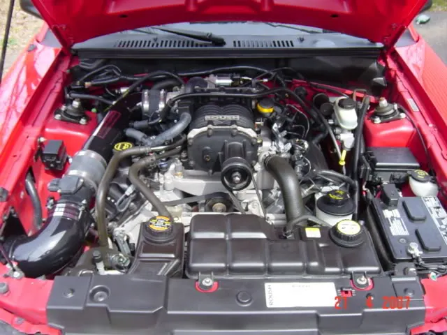

^ I just bought my JLT for the looks since I show it...
Makes the engine look nice instead of some metal pipe or that crappy way the stock one looks IMO :D
does give it a nice whine...i've had a few ask if i have a s/c from car people...haha

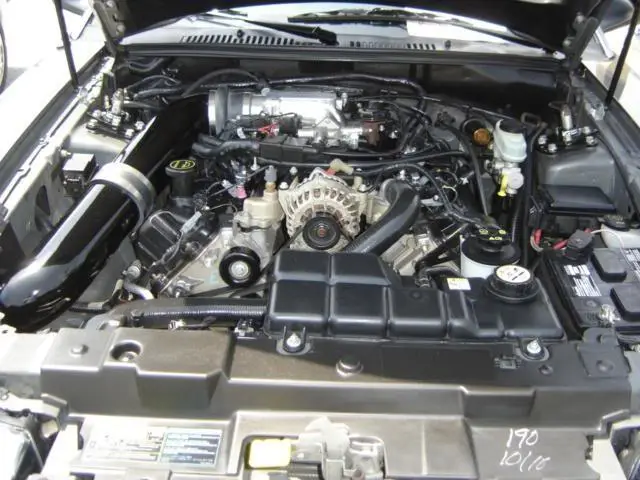

I put a K&N FIPK onto a stock tb/plenum. It made a louder air "whooshing" sound but didn't really notice much more power in and of itself. It did look like it provided way better airflow than the stock setup, which mattered to me because I'm slowly building up with bolt-ons before eventually going whole hog with a Procharger and I want the basics optimized first.
Next I replaced the stock setup with an Accufab 75 mm tb/plenum and a spacer. Now there was a MUCH more noticeable difference!! So the K&N could very well have been trying to help, but with the tiny intake in back of it, the benefit went unnoticed until enlarging the tb & plenum.
On the con side: I also had to leave off the bottom bracket due to rubbing, but it seems to hold on ok with just the one bracket. The black plastic isn't the most attractive thing in the world, especially with the polished stuff next to it, but at least there are no heat retention issues.
So I don't regret spending on the FIPK; it's one more component that I don't have to worry will create a bottleneck when it finally gets blown.
So does my wife.....Whine that is......:D
In hindsight, the CAI would have been a heck of a lot cheaper:lol:
