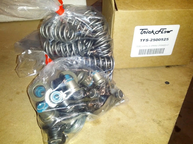

Thanks, looks like the spring I had before were :poo:.. They are CompCams 26113-16 (stage 1 springs) and from what I have read about them they are no better than stock... Just ordered a new set from trickflow, TFS-2500525 Twisted Wedge Track Heat Valve Springs kit. Im hoping they will be here by Friday so I can get the car on the dyno by Saturday.

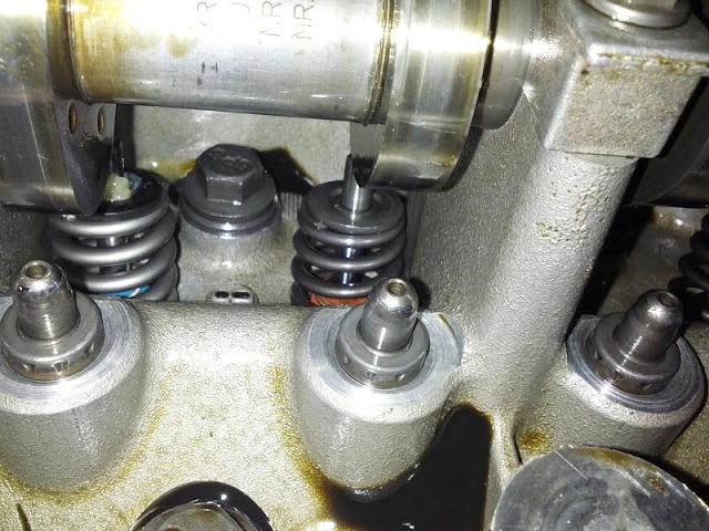

BTW springs are here! Time to install:cool:

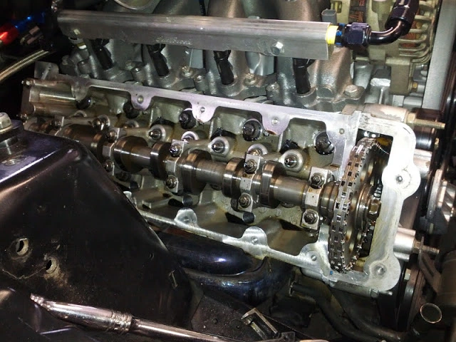

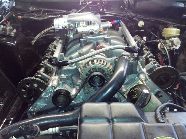

Springs installed

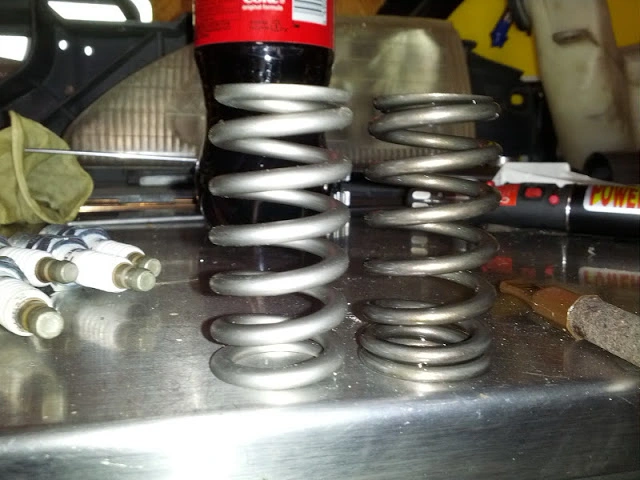

Trick Flow Track heat spring on the left & CompCam Stage 1 spring on the right
Trick Flow Track heat spring installed on the left & CompCam Stage 1 spring on the installed right
After the install, the sound of the engine changed at idle and under load. The boost comes in harder and holds all the way till 6500rpm, I will post another dyno video of the boost before the spring swap.
