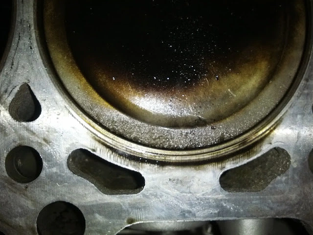

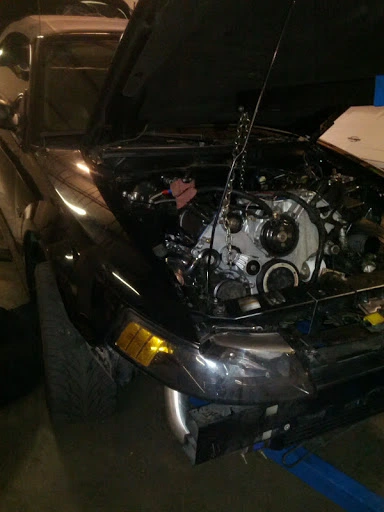

Removing the engine tonight, checked out cylinder 3 with a bore scope and saw a very small chip missing near the ring. Replacement piston and rings are on order. Also We think there was an issue with the head gasket as well, a little bit of oil was found in the coolant. Upgrading to head studs, too much boost for stock bolts. A quote from my brother "Bob, you need to stop being a cheap ass, im getting tired pulling this car apart."

Pulling engine apart tonight, I could have a new piston in it by the end of next week, however I want to take this time to get all the other issues fixed. Going to redo the wiring and hydraulic lines this winter, Im also doing the suspension and get a rollcage installed, I think the power the car is going to lay down will put me at mid 130's or higher. The piston breaking was god telling me not to hit the track going at that speed w/ stock struts and shocks with 140,000 miles on them w/o a roll cage.:leaving:

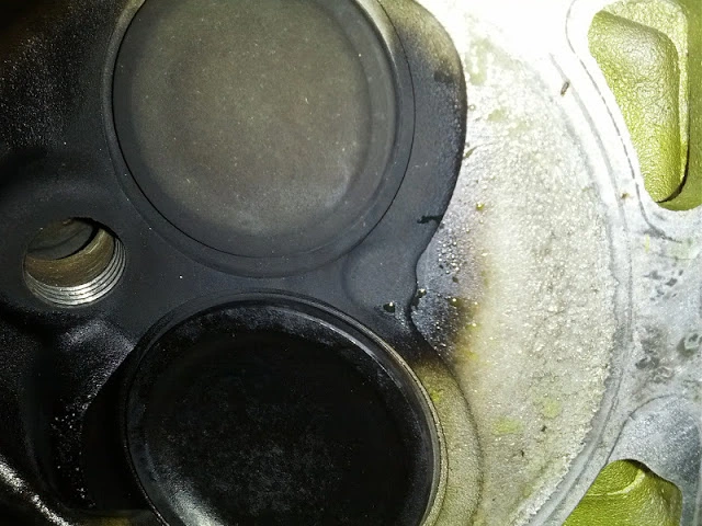

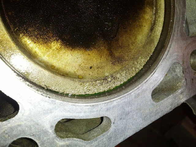

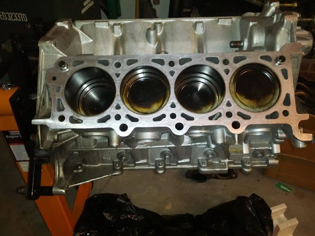

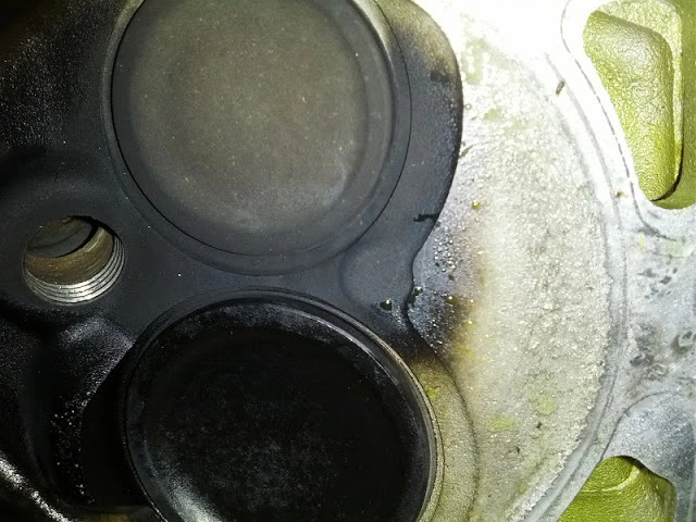

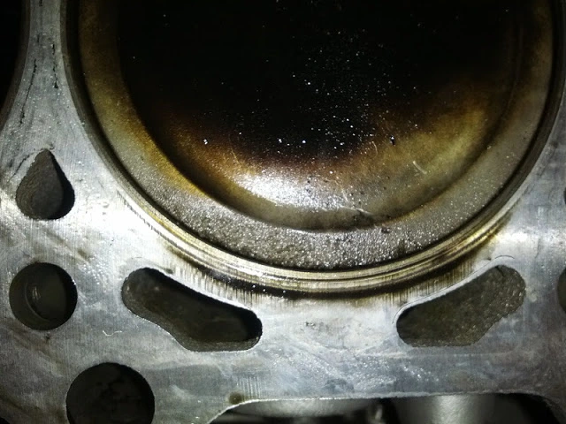

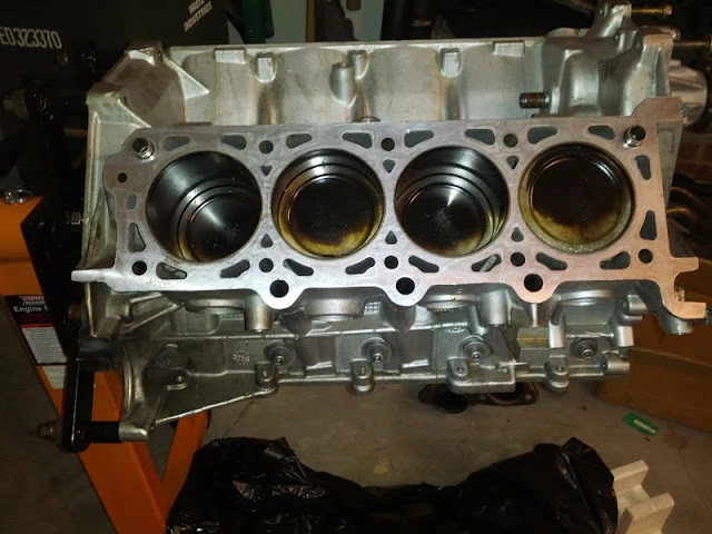

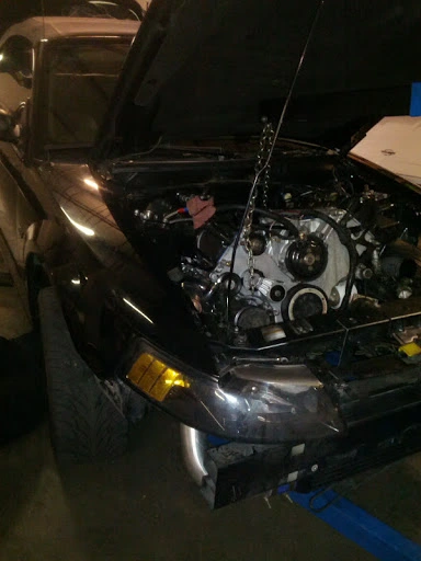

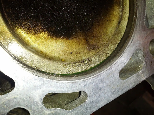

Not looking good... All eight pistons need to be replaced. Both head gaskets were blown and leaking coolant into the combustion chambers, and a ton of detonation. Stock head bolts did not hold up well I must say. Heads have some damage, but can be fixed. Block, crank, rods and everything else is fine. Head studs, gaskets, pistons and rings need to be ordered.
