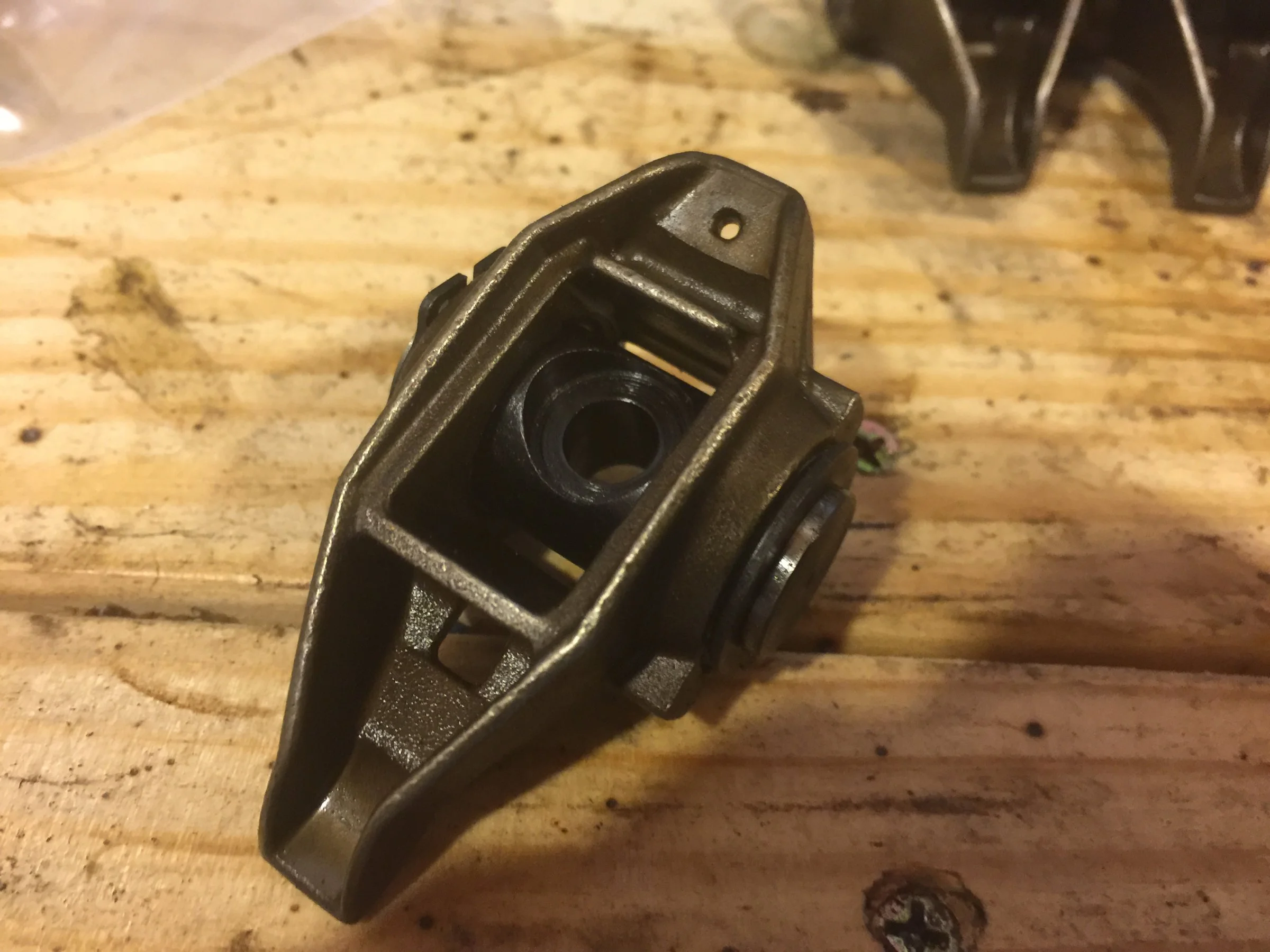

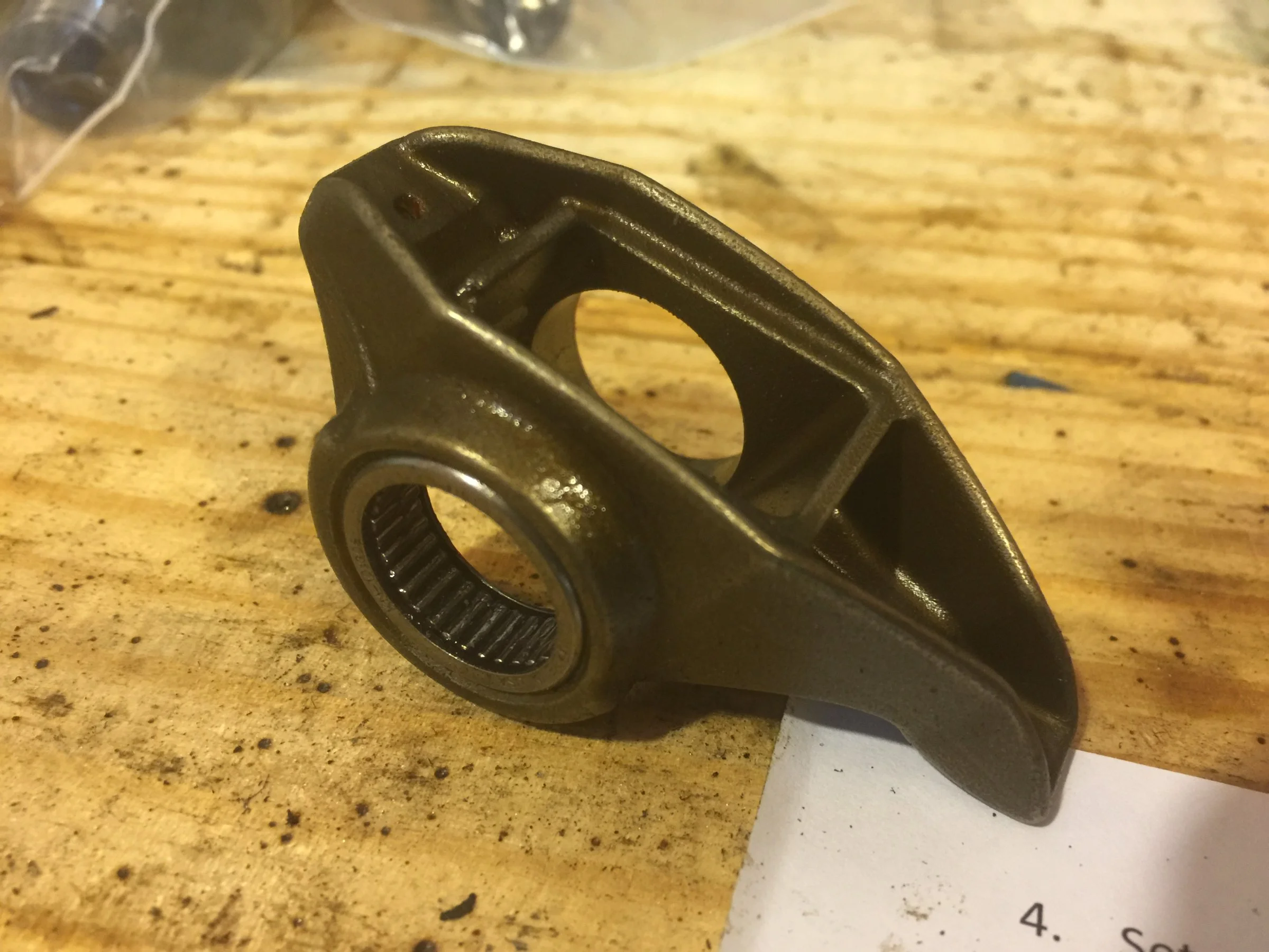

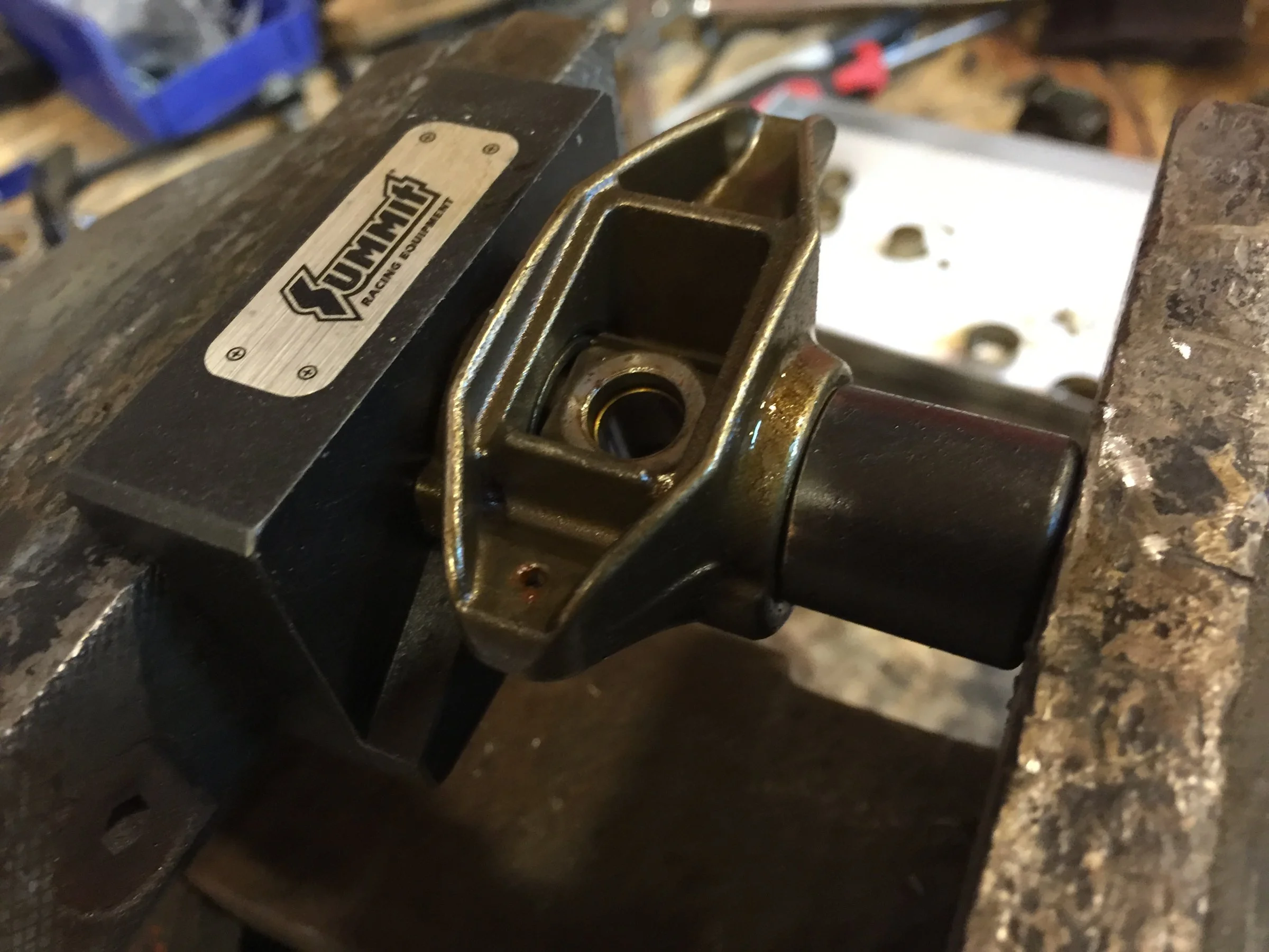

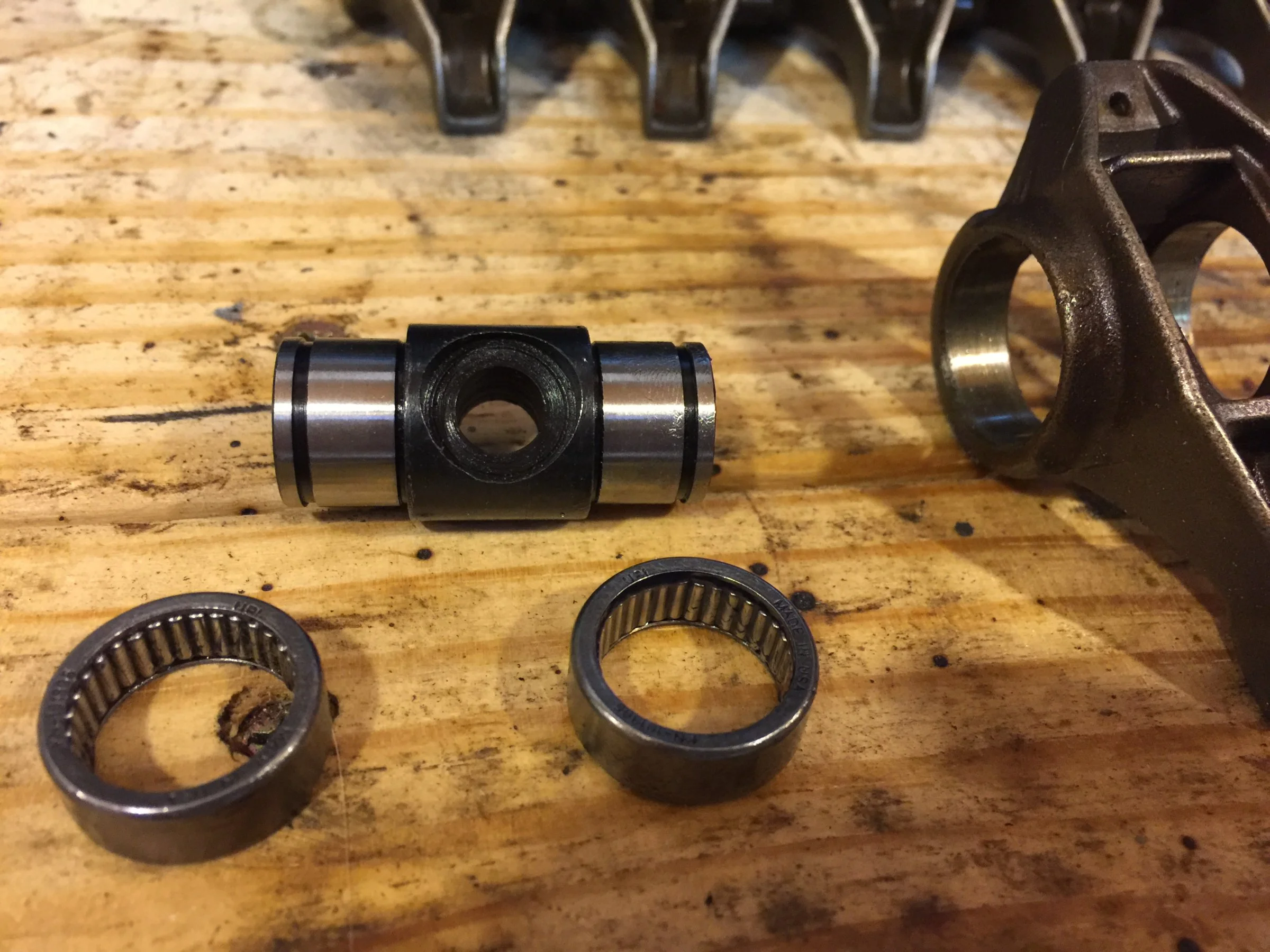

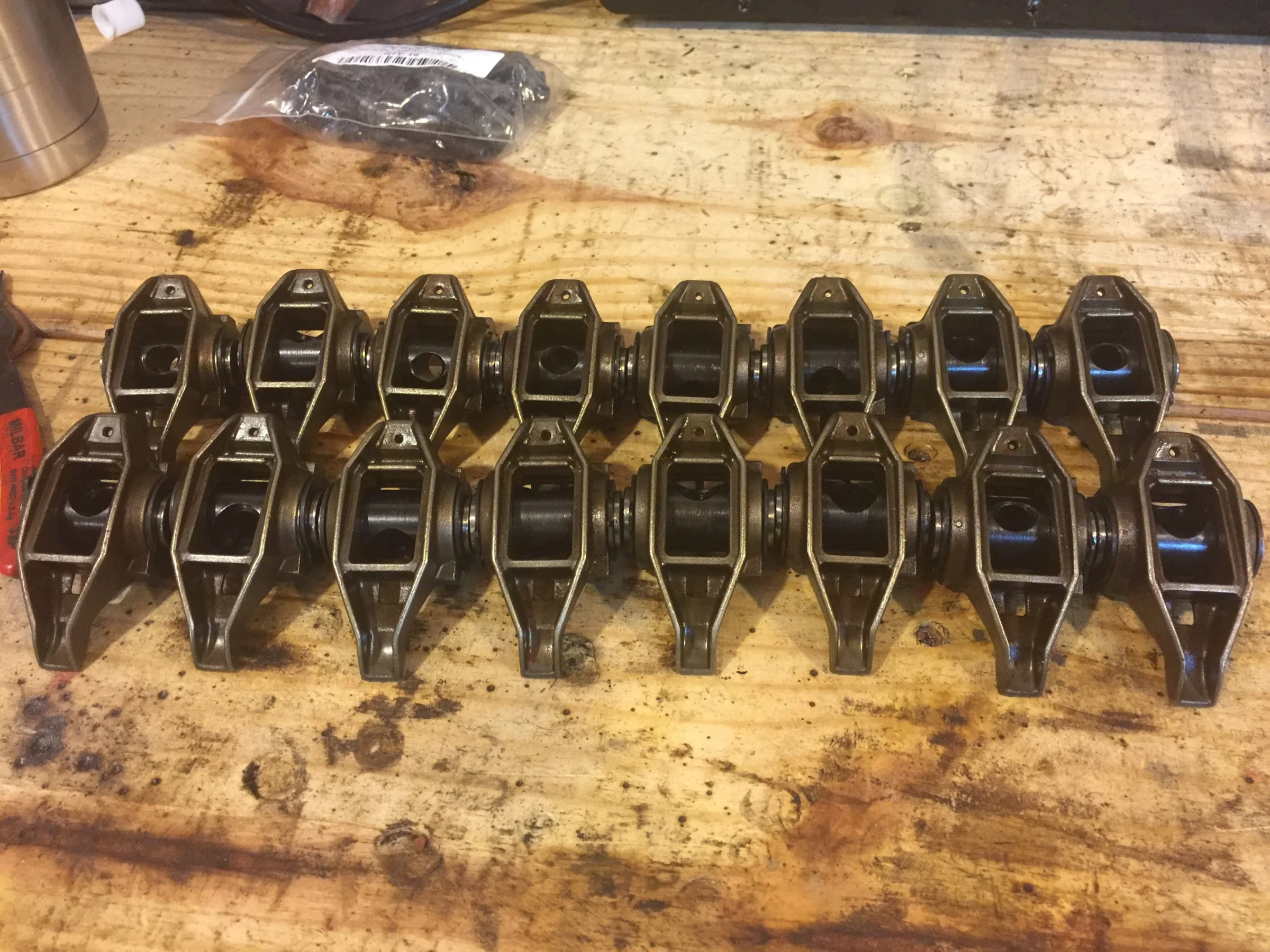

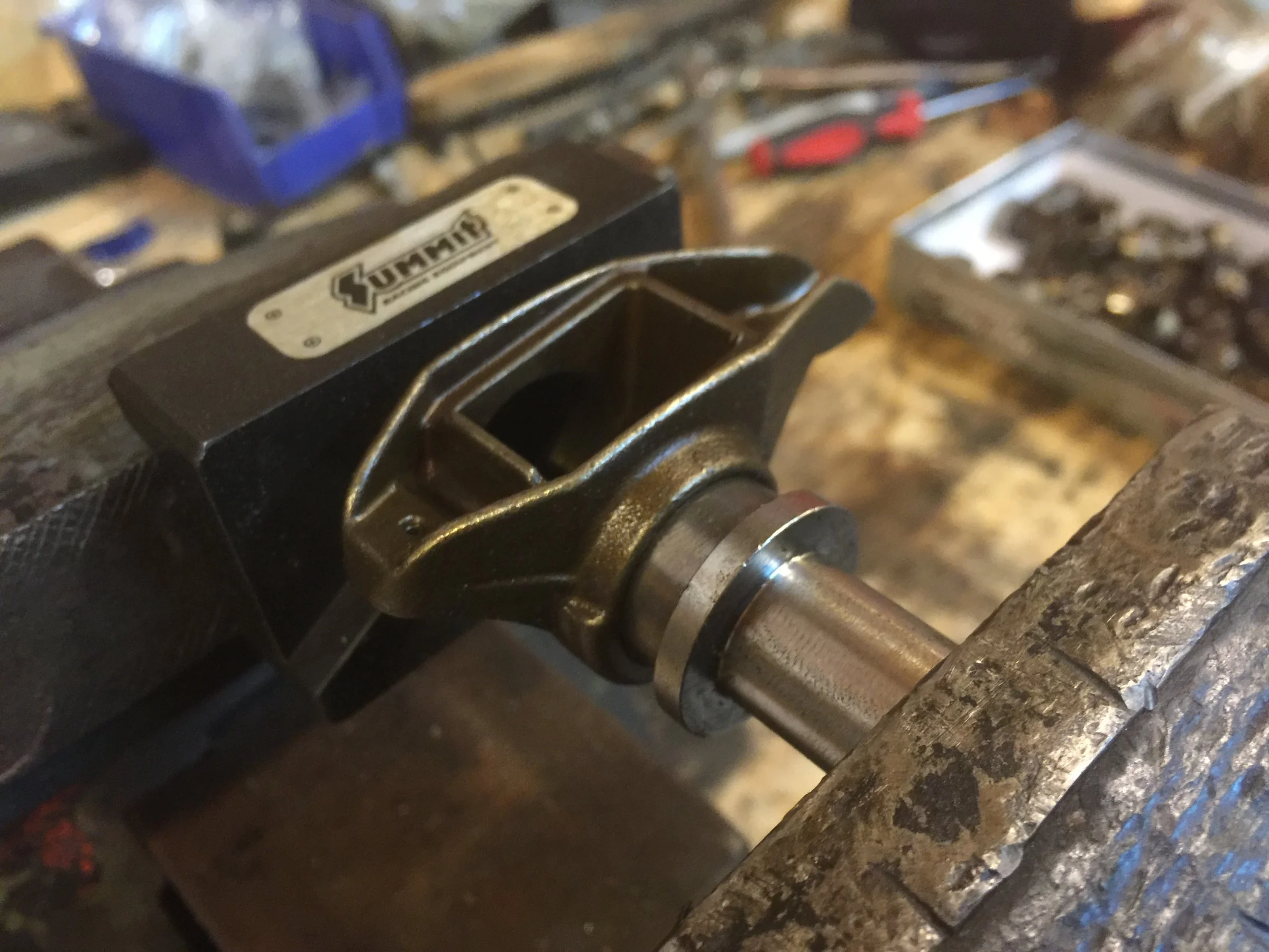

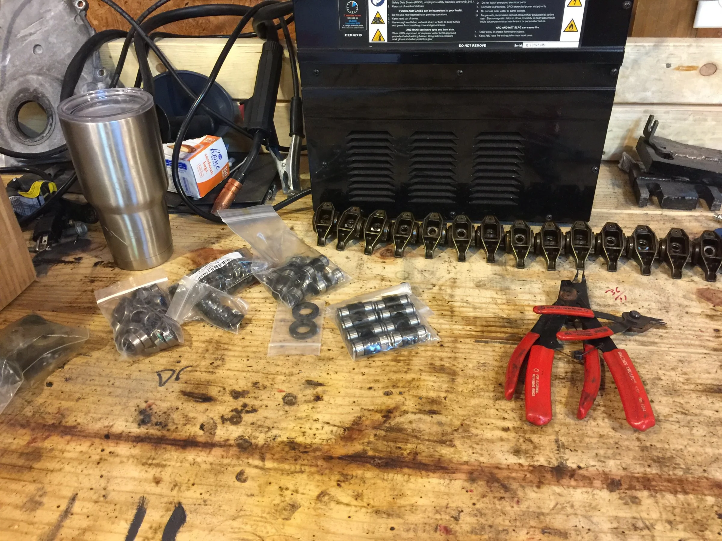

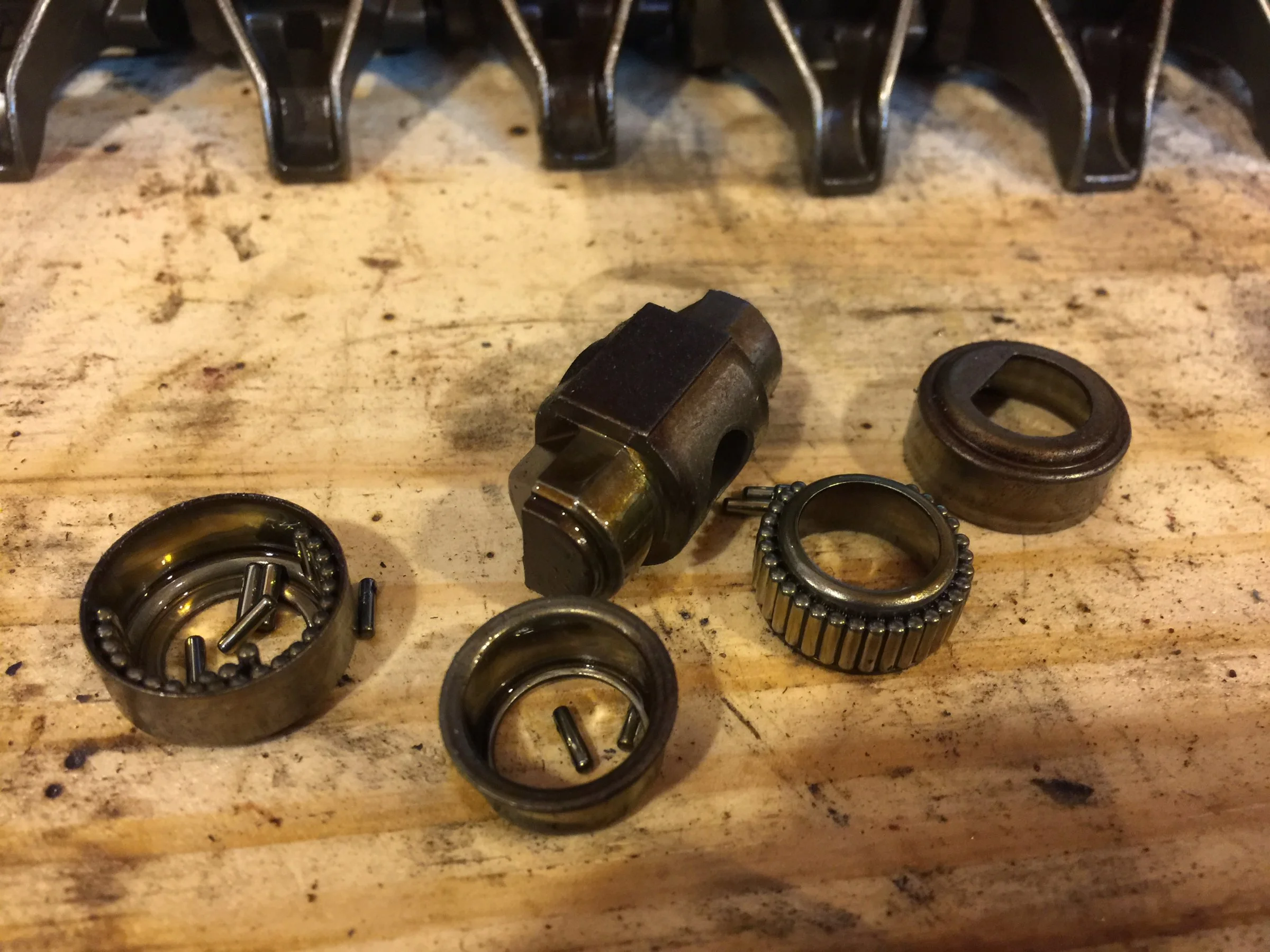

Sat down and rebuilt/upgraded the rocker arms today. I realize I'm not really catering to my audience here but I took some pictures along the way. I'll be doing the same when I upgrade the valve springs this evening if anyone is interested in the process. I'm sure most have done the job.
Old rockers, the kit and some trusty snap ring pliers
Handy summit bench vice tool. Pressing the old trunions out

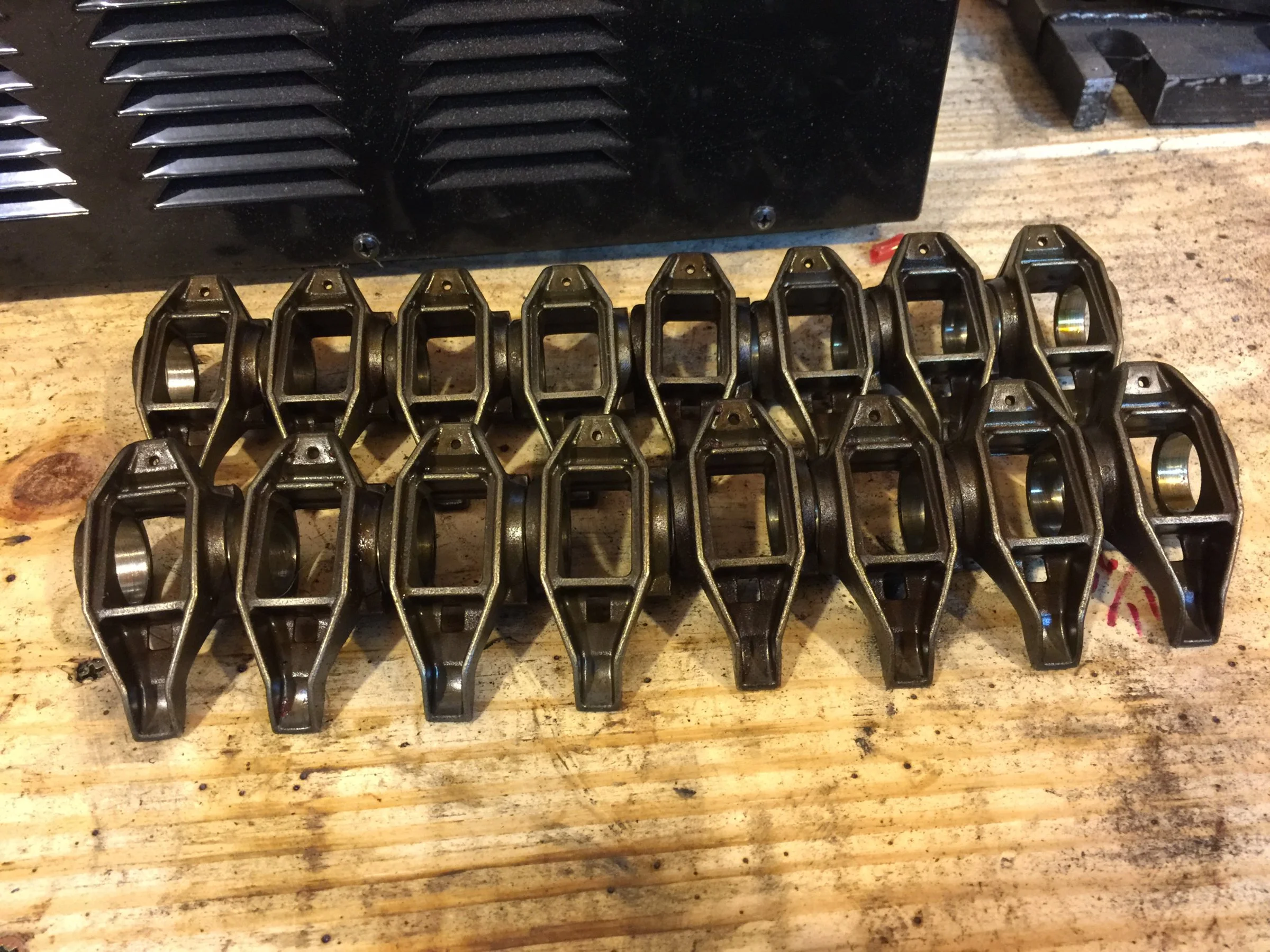

End up with this mess. The factory Gm rockers are an awesome piece. Super stable, reliable up to 4 digit horsepower and really hard to beat. Their only downfall being the bearings can implode if the valvetrain Is setup incorrectly or receives any kind of trauma. Which you can imagine what happens when all those little needle bastards end up loose in the cylinder head.
Empty rocker bodies
Upgraded trunion bearing design. Pressing in the new bearings. Drop the trunion in from the other side and press the other bearing on.
Apply some snap rings and there you have it.
Repeat 15 more times. Not a bad upgrade including the ARP bolts for under $140.

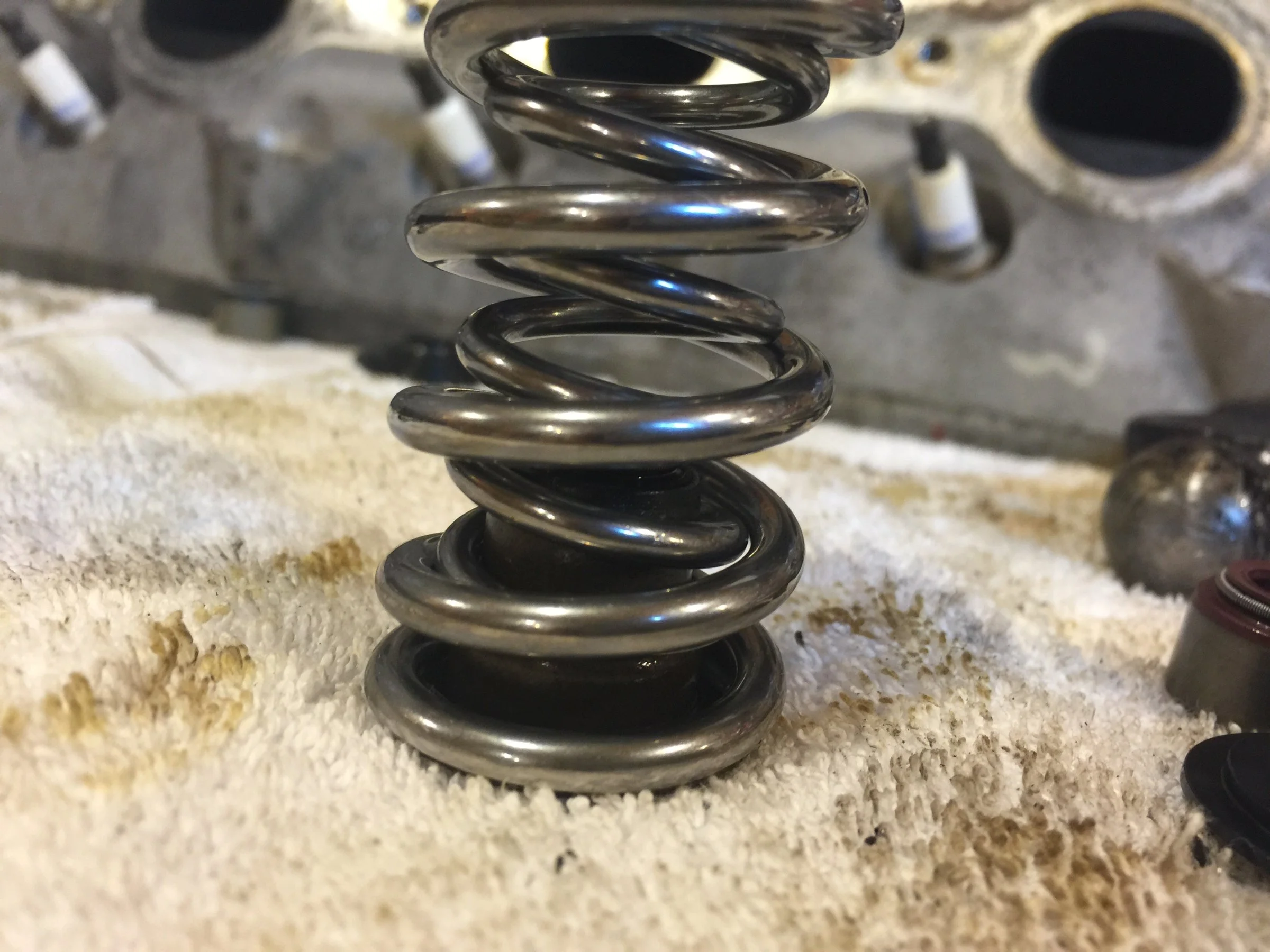

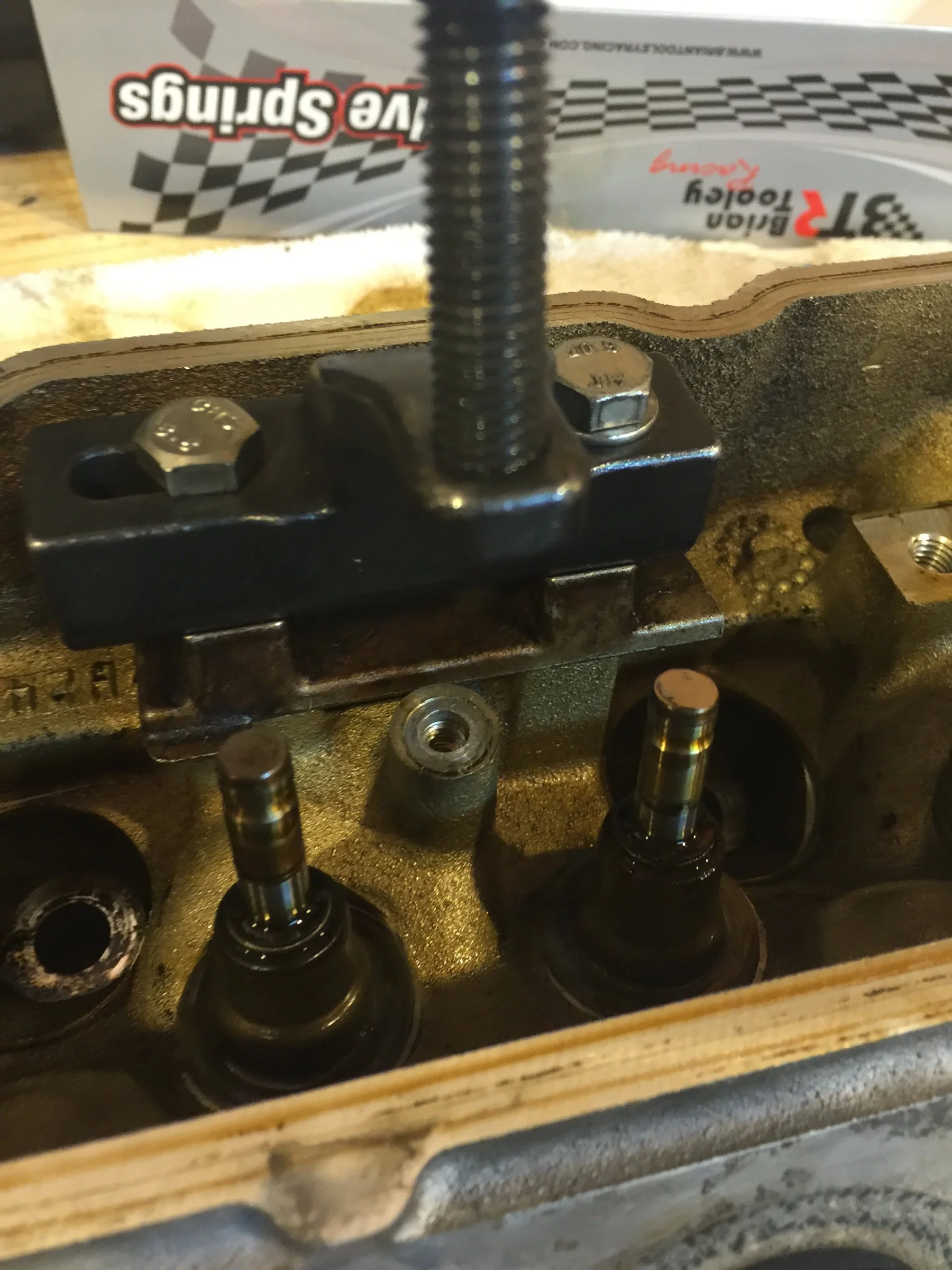

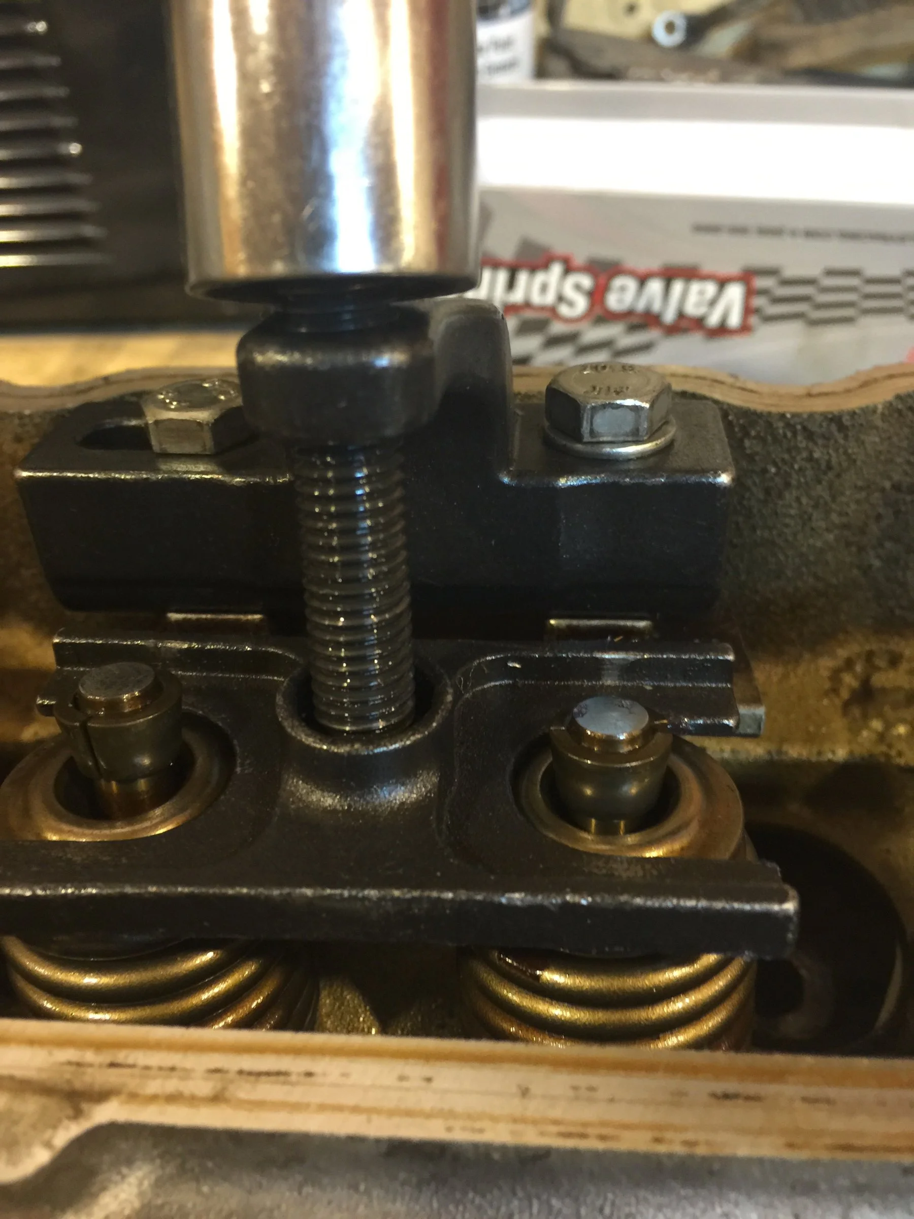

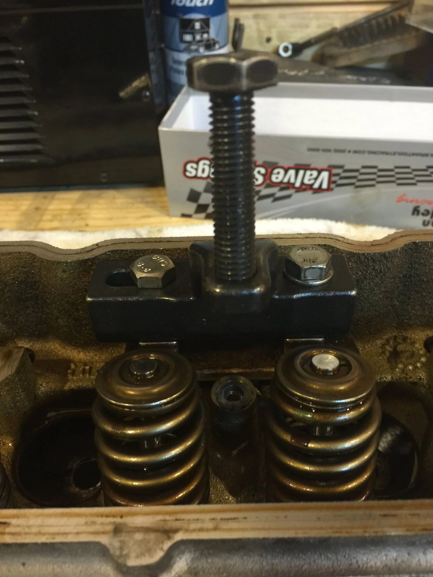

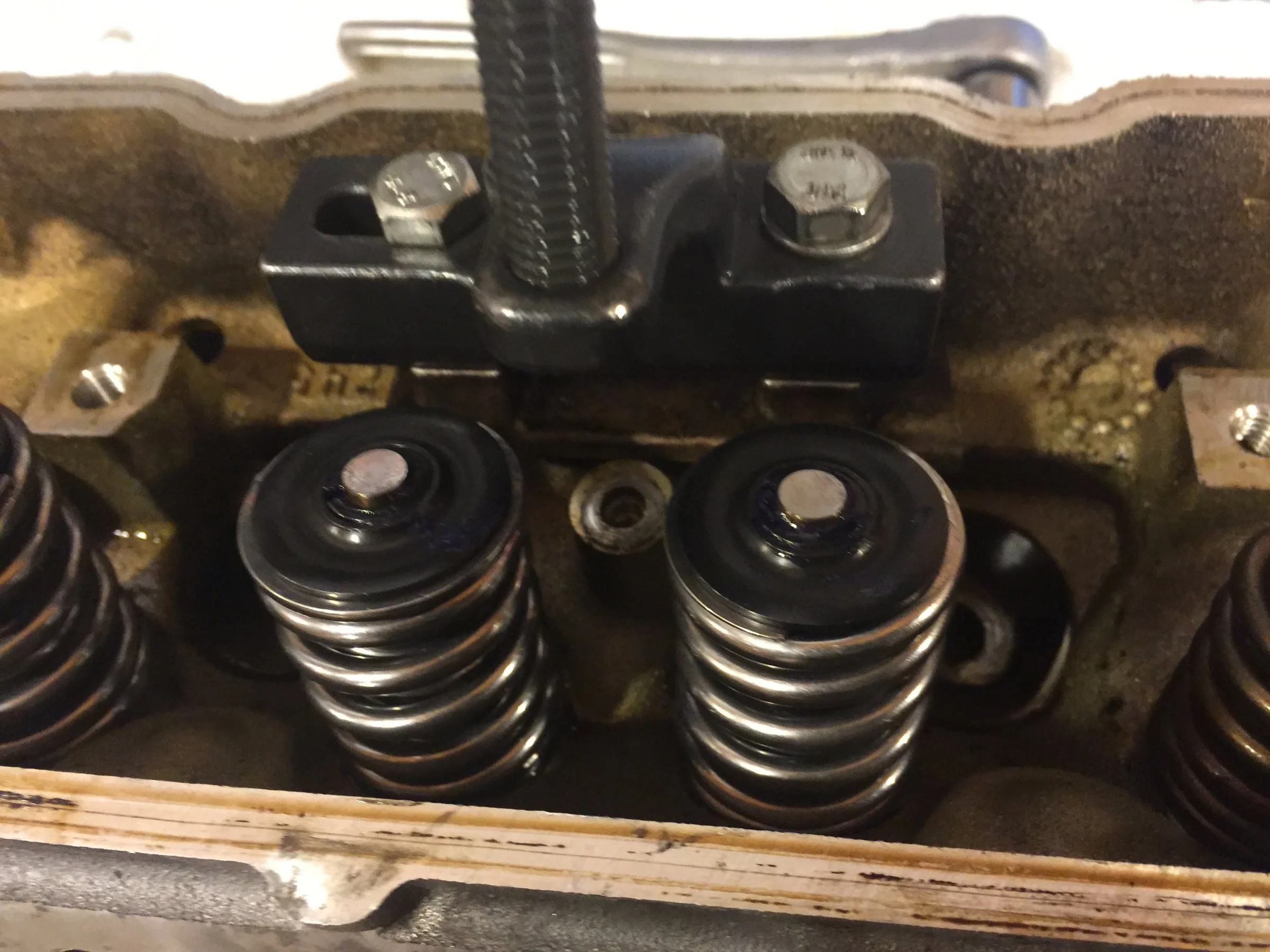

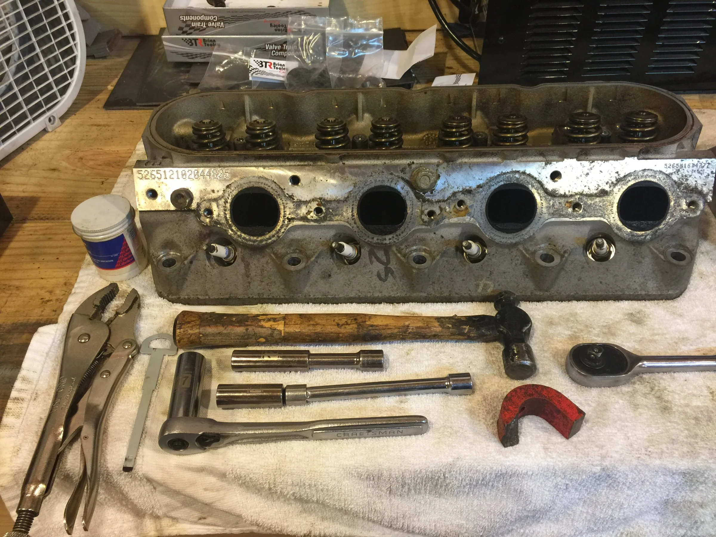

Tonight, cylinder heads were overhauled.
New springs, seats, seals, locks and retainers courtesy of BTR.
Tools. I don't like switching sockets so I enlist multiple wrenches. I lost my magnet stick, so large hunk-o-magnet will have to do.
The hammer is how you can tell it's a delicate procedure.
Comp cam spring tool. Bolts to the rocker arm rail, I cut up a small section of rocker rail to use with the tool.
Collapse the springs and remove the locks.
Now the springs can come out.

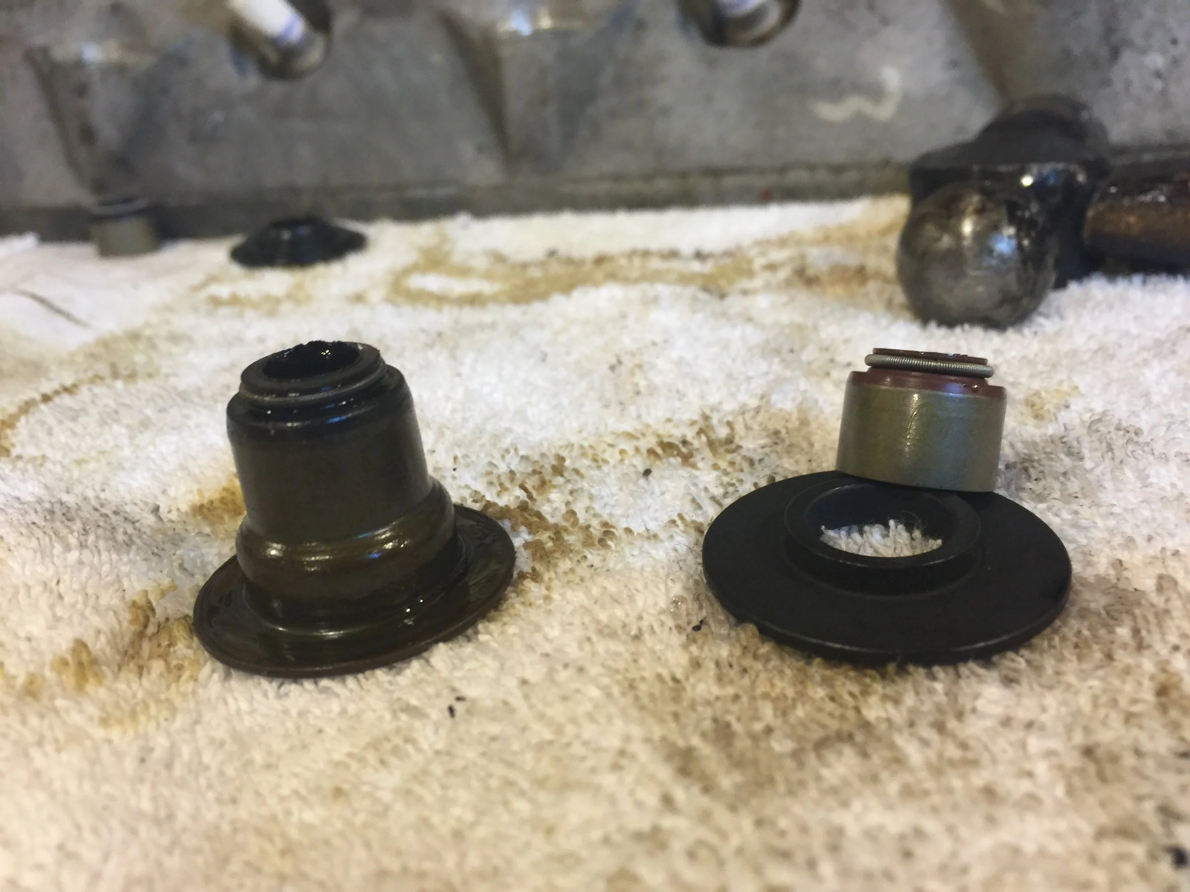

OE valve seals. These have to be replaced as the new springs are dual.
The inner spring contacts and can bind with the valve seal.
Old seal/seat left, new valve seat and seal on right. The hammer is used with a 12pt socket around the seal to knock it down into position. This sounds a little rough but it's actually the recommended method. 1/8" gap between the seat and the seal is what we're after. I made a little quick checker to check that gap as well as installed height. It's not super duper accurate but it gets the job done.
Same process on the installation. I use a little dilectic grease to hold the locks in place. It can be a real PITA, and if you do it quick enough you can catch a lock between the eyes....

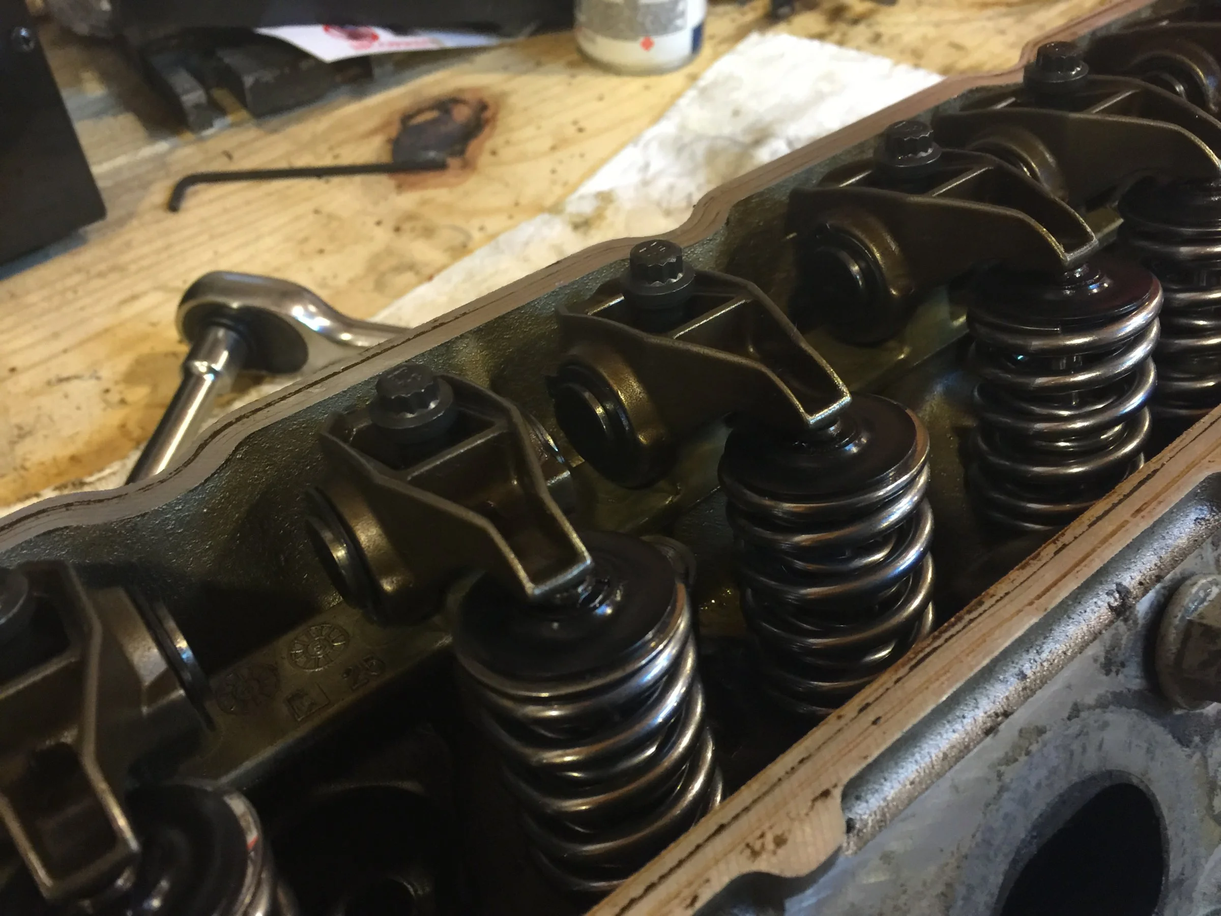

New springs with new rockers
Thought a video might be cool, so I gave it a shot. I struggled with the last set of locks on the right side and to prevent hurling it all across the shop I took a small break. so I cut the video a little short.

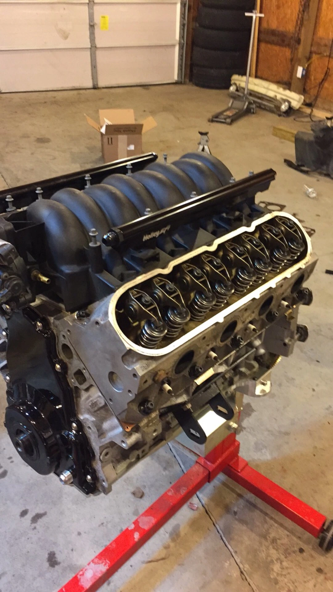

Tonight was an emotional roller coaster.
I laughed, I cried, I said the F word a handful of times.

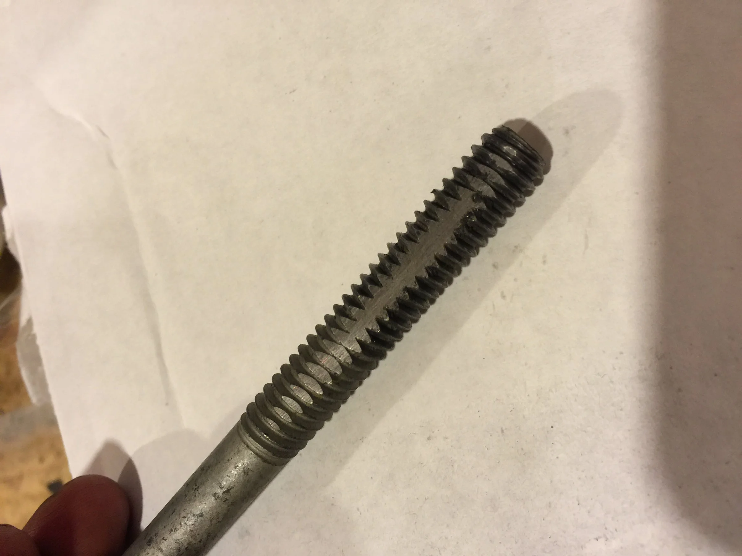

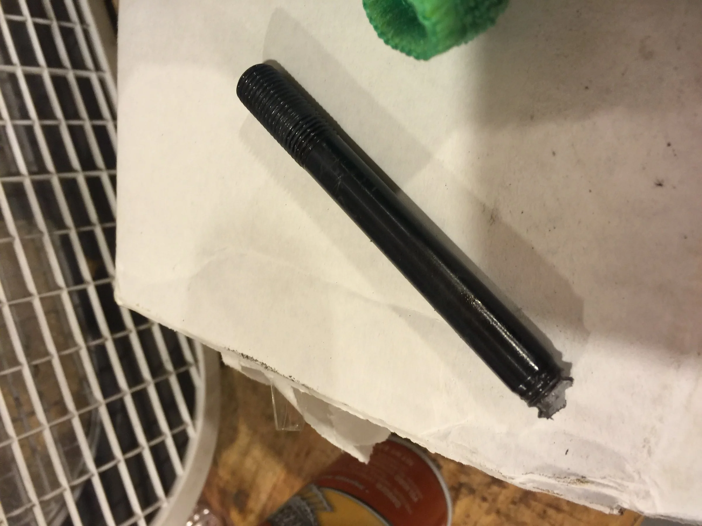

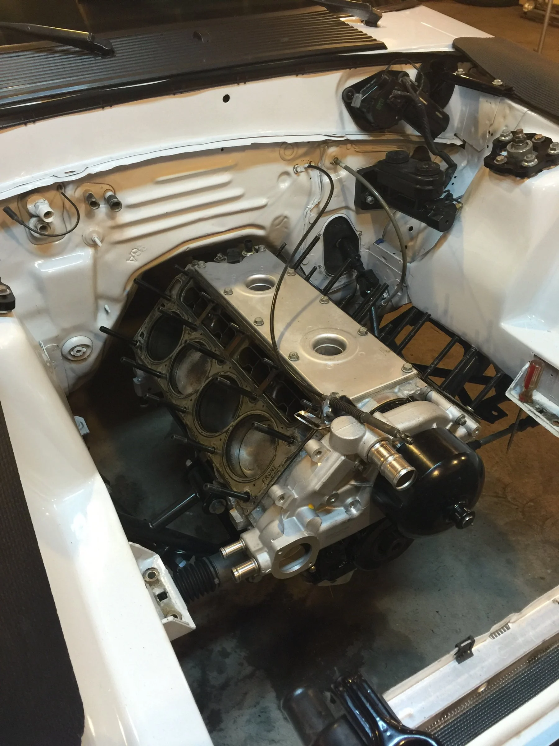

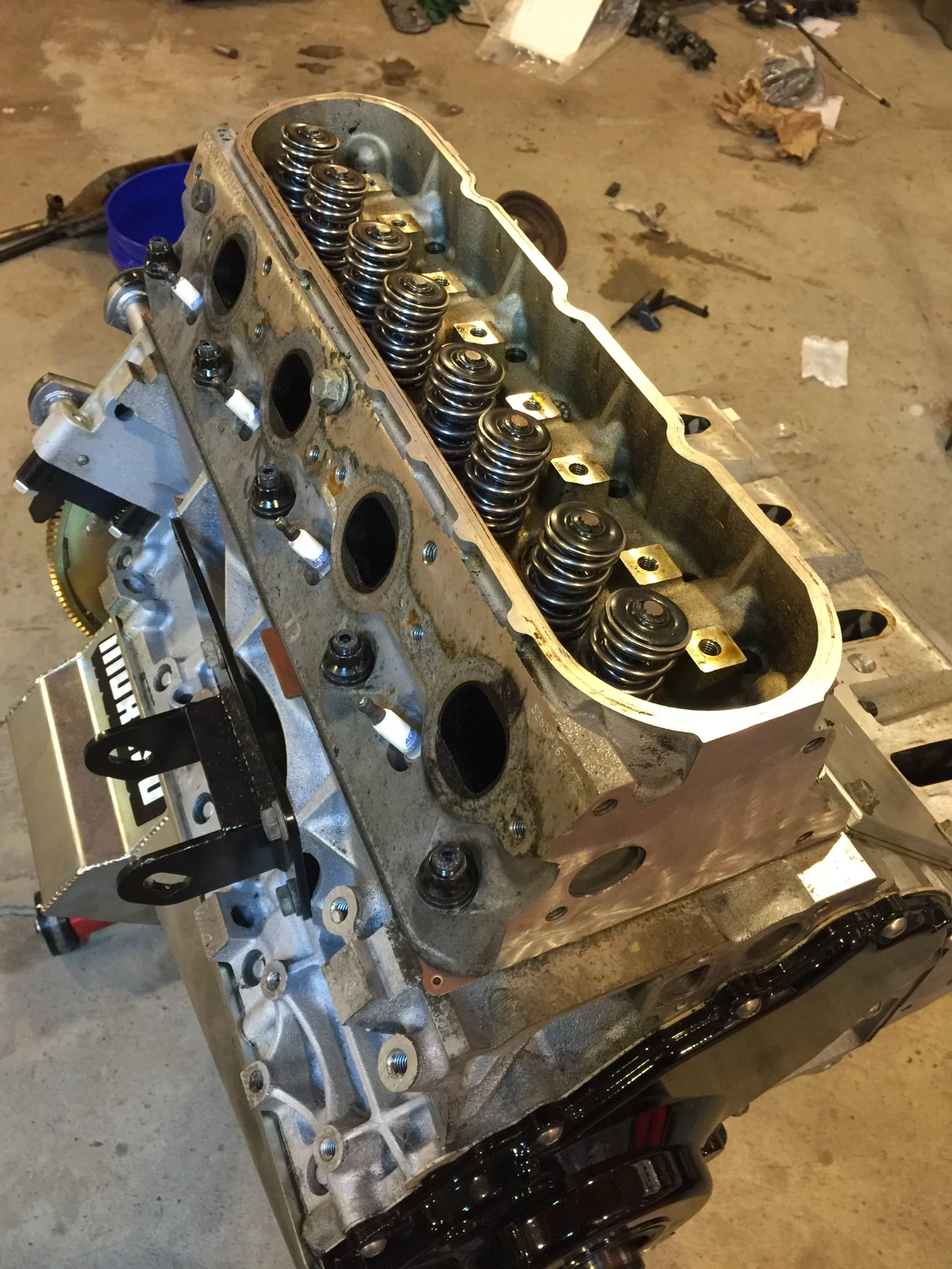

Pulled the motor back out again to tackle the head studs. Doesn't seem like a big deal but this is the 3rd? Salvage yard block I've put studs in and it never fails to be a pain in the ass. Brakleen, wd40, air compressor, everything I could find to clean the threads out. ARP wants like $60 for their thread chaser. It's an M11 bolt so I guess they're special. That's $55 more than I'm willing to pay so I made one.
Old head stud + grinder=
Worked like a charm once I cleaned it up a bit.
Got the heads on, ready to be torqued down.
Then the unthinkable happened........

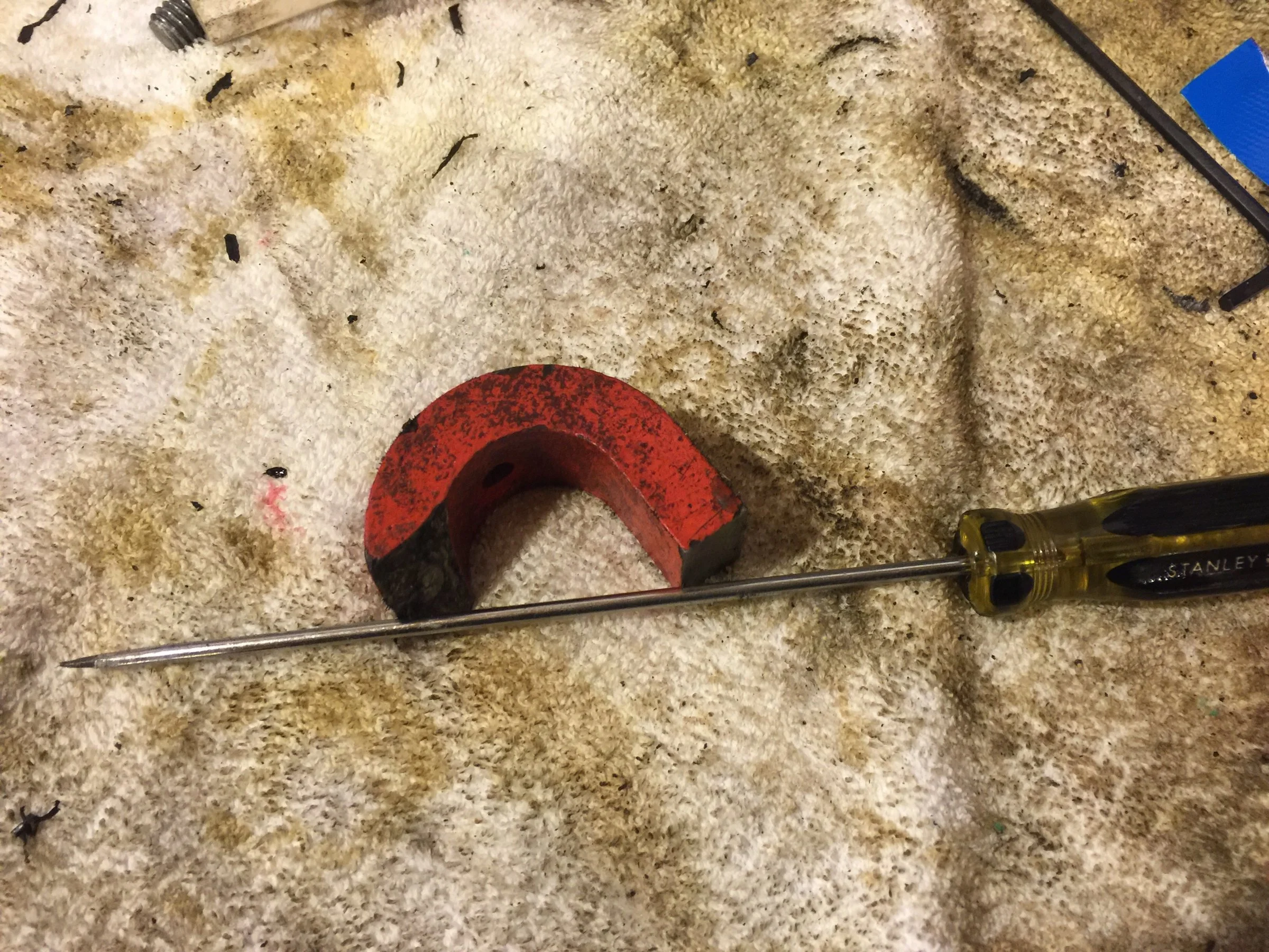

I dropped 5 washers. 5 super special fancy (by my math like $10ea ) washers.
I drop literally everything. If it's important, I'll probably drop it. I fear for my first child.
Luckily I found 4 right off the bat, and after sliding around on the garage floor on my creeper like some sort of crab I found it....
Of course, the magnet stick is still MIA so my crowning achievement of the evening was this creation.
Successful extraction
Tommorow we torque to spec all the things
