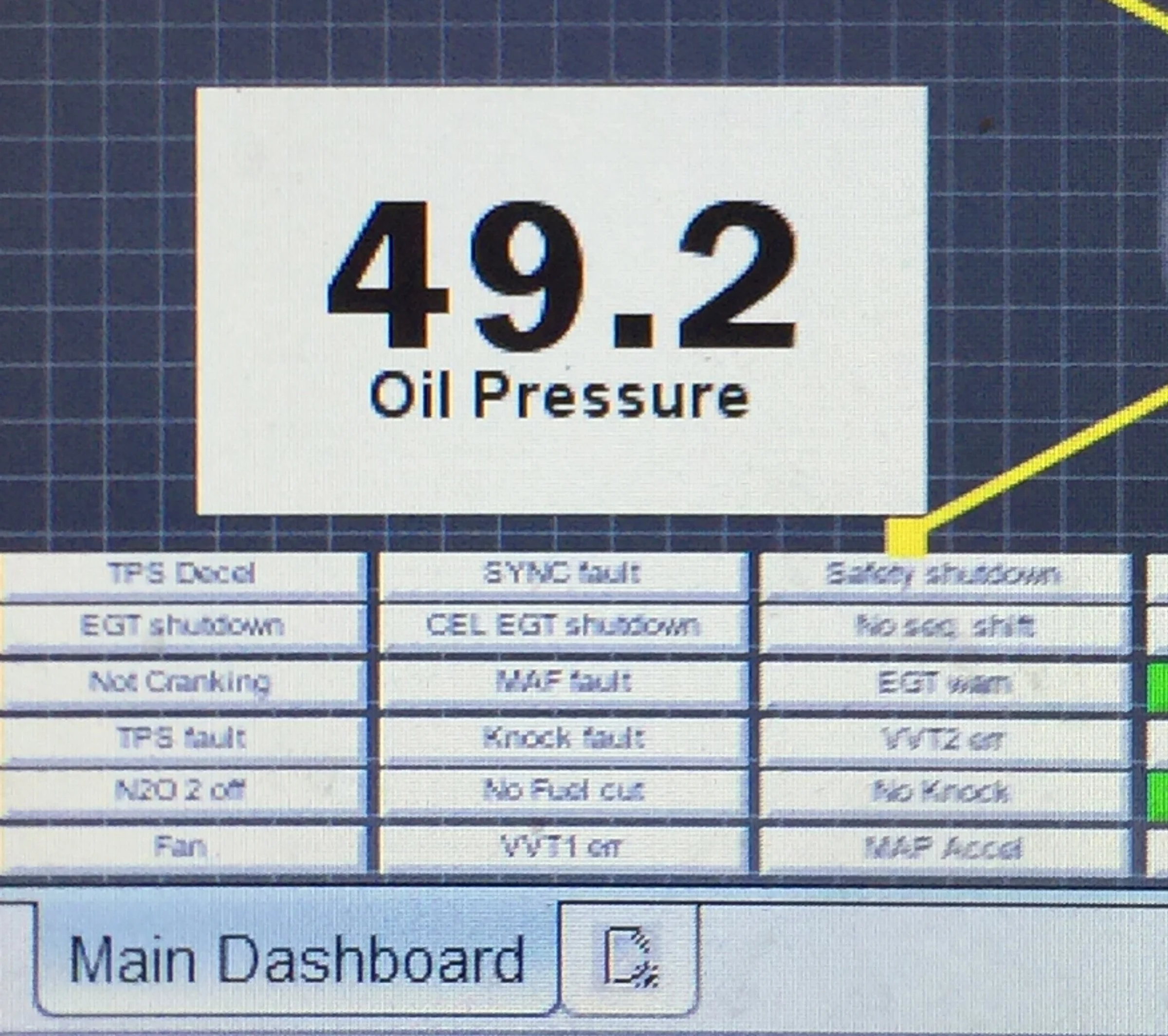

Going to put a mechanical gauge on the car hopefully Monday. If oil pressure doesn't read higher than the laptop was showing, I'll be pulling the engine out next weekend.

Finally had a free hour to mess with the car and was able to change the pressure sensor.
This is a relief.

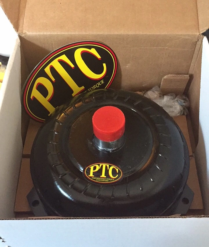

New PTC converter showed up today.
