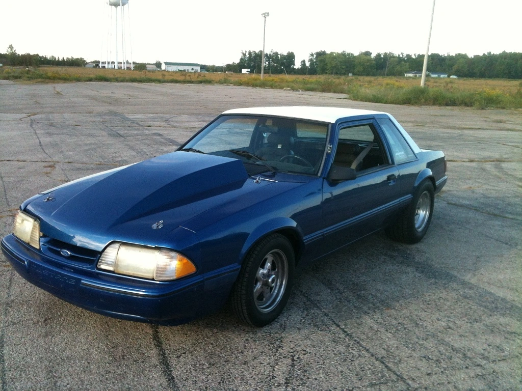

Blue car's mods are as follows:
new T5, stock SD 302
built rear end, c-clip eliminators, strange axles, 3.73s,
5-lug conversion
double adjustable LCAs, adjustable UCAs, battle boxes
eibach drag springs with airbag, comp eng. 3-way adjustables.
battery relocation
mac shorties, H-pipe, flowmasters
short throw shifter, new clutch, clutch quadrant
255 fuel pump, electric fan and a few other odds and ends
lakewood 90/10s
wheels are Weld Prostars 15x10s 6.5 BS in the rear with 275/60/15 BFGs
15x3.5s with 155 BFGs on the front.
car also came with front coil-overs but those are being saved for the red car

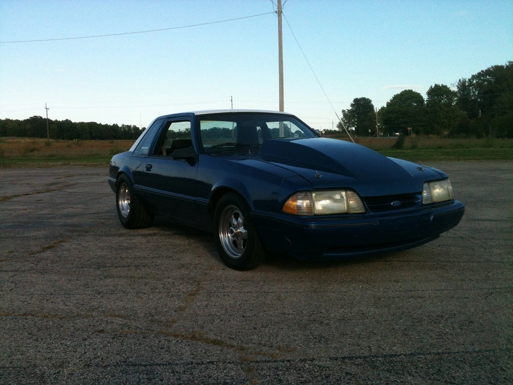

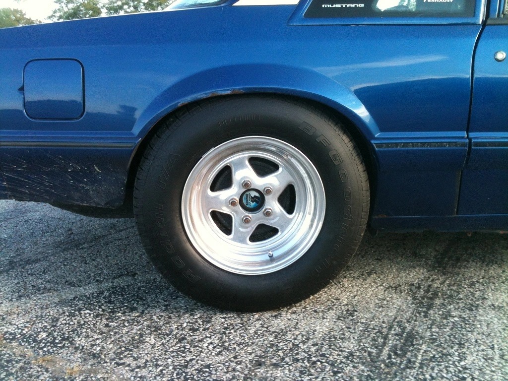

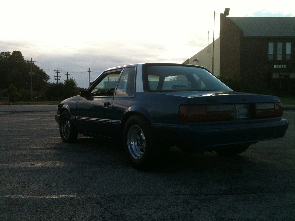

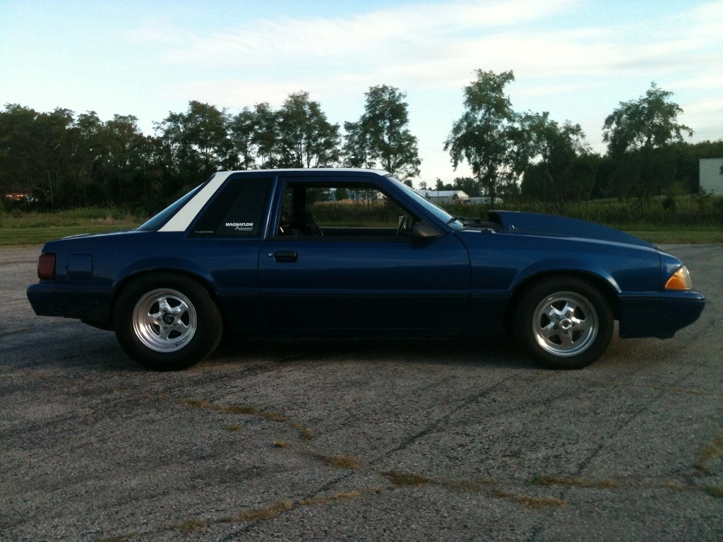

Recent pics of the 88, still kind of suck but its an iPhone 3Gs so its seen better days...
You can see a little bit of wheel well rust as well as a little rocker rust, mostly a clean car, but little things like that really bother me after my last car. and 275s really throw up the dirt on a car with a little rear bumper
Sits a little higher in the front with the 90/10s and the rear end is WAY stiff, need to get to adjusting but all thats been put on hold while the old red sled is making its way up from Georgia.

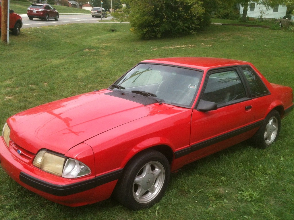

Onto the red car:

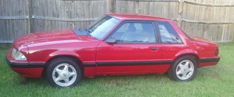

1992 4cyl coupe, clean rust free accident free car from Georgia, painted Ford Lightning red
came with the following:
Full Mallory Ignition System
battery relocation
gauge set (water, oil, a/f and tach)
3 core aluminum radiator
130amp 1-wire Alt
stock C5 transmission and custom driveshaft

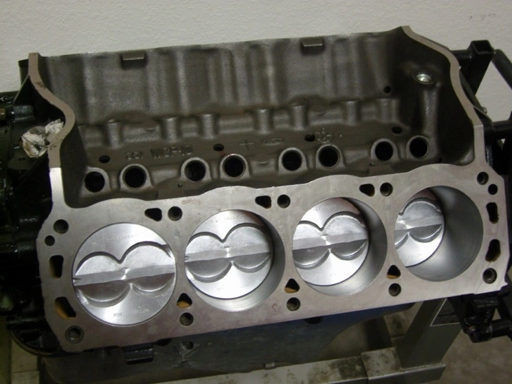

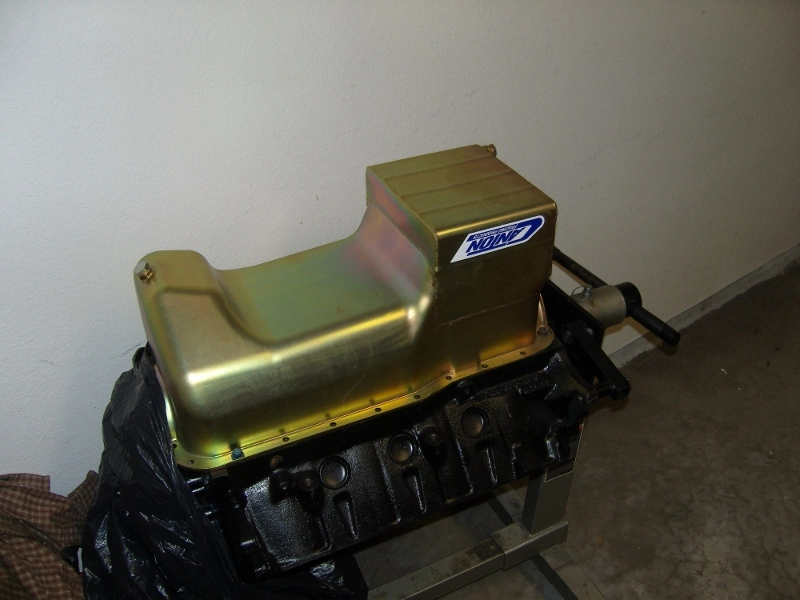

Also picked up a 398w:
Balanced and block decked
393 stroker kit, .060 over
3.850" crank
stock style 5.9" rods,
and flat top .060 over pistons with reliefs
Compcams xe284H cam
canton 7qt pan
will be 11:1 with 64cc heads (need to pick up a set of heads)

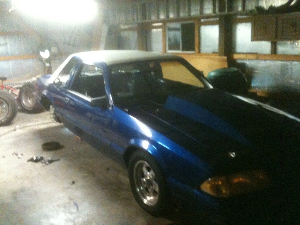

Day 2: already on jack stands :)
Once the red car gets here, things should get rolling pretty quickly so ill try to stay up with this thread. And yes the car is dirty, wanted to snap some bigger pictures and didnt have the time to clean it before the sun went down. She'll get a good cleaning one of these days

im positive the 284h is a flat tappet camshaft, so im sure it is. (i wont have the red car or the motor to my house until next week but i do own them). not really sure if ill stick with it for the time being or tear it down and convert it. You can do plenty well on a flat tappet motor but the risk of wiping out the cam lobes due to using the wrong oil or an error is almost more than i want to worry about. 11:1 isnt going to fly on an iron headed motor (no where to get race gas on a regular basis and i have no interest in a motor i cant run on pump gas) so im going to have to look for a set of AFRs or TFS heads. It isnt going to see over 6k rpms due to the cast crank but otherwise it should be a pretty healthy running car when all is said and done. Just happy to have a mustang or two to wrench on and finally felt like spending the money to have something im proud of. Not something I could say about the GT.

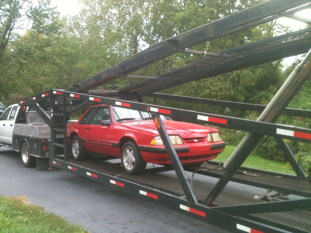

welp, the red car and engine were supposed to arrive today but after talking to the truck driver, it wont be here until thursday afternoon.
He had a pretty strange accident within the family that resulted in a death, told him not to worry about it and turn it around and head home if need be. Its only a car, there are more important things in life...
On a lighter note, im looking for a set of AFR 205's or a set of comparable TFS heads. The 225s were looking good but flow-wise the 205s are the same below .600 and this cams only going to be in the .550 range with 1.7s anyways so it seems like a waste of additional money. Trying to decide what to do in terms of a transmission as well. No real interest in building the c5 (takes the same internal mods as a c4 or a c6, dont really remember). Just never been a fan of auto cars regardless of their efficiency. So ill have an auto trans and custom driveshaft to sell at some point :shrug:. A t-5 isnt going to cut it so ill have to look elsewhere. Otherwise its a matter of swapping the rear end, suspension, 5 lug conv, and interior and we'll be rolling :nice:

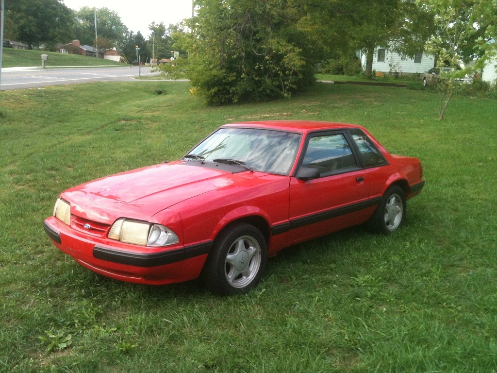

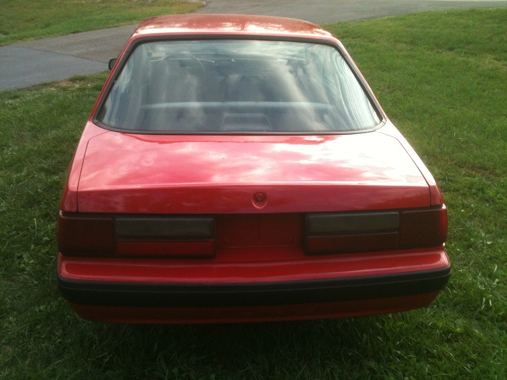

The red '92 showed up today, pretty excited to be honest. Not for what the car is but for its potential.

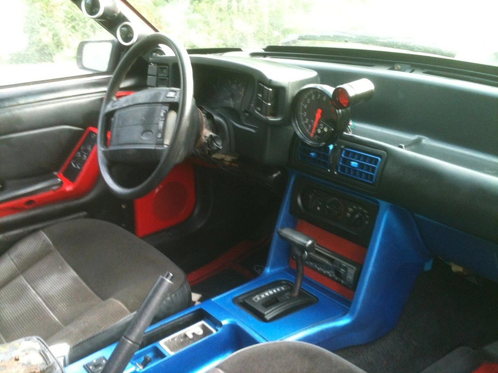

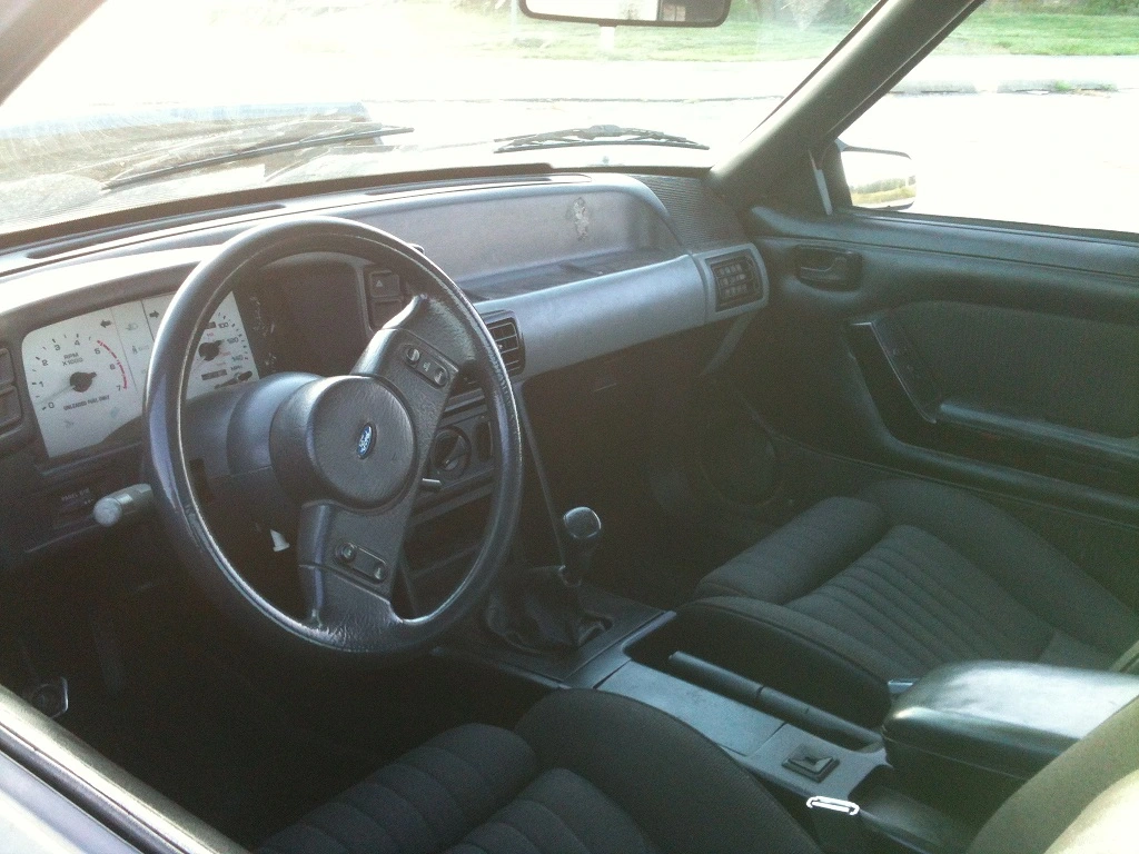

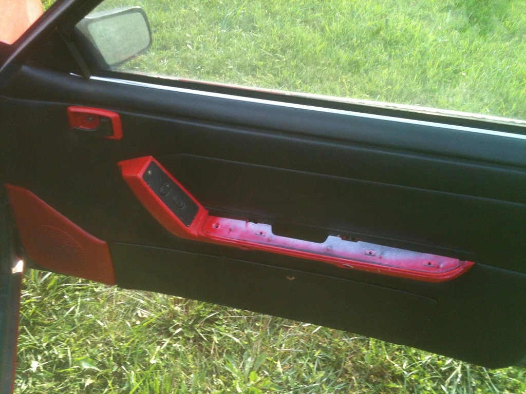

The interior is Absolutely hideous, but with a little paint will be perfect. The car needs headlights badly and the passenger side trim piece (came with car). otherwise its entirely what i was looking for. all the trim thats missing in the pictures came with it as well, just needs painted as we had clearly different ideas on the color scheme.
Ready to get to work!

Thanks. New headlights, different wheels and a good deep cleaning and itll be a whole new car. Its just nice to know that anything that needs replaced I dont have to go out and search for.

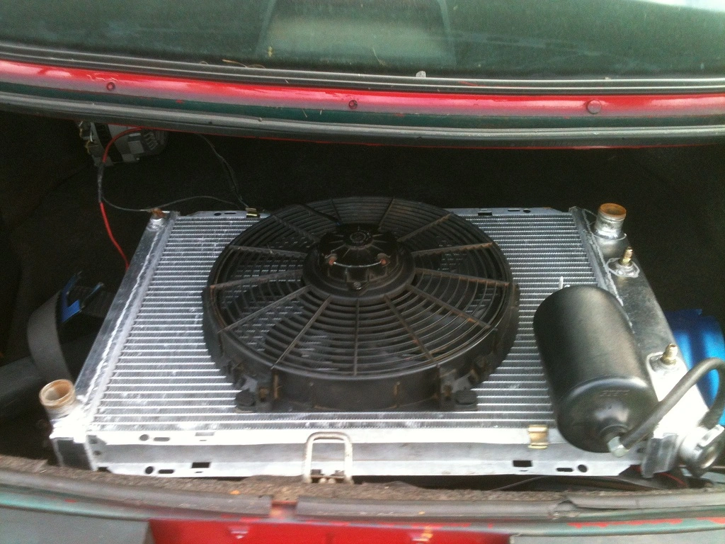

Umm, monster tach with a shiftlight on a 4-banger?:scratch: PO must have been very confused...
its a 398w that was at one time running in the car, so not so much confused :nice:
still not a fan of the tach.

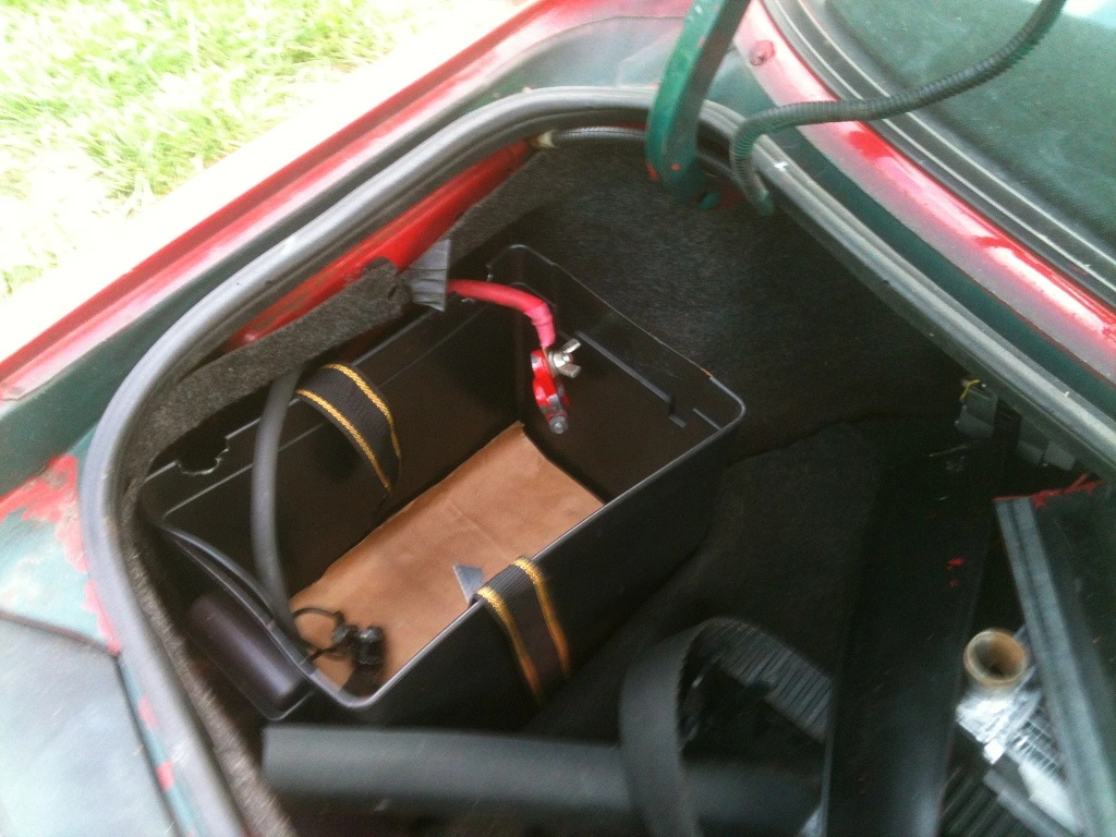

Relocated Rad in trunk:scratch: ! FTMFW
Scott
its far from a show car but paint wise much better than my past foxes. and the radiator is obviously in the trunk to keep the spare tire cool....kinda thought that was obvious :nonono:
