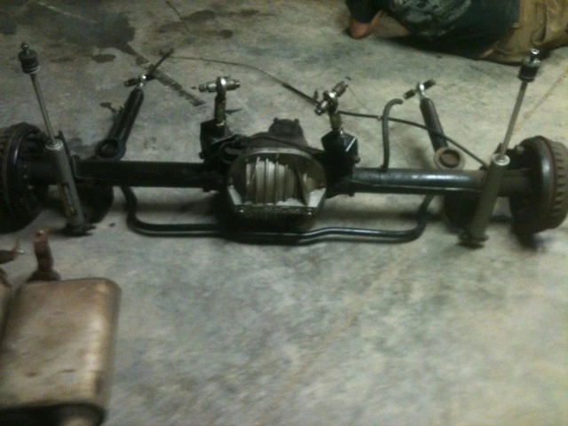

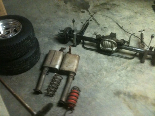

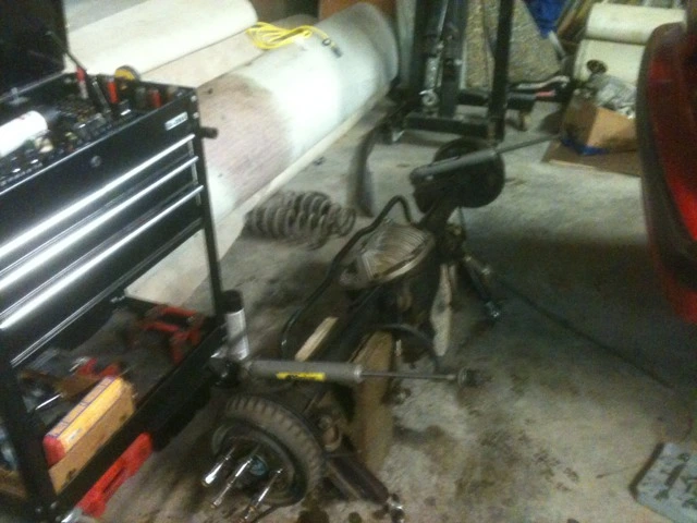

Got the built 8.8 pulled, cleaned and ready to go in old red.
Got the 7.5 (shut up it has 3.73s, someone will be happy) pulled and installed into the blue car.

FYI, the 4cyl cars run the brake lines to the wheel cylinder completely differently than the 5.0 cars do. The banjo bolt is a different style and the 4cyl one is mounted to the axle housing whereas the 5.0 is mounted above the rear end on the underside of the car. Easiest way to switch these is to remove the brake lines and brackets and swap the whole assembly over to each respective car. My situation is a little different as I have 2 complete cars to make it simple. The red car won't have "true" v8 brake configuration on the rear but I'm not splitting hairs. There will be plenty more little differences as I progress and ill try to point them out.

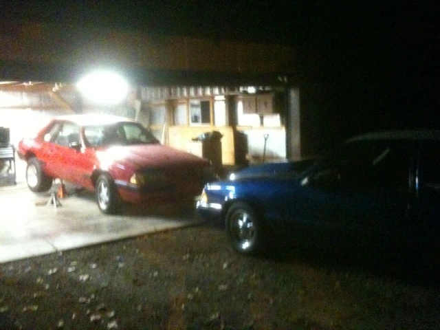

On a side note, and this has happened 3 or 4 times now,Actually came home from work today to find some guy trying to pry the hood open on the red car because he thought it was for sale. Got him out of my yard as fast as possible while getting him interested in the blue car.

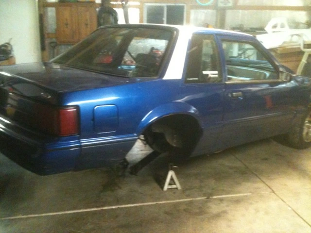

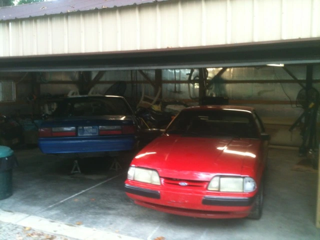

For some reason, after a long hiatus, 2 coupes torn down in a garage piled with parts really gave my inner child a chub :D

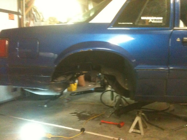

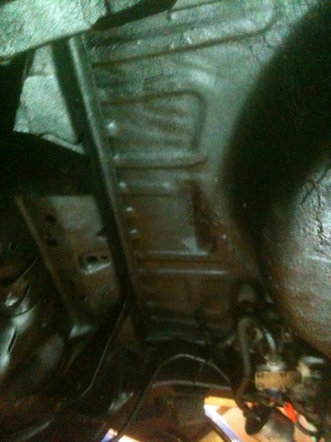

Underside was in great shape, just a bit dirty
Undercoat laid down impressively well, time will tell how it holds up.
New fluid, coated and resealed
Gotta roll the fenders before the new rear end goes in, and figured it'd be smart to wait on the drag springs anyhow
This was just a weird sight... But the v8 coils were already cut (explains why the rear end was ungodly stiff and going to be useless at the track) so they got put back in because let's face it, no ones going to buy a stock height coupe, it's just unnatural.

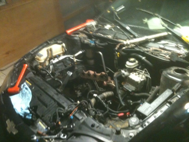

This guy right here is what ruins my day. Between a 40+ hour work week and other side work, still have to get an ecotec thrown back in this thing. Really cuts down on quality time with the mustangs.

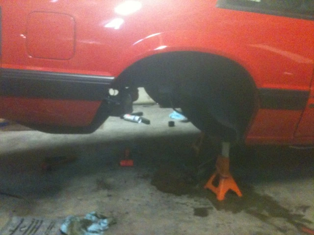

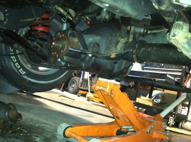

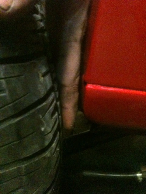

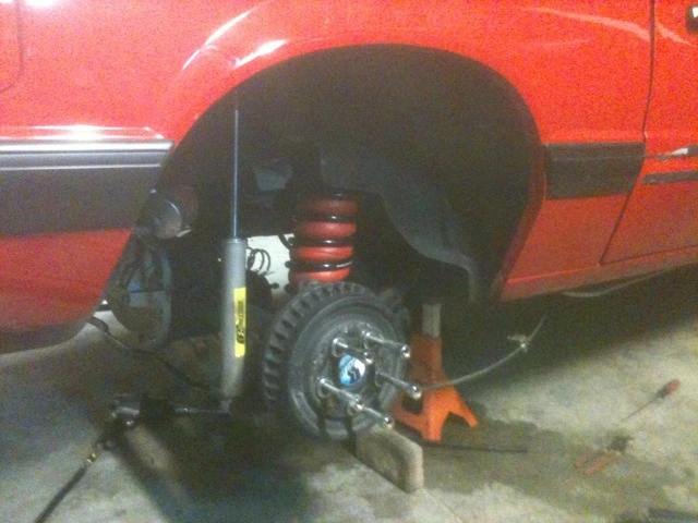

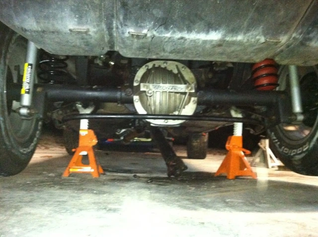

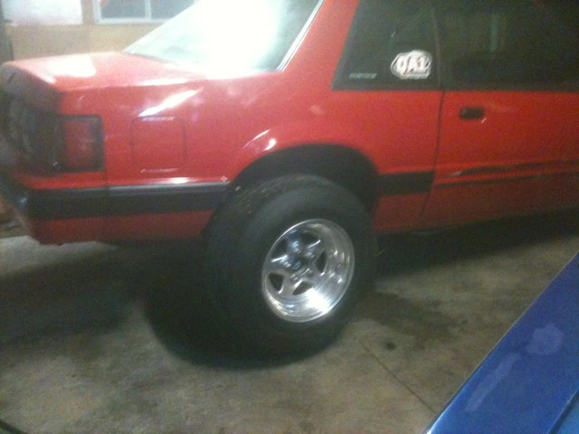

Rear end is in the red car. Having never owned a fox that didn't have at least surface rust and all the bolts welded in by Mother Nature, it's great to be able to slide new parts in on this car. Brake lines are swapped, just have to run a new line on the red car. Only issue now, that you'll note in the pictures. Is the tires don't clear on the red car so off jackstands it's still held up by the bfg's. going to need wheel spacers, as I've already folded in the inner wheel well and can't do anymore without bending it back into the springs. The Moroso trick springs were a bit of a pain, as the passenger coil is shorter by almost 2 coils, it's also a stiffer spring and was a bit difficult to install. Ended up dropping the lower control arms back out and then jacking it all back into place.

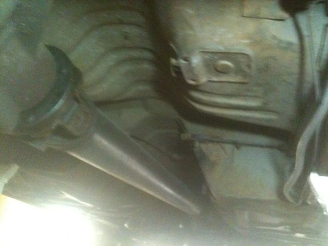

The control arms all need adjusted, the wheel is sitting far too close to the front of the wheel well, and the rear end is pulled far enough forward that the driveshaft can't line up. Does anyone know if the housings between the 7.5 and the 8.8 are the same deminsions or at least the same length from the cover to the pinion? This custom shaft may not fit on the 8.8, although i believe it will with some work. Otherwise I'm happy to have a big part of the swap finished.

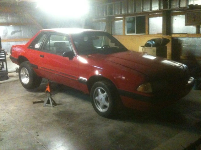

Oh it's sat down. 5/16 spacers and a little more massaging did the trick. Won't know where the control arms need to be til I've actually driven it. The springs haven't settled so it still sits HIGH, but we're function>looks at this point so I'm not upset. Taking a little break, have the front ends torn down on both cars and the coil overs assembled. It slipped my mind that the brakes are entirely different so we have to swap it all.

As for the cavalier, it's an 03 and the 03s and older have a timing chain tensioner that has since been recalled. The tensioner doesn't get enough oil pressure at idle, the chain went slack, it jumped time and smashed up the valves. It's seriously close to the same money to just swap motors
