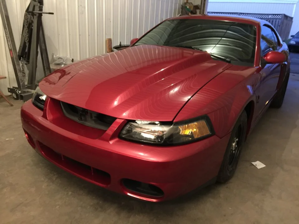

No secrets here! it's just not a 79-95 and will be pushrod powa'd.
But it will have AC and power steering so that's gotta give me some kind of credit

Wanting to get the car running as reliably as possible before the fun really starts. Planning to build a pushrod version of the terminator pretty much.

I love this body style. Where is the motor coming from? Lets get this thing started.

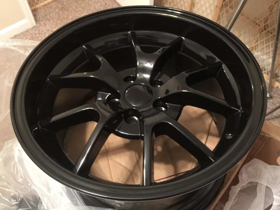

Ordered black 18" FR500s to replace the ugly draglites so my back room has become a parts warehouse. Got some floor mats I'm way too excited about too.

Those are the wheels I want on my fox. When I had my 01gt i had a set of rear 18x10s and was just looking for a front 17x9 before I ended up selling the whole car.

I'm all good with it, unless you're gonna tell me that there is a running, blown termi still under that hood.
Most definitely not. This car is an honest 9.5/10, even I could never do that to a running, driving car. Bought it as a roller, wrestled with the idea of a coyote swap. Priced a stock coyote swap, decision got a lot easier
