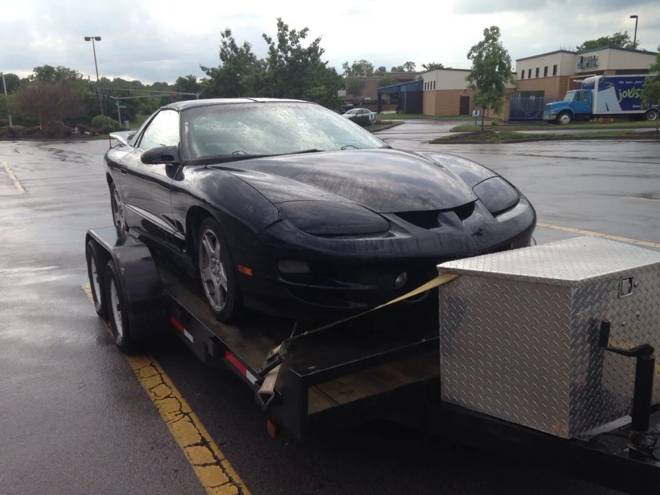

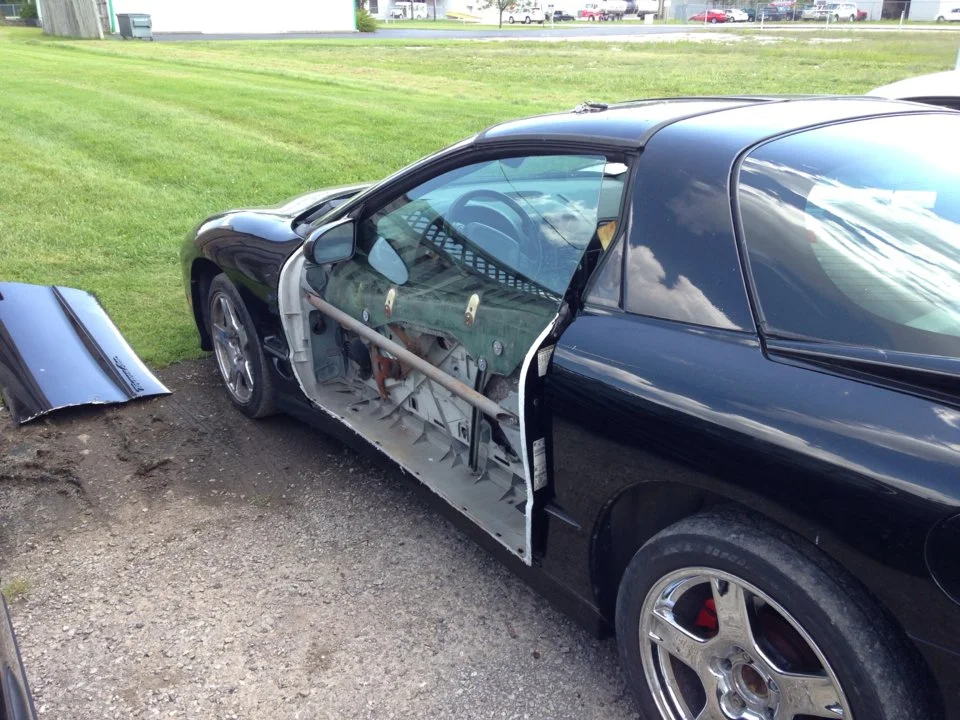

With a little work it'd be almost too nice to part out.

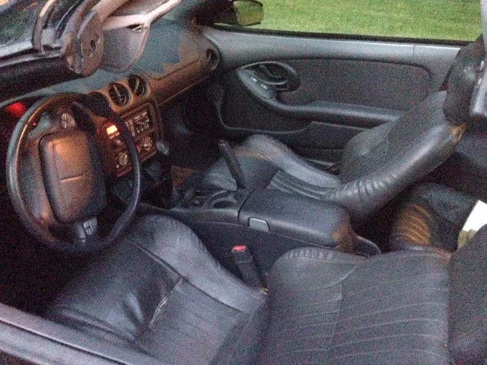

Needs a drivers seat, two fenders and a drivers side door skin.
Reactions: Noobz347
dayum that is pretty clean little car there. Used to be one of my favorite trans ams. Can't get an abandoned title for it?
I love the car, which I didn't think I would. It needs some parts I'm gonna try and track down.
Going to try that route, although it has an active title now. They left a ton of drugs in the car and I think are weary of claiming it.
Otherwise there's a few other things we'll try. I'd truly like to keep it whole because it's fun to drive but it was bought for a purpose so it's just fine to tear it apart.

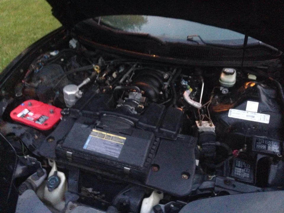

I truly enjoyed the th400 but I'd like to build a fun little cruiser. Going to pull and freshen up the LS1 and really take my time on this one. May end up ditching the big/littles for street wheels but they look so damn good IMO.
Trying to figure out if I can use these fbody pedals or if I need to track down turbo coupe pedals.
Hopefully I just need pedals, a fuel pump and another driveshaft to get this thing goin.

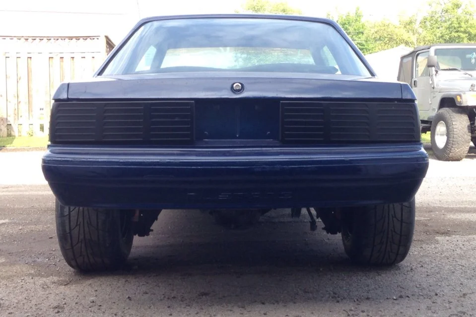

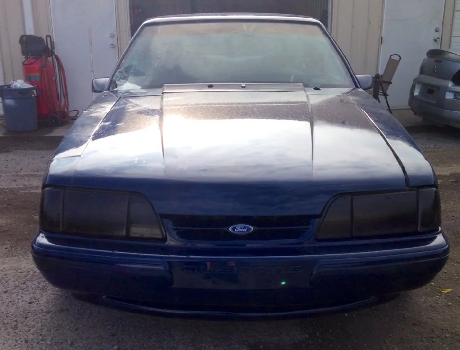

Hood alignment is currently god awful

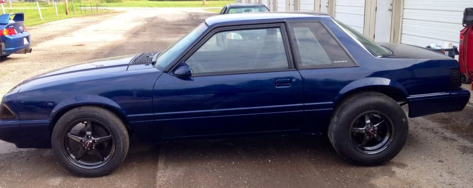

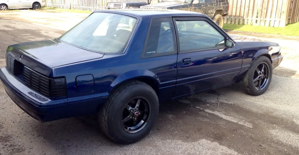

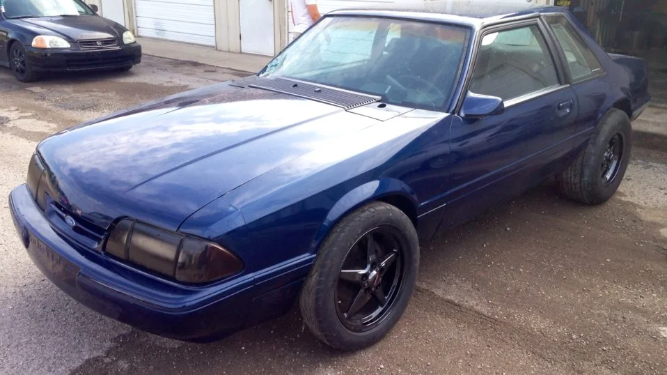

The wheels look all wrong on that car. The BS/Offset's have the fronts sticking too far outboard, and the rears look like you're trying to emulate some 60's altered wheelbase thing.

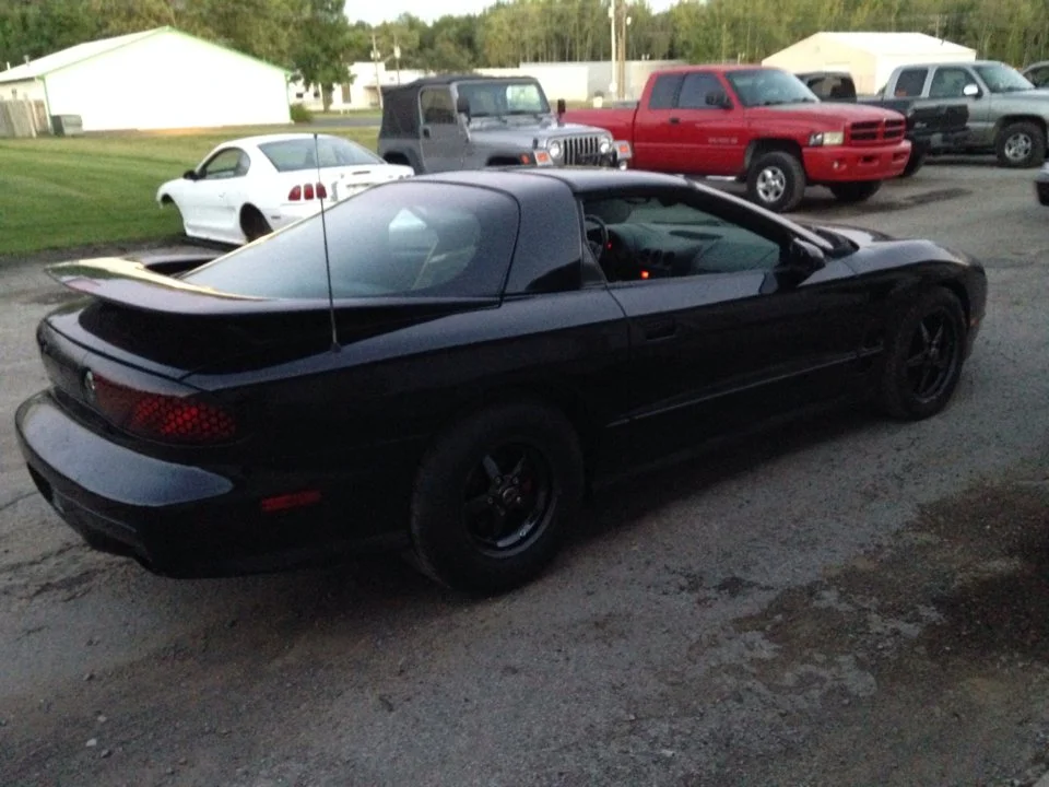

If that T/A is resellable, wouldn't it fetch more running, w/ the odds, and ends fixed, and a new drivers' door than it would as a non-running shell?

The dark stars were bolted to the fox without the correct spacers. Due to the "non-mustang" BS they set too far in. Like they did on the last car. The fronts sit so far out because the whole front suspension is SN95 and therefor wider. Was a risk of trying to use SN arms and spindles. The wheels have been removed.
The TA cannot be titled (or so i was told when purchased). I got an extremely good deal, as its intended to be a parts car. I always care about cash

The dark stars were bolted to the fox without the correct spacers in the rear. Due to the "non-mustang" 7.5 BS they set too far in. Like they did on the last car but was easy to correct with a wider car. They don't work on a fox. The fronts sit so far out because the whole front suspension is SN95 and therefor wider. Was a risk of trying to use SN arms and spindles. The wheels have been removed.

The TA cannot be titled (or so i was told when purchased). I am going to briefly pursue a title because its got a ton of potential and would be a nice flip if a clean title could be produced. The drivers door skin has completely separated from the frame, the drivers seat is snapped in half. The hatch struts are blown out, there's a handful of dents in both quarters and it looks like its been keyed at some point. Indecisive and impulsive, I am. An idiot I am not.
