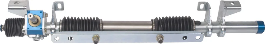

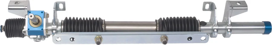

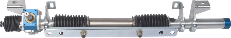

Great - can you advise whether it is thought the '66 TCP brackets will fit, or will I need to use the '67 TCP eccentric compatible brackets ?
The outer frame rail brackets have about a 1/4" slot that allow the rack to be shifted fore and aft. That allows for some variance in the thickness of the hardware on the backside of the lower control arm mount. The brackets are really designed to be used with a 1/4" thick washer or eccentric eliminator plate on the backside of the lower control arm bracket but the slots will allow the rack to bolt up tightly without one. Omitting the spacer is okay as long as the rack brackets still seat squarely against the frame rails. The rack's lower control arm brackets are secured to the rack tube with double-split collar clamps allowing the bolt's lateral position to be adjusted for camber.
The short answer: Yes, you can use the vario centric kit with the TCP rack. It just adds the camber adjustment feature of the '67 and later vehicles. We use the exact same rack and brackets for a '65-66 as we do for a '67-70. The inner brackets are just swapped from left to right to adjust to the longer '67 and later arms.
