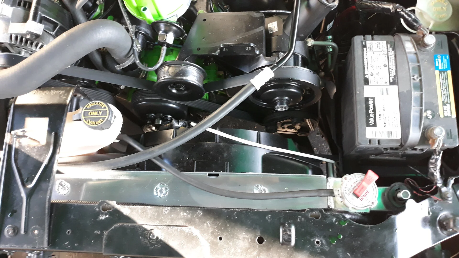

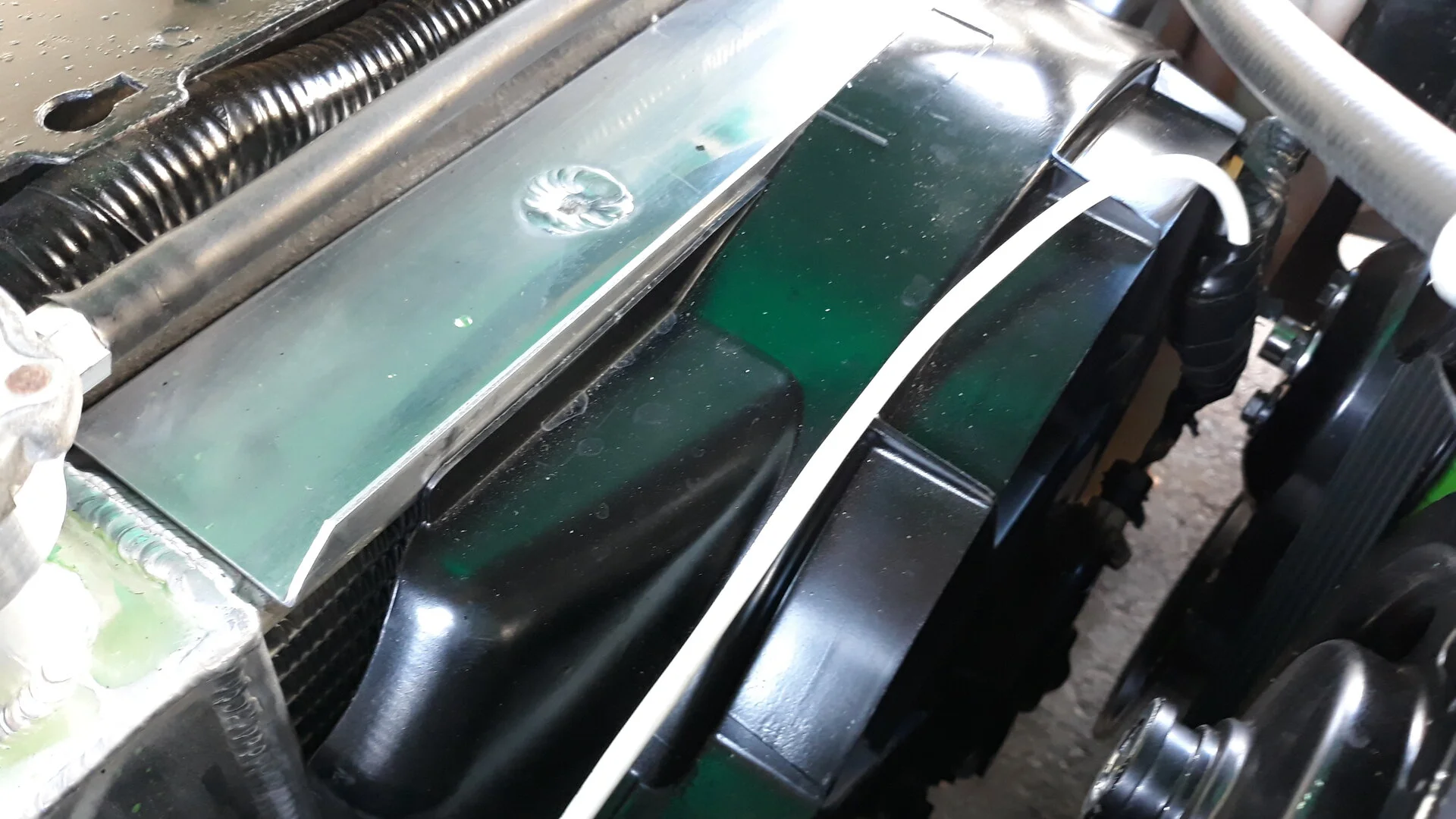

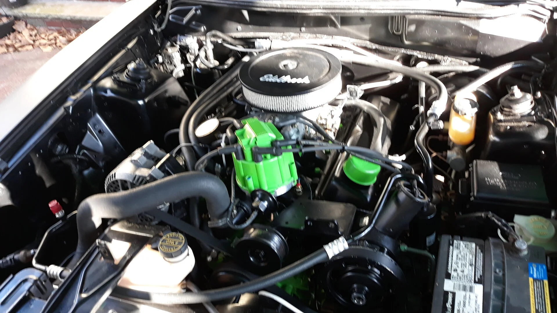

Is temp from factory gauge or from infrared temp tester on rad tank or aftermarket gauge? If aftermarket gauge, where is the sensor located?
Pics of rad and fan setup always help us diagnose.

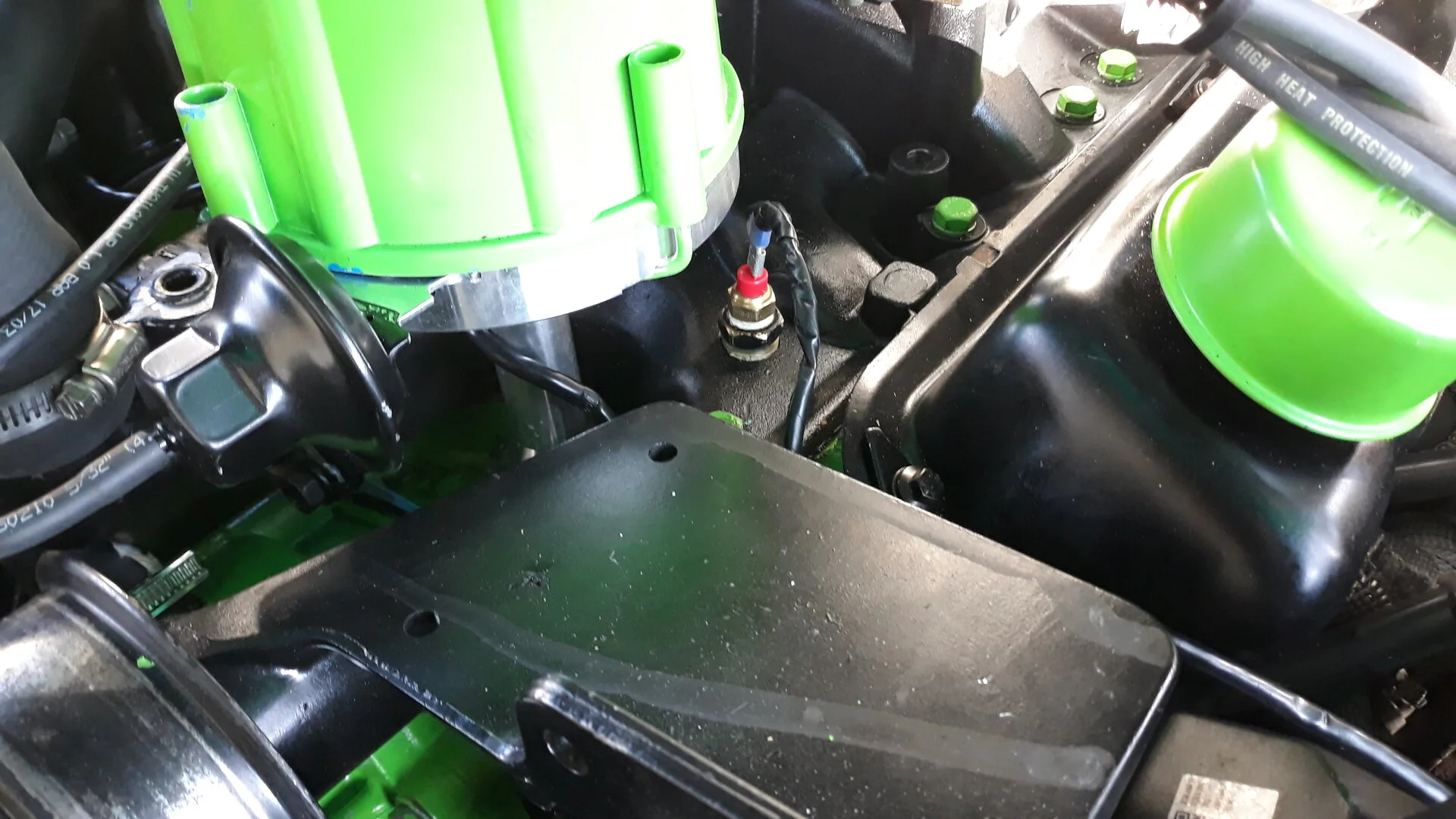

So... pic 1, is that your gauge sensor or fan controller sensor? (or are you still running fan through V6 engine computer).
So your 210 temp reading... is that on factory gauge, aftermarket gauge or using some hand held temperature reader testing discharge side radiator tank?
As you said above stock V6 e-fan wired to run constant with key on. When you are seeing 210 temp, what is temp of air coming from fan (does it feel warm or cool)? With an e-fan running all the time, I would expect it to barely keep engine at thermostat temp.
Pic 1 is a jegs aftermarket gauge sensor ...fan was just tapped into to run at key start.

So at that temp, is the air discharging from the fan warm or cool? Is upper rad hose firm and warm to hot in temp?
