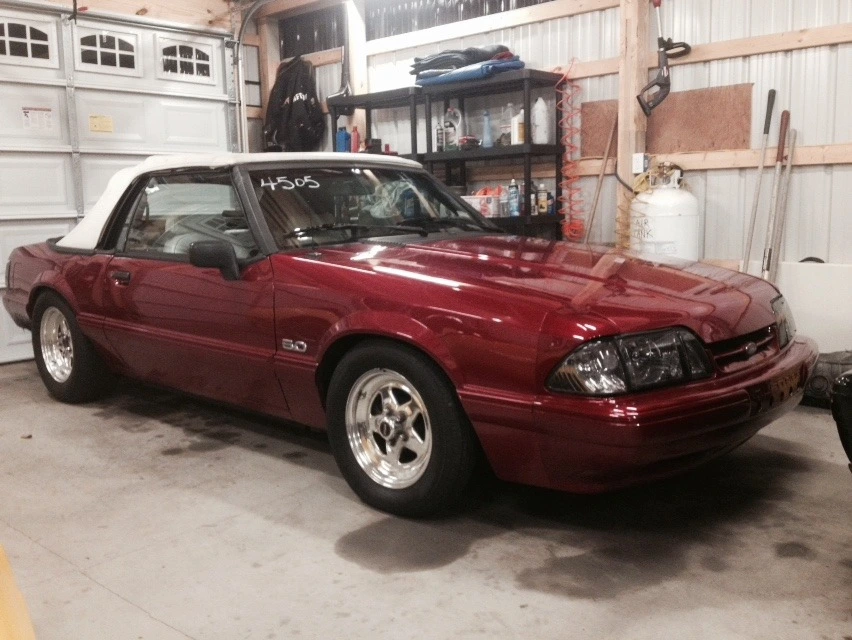

yep, Capitol raceway was open today. Son took his vert. She ran 13.82 @ 101mph. 60' 1.93
Picture didn't come up...but if it was red with a white top I may have seen it... Anyway, there was a clean one at the Wawa with pro stars looking pretty good. Had no idea the track was open or I would've swung in. Smh
Ha...I saw it. I was parked beside it. Lol...with my wife and two Chihuahuas. Lol. That car is nice. Beautiful color too...if only the pics would work. smh

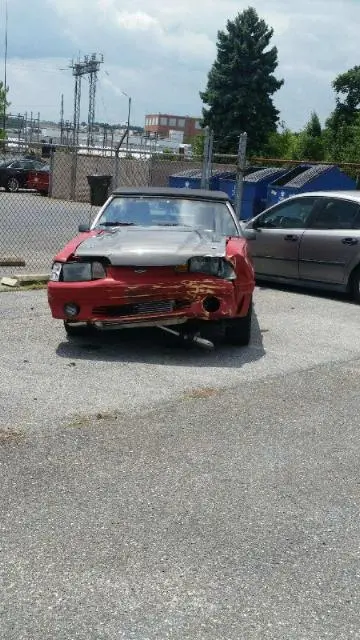

Oh man thank god i didnt trade him...he would have gotten the better end of the deal...The guy i traded my car to totaled it in a few weeks...i was pissed but hey it wasnt mine anymore....Im guessing the car had to much power for him...
