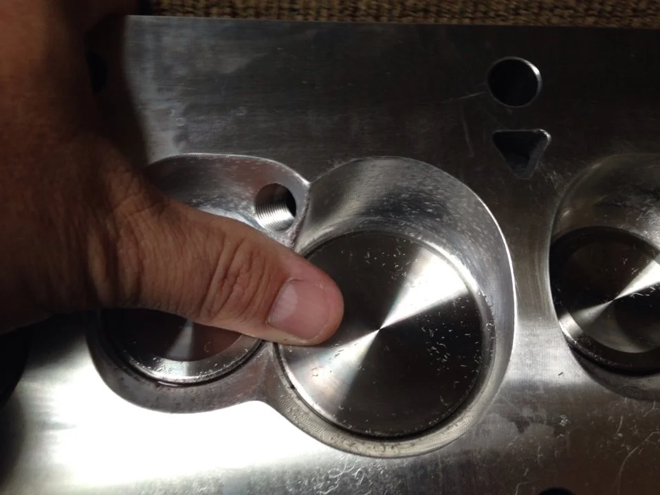

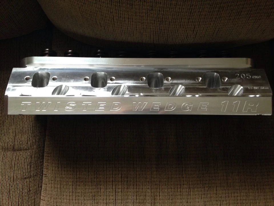

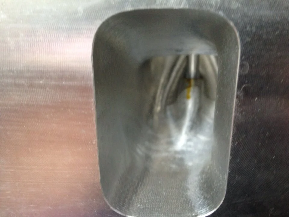

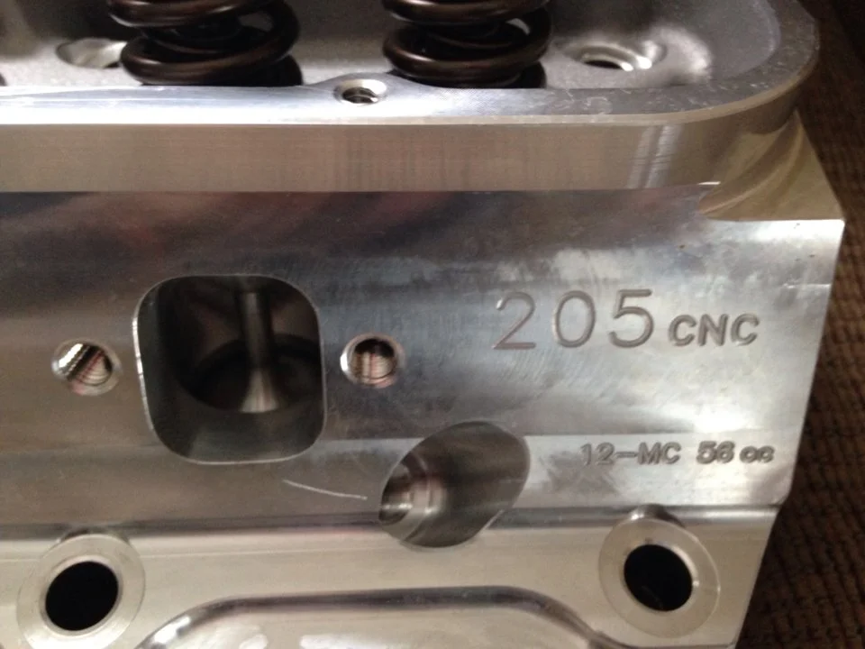

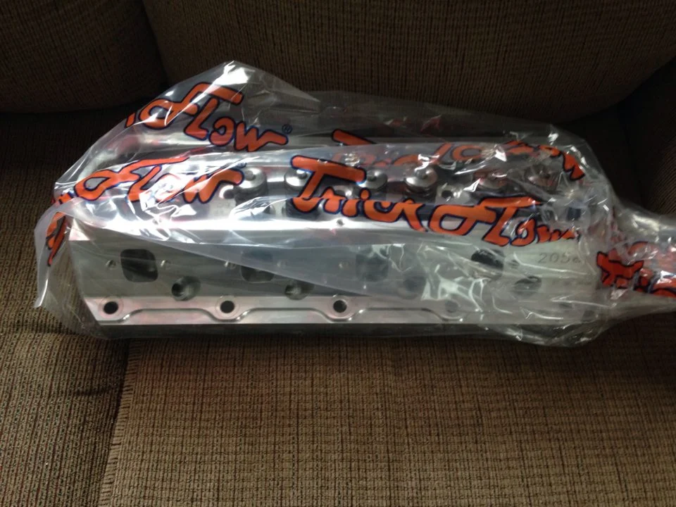

Well got the heads this morning! Here's some pics!
