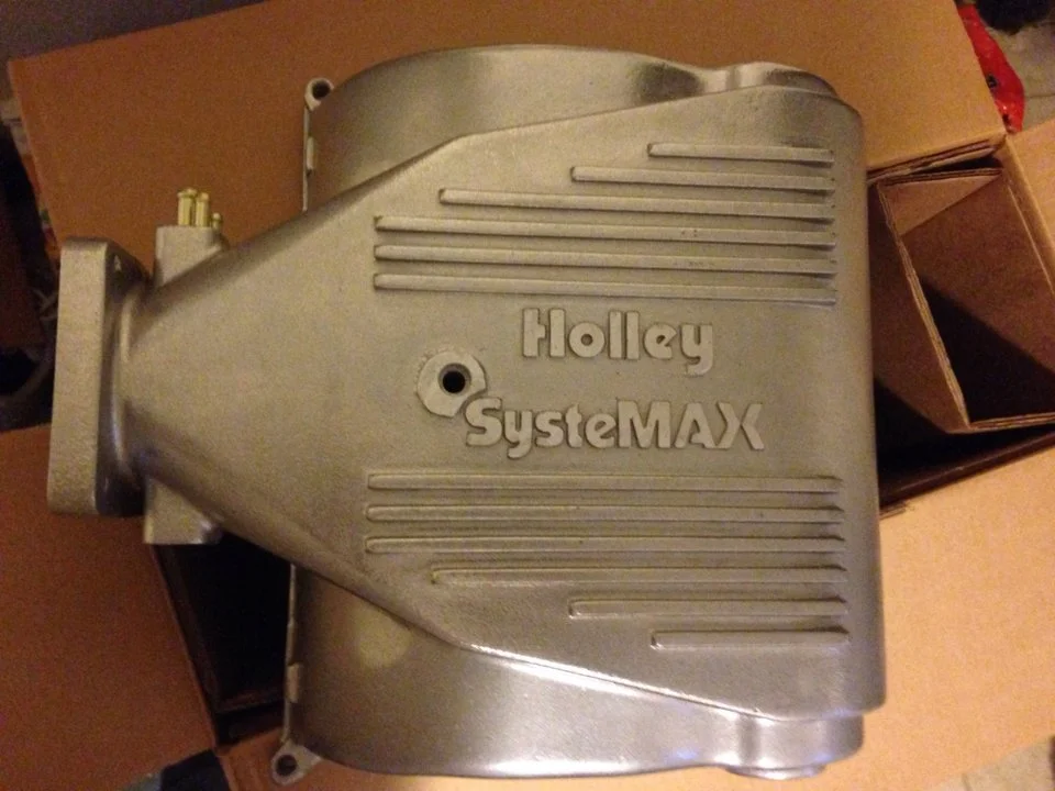

Heads up on the Systemaxx: I just installed it and I keep finding oil puddle just behind the TB each time I take it off. At first I thought it was from my modified valve cover baffle, but after some Google research I found it is a common problem.
All the vacuum fittings are in the throat right behind the throttle body. Couple that with the "hill" just inside the intake and the oil has a hard time making it into the runners and combusting. Apparently, according to the post I read, it is normal for a small amount of oil to be sucked up through the pcv valve.
The solution is either an oil catch online from the pcv to intake, or the relocating of the vacuum fitting further along in the intake. Apparently the freeze plug is a popular location for a new fitting, as it offers no permanent modification to the intake.

Yup . I was sucking oil like crazy . I just deleted the pcv with the blower and vented it .
