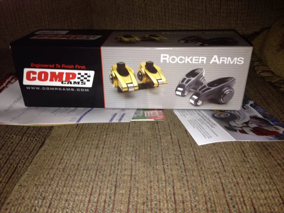

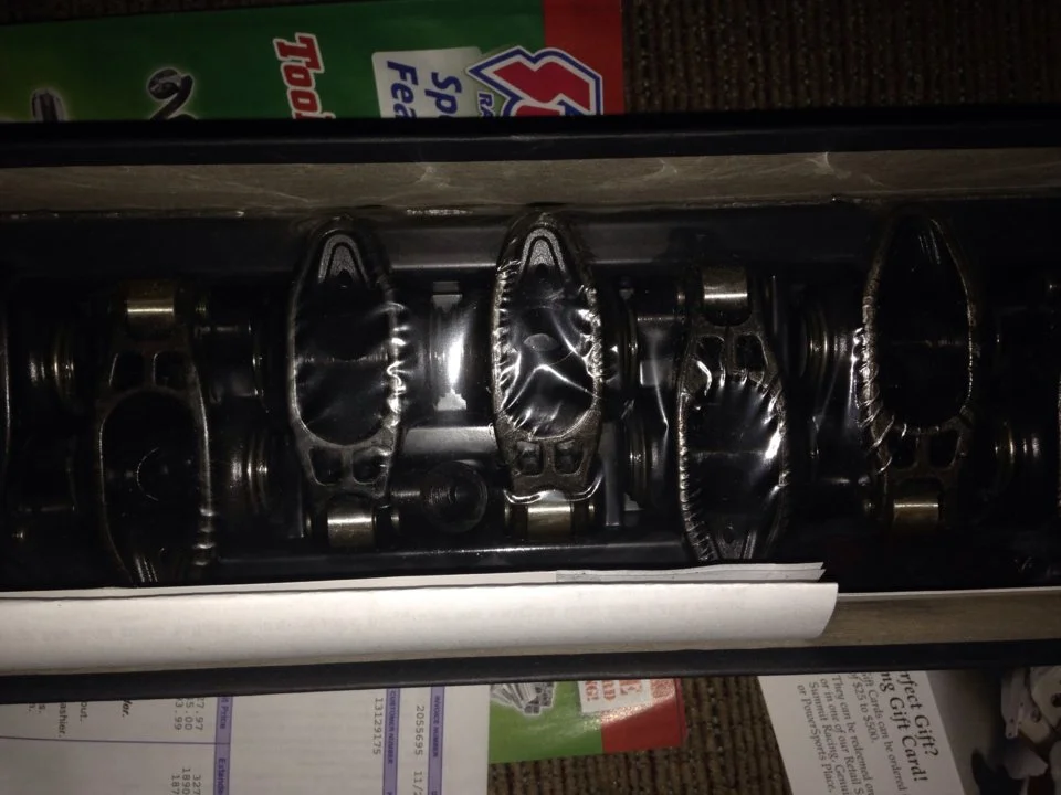

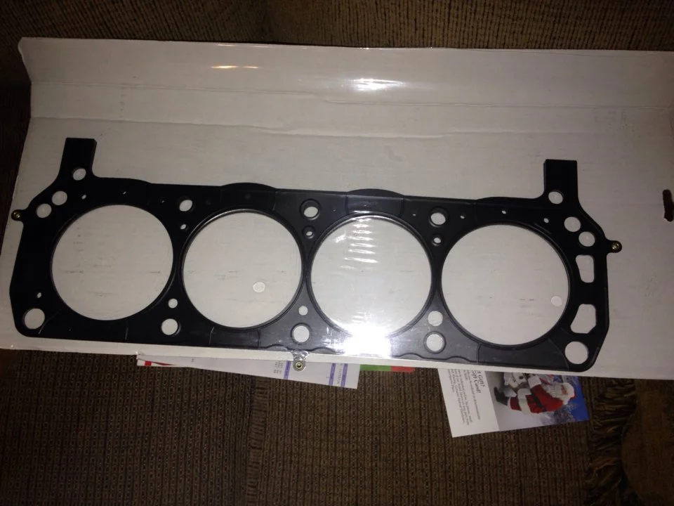

Finally got these tonight
Reactions: stangboy
Good choice on parts man. Should be a nice build. I tried to use all good stuff too, just couldn't afford the Dart block.
Joe
Thanks. I'm in the same situation. I've been wanting/waiting to do a dart build but crap keeps turning up(I have college kids lol). Figured I'd use my "future" funds for some right now fun. Start saving again for the shortblock/trans. I have spent most of the $ but have a little left and of course have some tax return $ coming in a few months so this project will get done by spring/early summer. I also am redoing the suspension and rearend.
