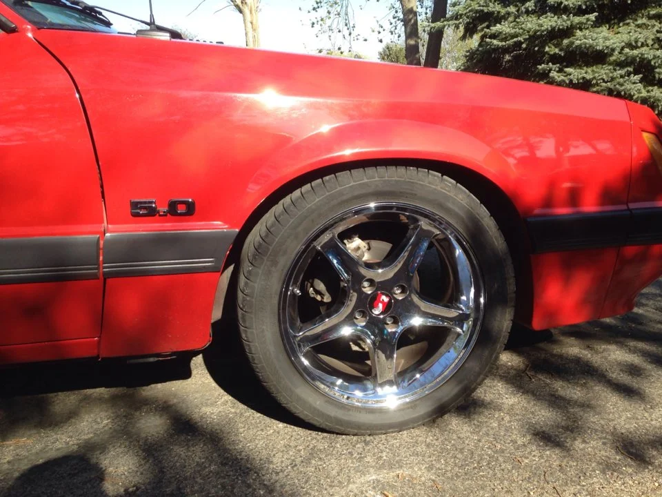

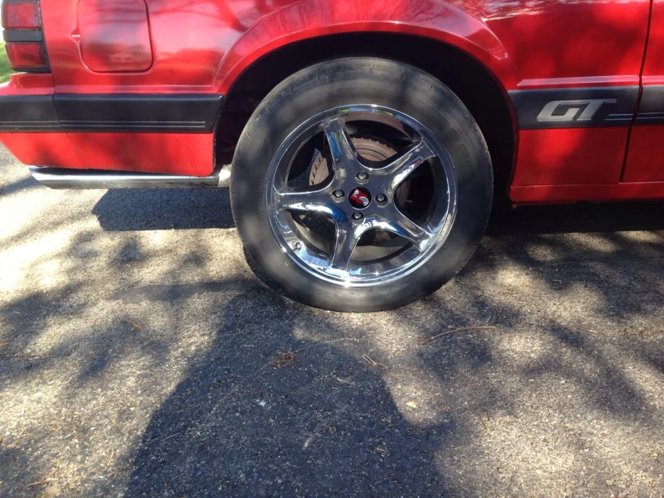

Yes the isolators are still in. I just thought they would sit a touch lower. They look a little high with the 17x9 Cobra's and 275 NIttos. Eventually going to a 28" MT tire on a 15x10 wheel for track duty. I actually was surprised at how well this suspension works. Going to be reeaaalll nice at the track with a good tire. I did a few launches out on A back road and it basically hooked with a small chirp and full air pressure in the tires. Night and day difference and the ride is actually softer than before. It's still a mustang quality ride but better. The struts are set at 6 right now. Going to be fun to play with adjustments.Still got the isolators out back? Taking them out will bring it down between 1/2 and 3/4 inch. Iirc, those springs are oriented towards drag cars, and probably would look better with a bigger (taller) tire in the well.

I can take out the isolators and drop it 1/2" or so. After driving it they've settled a little also. They are sitting just about stock height. I want to raise the front about 1/4-1/2" and even it out a little more. I like the quality of "ride" I'm getting. I'll try and take a new pic and show what it looks like. It's not as bad as that pic looks.Wow you're stink buggin a little bit there. Can you cut a 1/4 coil off to fix that without messing up the function of the rear springs? I've heard of people doing that with drag springs with success (or so they say).

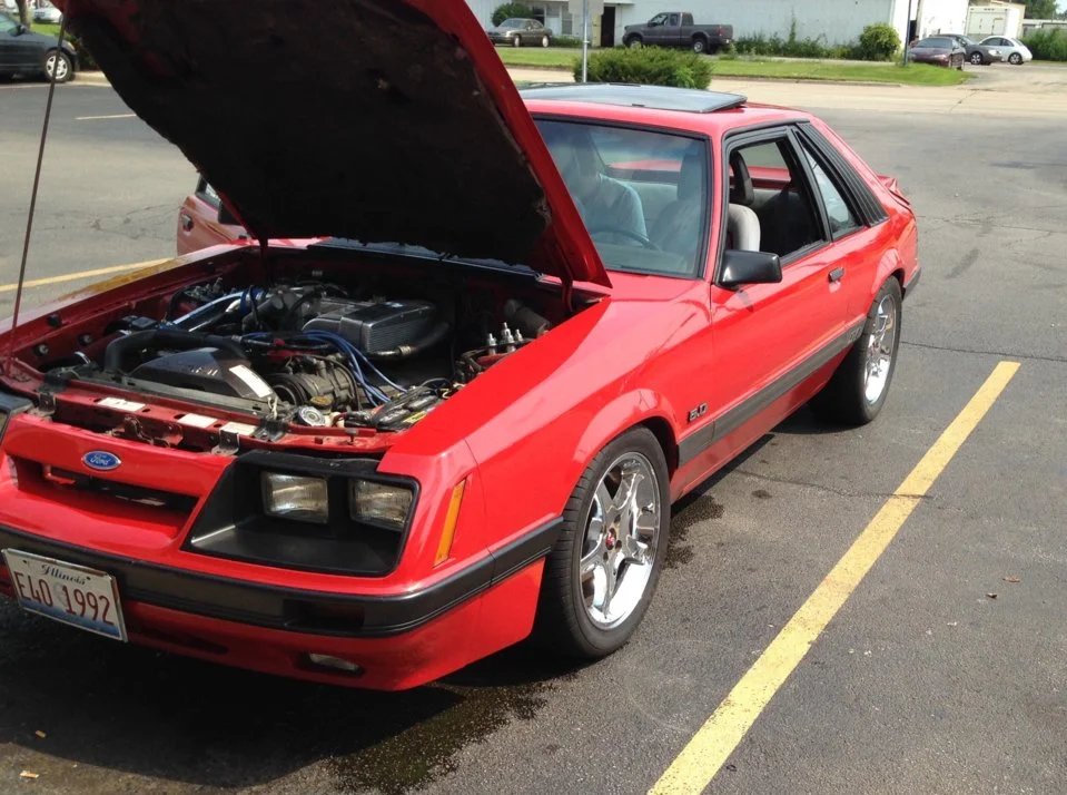

which t/b do you have? i had a holley billet for all of three days that did that same crap before i took it back and bought a 65mm bbk off a guy at work. ive seen postings since then about the same issue, not that they make em anymore.. I've messed with this throttle linkage a few times. I thought it was fixed. The actual throttle body sticks every once in awhile at wot. I can manually open it and it does it by hand. When I pull all the topend off ill double check but I believe it's the actual TB sticks.
Thanks and I already have purchased a 75mm AccufabSorry to hear that, guess a new TB should be part of the plan, good luck on the finalizing
I actually thought it was a BBK but it's a Professional Products TB(it came with the car)which t/b do you have? i had a holley billet for all of three days that did that same crap before i took it back and bought a 65mm bbk off a guy at work. ive seen postings since then about the same issue, not that they make em anymore.
