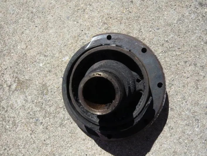

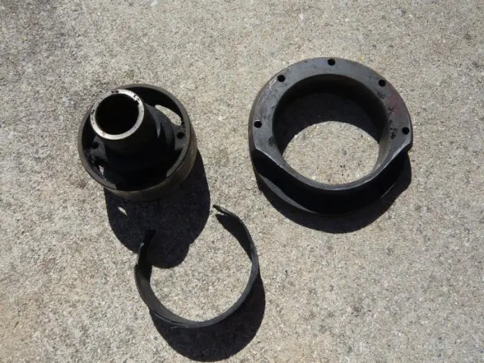

Today I discovered where the slight vibration in my '94 GT was coming from...the harmonic balancer had decided to come apart @ 225,000 miles.
A search of the forums, following a few links here and there and I had the info I needed to tackle this job. I picked up a Pioneer non-SFI HB at one of the local auto parts store and then I went to the other one to rent the HB puller.
About 3 hours later and my 5.0 is back rolling down the highway without that annoying vibration I would get at certain RPMs that would tend to get better when I would let off the throttle and coast at certain speeds on the highway.
Thanks :SNSign: you guys totally rock :nice:
I've attached some pics of the old harmonic balancer, as you can see, it was in serious need of replacement.

That's gotta be the most skank balancer I seen yet.... :nice:

As for the balancer, surprised yours lasted as long as it did. I normally post up the after pics of my HB but youve definitely got me beat. :jaw:
