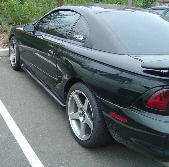

hey, i have h&r supersports springs, tokico non-adjustable shocks/struts, and steeda c/c plates. you're probably going to need shorter endlinks too, cuz the stock ones are too long.
eibach sportlines 1.8/2.0", h&r supersport 1.75/1.6". front/back
the h&r are very sensitive compared to the sportlines, at least in my case. when i swapped the sportlines with the supersports, i thought there was something wrong with the tires or something, you can feel every bump in the road, but i got used to them quickly. but for either, theres a lot of jumping around at high speed when i hit small bumps and stuff on those crappy LA freeways.
if u want the rear that much higher, i guess u could get those adjustable lca's from mm or steeda, but the rears sit slightly higher with both springs.
for both it wouldnt make it up a normal driveway straight without scraping that plastic "scrape bar" thing on the bottom of the bumper (dunno y they even put it there). but it's not too much of an issue, i only need to barely turn sideways.
also, when i ordered the h&rs the guy said something like, "h&r are higher quality, made in germany". on the eibach springs it said: "MADE IN GERMANY". eh, salesmen.
i'll try to get some pics up.
