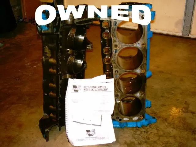

I know of a couple of guys that have well over 400rwhp and their blocks are hanging in there. They all say that they're running safe tunes and are keeping the rpms below 6000. Most guys i talk to seem to think its the high rpms that kill the blocks more than high horsepower.
Holy crap!!! I've seen 302's cracked down the middle but never split in half... must have been one hell of a 1/4 mile run!
