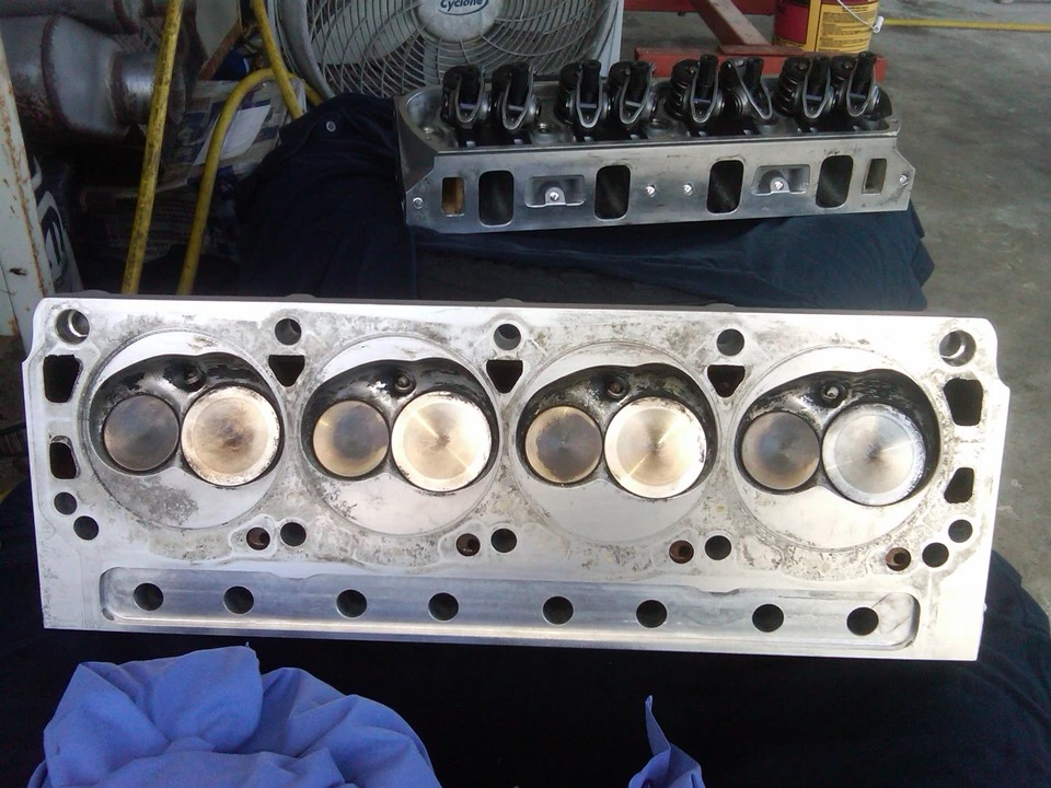

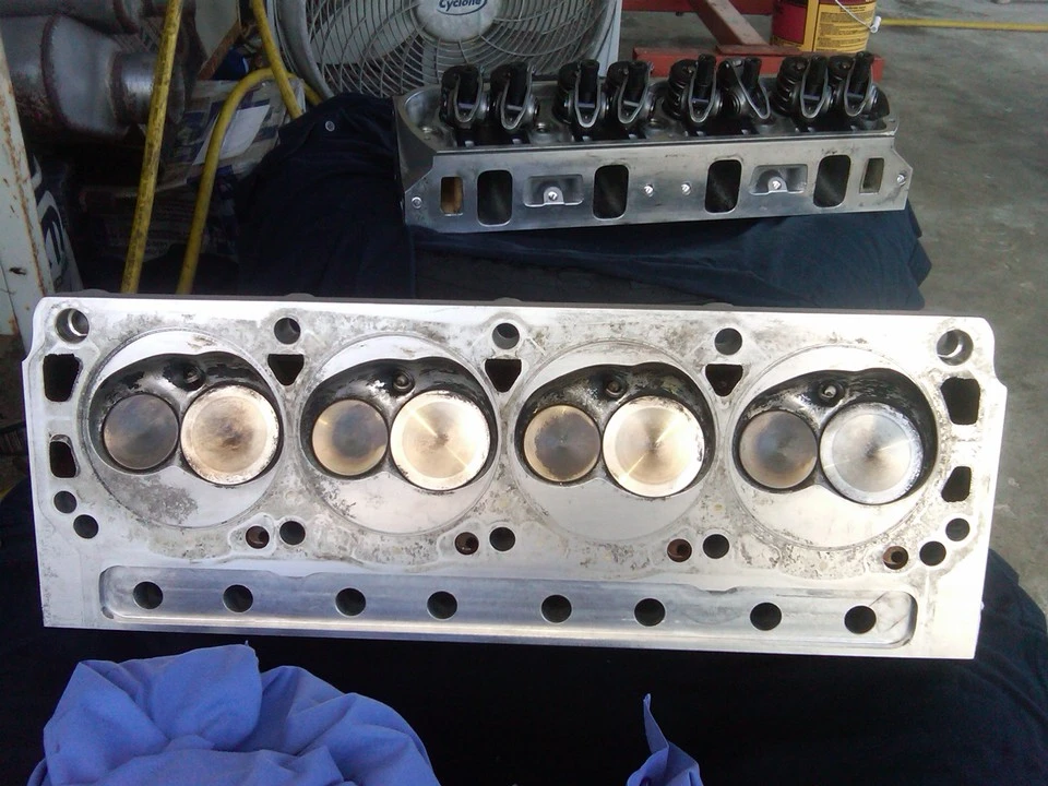

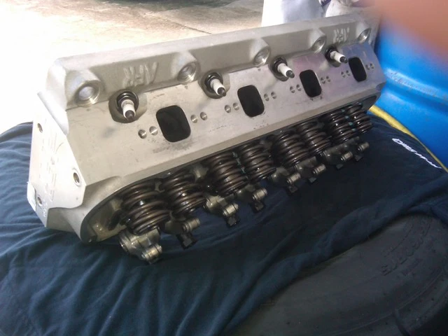

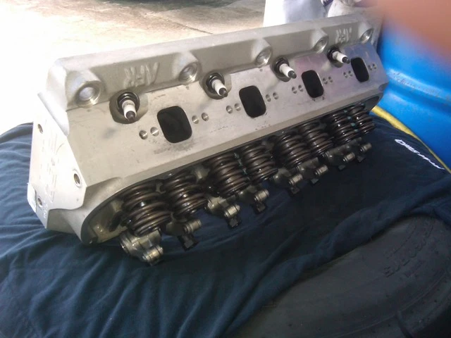

Got some 205s with 1.6 promagnums for $1600. Have about 100 miles on them.

I got the heads in the mail finally, but from the looks of them, the postal service played football with them. Had to file a claim and send them to the machine shop to get cleaned up, where they still sit....with the unfinished, but PAID FOR 408 shortblock. Sheeesh!
