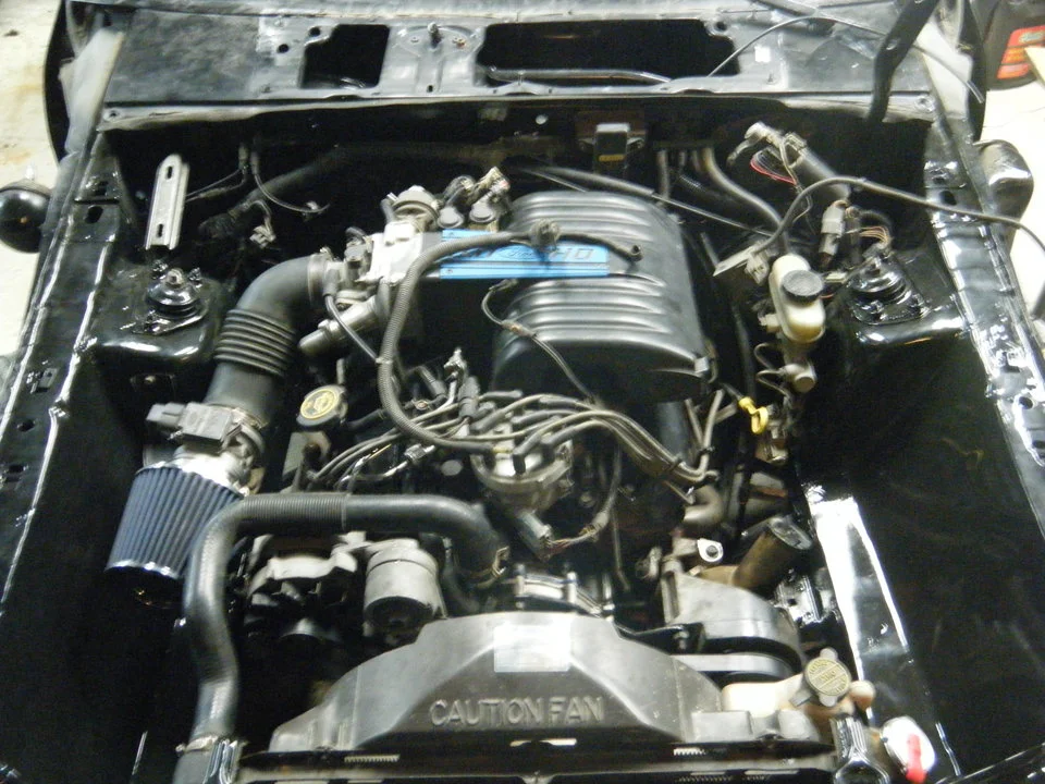

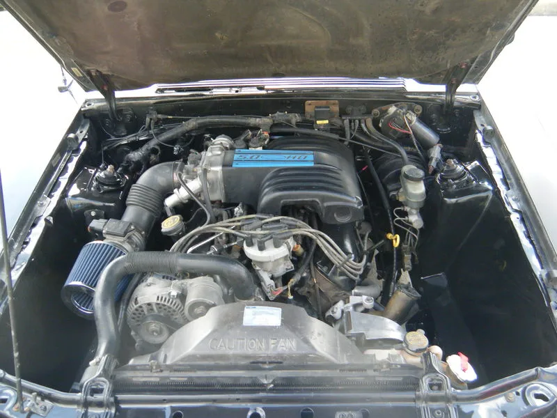

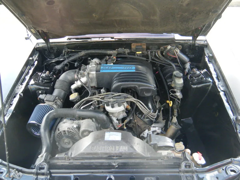

Alrighty. Here is the engine bay:
Excuse the extra wires laying around. I've done some more cleaning up and tidying since then, its coming together. I did some light polishing on the p/s pump and EGR housing, took off the a/c and smog wires you see, and wiped off some greeeezy hand prints in the paint.

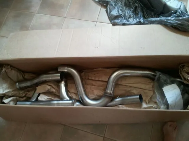

Well looks like the UPS man was in the area this morning. This should be the first of 5 boxes coming in. Also waiting on a manual rack, strange 10 way adj shocks for the rear, and I am expecting to win an eBay auction for a 3G alternator and an electric fan controller.
Still have the A/C delete pulley and C/C plates to install also

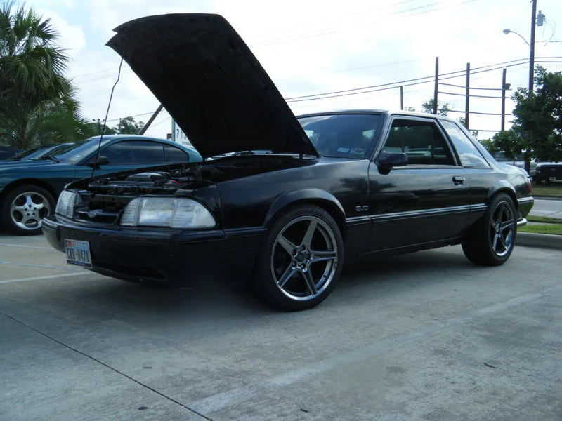

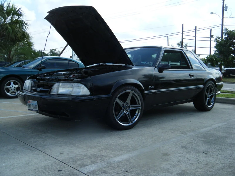

I did have a chance to go on a local cruise in the short time I havent been offshore. Here are some pics... The haze is a smudge on the lens of the camera, didnt realize it until after the event...
By hoopty50 at 2011-08-10

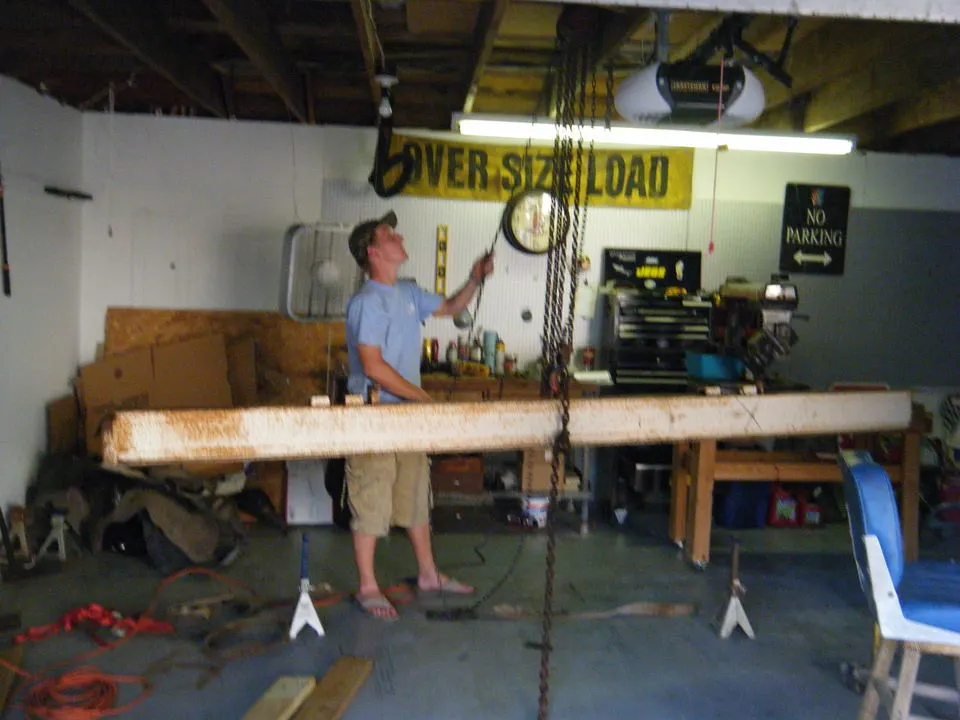

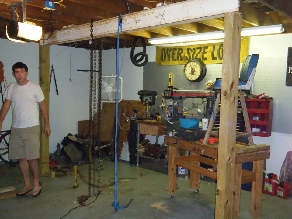

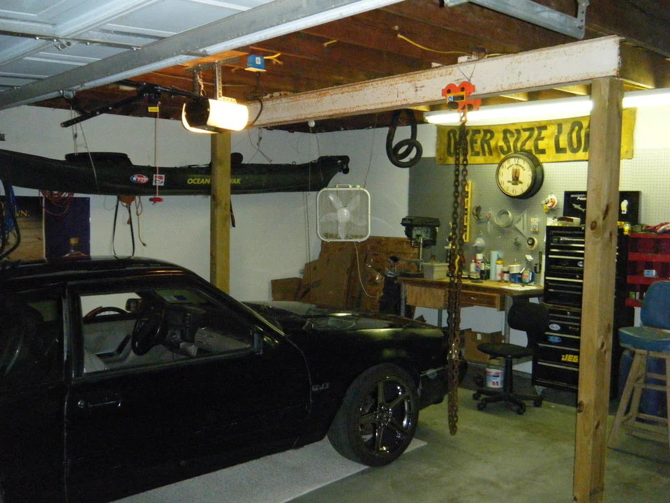

A few months ago, I installed an 8" I beam in my garage with a trolley to pull motors with and such. Here's the ongoing of events for that night and why alcohol and Krylon don't mix.
Bolted the chain hoist to the roof beams and began lifting the beam. It wasn't light, I'd put it at about 400 lbs
By hoopty50 at 2011-10-24
Here's the beam up flush to the rafters with the 4x6 posts holding it up
This is the almost finished product with the trolley ($60 from Harbor Freight) and how it looks in the garage.

For all you engineers who are freaking out because there is no bracing in the pictures, relax. It been installed since these were taken.

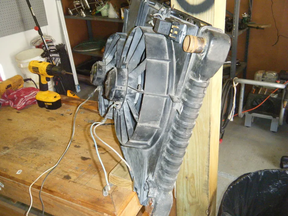

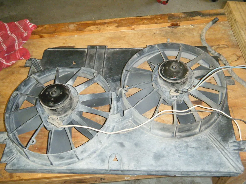

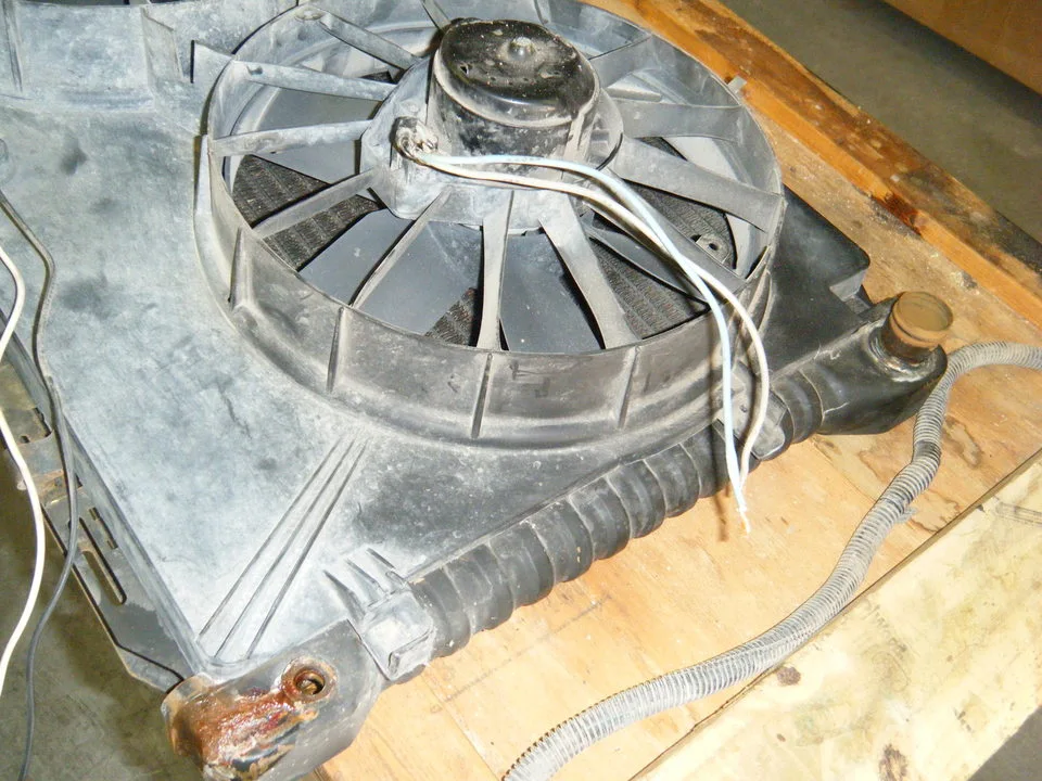

I also had the chance to install some electric fans. I got this set from my buddy who does LS swaps into old cars. The fans are a dual 10" setup from a trans-am I think. We weren't sure how they would fit, but when we set the fans on the radiator, it was like they were made for each other.
Here's the fans:
Drivers side edge:
Passenger side edge:

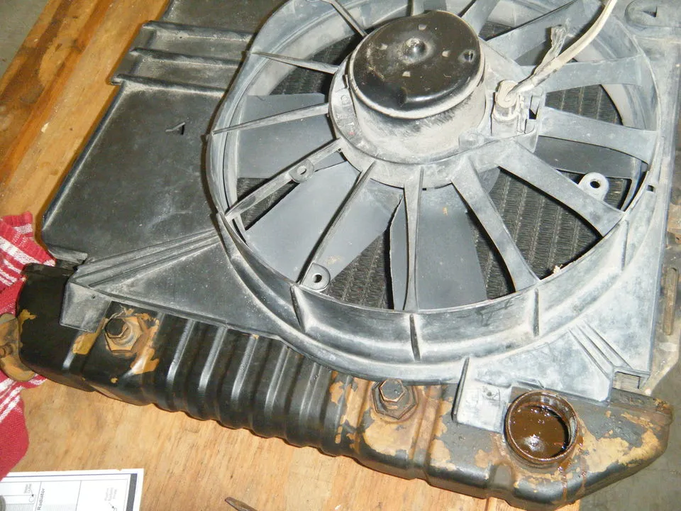

Heres the whole thing. I made some brackets at the bottom out of 3/4" aluminum flat bar and the top lined up so that I could run a couple 1/4" bolts through the shroud and the tabs at the top of the radiator. Thats the fan controller at the top, I ended up moving it to the bottom out of the way.

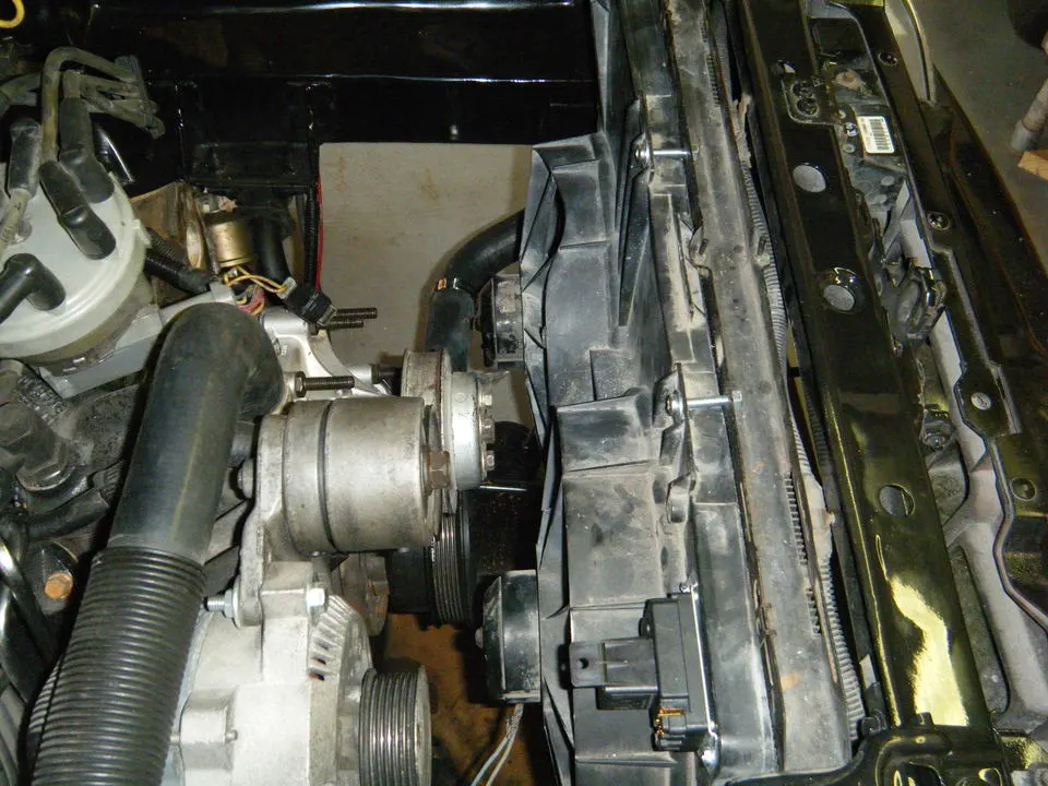

Here they are installed.
The controller is a Derale unit off of eBay. For $25 and how easy the installation was, I'd recommend it so far. Its also adjustable.

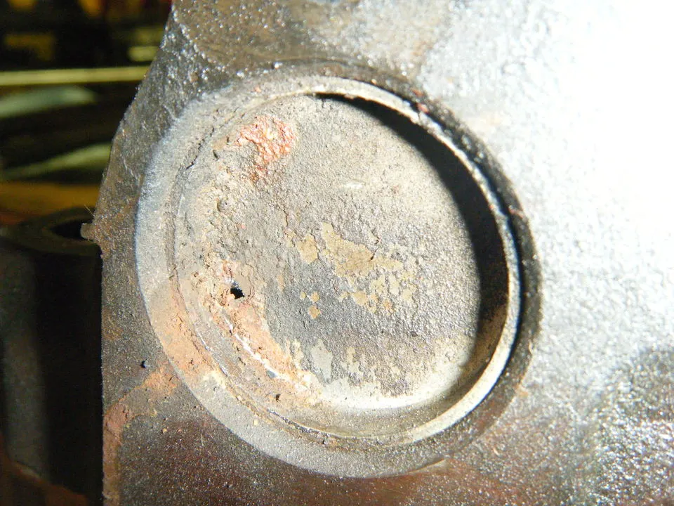

At this point, I cannot tell you how mad I am. My car has been riding jack stands for months and I only got to drive it ~20 miles before something else lets loose. I want to blow it up. Anyway, wednesday of last week, I did some investigating and found the culprit:
Yep, thats a hole. So I had to pull the head to replace a $.10 piece that I should have replaced in February when I did all the gaskets and freeze plugs on the block. Ahh well. Its all fixed and I drove the car over the weekend. The TKO took some getting used to as did the manual steering, but the overall consensus is I love it the way it drives. The manual steering is great. Yes, it takes some effort, but its not bad at all.
