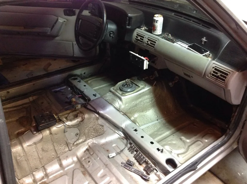

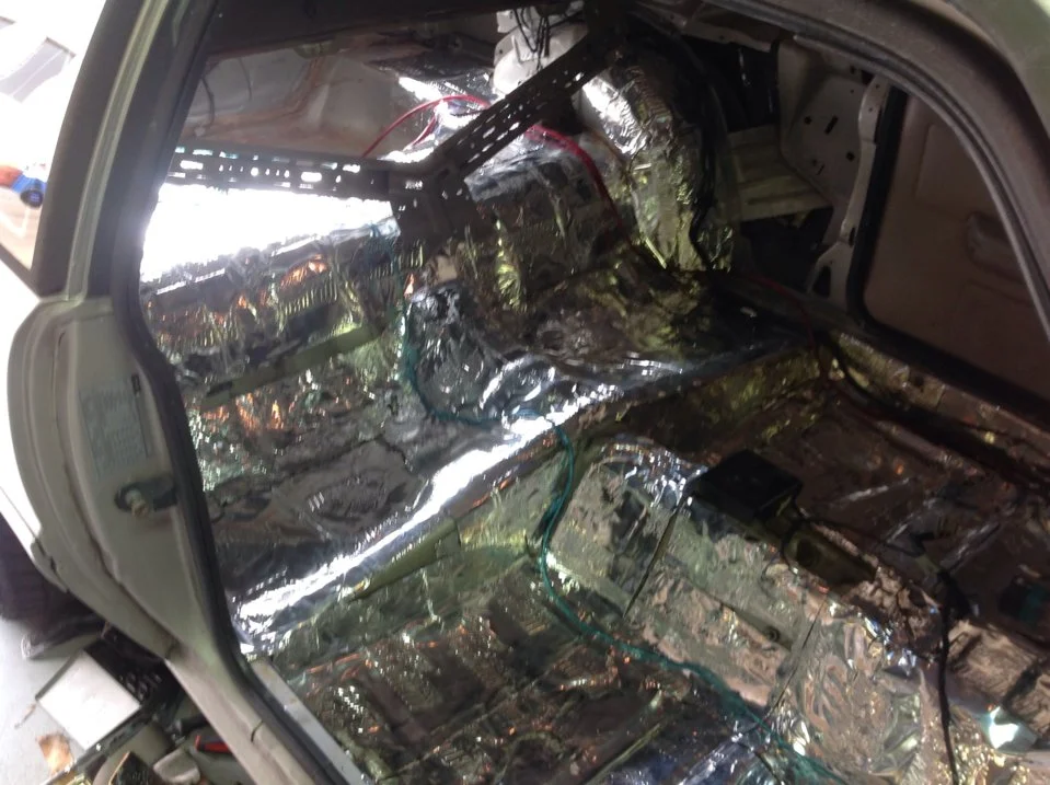

Dash is all back in, but I went out and bought sound deadener and then gutted the interior. I'd like this to be quiet as a morgue at cruise speeds.
Done for tonight, will finish up tomorrow and Monday if need be.

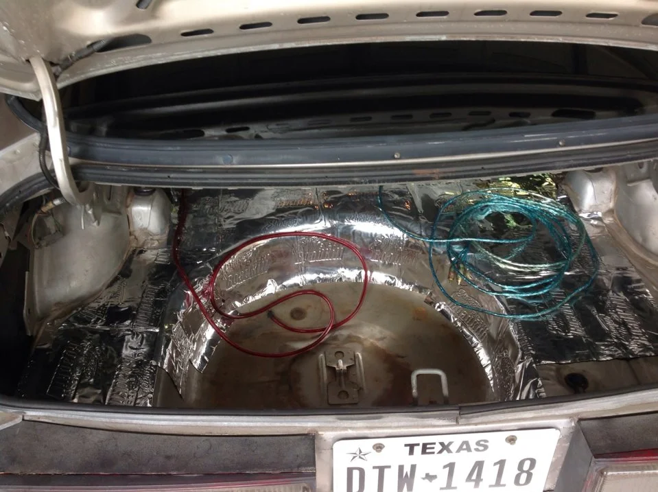

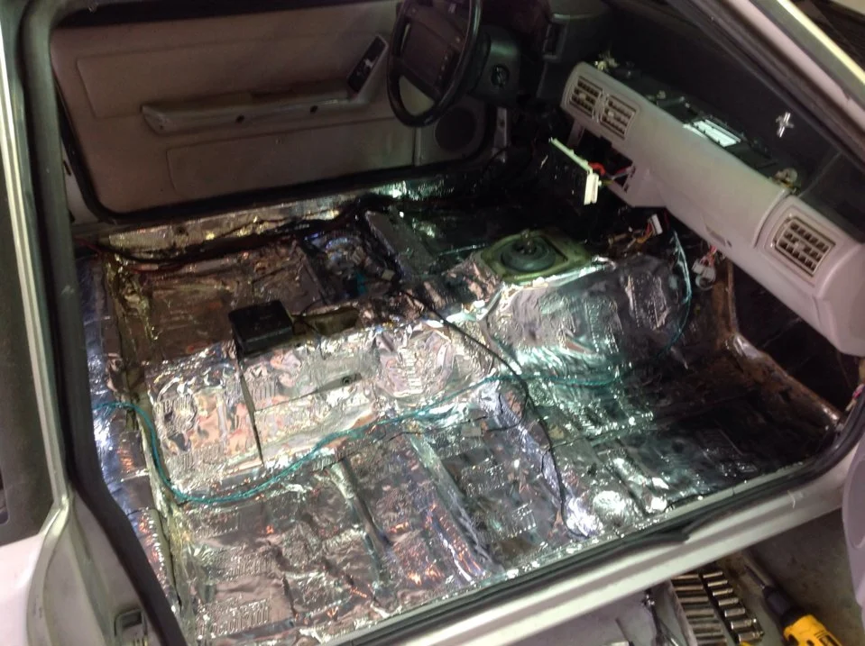

More work done. Ran well short on sound deadener. Got the floor boards and 1/2 of the trunk, some of the qtr panels behind the door. Need another 20 sf. If you plan on doing this, plan on buying 60-70 sf.
I also ran the wires for the stereo. Still waiting on the carpet to dry as I power washed it this morning, will start putting the panels and back seats in. Look for more updates tonight.
Ready for the week! Just test drove it - the Stinger Roadkill lived up to the good reviews online. I had no issues installing it. While it didn't kill as much of the road noise as id hoped, it is a night and day difference on bumps and dips. I think if I do the doors and the rest of the trunk, it will help the road noise more, but overall I'm pleased with it.

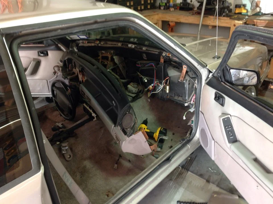

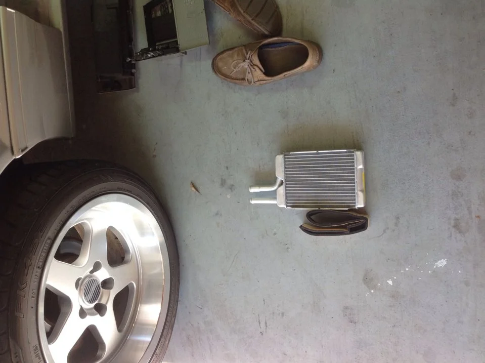

And the heater core is in. That is a huge weight off my shoulders. Still need the hoses from late model, but that's a 5 minute job.
