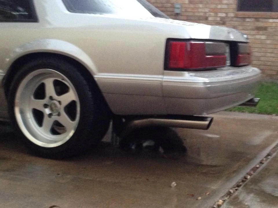

Also, I am piecing together a new cat back. I found some 2.5" tubes online for between the H pipe and the mufflers. Jegs also now sells a Magnaflow knockoff and I traded for some 3" VRS tailpipes. It should really speak at WOT when this all goes in!
