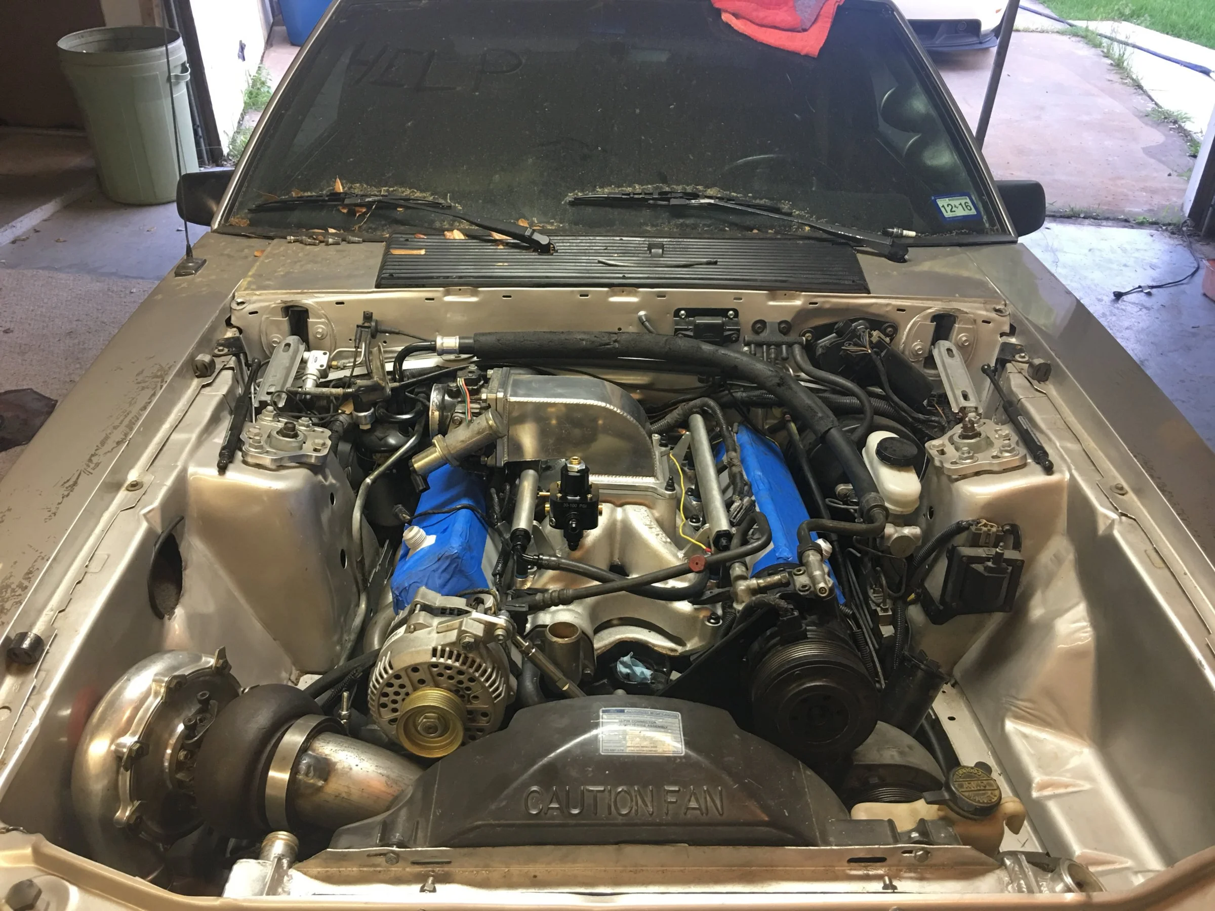

I'm as far as I can get without buying stuff. Gonna have to wait for a bit.
Edit* well, I guess I can start plumbing the cold side.
Does the turbo touch the panel?
Looks badass man
So, no - The elbow does not fit under the hood as it sits. Also, the attachment point for the TB linkage already hits the valve cover, so I'm going to need a 1" spacer to boot.

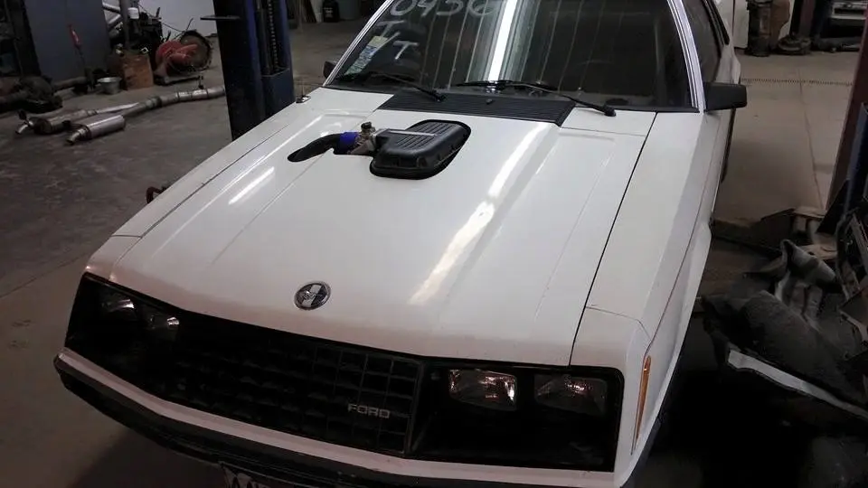

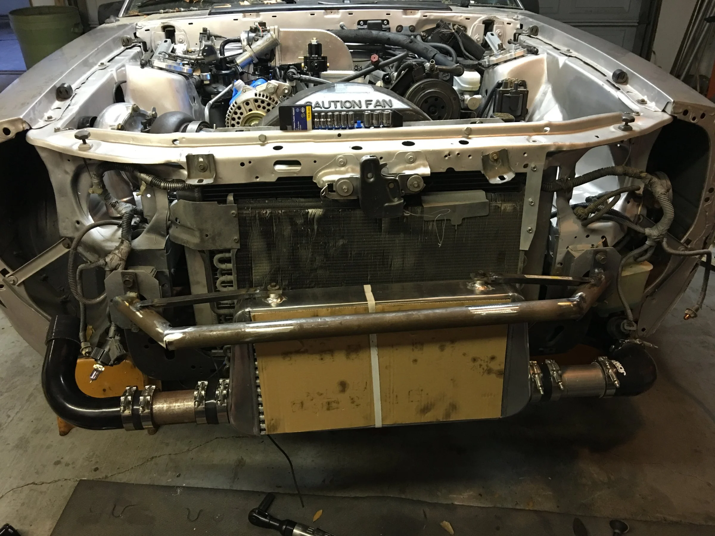

looks nice but the IC sits a little low IMO. if the car is lowered at all you run the risk of stuff hittin it. mine [same IC] mounted flush with the radiator support.
have you given any thought to facing the tb twards the fire wall? may alleviat some fitment issues...... maybe.... the IC piping will be more intricate but it would be worth it if the hood fits.

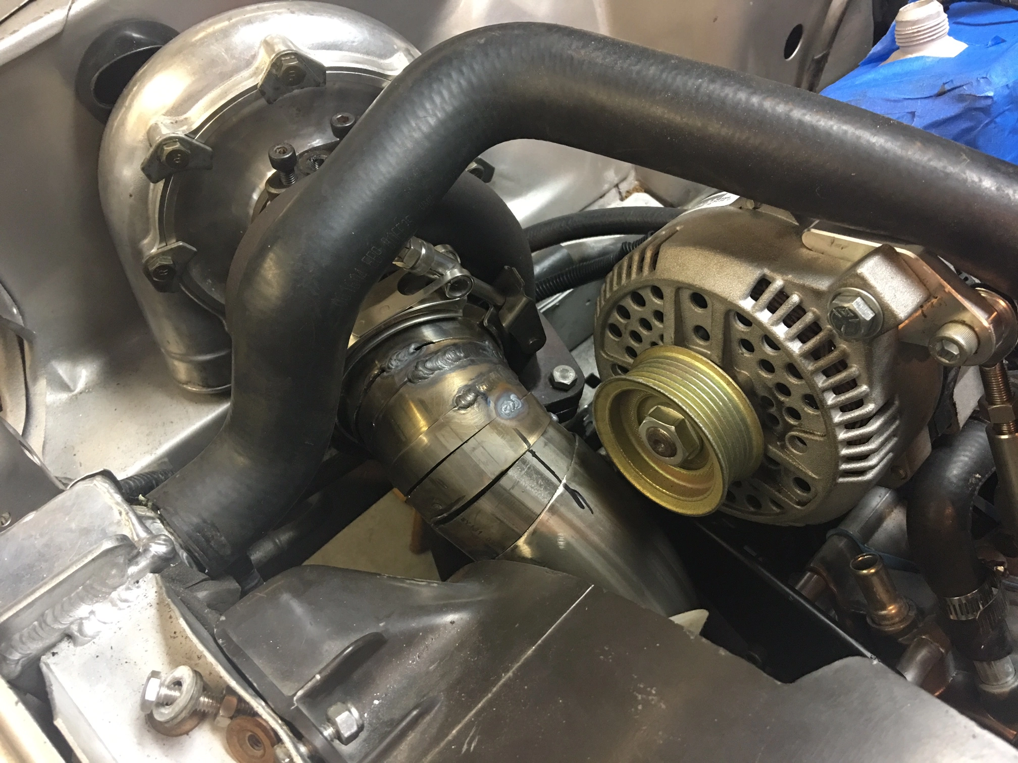

Last night I pulled off a feat I was hoping to prove possible - albeit crudely. I was able to snake the downpipe between the fan shroud, fan, alternator and bracket... Again - very crudely.

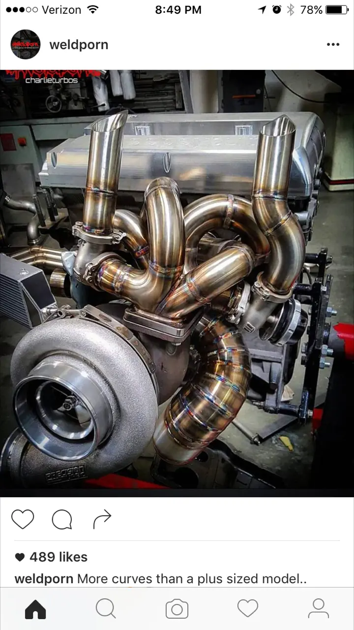

Why do I say it like that? All those pics you see on the internet of the fancy-pants stainless turbo systems with the cool heat coloration and beautiful welds - THOSE GUYS ARE ARTISTS.
Take this picture for instance. It's frame worthy.
Who knows how many hours of cutting, shaping, welding, scrapping and starting over are in there - all with thousands of dollars in fancy tools. It's a bit ridiculous, really. It sets false expectations. It's like women with fat shaming, only this is weld shaming.
So that leads to my sloppy-assed work. I spent a couple of hours last night attempting to cut 3" tubing with my portable band saw in straight lines. I want need a chop saw. One look at this picture and you'll see why.
At the end of the day though, I'm not ashamed of it. I did what I could with what I had and it's going to work. And it's getting wrapped in header wrap, so you'll never see it anyway. :D But, with that said, I am going to finish welding it up this weekend and it may actually turn out half decent. Or I may go buy a chop saw and do it all over again. I could make magic with straight cuts and measurable angles, I swear!
I feel like that picture was expectation.....reality comparison. Also, if your worried about the way it looks, look a sloppymechanics builds on youtube, he's used junk piping and crappy steel and made 700 horsepower on the junk. Then he spent money for a cleaner look and lost hp.....irony some times

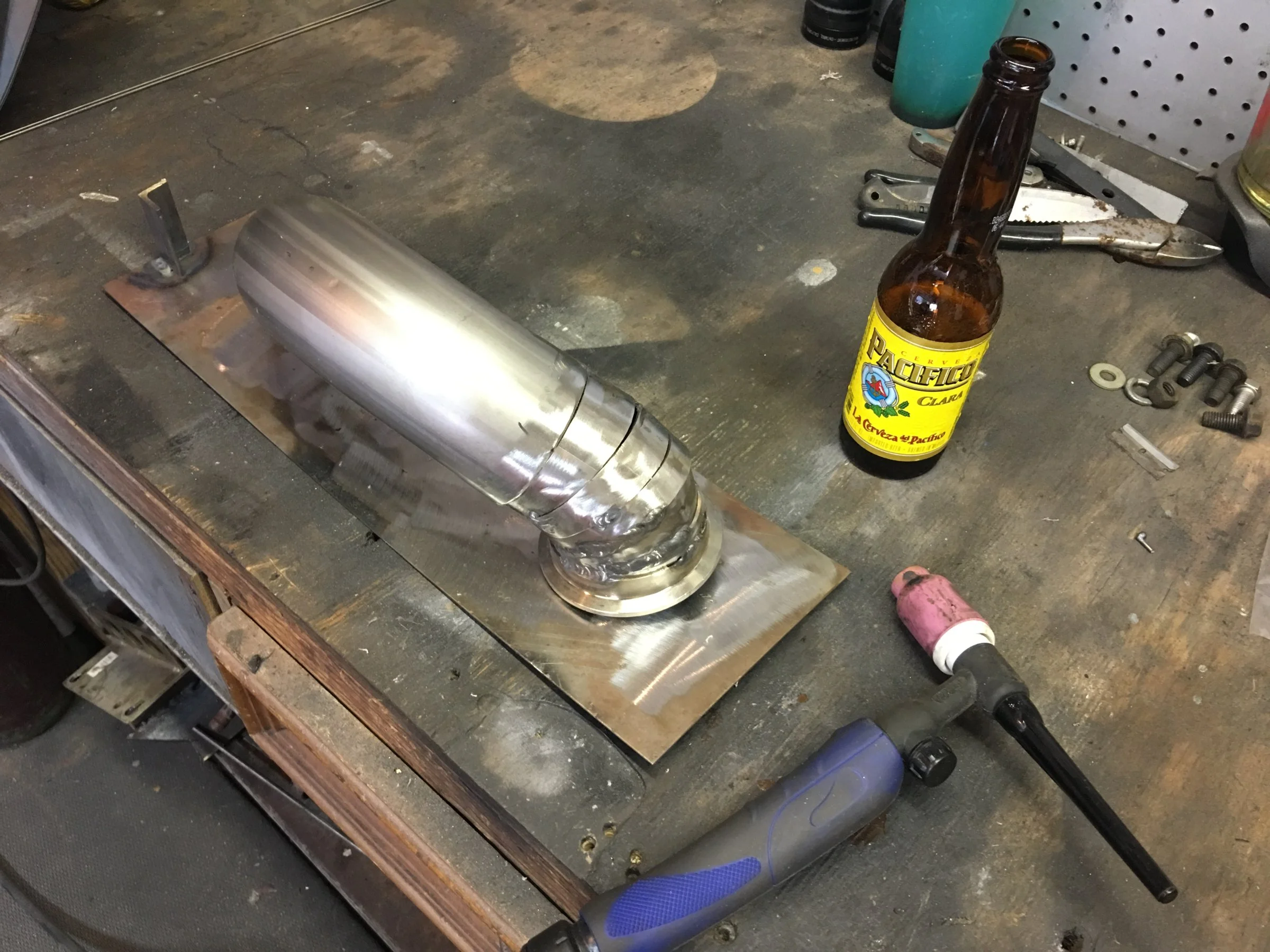

it had to do a literal 180* turn. I already had the smallest 3" donut to cut pieces off of and still had to pie cut that in order to make it fit. Bandsaw=sloppy cut.
When in doubt make a small "coupling" out of the same pipe slit down the middle to pop over the joint then weld both sides of it. After that I take a flapper on a drill and clean up the inside of the weld.
