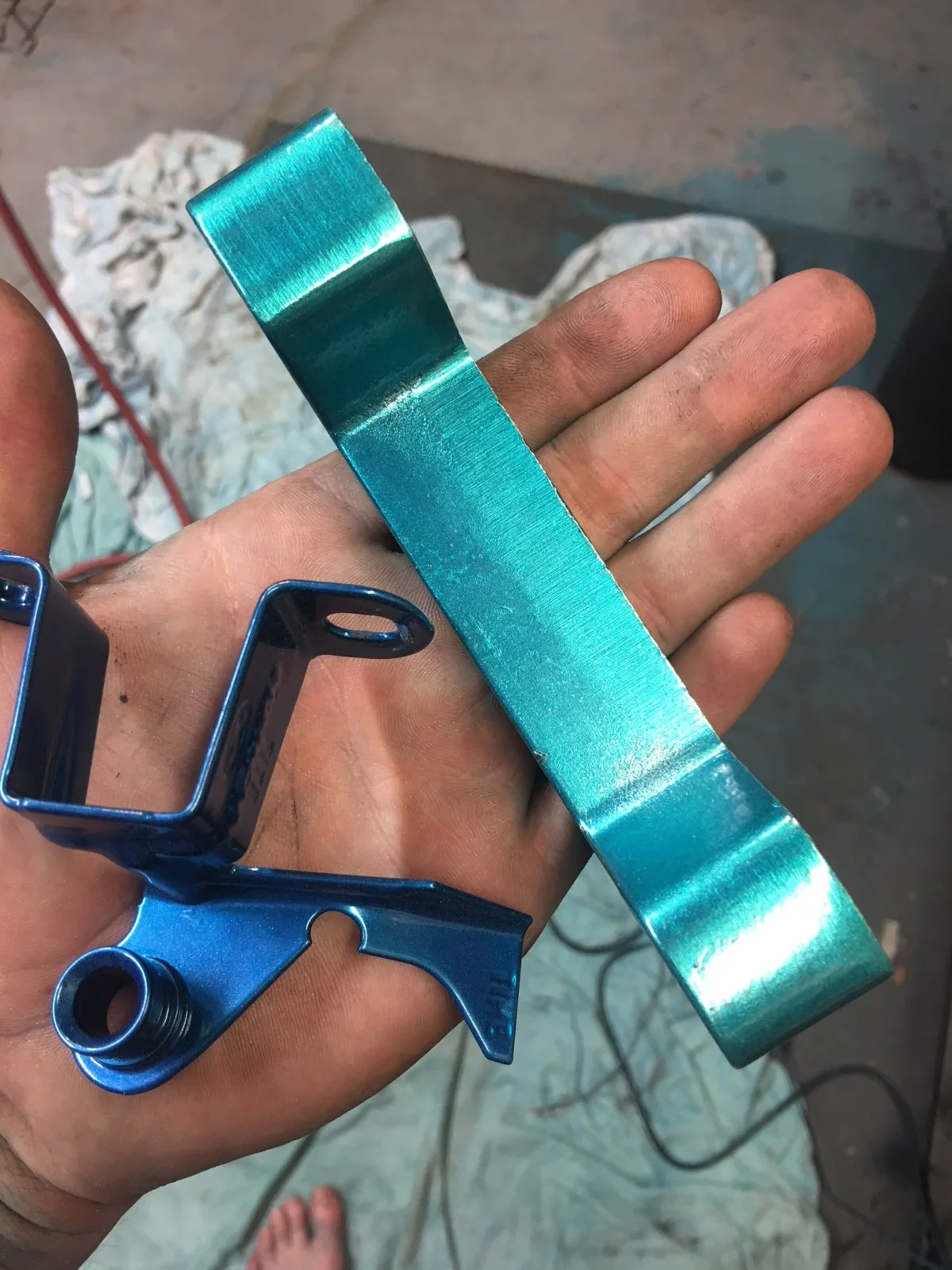

Part #1 is done. I am tickled shiitless with the color
So the problem here... While I like the color that I ended up with, it's not correct. See below:
The timing pointer is "correct" and the spacer is what I'm getting. I'm not upset, I almost like the green better, but it's still making me scratch my head. I searched the interwebz as much as I could, didn't find anything. I sent an email to the powder manufacturer to see what they say.

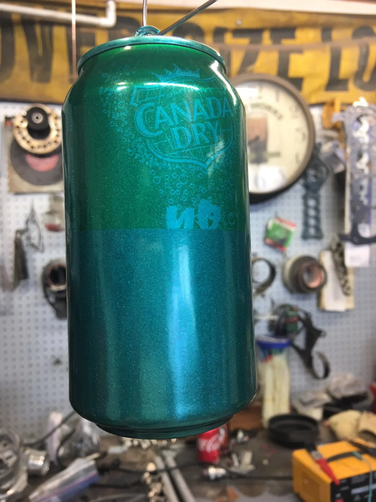

I only did 1 coat. I did a test run on this can - the bottom half has a chrome base coat to match the aluminum. Might try another coat of teal tonight and see what happens, depending on what the supplier tells me I did wrong.
(it looks blue in the pic, but it matches the green on the other parts.)

Top Coat Information: Top coat powder coating colors and clear metallics are transparent. The color of the substrate (surface) under a top coat will affect the finished appearance. To simulate the color displayed, use USS 4482 Super Chrome as a base coat, which is the brightest chrome powder coating available. Depending on the brightness of your metal substrate, you may be able to apply directly to the metal without using USS 4482 Super Chrome as a base coat. As always, shoot a test piece first to determine if your desired results will be achieved.
Seems to me if you want it the bright teal green color (that you're already getting) you should use the chrome base coat. To get it darker (blue looking) you probably want the base color (substrate) to not be chrome. I'll also add that your timing pointer looks to be blue, Hawaiian Teal is going to be green'ish blue. Not the same color if you're looking for a match IMO.

Yeah, so the soda can posted above has the bottom half done in super chrome - that's the color differential that you see there.
