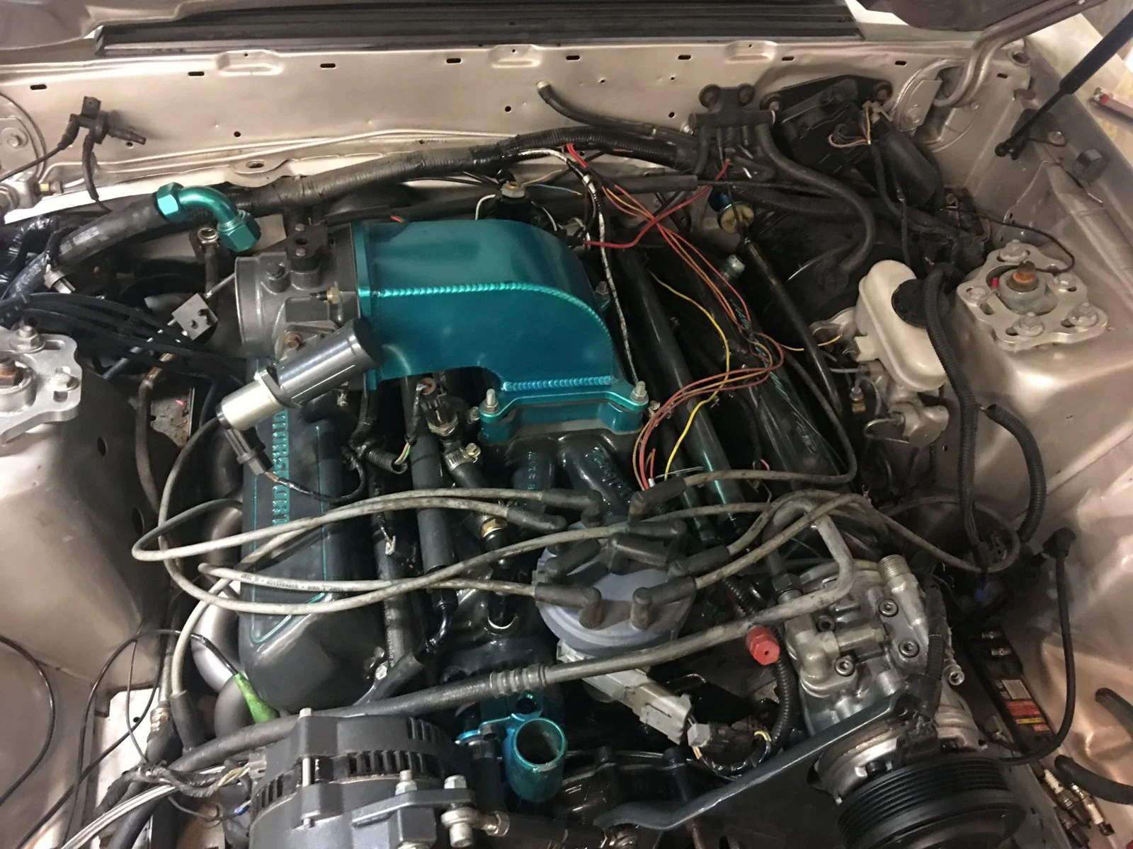

Half asleep in the shower this morning, I was running back through everything in my head.
What has changed since it ran last?
- The ignition system - but that's been tested to exhaustion and we know it all works.
- The cam/ lifters - Here's my newest theory. When I did the head swap on my truck, I had some trouble wrapping my head around the fact that I couldn't compress the plungers on the lifters to set the preload... Because they were full of oil. My guess is that I should have made sure that the lifters on the car were full of oil first as well. The plungers were all compressed slightly, so maybe some intake and exhaust valves are cracked open just slightly after the oil was primed and lifters pumped, preventing the car from running right. You know, just like @95BlueStallion fought for months a few long days.....
- The final thought that Tanner brought up, as well as a buddy on the drive home yesterday is that something is funky with the fuel system. After all, the car sat for a really long time, mostly outside. Maybe the regulator isn't working right. Yeah, the pump primes, but is it holding pressure? I have verified that the pressure is set at 42 psi, but Is pressure bleeding off after I try starting it? I don't know yet. I can run the fuel pump via test mode and verify all of that tonight as well.

Alrighty, Picking up where I left off last week,
1) The rocker arms are fine, I can spin the pushrods somewhat when the valves are closed.
2) I disassembled the regulator last night, it's fine.
3) I pulled the fuel feed line last night and ran the pump for several seconds. The fuel line might as well be a garden hose at full blast. Absolutely no shortage of fuel, so the filter doesn't seem to be clogged.
I have a few more ideas to test in order from least to most likely, in my opinion:
1) the injectors need to be cleaned and flow tested.
2) the wiring for the fuel pump isn't big enough to support the required voltage/current.
3) there is still an ignition issue that isn't showing up on the logs.
