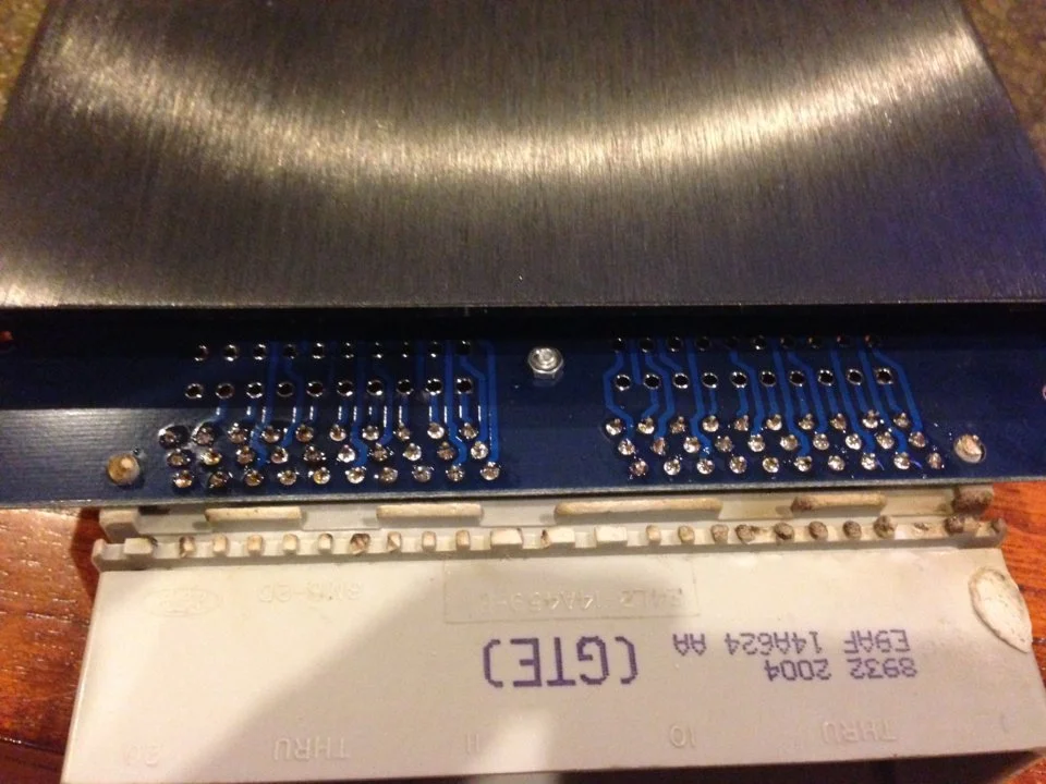

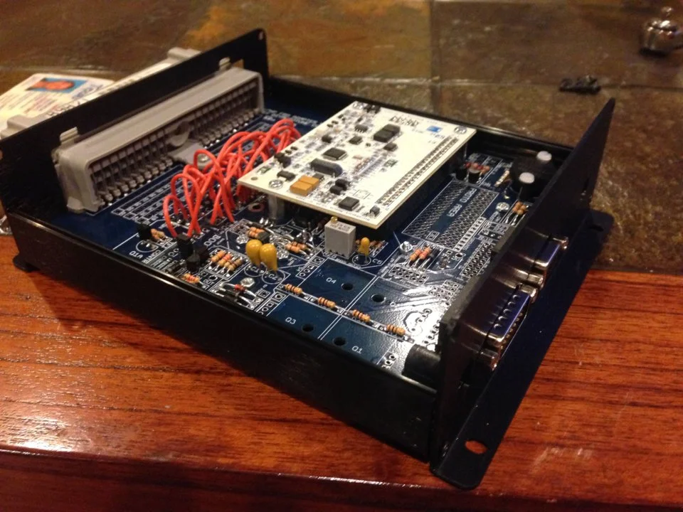

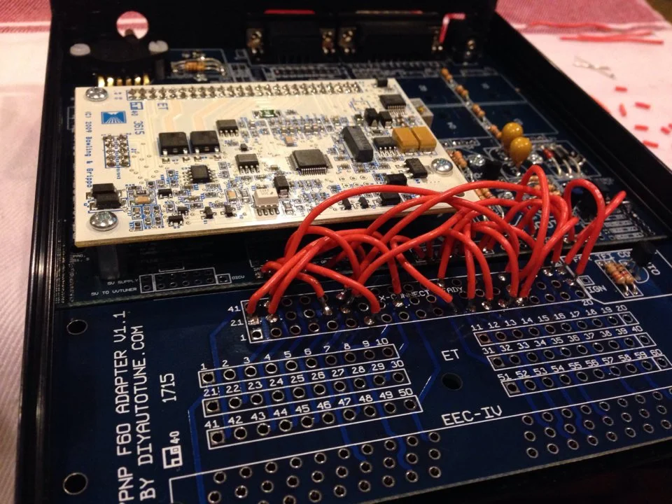

Finished everything on the MS short of soldering on the 60-pin connector where it plugs into the harness. I fixed a few soldering issues that were pointed out previously and feel relatively confident that it will work without issues.
It looks better. I think your gun is the limitation now. If the 60 pin is braided wire, you wight want to consider tinning each of the tip before soldering to the board. Get a 60W ebay pencil iron. It'll make your life a lot easier.

Thanks, and yes, the gun is not a "quality" unit by any stretch. It's a 40w Radio Shack pen-type.

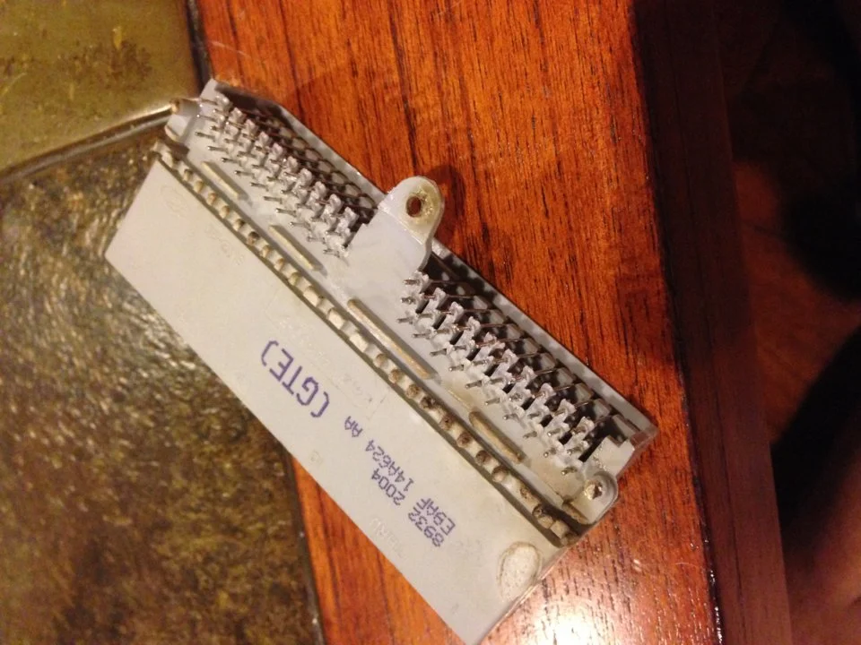

The 60 pin is all metal leads. Right now I am struggling with desoldering the connector. Fought with it for about an hour last night and might have got 8 of them done.
This is because your connections are getting too hot when yo solder and it's flowing all the way through the hole

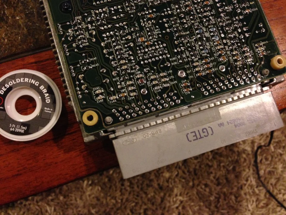

Not sure I follow. The picture above is a stock ECM that I am trying to remove the connector from. I was placing the desoldering braid on the pin and putting the iron on top of that.I could get most of the solder out, but there was a little left that would not wick up the braid.
I did some reading after the fact that suggested I should preheat before using the braid. Agree?
Now I don't follow. Preheat what, the connection, the braid? I've never preheated either for desoldering. If you have a small tube of flux, that's even better. It requires about as much as you can fit on the head of a sewing pin, for each connection.
What I was referring to above was that I thought you had to remove connections that you had previously soldered. Now I see what you were talking about. Yeah, those were soldered with a flow soldering machine. Very efficient and it generally makes great solder connections. Removal can be a bit tedious. Hang in there though. You will find that you will improve quickly. It's a lot easier than welding IMO but does require a rhythm and feel, to do well.
One of the things that helps with desoldering machine soldered PCBs is to touch each connection with heated desoldering braid from the top. Only the cold portion of the solder connection will refuse to flow to the braid so clearing the top first can help.
One other thing that can help is to apply a very small dab of solder to the top of the heated braid. It's really just the flux that you want. Just enough to get things moving.
