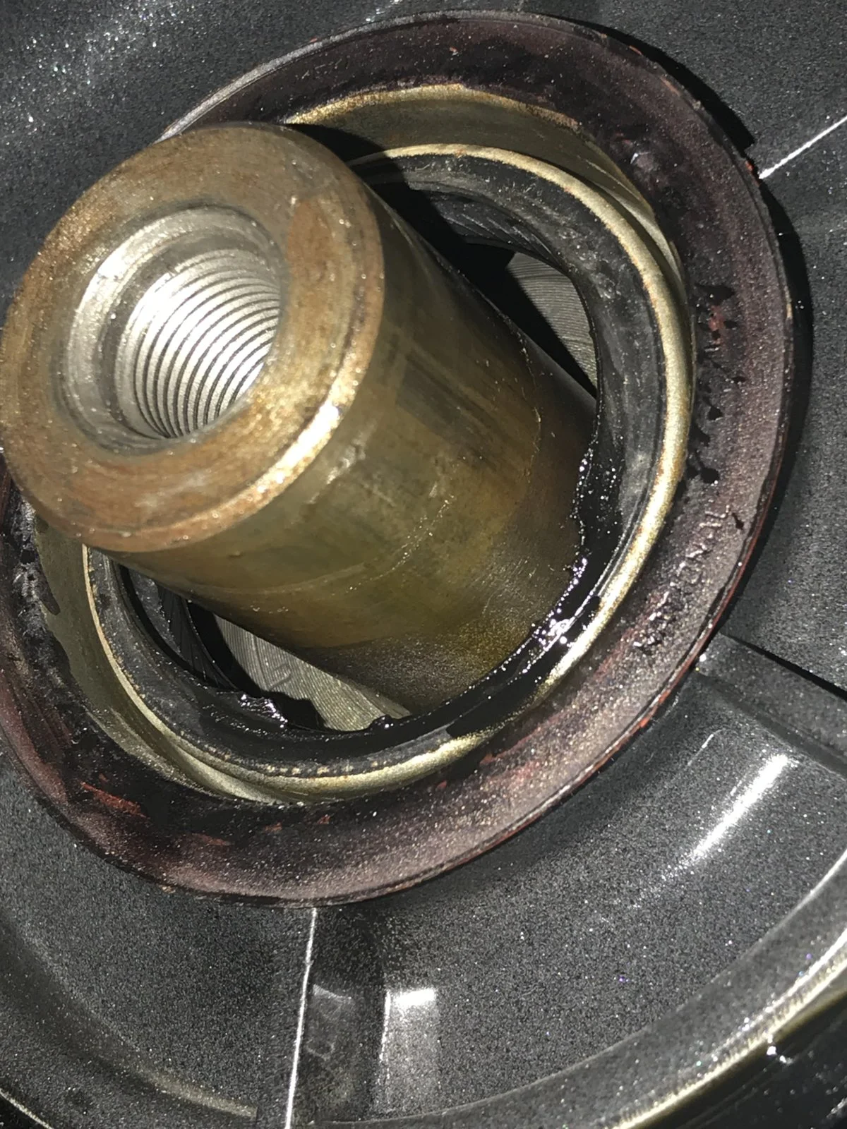

Good: It moved.
Bad: it’s got a mofo of an oil leak, won’t hot start (starter) and has a bad air bubble in the cooling system.
The oil leak is coming from behind the balancer, so off it all comes.
