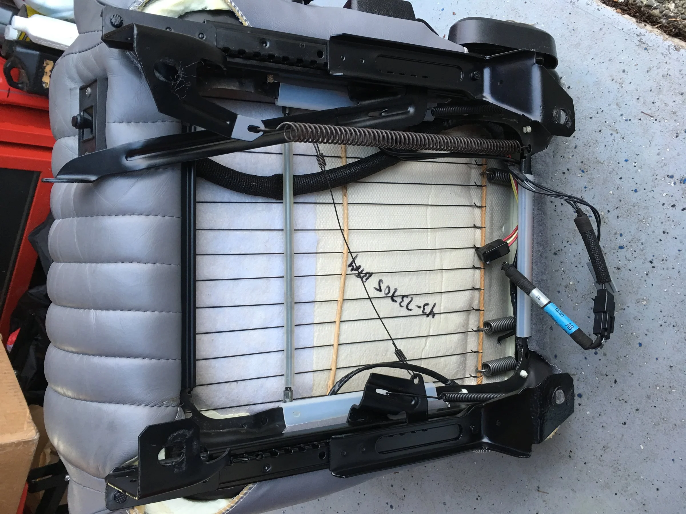

Anyone know what that taped up plug on that wiring harness is for? I am putting in a power seat track.

Power lumbar hookup?
It would need power from somewhere off the power track

I figured it out. Just needed to look at it for a second. It hooked into the harness coming in from the floor. Got it all hooked up. It works. I think the motors are a little weak or I’m too fat cause they hardly move when I’m sitting in it. I definitely sit better in it.
The foam has been replaced in it, that’s why it looks so nice. As for the tracks, they are very nice. I don’t know if the are reproductions or if they even make them but they didn’t even appear dirty.

Under the seat is super clean, not sure if it’s original but it looks it. Don’t know if you can see the shiny peaking through in a hole where the front mount is for the seat, but it’s got dynamat under there!

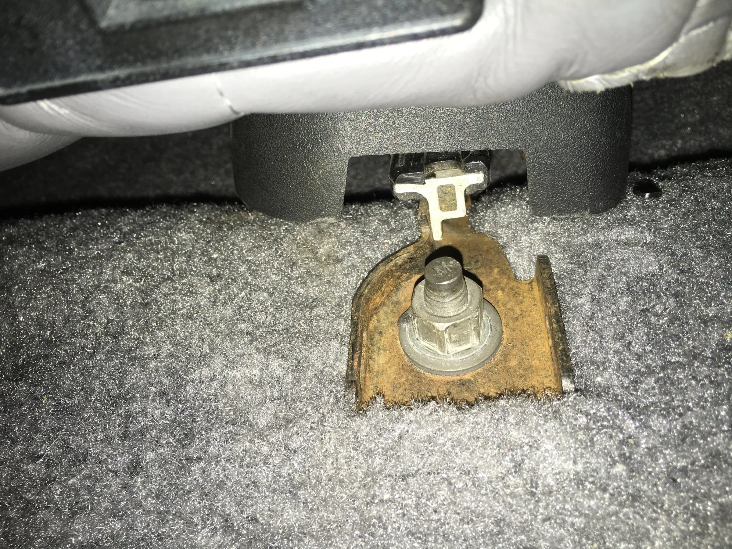

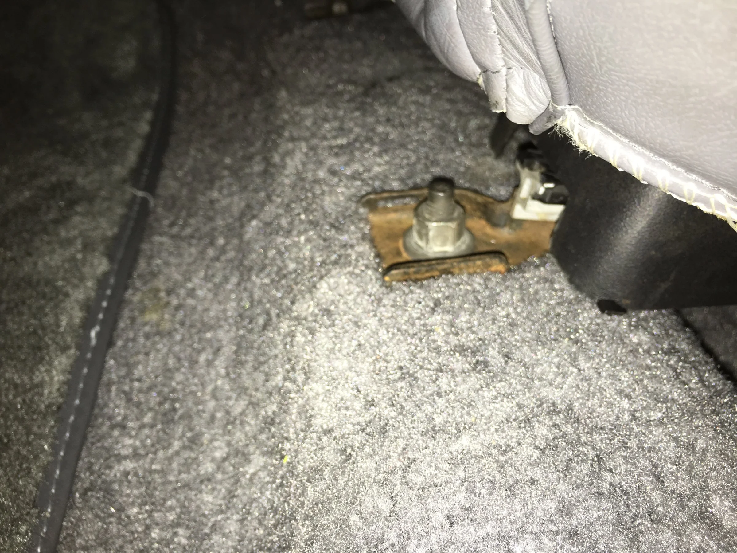

This is the front of the seat. No where for the cover to mount to. It’s hard to see in the pic but on the sides of the mount there are elongated holes that look like they could be holes for covers.

They look different from manual tracks, I'd have to run out to the garage to compare, I think I still have the non working power track from my old vert

Find a cover that's large enough for the foot and fab your own retainer. you can install it under the bolt.

The seat frame I found is power adjust with tilt, I remember getting one from a tbird thinking I could adapt or use parts to fix mine so that one I found may be the tbird one, don't remember a tilt option on stangs. So I dug around and found bolt covers for a manual seat and the push pin hole is on the top, you may be able to drill a hole in the side for the pin, just a thought.
