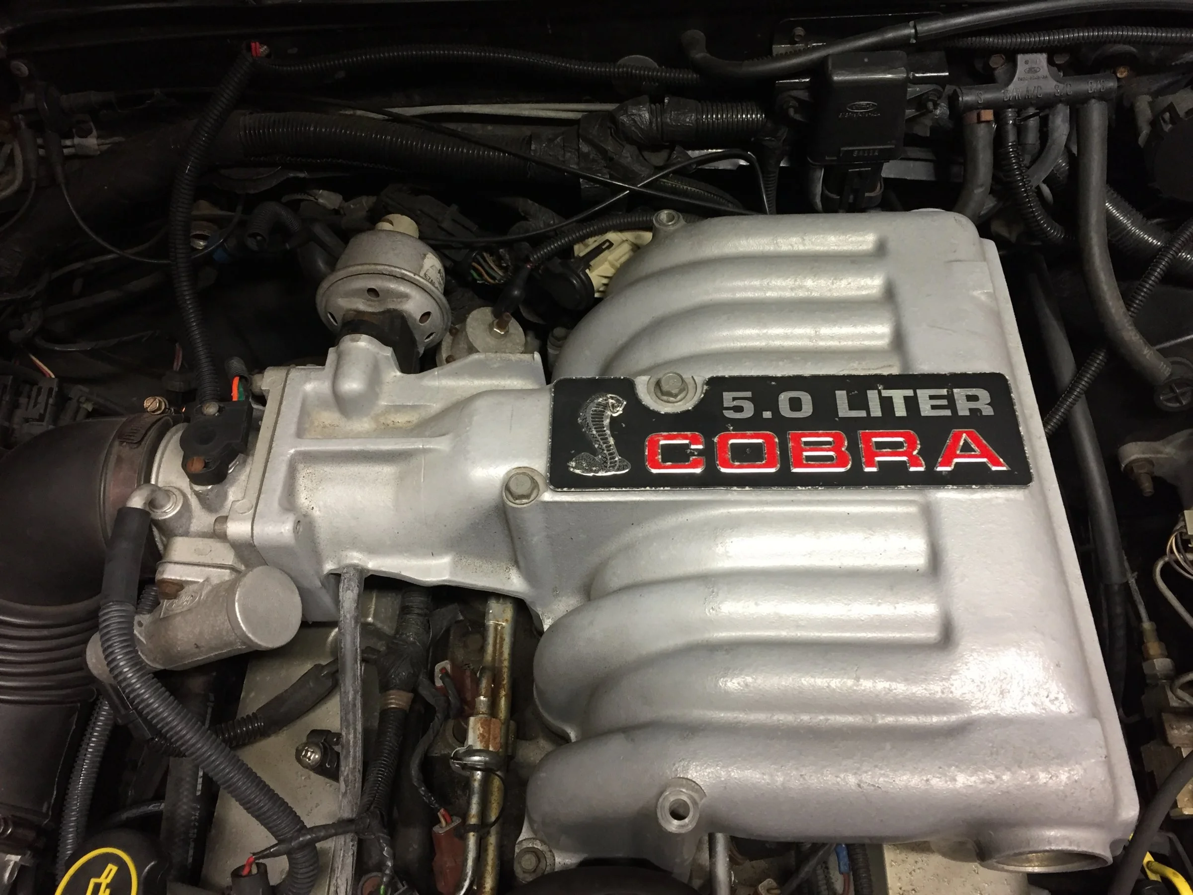

Mustang5L5 said:
What color are you going? OEm argent?
As close as OEM as possible. Would that be argent? Did it have a clear coat also?
Go with the color that Mike did on his Explorer intake. That came out killer, hes got it in his thread.
I would say argent white/silver is close to oem. Over the years they may have yellowed a bit but if you google 93 Cobra engine bays they look very light silver.
Here's mine. The paint I used on my explorer upper doesn't match

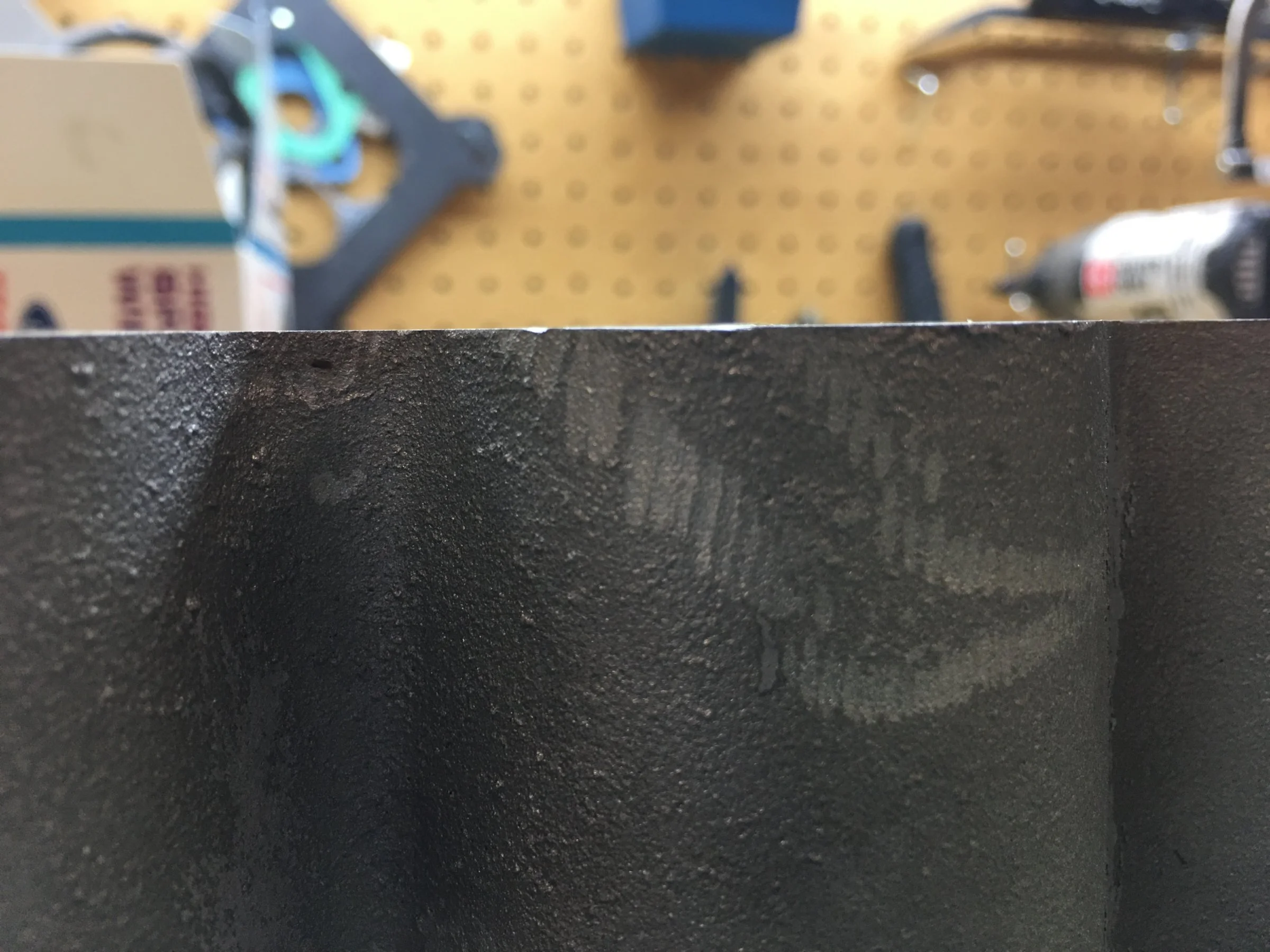

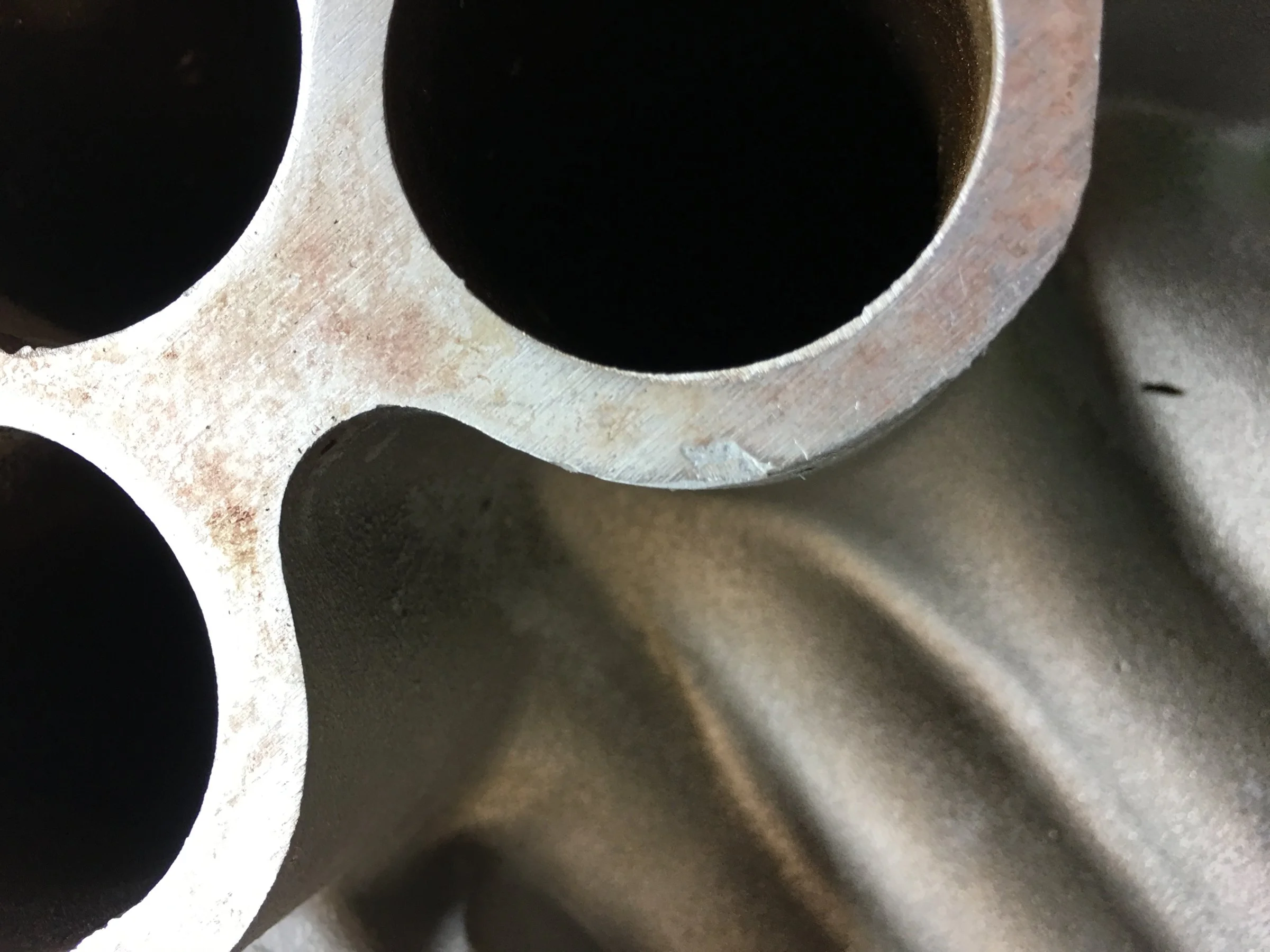

Tubbster66 said:
One area of concern that I see and it’s probably my fault. I can just feel this wit my finger nail. Should I be concerned at all? Doesn’t go all the way into the inside.
Late as usual and those guys are right. That little chip won't make a difference.

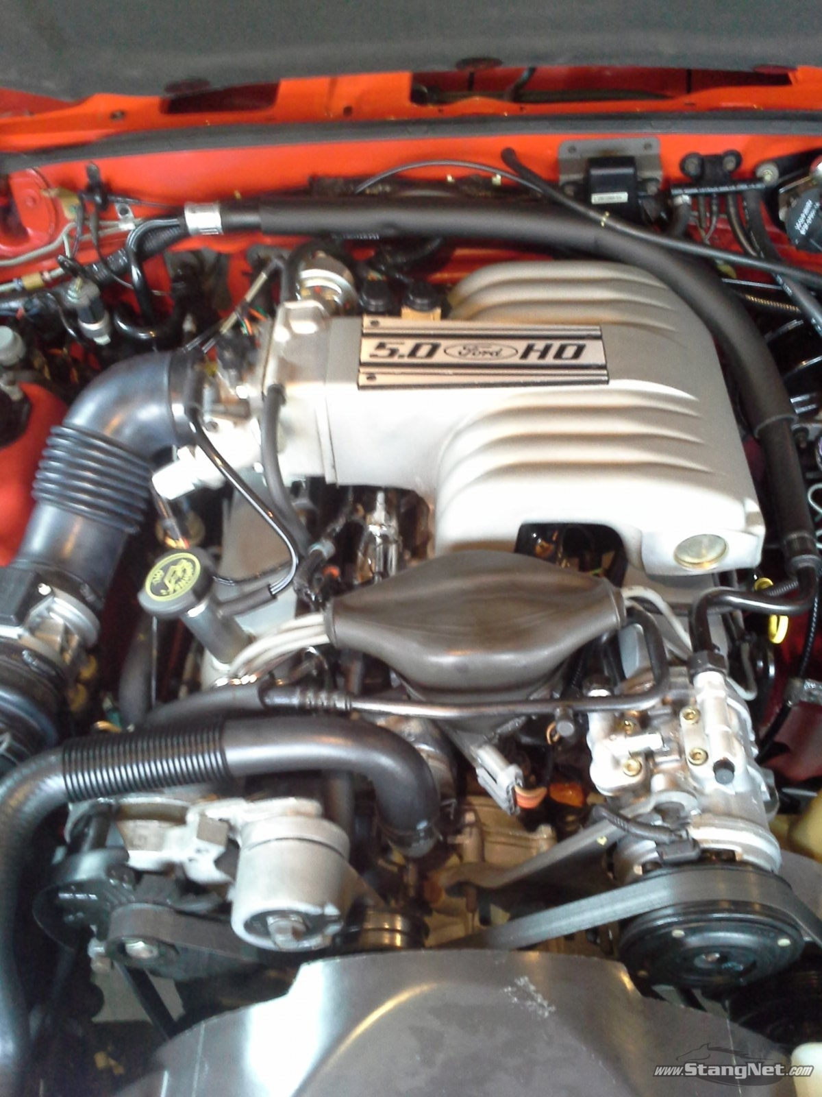

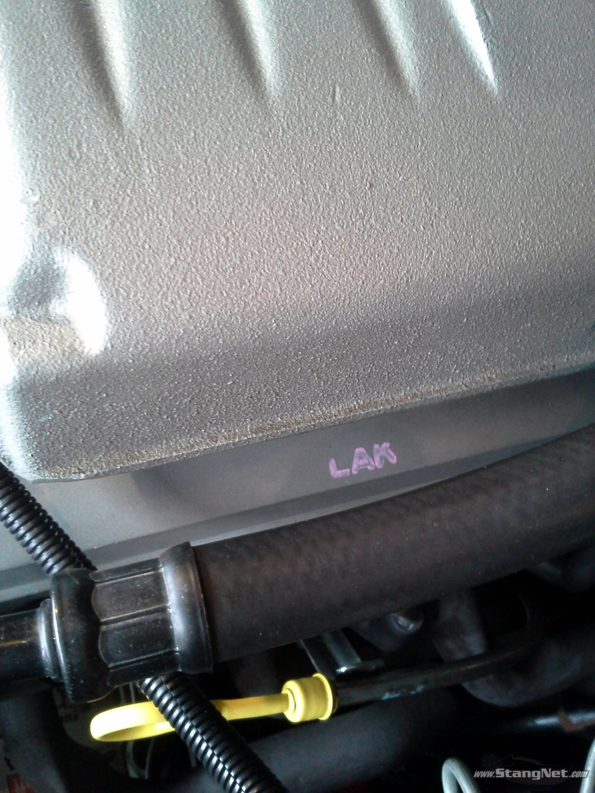

Serious question, are we sure the intakes come painted from the factory?
Here's mine. Never been touched, would you guys say it's painted or natural aluminum?
As a Pats fan for over 40 years I'm so glad Pete chose to throw. Butler for the win
Haven’t heard that one before..
I would think it’s painted just due to the fact that bare cast aluminum would be very dirty or discolored after so long wouldn’t it? Of course I have no idea how many miles you have and I know very little about these years of mustangs. Great looking engine bay! Brady shouldn’t try to catch by the way..

A serious question? Seriously? I would guess not painted from the factory but what do I know.
Lets ask @FoxChasis maybe he knows

There's definitely a coating on the intake. They aren't bare. In my youth I've stripped few to get them ready to polish. In my pile of parts is my original HO intake with a (poorly) polished upper. I remember stripping the "paint" off it years ago.
Now, is it paint or a powerdercoat? Not sure. It peels off in layers like a paint, but I've read mixed things on what it actually is.
