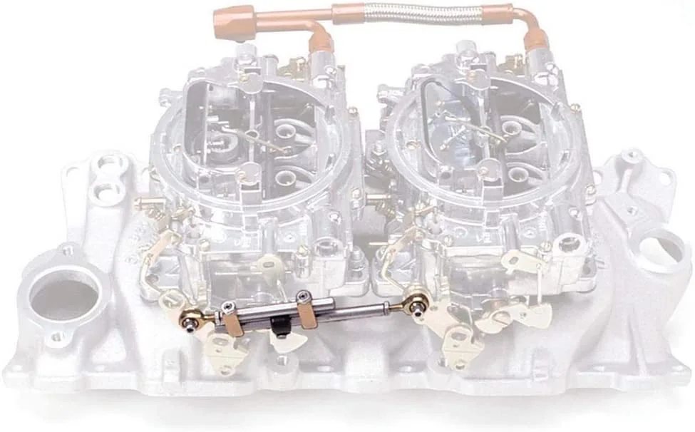

So I ran into this on Marketplace......
Facebook
www.facebook.com
While I think it would look pretty awesome when you lift the hood, I don't think it would give much of a bump in power...... would it??

Unless someone de-tuned it already I would think it will run too rich and rob you of power and fuel mileage. Correctly tuned it would be badass under the hood. Once properly tuned it may give you a bit more but there are other bottlenecks in a 302 that need addressed to make it worthwhile performance wise.
Appearance wise... Dual carbs goes from Nice Ride to uh oh, got serious.
I have an autometer A/F gauge and it is just an o2 sensor and gauge. No separate controller to worry about.

Yeah, I figure that that set up is more about the factor than actual performance. I mean, the way I see it, an engine can only burn so much fuel and take in so much air, having more carburetion really won't do much. It MIGHT give it better throttle response or climb the RPM band faster, but power wise it really won't do much more than a typical 4 barrel. But then again I've never operated anything with multiple carbs either, so I really don't know. I'm only speaking from a theoretical standpoint....

More carbs is more failure points. Looks cool but ....
When I got my first II back in the prehistoric times. I threw a holly 600 on it. That thing fell on its face when you punched it. Just too much fuel. Had to be detuned to run right. Those engines had a 500 cfm carb from factory. It was more then enough. But it wasn't a 4 barrell. I couldn't get respect with a puny 2 barrell. Come on. Even if the 2 bbl ran better. It had to go.
So as I see it. You go to install the dual carbs now. I was talking you out of it but now I see the light and cannot in good faith continue that dark path. Those teenagers just wont respect a mere 4 bbl with all them fancy injectors and electrons and coding and turbos and what not they play with today. Hell there 4 cylinders have 4 injectors. Here you are with a v8 and only 4 venturies and 2 of which don't even work all the time.

Dual quads should be setup, that you run the most time on the primary of the first carby. Than with 30% or 50% opening the Primary of the second carb should come in (linkage should be designed like that). So far you are running a double pumper. If you step onto the pedal the two Secondarys come it additional. In the upper RPMs you get more air trough the engine. So the engine should turn much more freely above 5000 RPM.
That is the experience of a friend who is running dual holleys on his 302 roller cam with AFR165cc heads. So he has a healthy engine, as you also do.
Downside is, that he doesn't get idle as low as with one carby. And you need to fine tune the two primarys similar to a double pumper. It helps if you have a manual transmission (which my friend has).
4 barrel (if not way too big) is usually better, than 2 barrel because the primary venturis are smaller. This means you have higher air speed and a better atomization of the fuel, which means better MPG and performance. But you need to tune a universal carb much more to work perfectly. The OEM carb will run nearly perfect, because the OEM set it up. One point: OEM sets it up, that it is running everywhere (altitude, quality of fuel etc), so he has some secruity factor on the stock setup (this is also valid for ingition timing).
Regarding AFR at idle: forget the reading, there is to less mass flow, that the reading will be right. Manifold vacuum is at idle the better way for adjustment. But I understand that you are wondering that it shows a fixed reading. Hope the device has no defect.

Edelbrock 7094 for example is such a progressive linkage where you can adjust when the second primary comes in...

I'm not going to get the dual quad setup, just posted it for and grins. It would be fairly impressive to open the hood and see them in a II though!

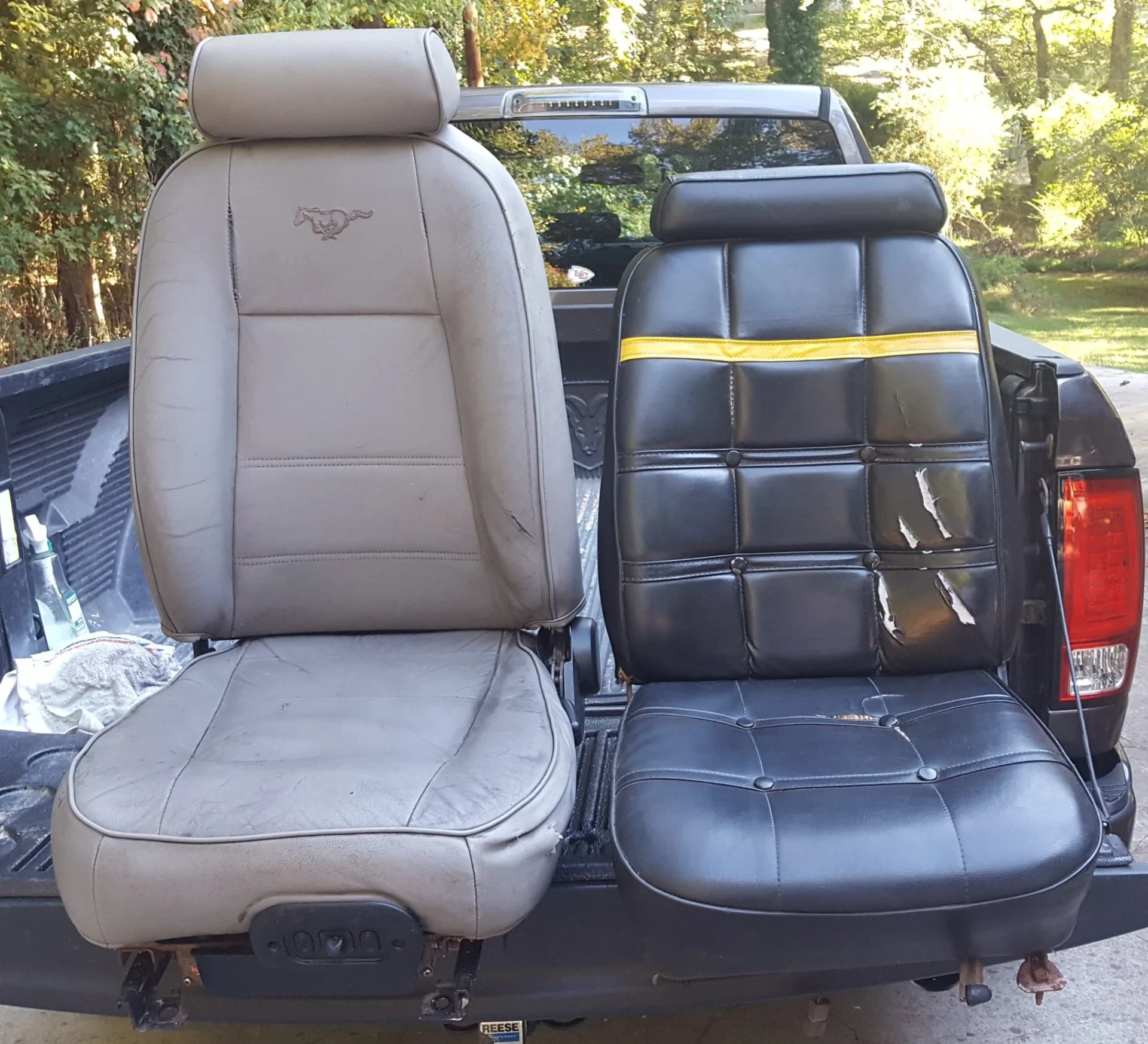

Spent about an hour out working on getting these seats ready to go in. Found that the II's seat tracks are not a bolt on affair as I thought they were. @Enzio - what trick did you use? It's looking like there needs to be some sort of offset bracket made and maybe risers of some sort to accommodate the II's tracks.
I'm back to having trouble uploading pics again, I'll have to see what I can get done on my laptop later....

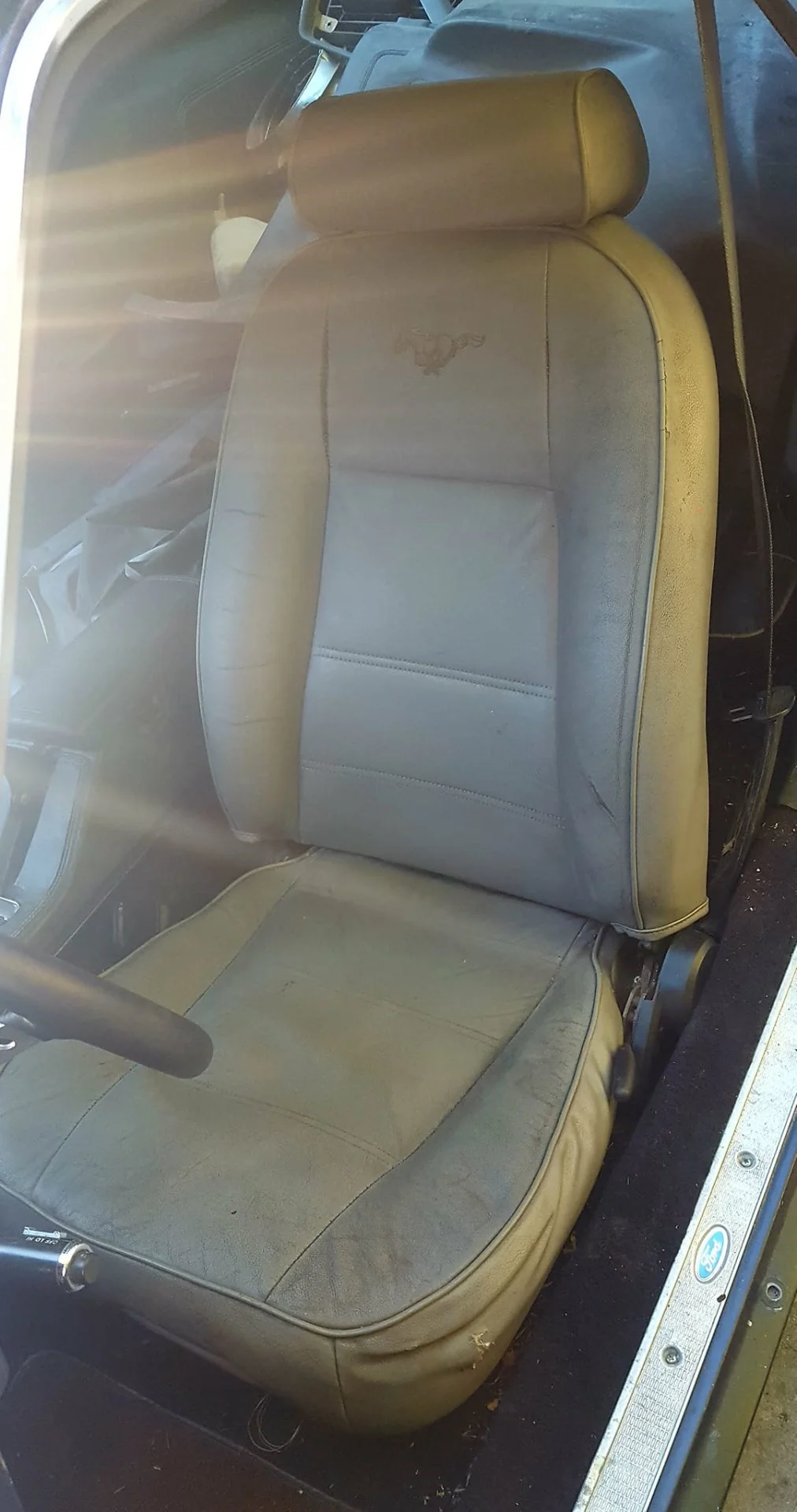

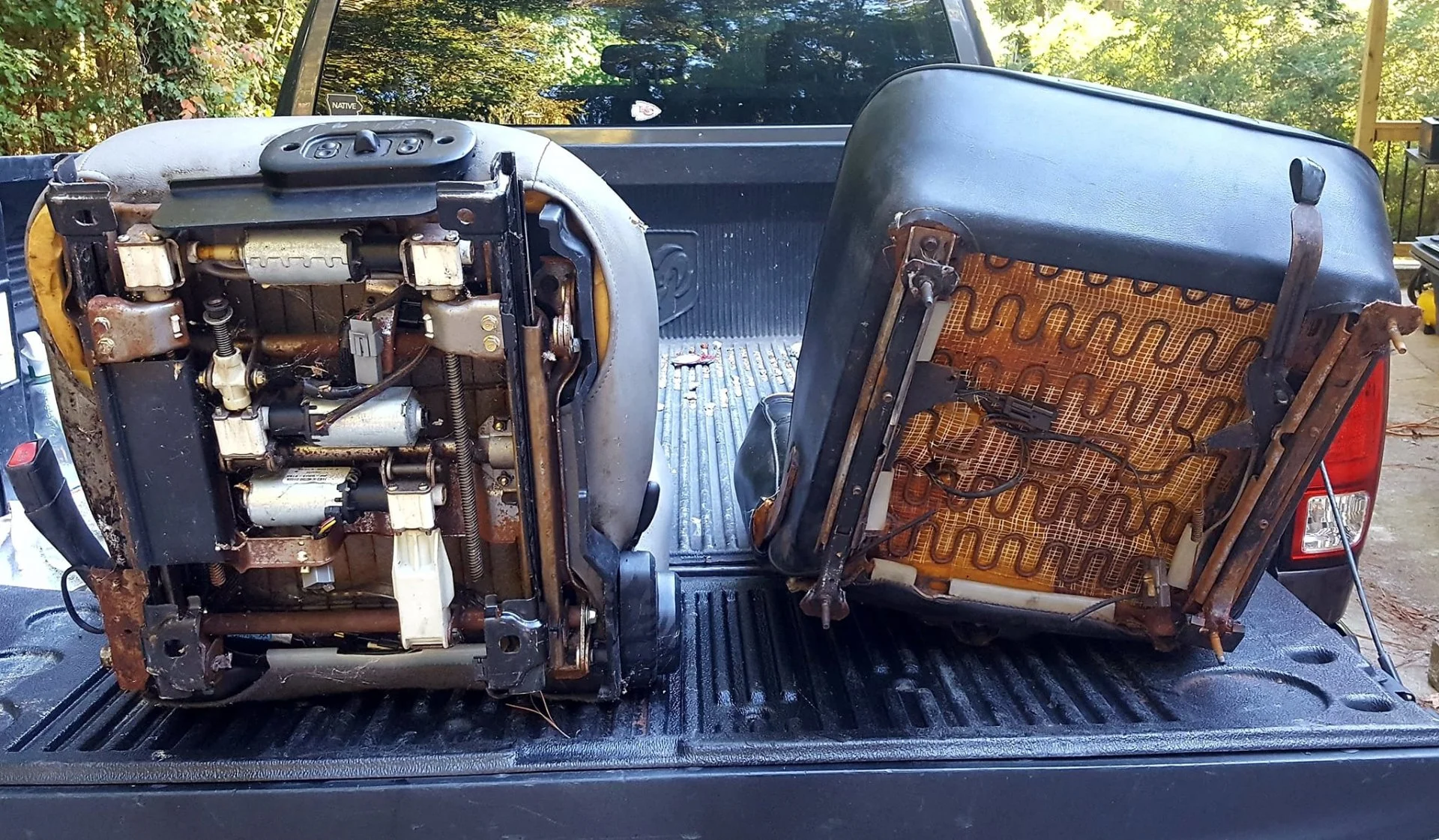

Attempting to load the photos I couldn't get done yesterday.....
Here's the comparison between the original II seat and the late model after cleaning them up.

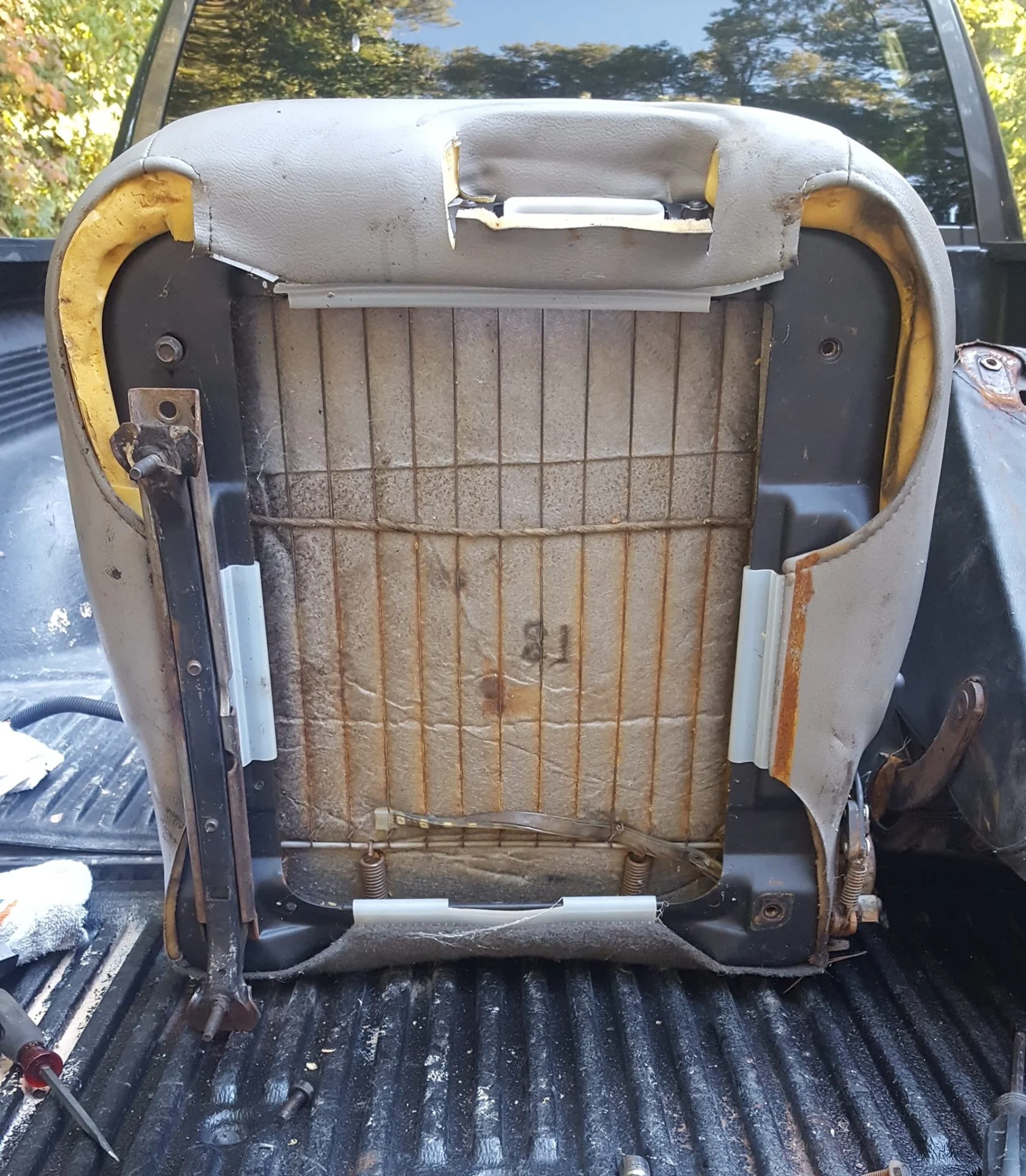

The underside, obviously before I pulled the power mechanism from the newer seat.

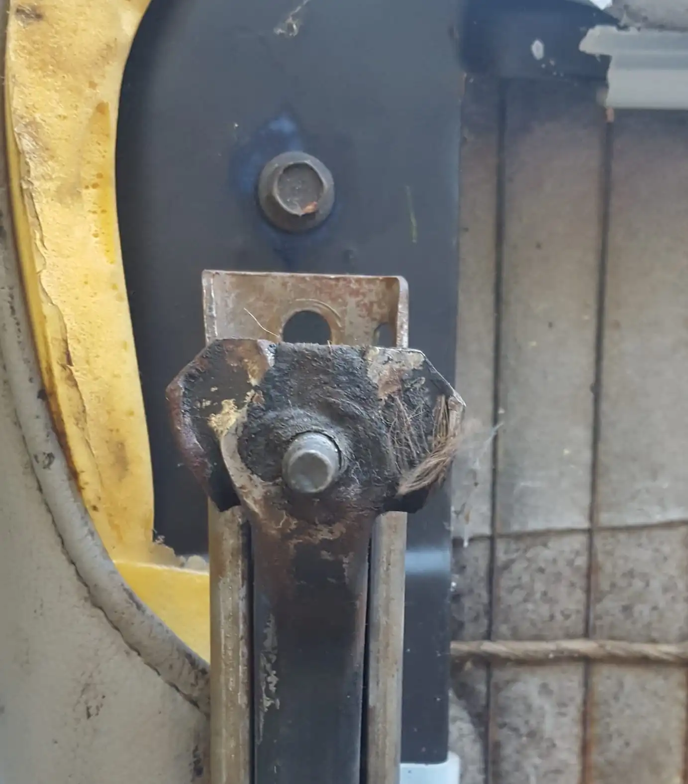

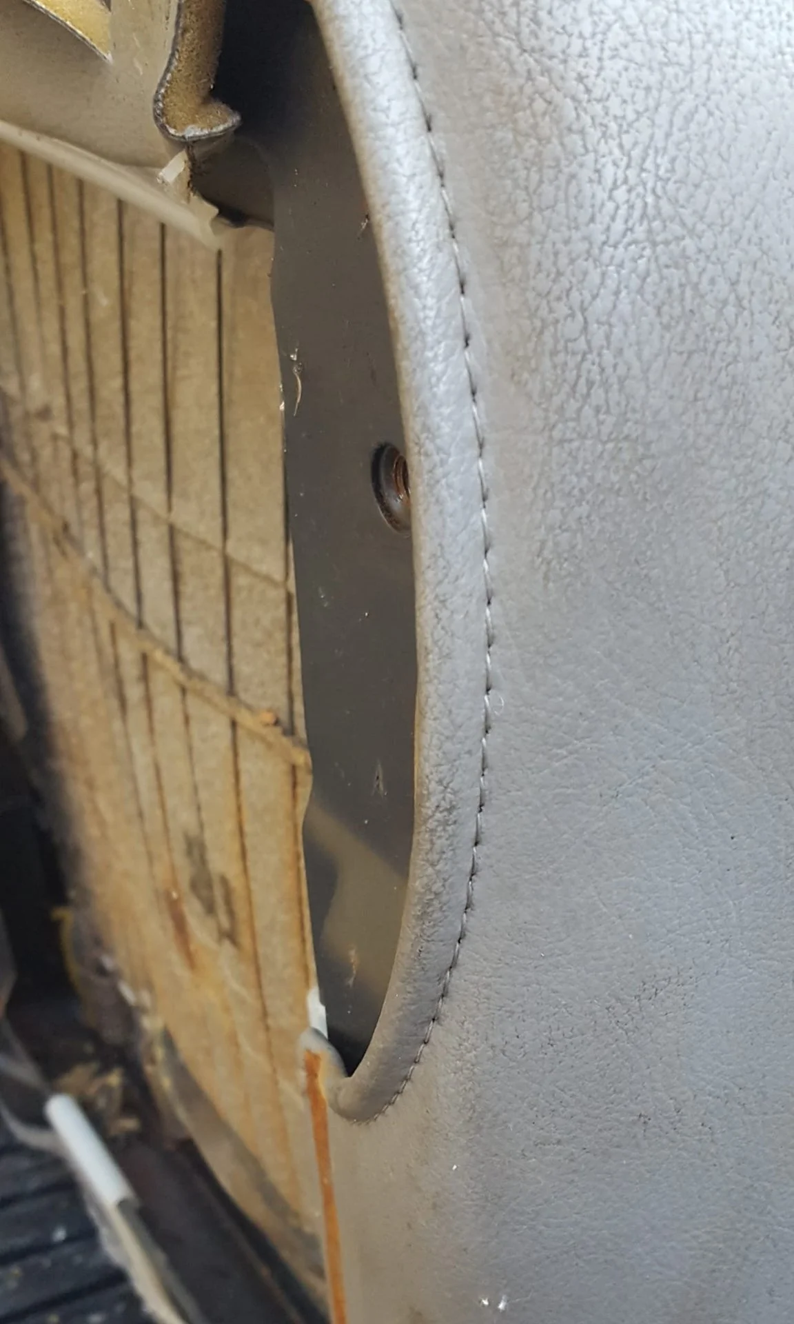

I ended up breaking one of the mounting bolts off in the old seat.
I then attempted to bolt the II tracks onto the new seat. The bolt spacing is off by about an inch. It is also offset height wise, with the back being lower and the front being recessed. The II tracks have a radius to them that is raised in the center which, in this case, hits the seat bottom. (I didn't think to take a pic of that....)
The front mount location:
As you can see, the hole doesn't line up with the seat bolt location AND needs some sort of spacer.
But here it is sitting in the car. It almost looks like it was made to go in these cars.
I have some work to do, but I'll get them mounted in there!

It's been a long time. I didn't have to do anything to the passenger (non-power operated) seat. Just remove the old rails and slides and replace with the original II rail and slide/ratchet.
On the driver (power operated) seat I had to remove all the power equipment other than the lumbar air pump. The right side of the rail went right on same as the passenger seat. The left rail took a little bit of work. After removal of the power devices I had to add a spacer and then buy a longer bolt on the front left attachment point. I think I just used some fender washers until I had it level with the other side. (always ment to machine a solid piece in there but it's still working fine) It bolted right in.
As far as the mounting holes on the seat. I think there were multiple holes on the back side of the seat. They were hidden under the folded upholstery? Once I found those then the bolt holes lined up with the original tracks.
I may be wrong as I said it's been a long time. At first I thought I had waisted a bunch of money.

Finally had some ambition and nothing else to do, so I went out and got the driver seat installed. Just a quick heads up in case anyone tries this and runs into the same issues as I did: the distance between the seat mounting holes in the floor is about 14 inches. What I did was went to Home Depot and picked up some 1 inch square tubing with holes punched into it every inch. The holes just happen to be the appropriate size for the seat tracks which is 5/16. I ended up cutting a piece with the appropriate amount of holes (14) and used that as a fixture along with the old seat tracks. I'll take pics when I tackle the passenger side for illustrative purposes.
