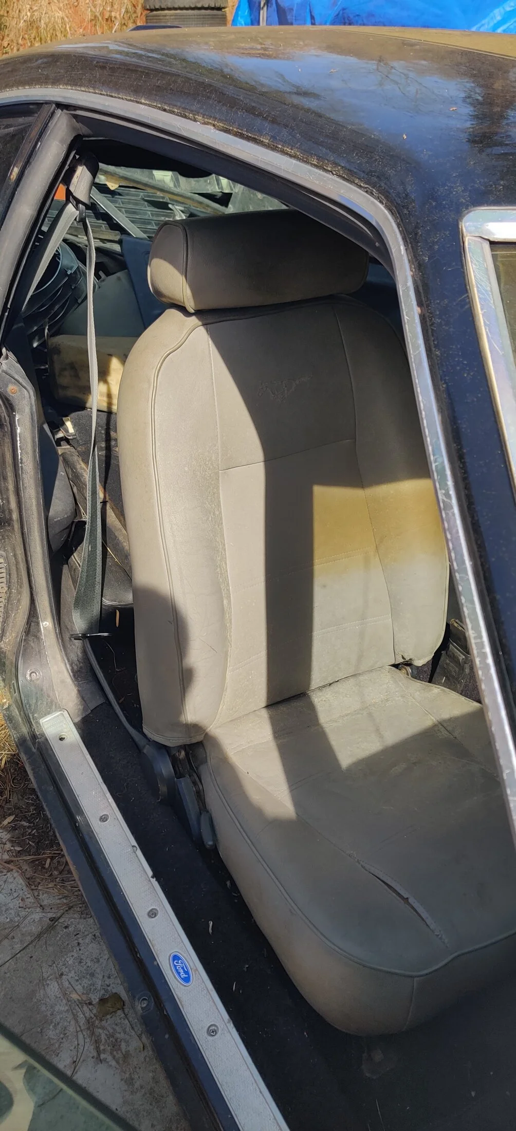

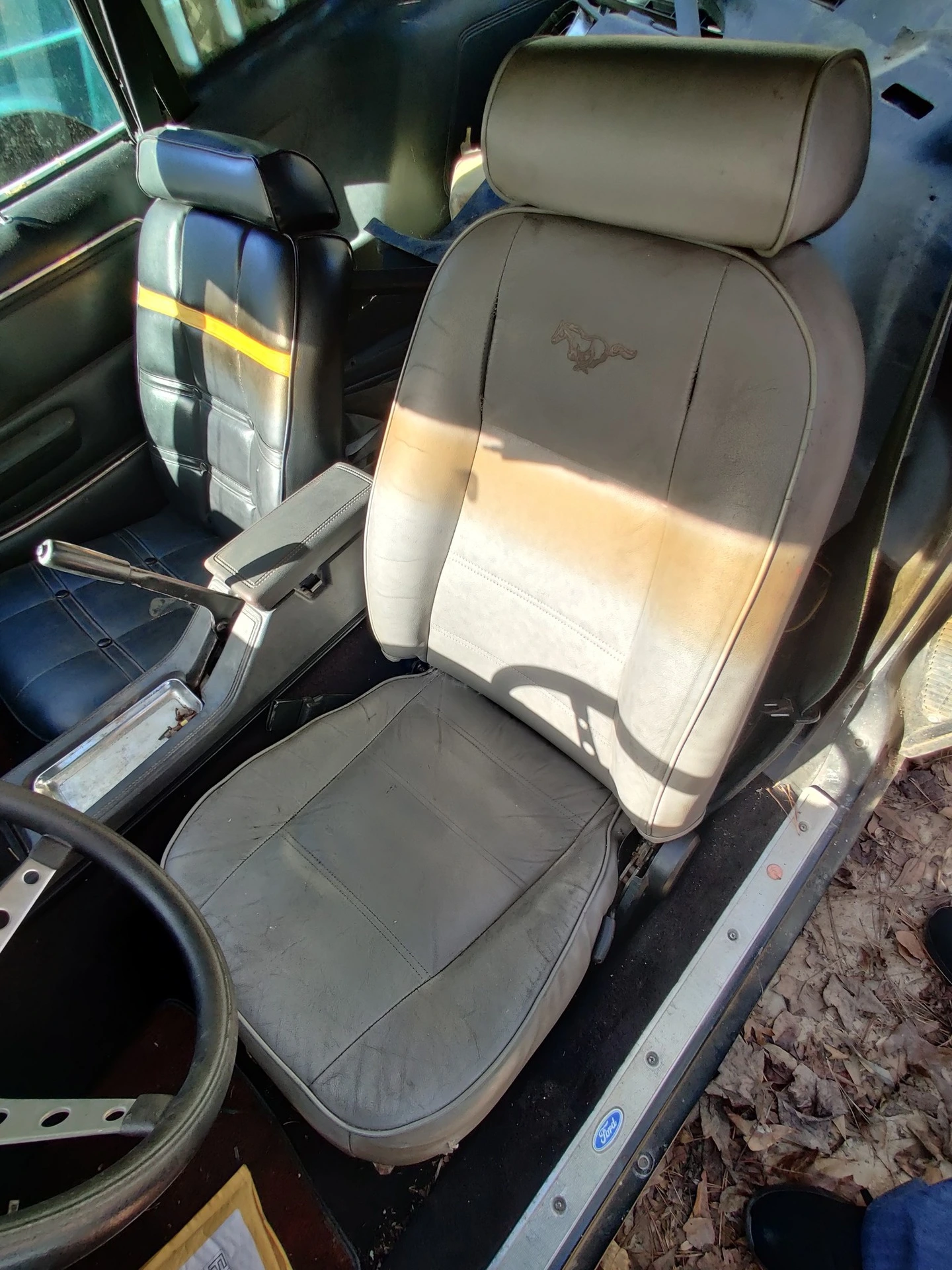

Adding a pic of the seat partially mounted. I need to jack the car to reach the inboard mounting locations.

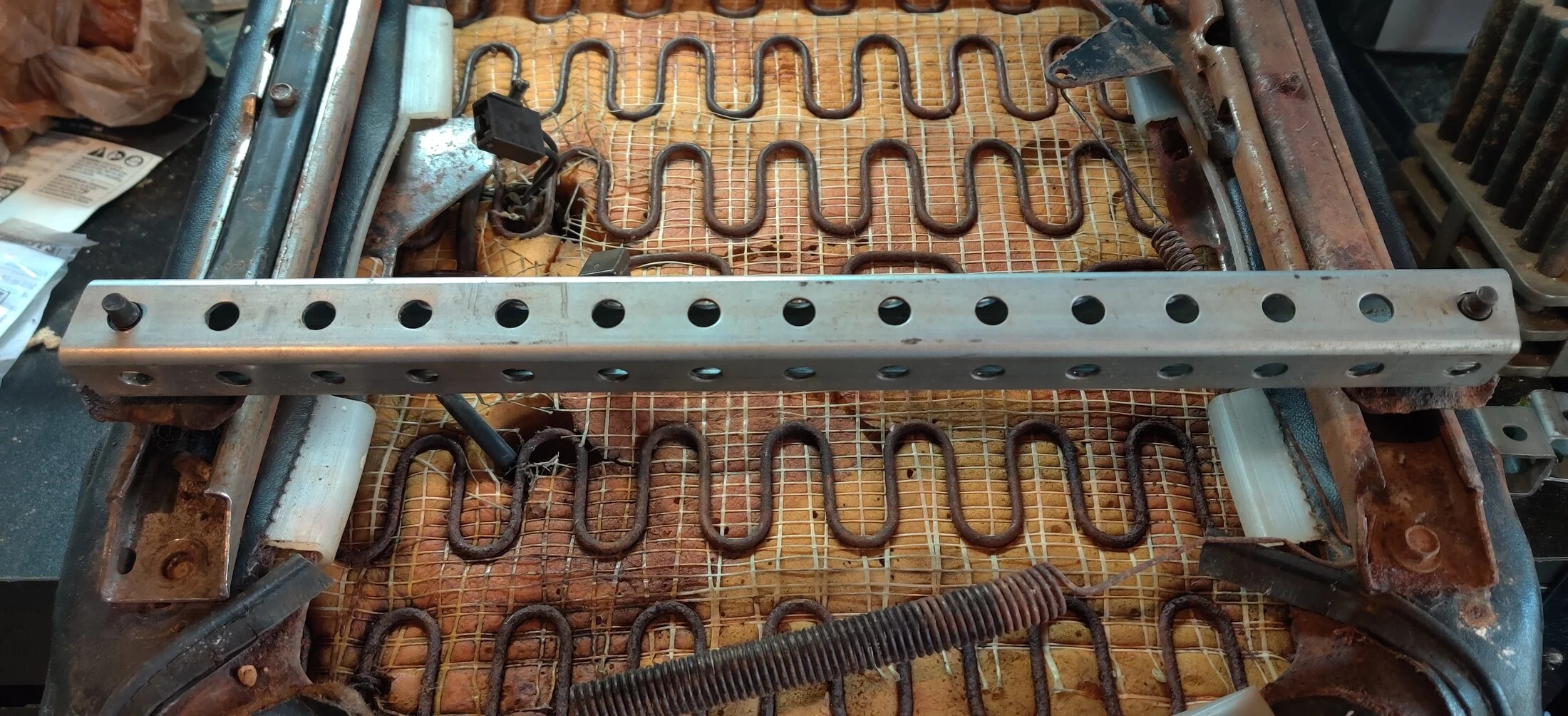

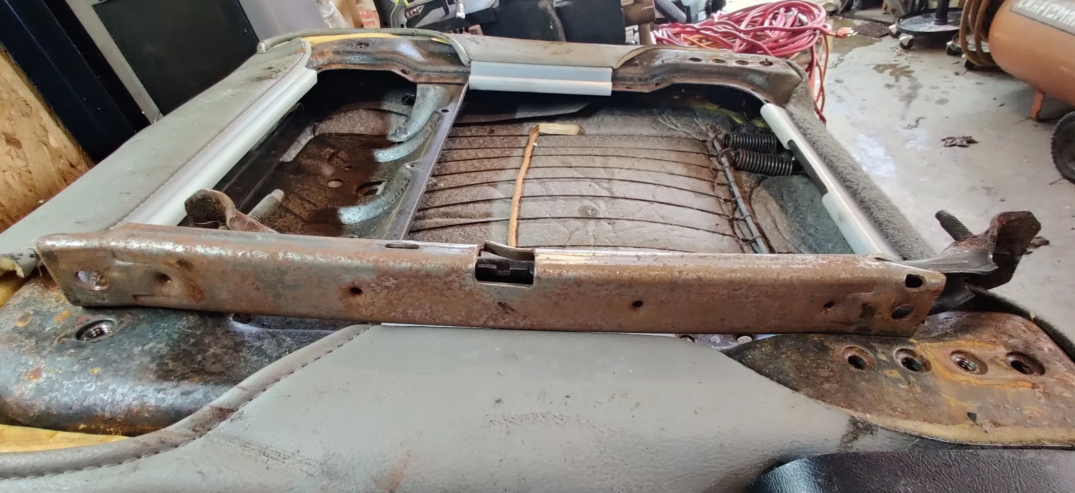

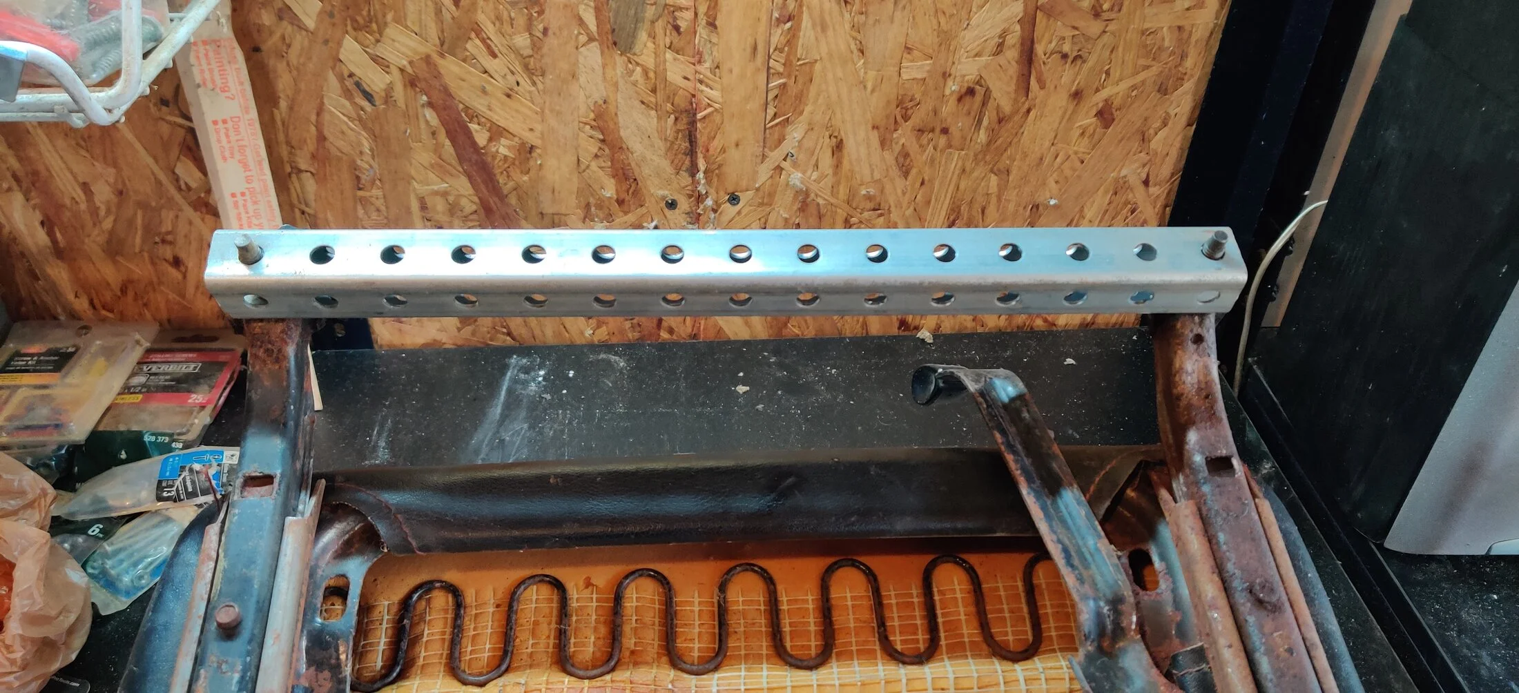

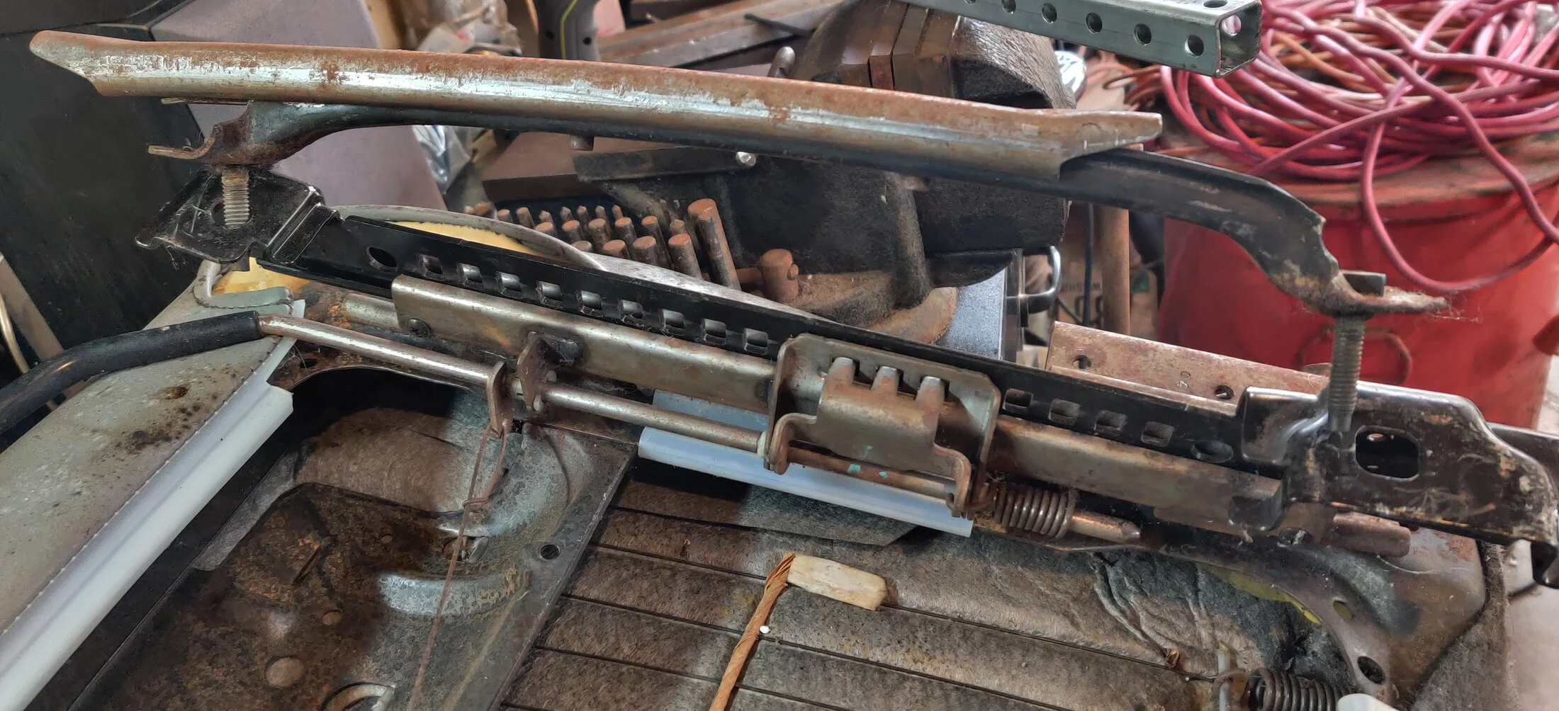

Update: both seats are now installed. The passenger seat has a different bolt pattern for the manual seat track than the driver side had with the power track. I tried to take plenty of pics to illustrate everything....

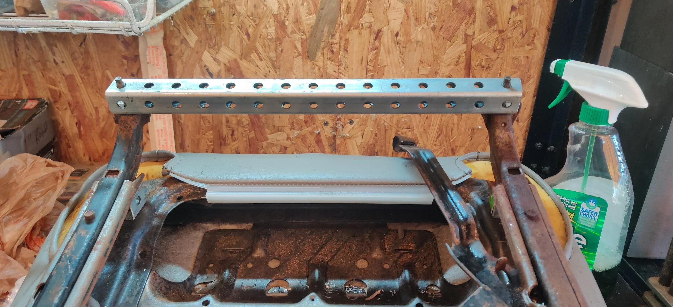

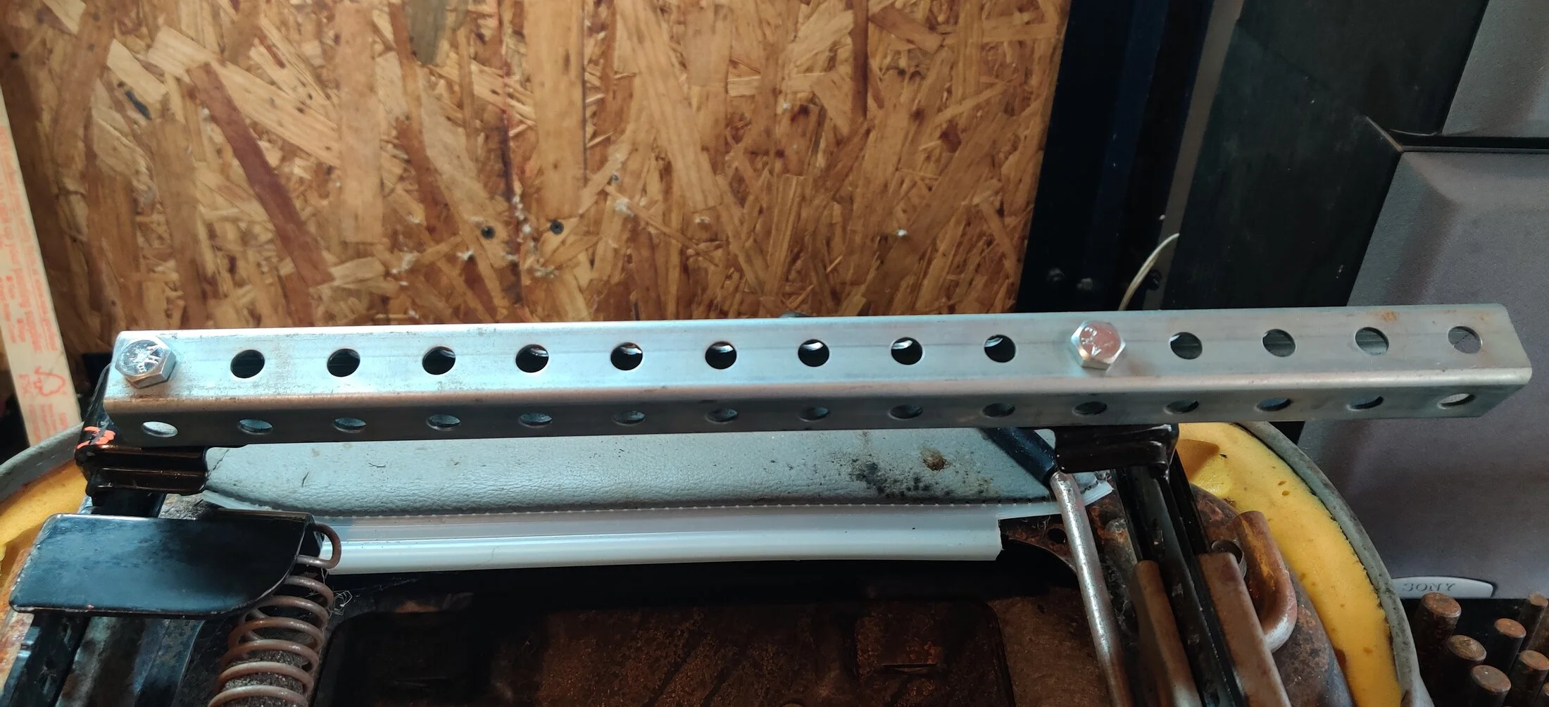

Here is the piece that doubled as the riser and as the locating jig for the mounting holes. As you can see, it worked well. :)
And the back side of the original seat. Notice the broken bolt on the left side. The right side also broke when I tried to remove that rail.

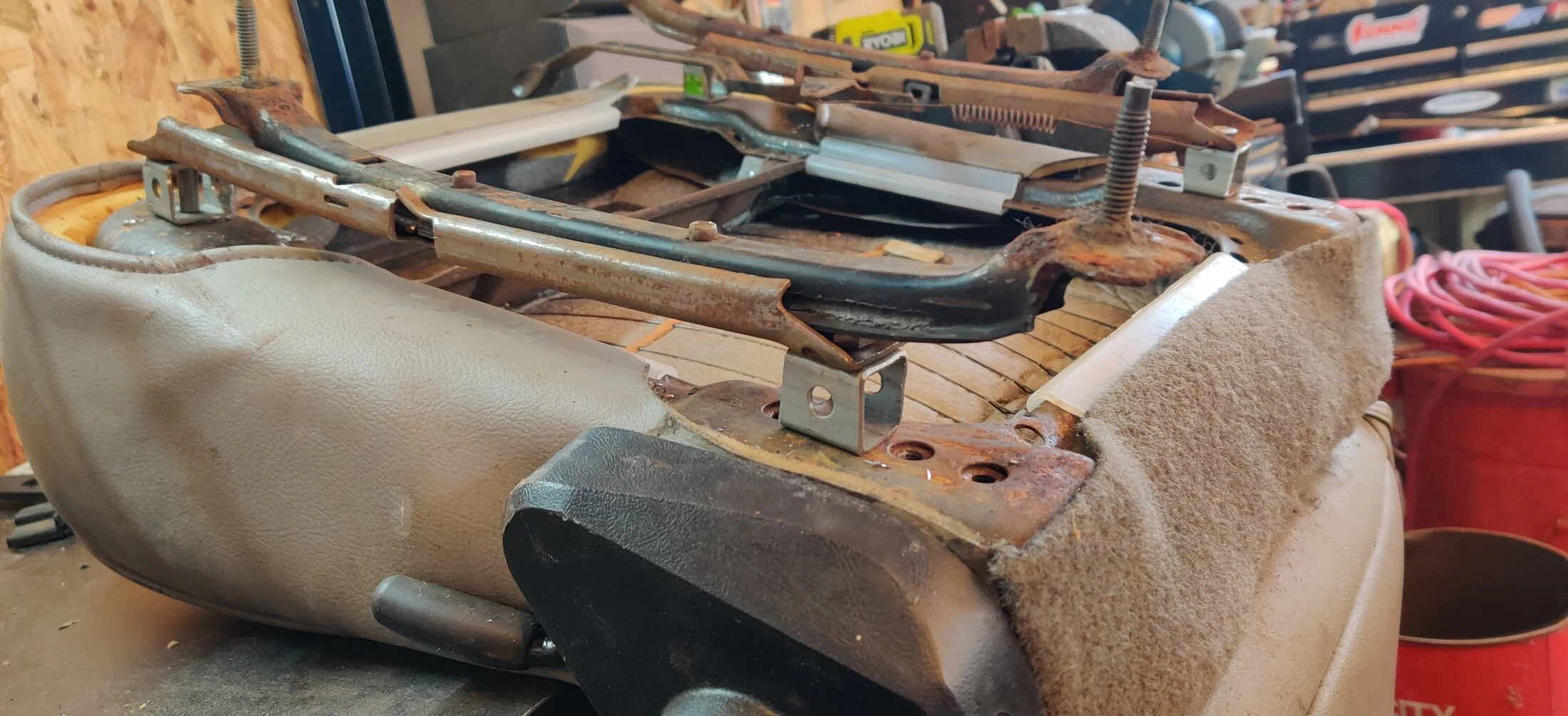

Here you can see the newer track's hole locations are spaced differently. They're also too narrow to try to reuse them.
Here, the new seat's tracks have been removed and revealed multiple hole locations on the back side of the seat. The driver seat was completely different and I had to relocate all of the mounting holes. But as you can see, a pair of them lined up well with the II's seat tracks, I just had to drill them out in order to use the spacer pieces so the tracks would clear the framework.
After getting them mounted, I used my jig to double check the track's mounting stud locations and bolted it into the car.

It does seem to be a little tight against the tunnel. I had a booklet of some kind stuffed between the original seat and the tunnel before I started and didn't remove it until I had the new seat in. It gave plenty of resistance when I pulled it from between the 2, but nothing ripped. I'd suspect that one might have to put in a little more effort if they wanted to adjust the seat, but I think it'll move. I also think that we're going to try a test drive this weekend - my girlfriend wanted me to get it washed so I could take her for a drive last night.

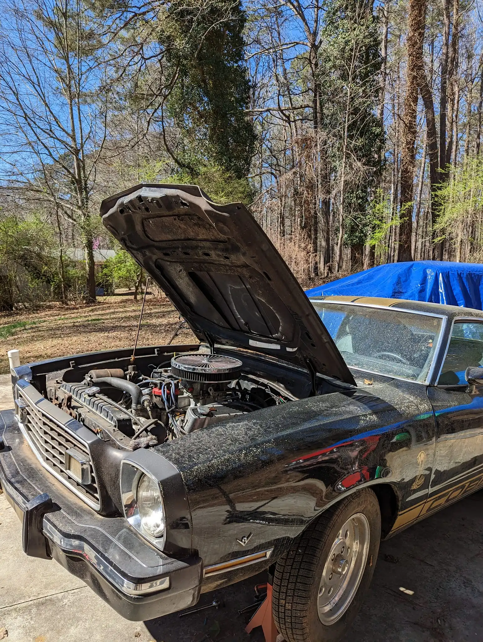

And this is going to be a no-go now - went out to start the car and it won't start. It cranked 2 separate times I turned the key, then it wouldn't on the third try. I could smell some kind of hot electical component when I got back out to double check the battery connection, and the cables were a little warm. I checked the battery and it read 12.2v, then went ahead and tried jumping the solenoid with the key off to make sure there was no other kind of electrical load affecting anything, and the solenoid just clicked once. Looks like I'll be hunting for a new starter now.... anyone have any suggestions? In case you don't remember, I still run the II flywheel and bell housing. I'd kinda like to try a mini-starter of some sort this time around..... :shrug:

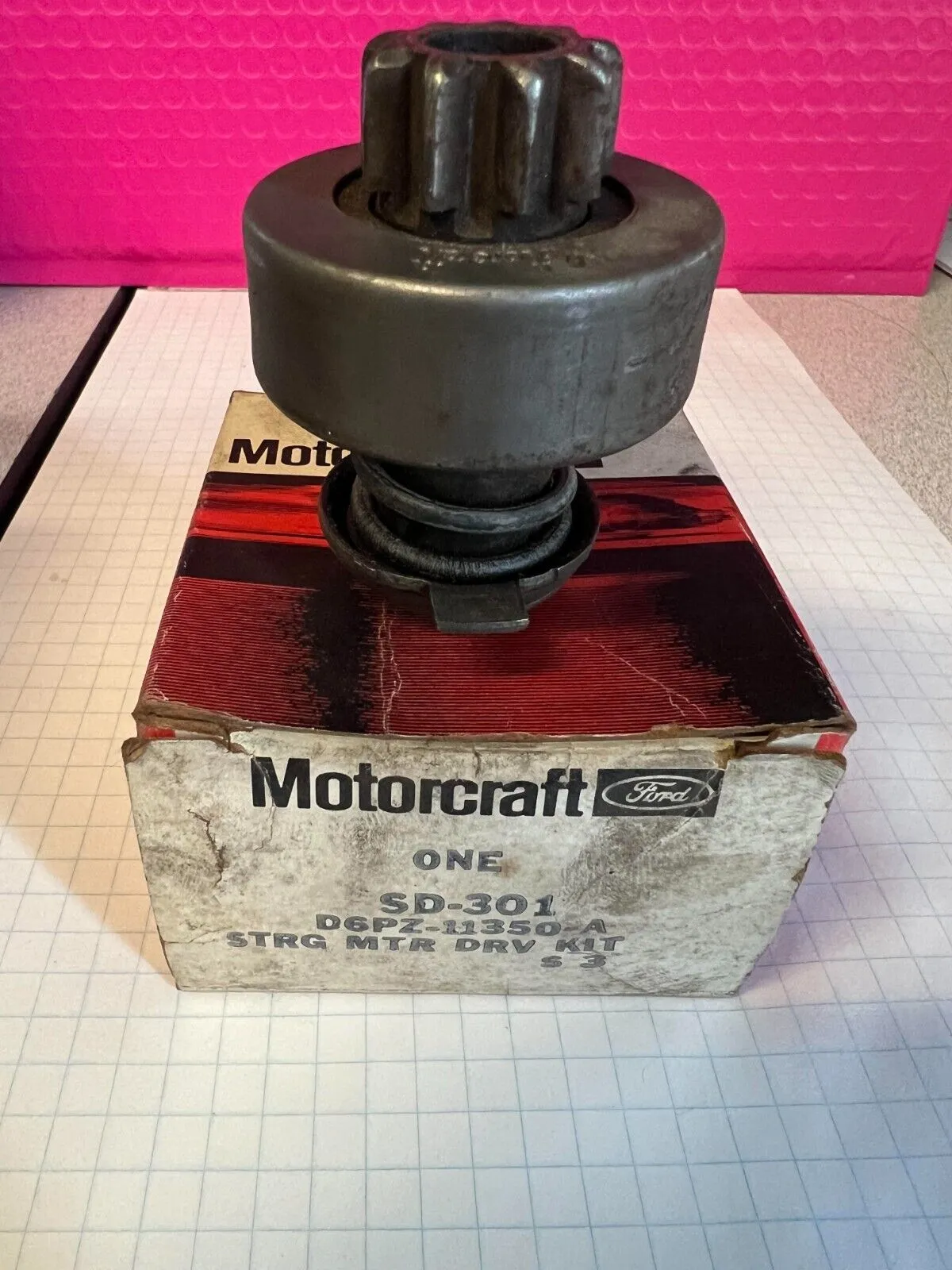

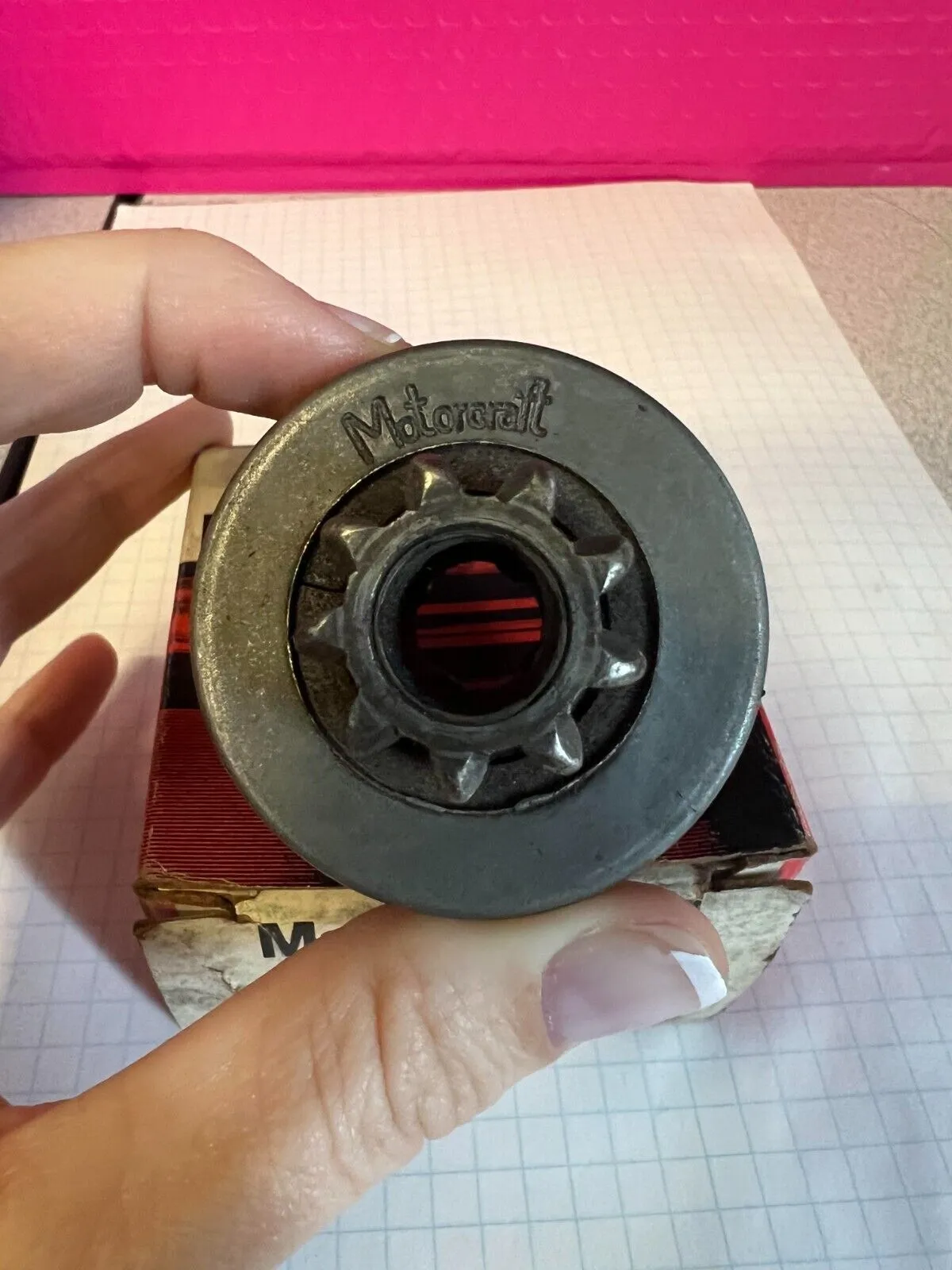

I’m thinking All the parts books are wrong at all the parts stores, the 10 tooth starter will damage your flywheel or flex plate.
A Mustang II with 302 and 141 tooth bell housing needs this 9 tooth drive.
Would be swapped onto a Ford 10 tooth starter of that era.

You've brought up an aspect that I don't think has been explored in a long time - at least I don't remember it being mentioned anywhere. I did some more searching and found a couple threads that might be relevant.
In this thread, Gael mentioned that he counted his drive teeth and found that his had 9 teeth.
Then, a couple months later, he posted this thread and said that both his starter and a new mini starter that he went with had 10 teeth.
:confused:
Another couple of threads mentioned a couple of different things. First, there was this thread talking about the different cone depths.
Then, there's this thread which states in post #6 that the automatic flexplate has 141 teeth whereas the manual's flywheel has 148 teeth. :O_o:
https://stangnet.com/mustang-forums...rters-work-with-our-smaller-flywheels.502778/
Then, there's this one that mentions the gear pitch which makes a lot of sense if you think about it.
Then, finally, we have Matt's suggestion for using a late model Fox or SN95 starter when using a larger oil pan.
Now, it seems that most of the problems people have with starters concerns using them with the automatic's flexplate. In one of those linked threads someone made mention of having a manual and being able to get a starter that would work at any time. And, in my experience, I think that's most likely true. I don't remember having any of the problems that I see mentioned all over - but then again, I've not had an automatic transmission since the mid 90s. SO - what I think I might try is Matt's suggestion and go with a Fox starter. I know they're a little smaller than the stocker and shouldn't be some outrageous price compared to an aftermarket high torque mini. Looking at this guy here:

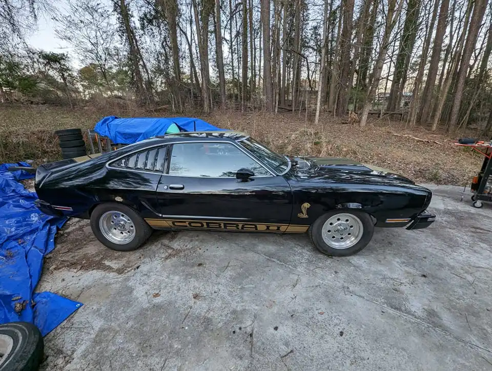

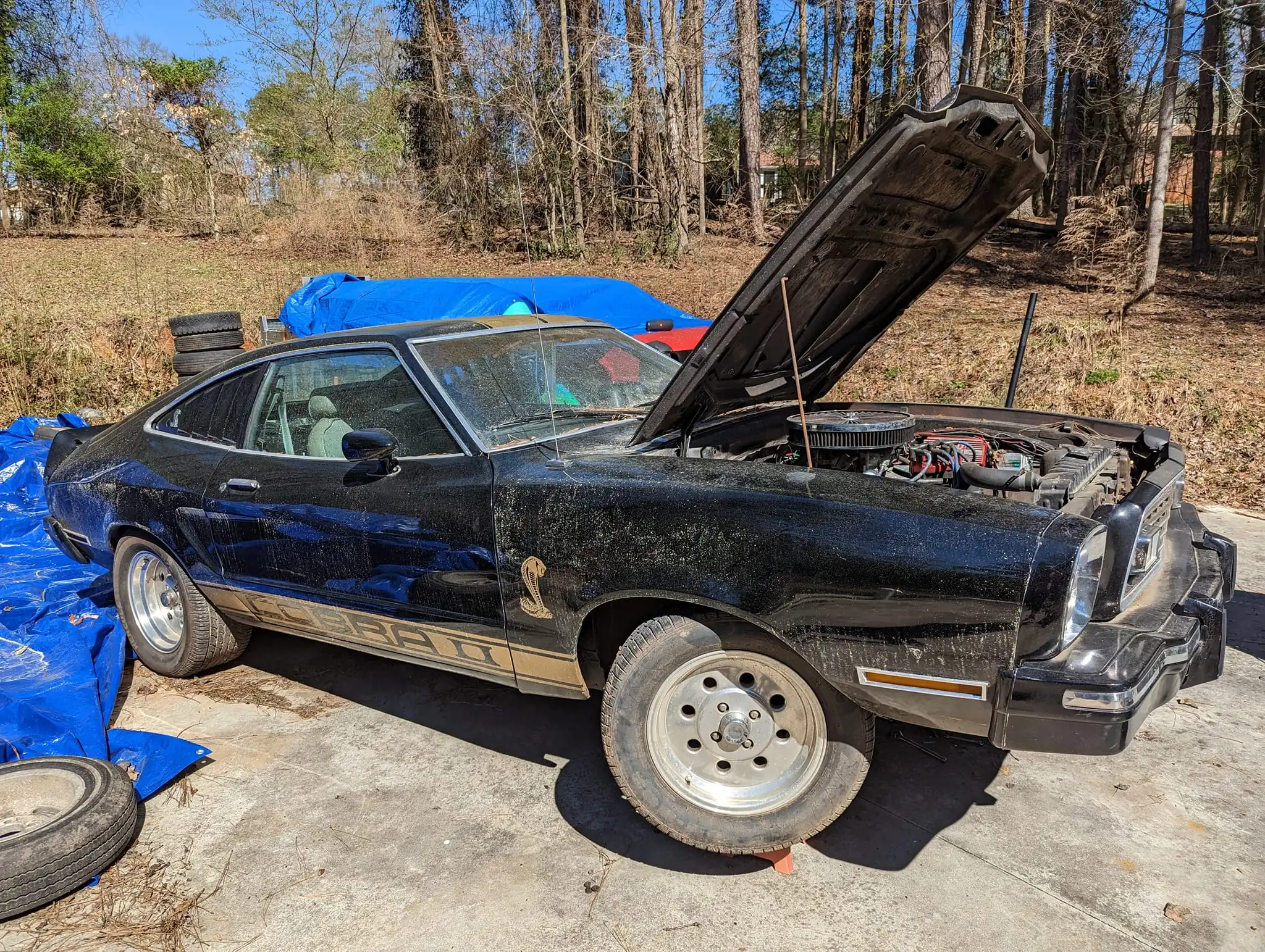

Can't seem to get the videos from her FB page, but here are a couple of the "before" pics she took while I was working on it.
And another after a wash.
