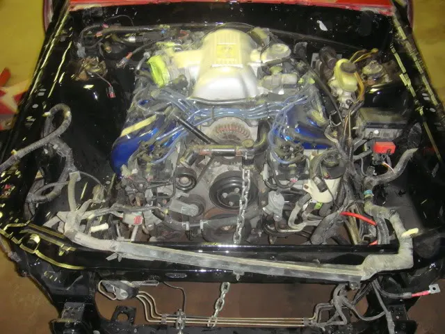

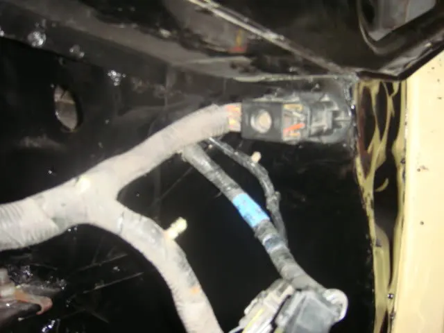

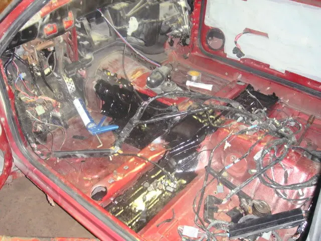

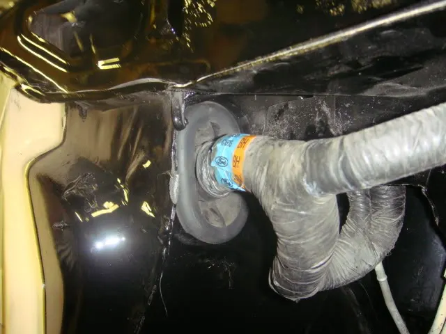

Got all the spagetti out of the storage bins. I had to cut two holes in the outside firewall area to get the ECM harness inside and the dash harness.
Also got some other things hooked up and plugged in. Just need to start laying all out and get everything where it needs to be next.

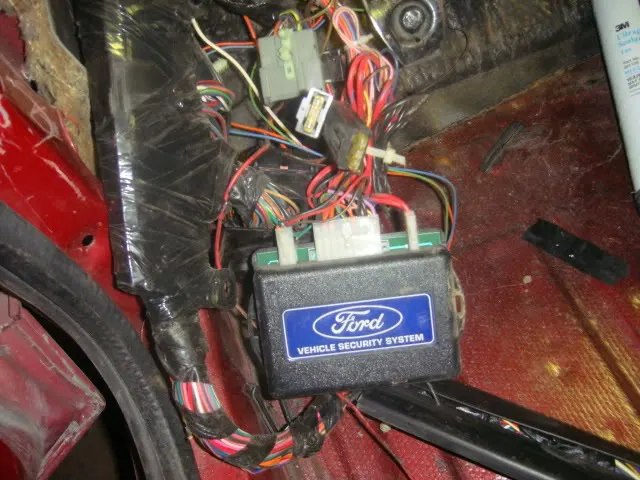

And this crap. Why would anybody install an aftermarket Ford system? These cars already have PATS. I really want to take this out. It's mostly just tapped into other wires. There are a couple wires I'll have to solder back together tho. I should prolly get it running with this thing installed, and go about removing it afterwards, just to be safe.

Lookin good Matt!!!!! The hard work seems to be over no? home stretch!

Thanks bro. It seems so. I can't wait to put down the 3" cut off wheels, the welder, and my thinking cap. The rest should go in like a normal car...til I get to the door wire harness. I'm gonna rewire the mirror switch to the speedo bezel again, and put the SN95 mirror plugs on the fox mirrors and the fox lock actuator plug on the SN95 door harness. LOL...lots of soldering that day. Hopefully it will run within 1-2 weeks. Depends on how much time I get and how much motivation I have.

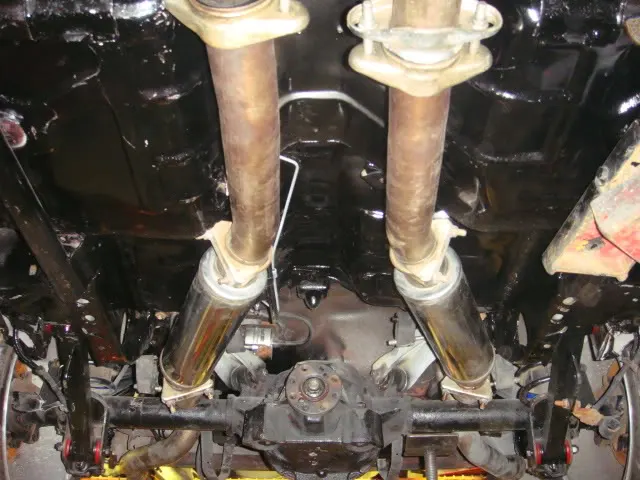

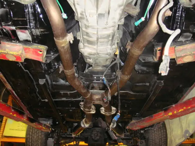

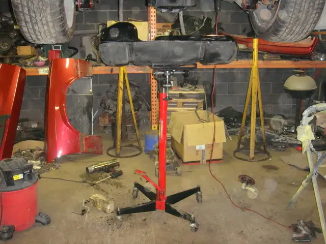

Anyways. Got the exhaust on, got the oil and filter in, got the tank in, after I POR-15'd the whole thing. Also got the dash wired up and re-installed.
Fluids....didn't get around to installing the radiator or antifreeze yet, or transmission fluid...that's next.
Bassani X pipe
Magna Flow Magna-Packs. One tail pipe is bent, but I'm gonna take care of that when the Cobra bumper gets mocked up.
SHE'S ALIIIIIVVVEEE!!! The car is WAYY TOO LOUD. Magna Flow Magna-Packs are crazy. I am backed up to a wall inside a building, so I'll see how it is outside in a couple months and decide what to change. http://s184.photobucket.com/albums/x258/svt32vdohc/4-Modfox/?action=view&current=MOV00807.flv
