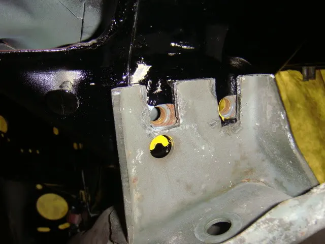

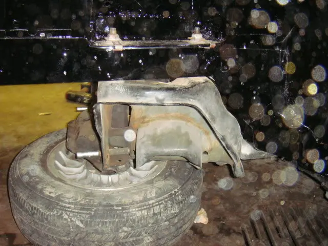

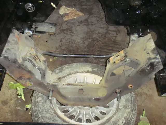

I modified the K-frame this morning out of the car. Had to cut those hole bigger in the rear where they bolt under the car. MUCH easier this time than on Hack Job. On Hack Job, I cut the tabs down but didn't touch the holes. I had to do it in the car on Hack Job and what a 2 hour PITA with a hand file. I worked on these for about 20 minutes with a sawzall and my 3" grinding wheels. Done! I even bolted it back in the car again and everything lines up. I just need to add some small washers to those bolts since you gotta take some metal off each side of each opening.

1990Coupe said:
NICE! Need mo pix yo!
BAM!
Holy Orbs!!!!!!! I hate those things.
And yes, this K-frame will get power washed, and painted, don't worry.

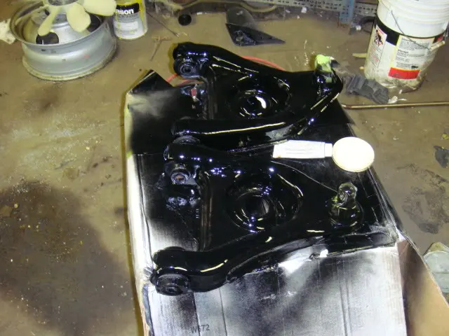

Single Staged the LCA's too...why not? And they have MOOG 94-04 ball joints.

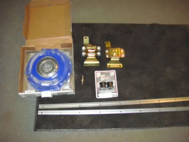

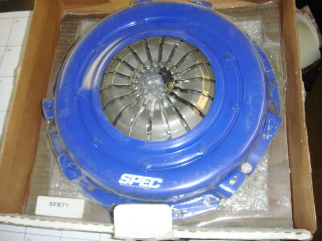

Spec clutch came in. American Muscle sent it. Ordered it Monday at around 1:55pm and it's here now. That's less tha 48 hours!! Props!!!!!!!!!

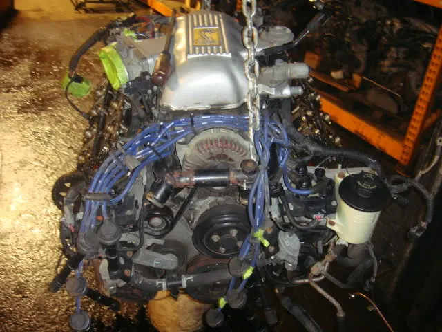

Cool build up man. Car looking GREAT!!!! Di notice on one of the pics that you are also swapping the dash out. Are you just gonna use filler panels for the airbag spots or gonna put air bags back in?
If you gonna put the bags in I got a set out of a '98 they are tan but I can hook you up Cheap on 'em. lol
Props on the guts to do it a second time around!

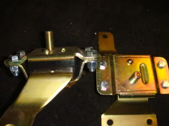

Thanks. I used air bags in Hack Job, but I didn't hook them up. I have an old black air bag for the drivers side from my old Lightning. It just says Ford on it. It was blown so I glued it back together. It looks absolutely perfect. Can't even tell. For the passenger side I'll do the same thing.
Got my LRS parts. It's a shame you can't see the clutch or the motor mounts when they are in the car.
11" Spec Stage 1 from American Muscle. LRS supplied the Poly 1-1/4" sway bar mounts, poly motor mounts, a new clutch fork pivot ball and the new rocker molding retainers. I got 2 other small ones too not pictured.

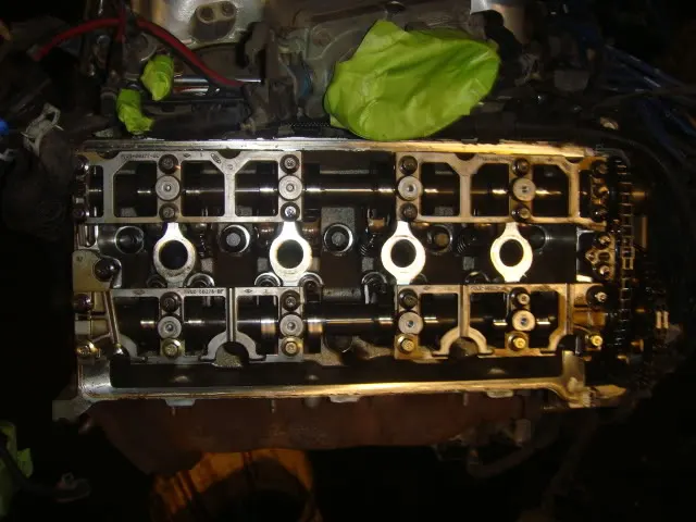

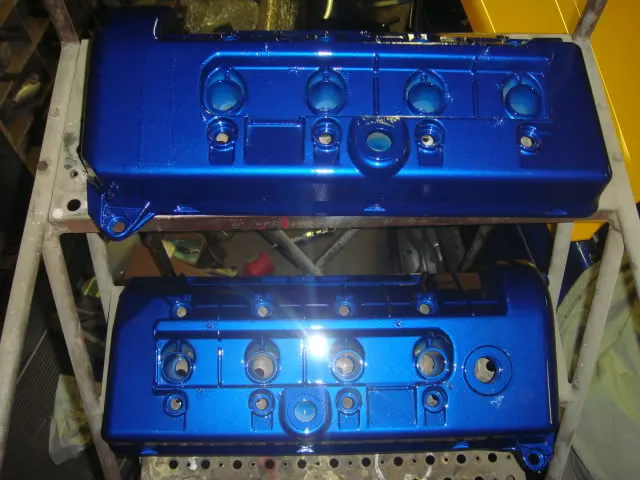

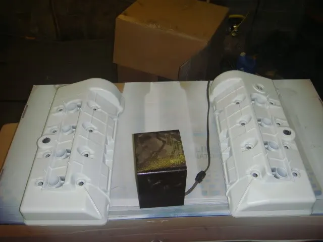

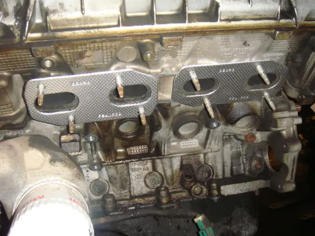

Got the valve covers off, oil pan off, got the new exhaust manifolds and gaskets bolted down, painted the oil pan, painted the valve covers, power washed and degreased the motor. I installed the RH motor mount after modification. The side of the mount needed to be ground down about 1/4" for a 1" long section. It would hit the block and not line up with the holes.
First of all, aluminum blocks suck. I heated all 16 oil pan bolts to get them out. Every single one of them wanted to snap. I got them all out without them snapping or taking any threads. I need to replace about 6 of them since the 10mm socket would just round off of them. I used vice grips to get those out. There is NO WAY somebody could have done this if the motor was in a car. Forget it.
Tomorrow the plan is to reinstall everything I took off today and maybe drop the car on it.
Enough talk...PICS
First I degreased the transmission. Engine Brite Foamy FTW!!!!
Engine was greasy and dirty
After a spray down

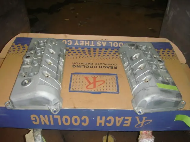

This was before the spray down, so all this grease is gone. Whoever installed the longtubes left out about 3 out of 8 bolts on each side. They are getting sold, I put the stockers on from my old 96.

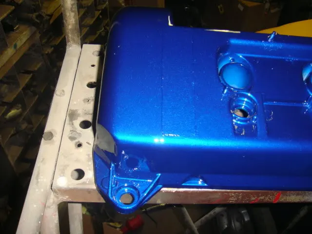

The valve covers had to be the filthiest thing ever. Full of grease and grime and all the silver was bubbling. I degreased them like 4 times and sanded them down.
I knew with how greasy they were that paint would never stick and I'd get fisheyes. So....I found some white paint from an old Explorer and I sprayed that until the fish eyes stopped coming back. I sanded between coats.
Then I sprayed this badass metallic blue. It's a GM color from my Dad's project that he's got going right now.
And of course I taped off the hand signed plaque.

I concur, that color is bad ass!

That blue is badass! It looks like the blue that was on my 03 Silverado, Arrival Blue.

2004 Silverado SS. It's a nice truck, just barely hit up front over the bumper. No frame damage. We already have all the new/used parts bolted up there and everything lines up. It's AWD with 4.10 gears from the factory. Has a CAI and it was a Florida truck (Florida title) Can't wait to take it for a ride. Too bad I didn't have my Lightning still so we could run 'em!!!
I only used a drop of his paint to do these covers so he didn't care at all.
I bet that's the same as his truck. It's a BADASS blue. Prolly the best blue I have ever seen. You really have to see it in person to get the 100% pop of the metallic. The pics above show it off well, but I can't wait to see it in the sun.

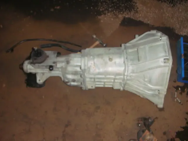

I got everything back on the motor today and I got the transmission bolted back on. It's ready to have the car dropped on it. Wanted to do it today, but I ran into stuff that took me longer than anticipated, plus I left early than I did yesterday. Forgot my camera too, so I'll a couple pics up tomorrow.
