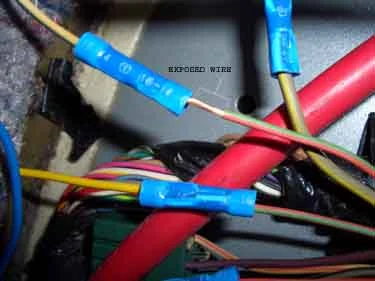

OMG It now has finally quit surging and stalling....after weeks of going through the helpful....let me rephrase it Very helpful list....I located the computer and found some wires and when I looked close one wire had been pulled out of its connector..i DONT KNOW WHAT THAT WIRE CONTROLS BUT....probably from someones foot on the carpet pushed it out...so i extended it and replaced the connector. reset computer let it idle and it doesnt surge. So that with the combination of cleaning the mass air element fixed it... Im crossing my fingers... now that ive found my eec test connector up by the mass air im going to dump the codes...
Thanks ALL RIP Dragon:lol:
