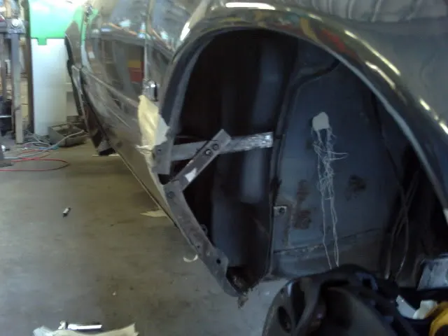

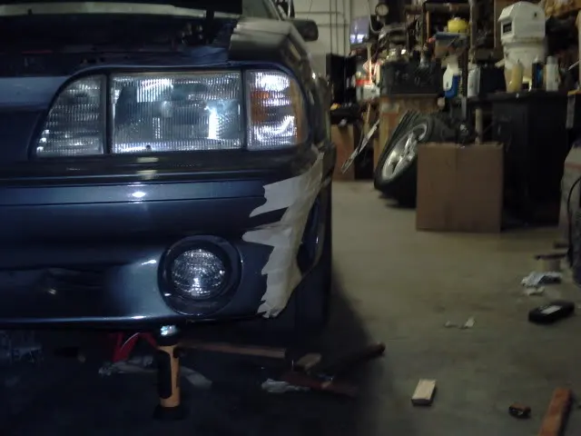

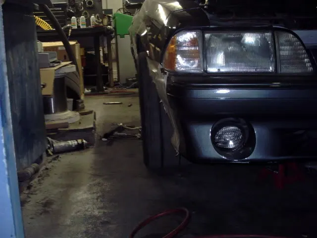

Oh yea, i did use to have a buidl thread didnt it, then certain people started to queer up the site so i stopped updating it . Even those pictures are old and dont show the latest updates to the car like the floor mats and MC-Machine cluster with cobalt gauges.
In short though, i used 1" wide steel bars with double threaded eyelets attached to them, i cut off all the portions of steel behind the front ground effects and most of the excess plastic on them too, 1 bar was made to push the fender out and another was made to oush the ground effect out. The back portion has the part behind the side skirt cut till about 1/2 from the fender edge and 2 more bars are used to push that portion out, in total its about 5" of clearance i gained to fit my 275/40/17's

Neat idea! I think I can use something like that on my '88. Although my fronts are 245-45-17 and should clear, they rub on the front edge of the inner plastic both while parking and on g-outs over big dips. I want to put my drop springs in, but it already rubs at stock height so I gotta fix that first. Thanks for the pics!
