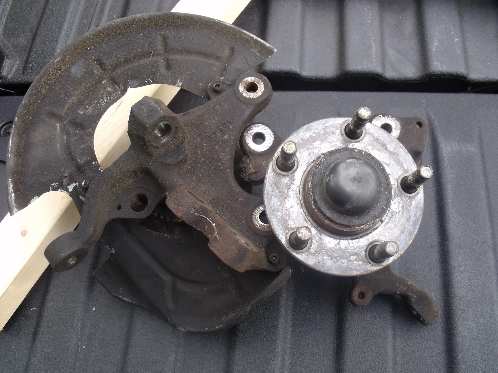

They are still out there.... Pulled these out this am from a 95.. $80 out the door......
EDIT.. I looked at my final bill and it was around $70 total......

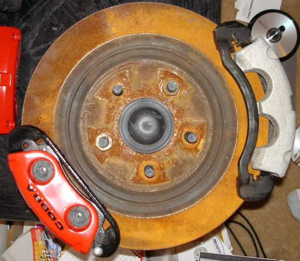

They are better than fox calipers, but there are better options. I’d snag a set of 99-04 GT/v6 calipers off a different car after you get the spindles off the 94-95
so tell me about these GT V6 calipers?? I have been looking online and I find a two piston caliper but I do not find anything specific Gt/V6.... What is better about this set up?? TY
They were standard on the Gt and v6. It’s basically the step in between stock and the cobra brakes, in terms of upgrading our foxes.
Find any 99-04 V6 or GT at the wrecking yard and you’ll find them. They fit the smaller 10.9” rotor and look like this
cobra is the red caliper and GT/v6 is the natural finish csliper. Ignore the fact they are sitting on this rotor. The Gt/v6 caliper won’t work with 13” rotor
keep in mind, when these calipers sit a long time the Pistons can somewhat seize up. So make sure you test the Pistons in the yard. Press them in and see if they move easy.

For $35 each for 94 spindles Id be scooping up as many as I could. Selling for $200-300/pair on eBay
I checked my local LKQ, and they list spindles with hubs as $26.50 plus a $8 core charge. I think I'll be checking their site a little more often. No not for the flip, just if other foxes find their way into my garage over the years to come.

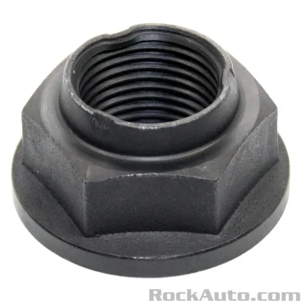

Sooo, a question about the 'caged" nuts that hold the hub to the spindle.... I read where those need to be replaced each time?? is this correct?
I was trying to find a set of these " caged nuts" and all of the pictures with this part does not look like what I took off these spindles?? Seems to be a metal cage around it and the replacement nuts do not have them??
Just like with nylock nuts, the locking mechanism will slowly over time loose the friction that creates the lock. The caged nut does a similar locking function. But really when you are putting well over 100 ft lbs of torque to tighten, I don't think the locking function is really needed. If worried, re-torque it (check it) every couple months.
