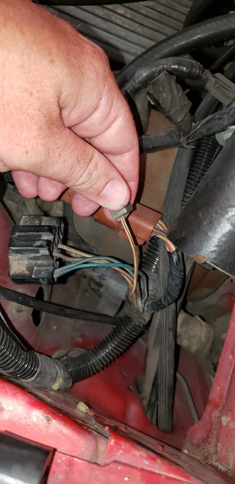

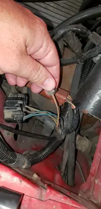

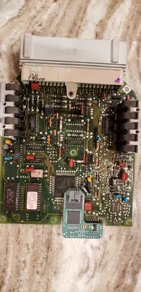

There are two little plugs that plug into the tester. The dog house shaped one and two others lay in that corner. One is for the hood light...i think its an orange wire but could be wrong....the other is the fuel pump test connector. You want to plug the latter in the tester. I've seen several people make that mistake so thought I'd mention.
Almost all the fuel pump power wiring for any ford is pink with black stripe...but I'm not completely sure about that connector. I'm at work and nowhere near my car. Wish i could help more man.
