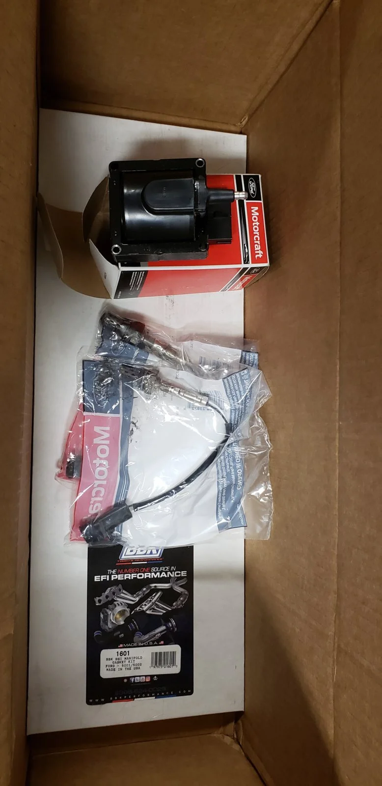

Just a few things that I knew I was going to replace or needed.

Finally got to mess with the car a little bit. Put the new ignition coil on and took it for a short run to see if it helped. The almost dying under hard acceleration and slight surge while just cruising at constant speed seem to be gone. I replaced a MSD unit with a Motorcraft.I also pulled the mass air meter and cleaned the sensor with cleaner specifically designed to clean them, CRC stuff from O'Reillys. I cleaned it after I took it for a ride to test the coil. I still cant pull codes so that hinders things. I'm sure that I'll get it sorted out once in the shop. The car was running good, but the check engine light and check oil light both came on. The oil pressure gauge was showing good pressure and it has plenty of oil in it. Again I cant check codes, but any one have an idea of why the oil light would have came on?

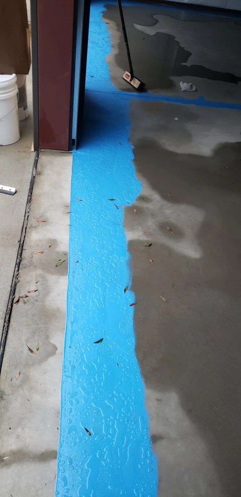

My better half is going to start cutting in the base coat on the shop floor this week. The goal is to get that coat down this week and start on the second coat next week. We have more company coming this Friday, so we'll see how far we can get.

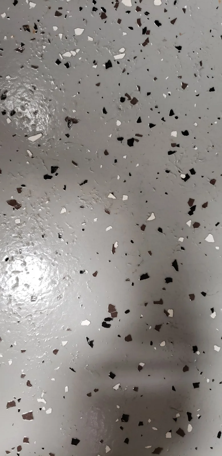

This is a close up pic of the garage floor. You can see the hair that I keep going on about in it.
Not sure how they troweled it. It was already in place before we got involved in the build. This is the garage floor so I wasn't worried about the finish. The shop is another story. It was machine finished and I want it to be smooth. Its gonna be fine. At this point I feel like I'm making a mountain out of a molehill, but I'm committed! Gonna see this thing through.

Good things and not so good things happened yesterday. The misses got fired up and cut in the epoxy on the shop floor! Then 4 hours later that 50% chance of rain 50%ed all over the place. I dont think it hurt anything, but its going to be awhile before we can finish putting the first coat down.

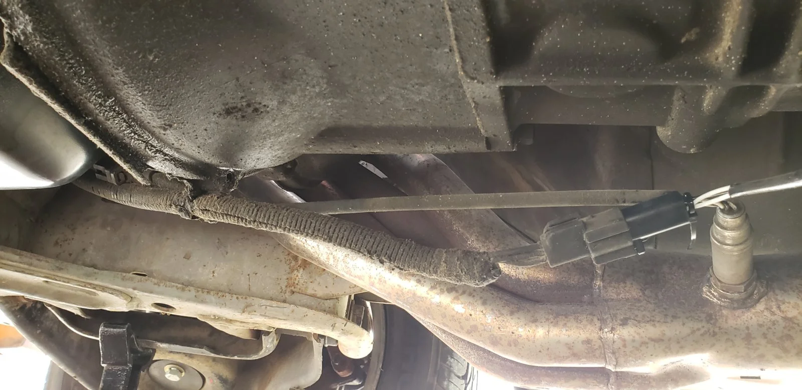

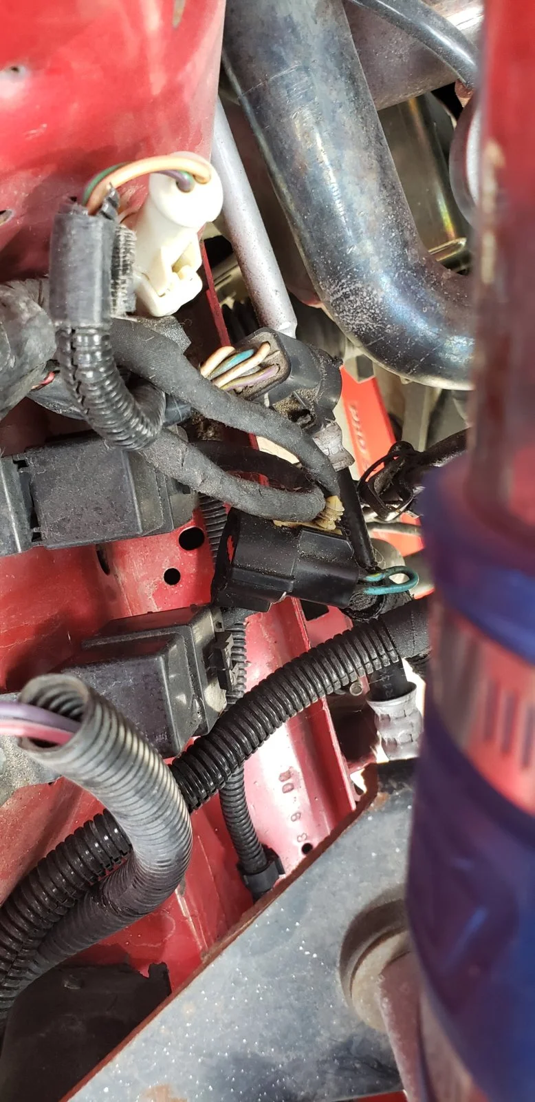

I think I figured out why my low oil light is coming on.
This is exactly what happened before my low oil light started coming on. I bet I pinched the pig tail somewhere. I'll check it out while I'm under there changing O2 sensors.
Got one of the O2 sensors changed, drivers side. The passengers side one currently on the car has a very long pig tail. The one I have is short.
You can see a pic of the one I have already posted in the pic. I'm pretty sure I need to get O2 sensor wire extensions as my car has long tubes and it appears the PO just made it work.
