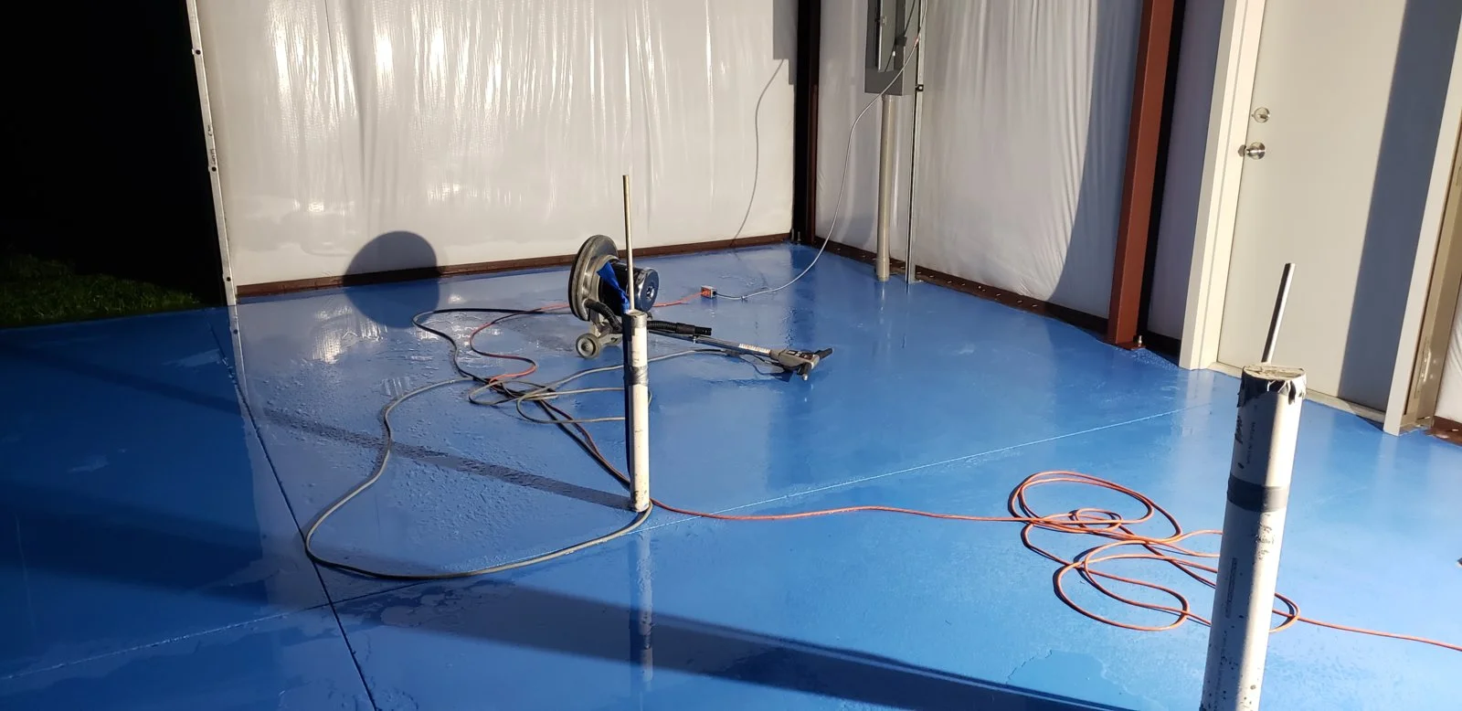

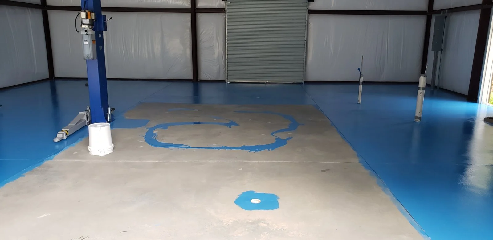

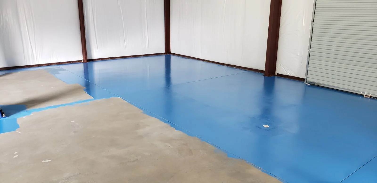

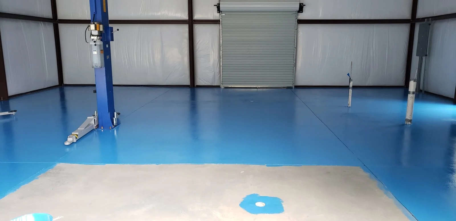

I wasn't planning on working on the shop floor this weekend, but I did anyway. Spent about 10 hours out there yesterday sweating my butt off smearing epoxy all over the place.
The kit I got came with spikes that strap to you shoes so that you can walk around in the wet epoxy. Those things are awesome! If you're ever using them be CAREFUL. They allow you to get around, but have little to no grip. I almost busted my butt countless times. I would have looked funny covered in blue paint!
This is the primer. Next step it to put down the mid coat. Hopefully I'll be able to do that this weekend. Then I'll get the clear coat on top and it will be done!

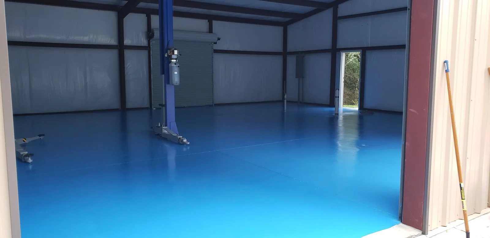

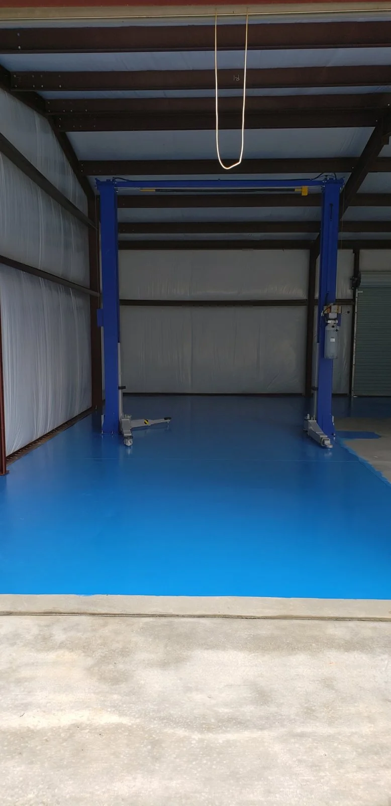

I made some progress on the shop floor over the weekend. I went to mop it Saturday morning and found that even with the coat of epoxy, the little fiberglass hair wads were so rough that it was pulling material off of my mop. That was kinda of a bummer, but it just means a little more work. This is the primer coat so I rented a floor buffer with 100 grit pads from Home Depot. Spent all evening running that around in the shop and now its slick! If the weather cooperates and we dont have company this coming weekend I'll maybe get the second coat down.

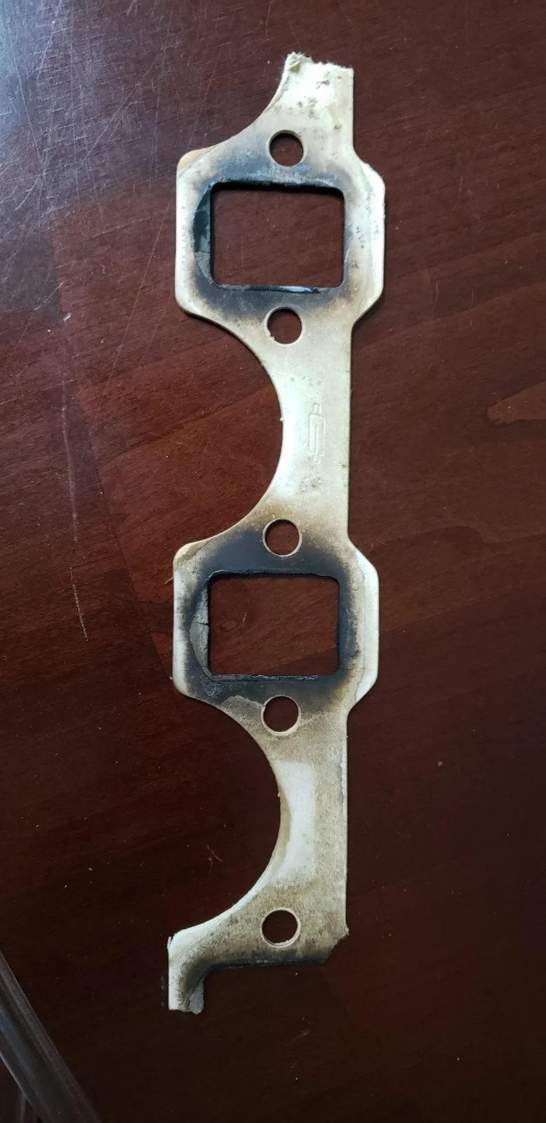

I got the header loose on the passenger side. This is my first time working with long tube headers on a car. I had an old 76 Bronco once that had long tubes on it. It was a completely different engine compartment. It had tons of room under the hood, so it was easy to work on.
When I got the header loose it was easy to see that the gasket was an old paper one that was crumbling. I was able to get one large chunk out, but I still have a little left to get out near the back of the motor. I can only move the header at most .25" at the front and less toward the rear. I'm going to use a piece of metal banding material as a scraper and knock the rest of the old gasket out. I'm pretty sure that this is the reason I had the leak.
You can see in the pic that the openings in the gasket are slightly smaller than the openings in the header. I have BBK long tubs, just for reference. I was going to get a set of copper gaskets, but the ones that LMR sold specifically said that they did not recommend them for use with BBK headers. I just went ahead and got the 1 5/8" gaskets manufactured by BBK. They appear to be a much more substantial gasket than what was on it. The old gaskets are Mr. Gasket brand. I see them being sold in all the parts stores. I'm just going to do the one side at this point. Once I get to the point where I can get into the shop and use the lift I'll tackle the other side. I have a feeling it will make things a bit easier. I know I can do it on the ground, but I need a list of thing to break the lift in with!
