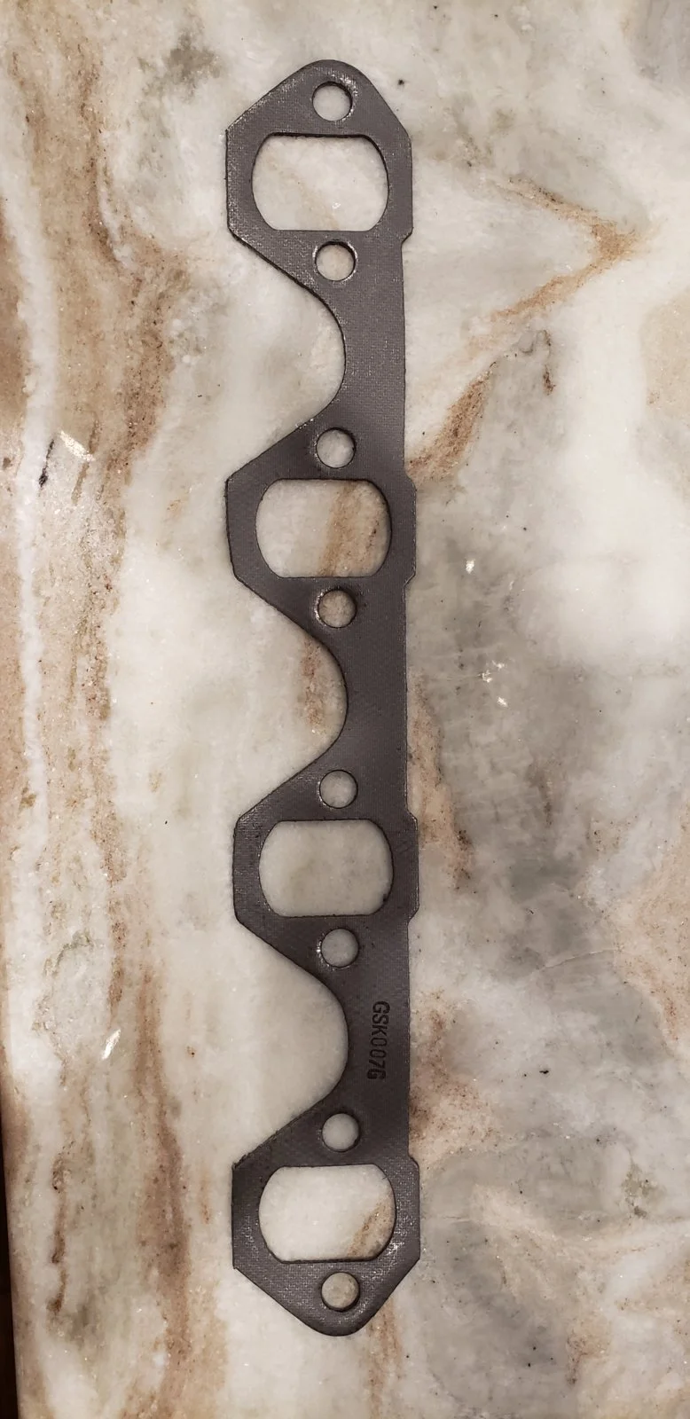

Here's a pic of the new gasket from BBK. With a little luck Ill get it installed this weekend. The wife and Kido are headed out of town tomorrow and wont be back until Monday. I'll have all weekend to work on the shop and car!
Are you using locking header bolts?Here's a pic of the new gasket from BBK. With a little luck Ill get it installed this weekend. The wife and Kido are headed out of town tomorrow and wont be back until Monday. I'll have all weekend to work on the shop and car!
Im not using locking header bolts. I bought a set of these in the hopes that it will make working on it in the future a little easier. They came with washers, but I havent opened them us so I dont know if they are lock washers.Are you using locking header bolts?
you should run a couple heat cycles and then tighten them up again hot.
Thanks for the advice! I've already opened up the gaskets, so I'm going to give them a try. If I continue to have issues I'll definitely give the method you described a shot before buying more gaskets.I dont use gaskets, they never seem to hold. I just use good old copper rtv, a light smear and press against the head then let them hang on the header bolts for 10mins then tighten.

Not really but she will help me move it.If it continues to give me fits, that would be be a good options to look into. It was bolted up just like it is, before I took it loose though. So, I think this is just operator error!Is it a small enough amount where maybe a Dremel to open the bolt holes would help?
