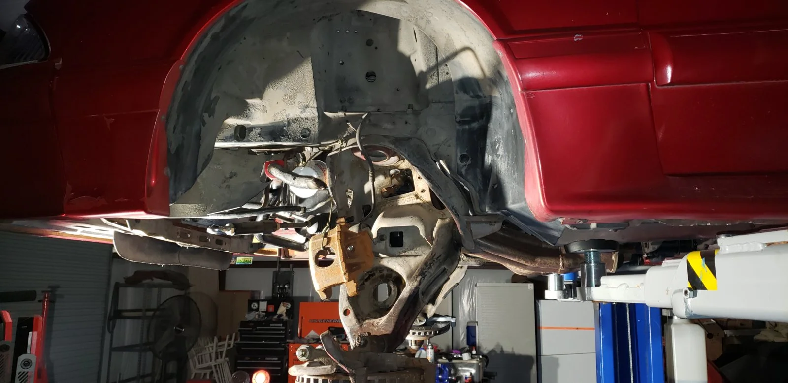

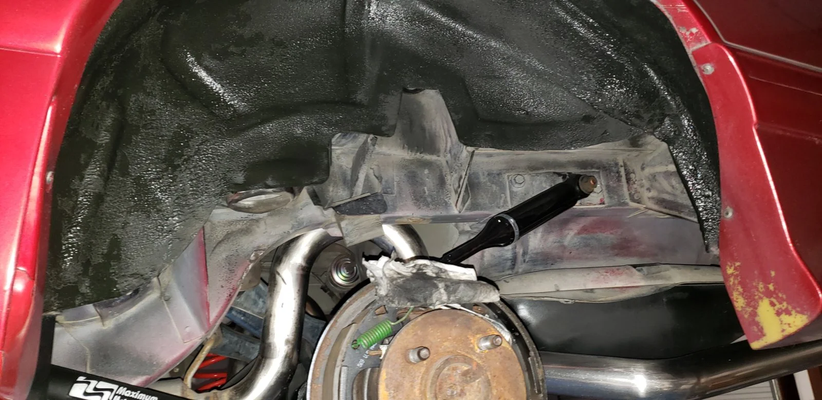

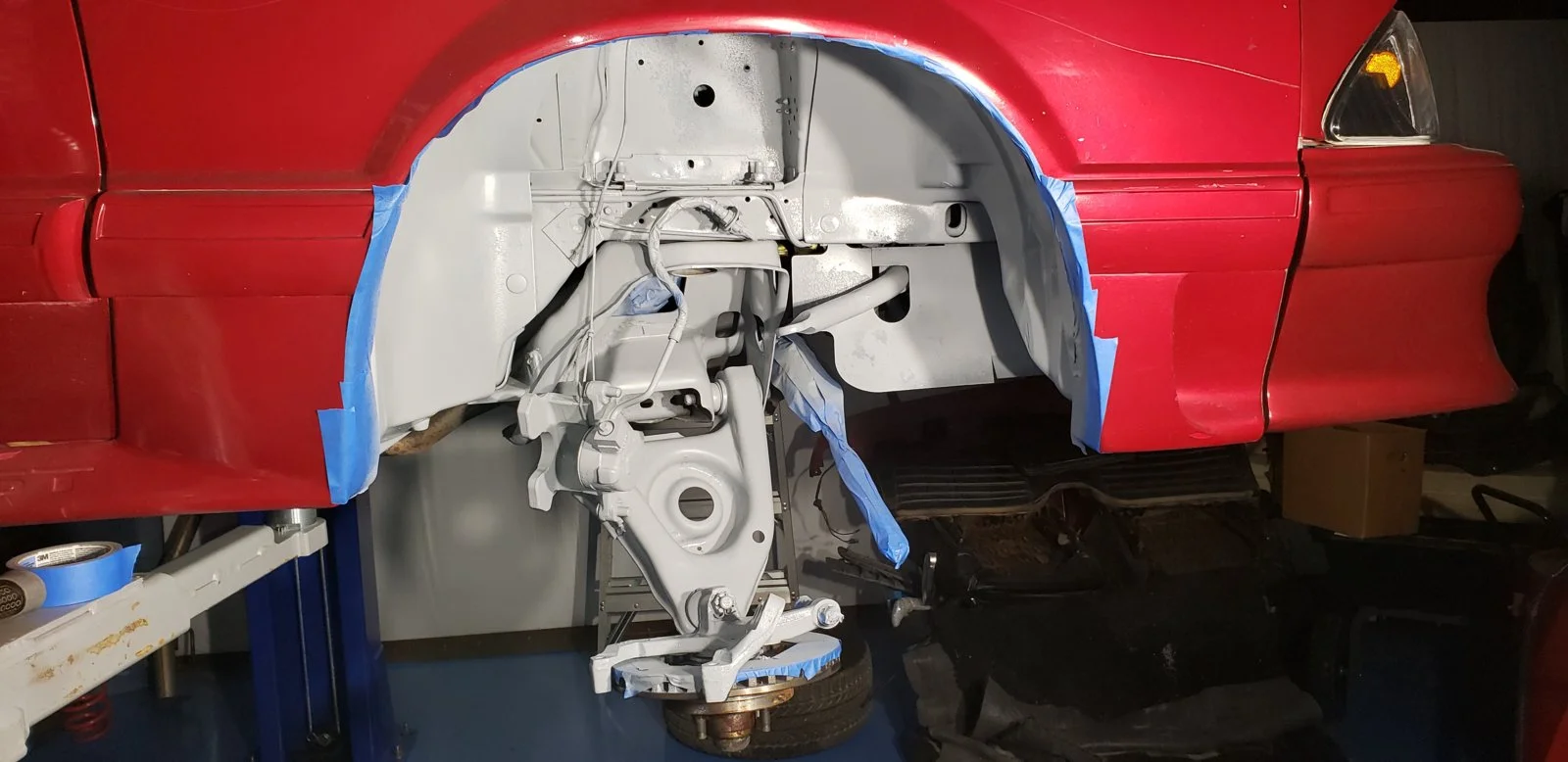

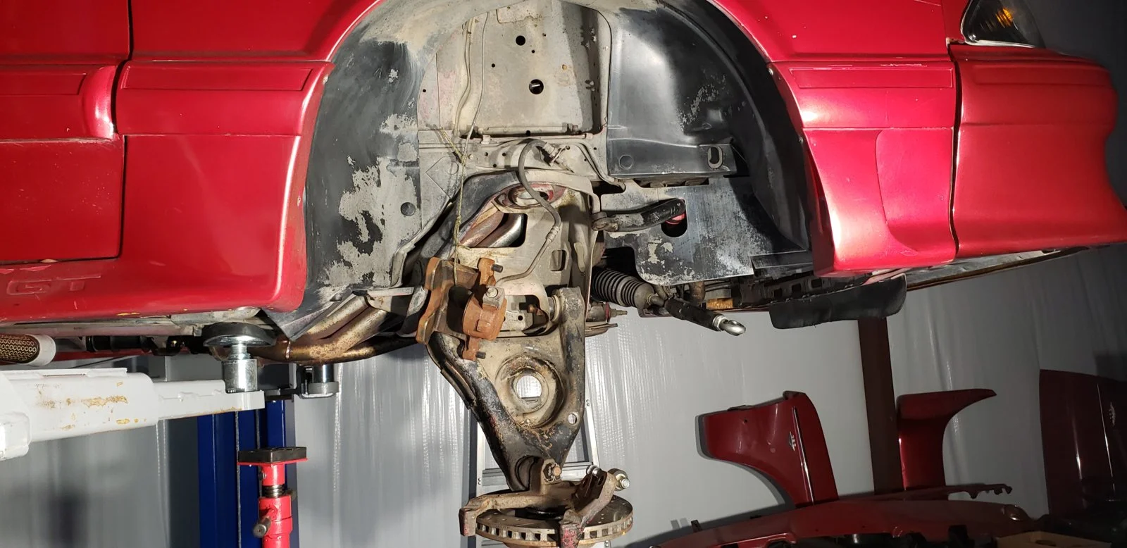

Got a little done last night. I'm not going to finish installing the control arms until I get the torque boxes reinforced. I did finish cleaning up the wheel-well.
And I got the front spring off of one side. I'll get the other one tonight and spend some time clean everything up as I put it back together.

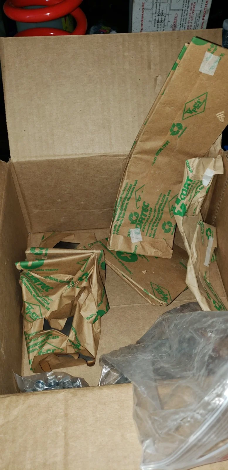

Thanks @Foot Hill ! That's what I'm hoping for. They came in last night.
Along with the torque box reinforcements.

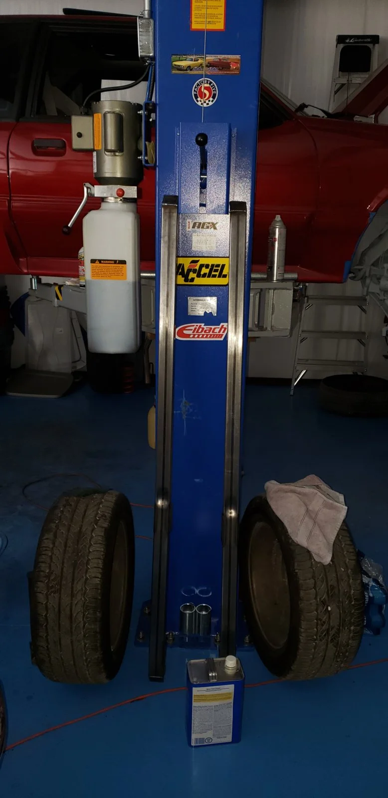

Now you need to add a drive on lift to that shop!

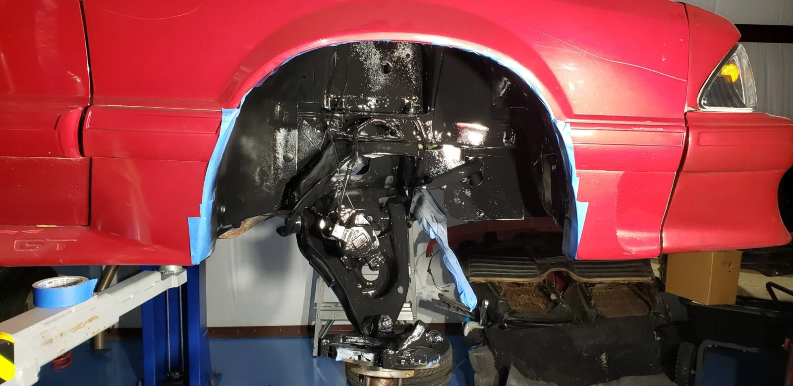

One side is now mostly done!

Time for round two! I got the drivers side disassembled last night. Now I've just got to clean everything and paint it.

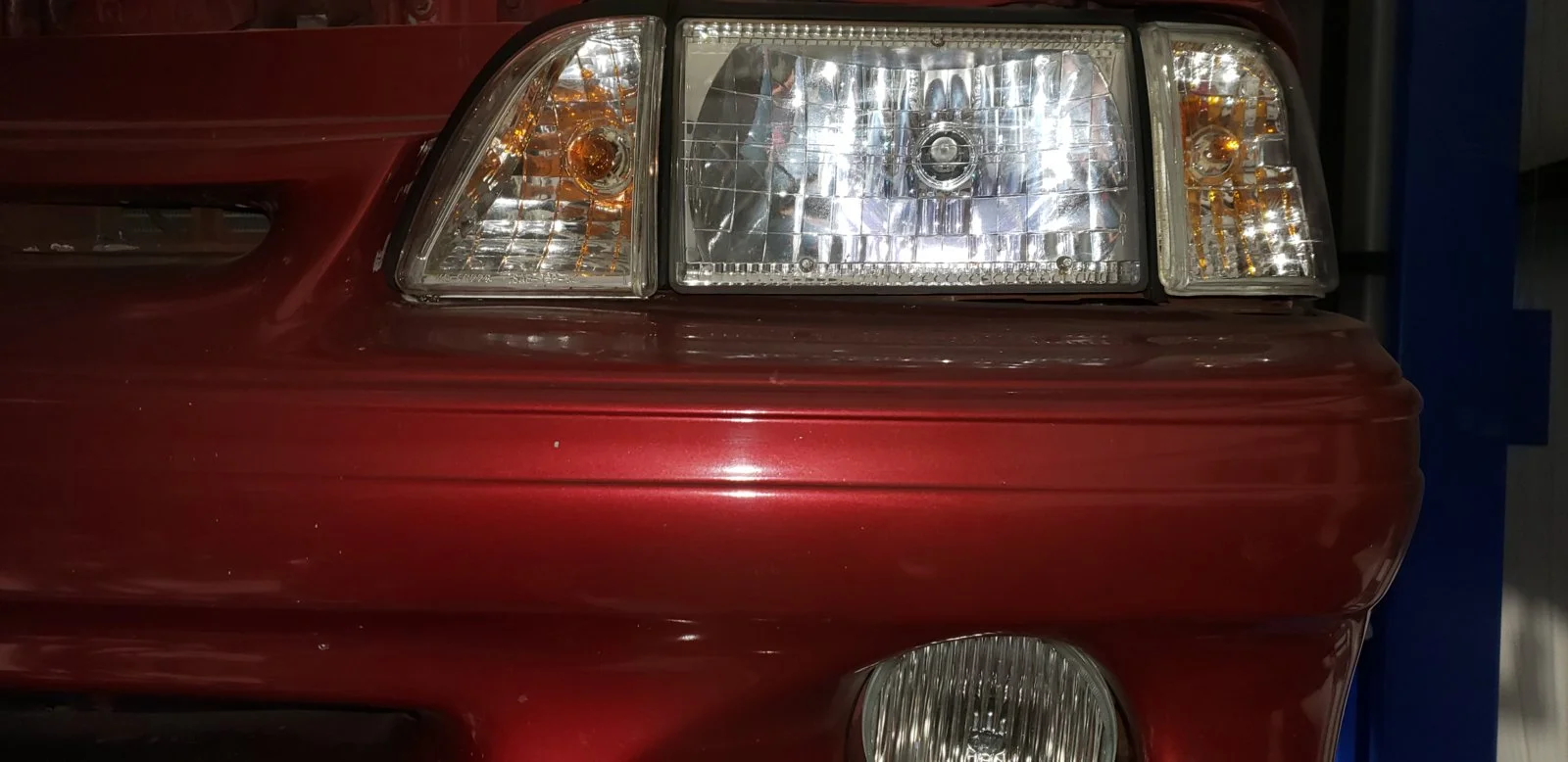

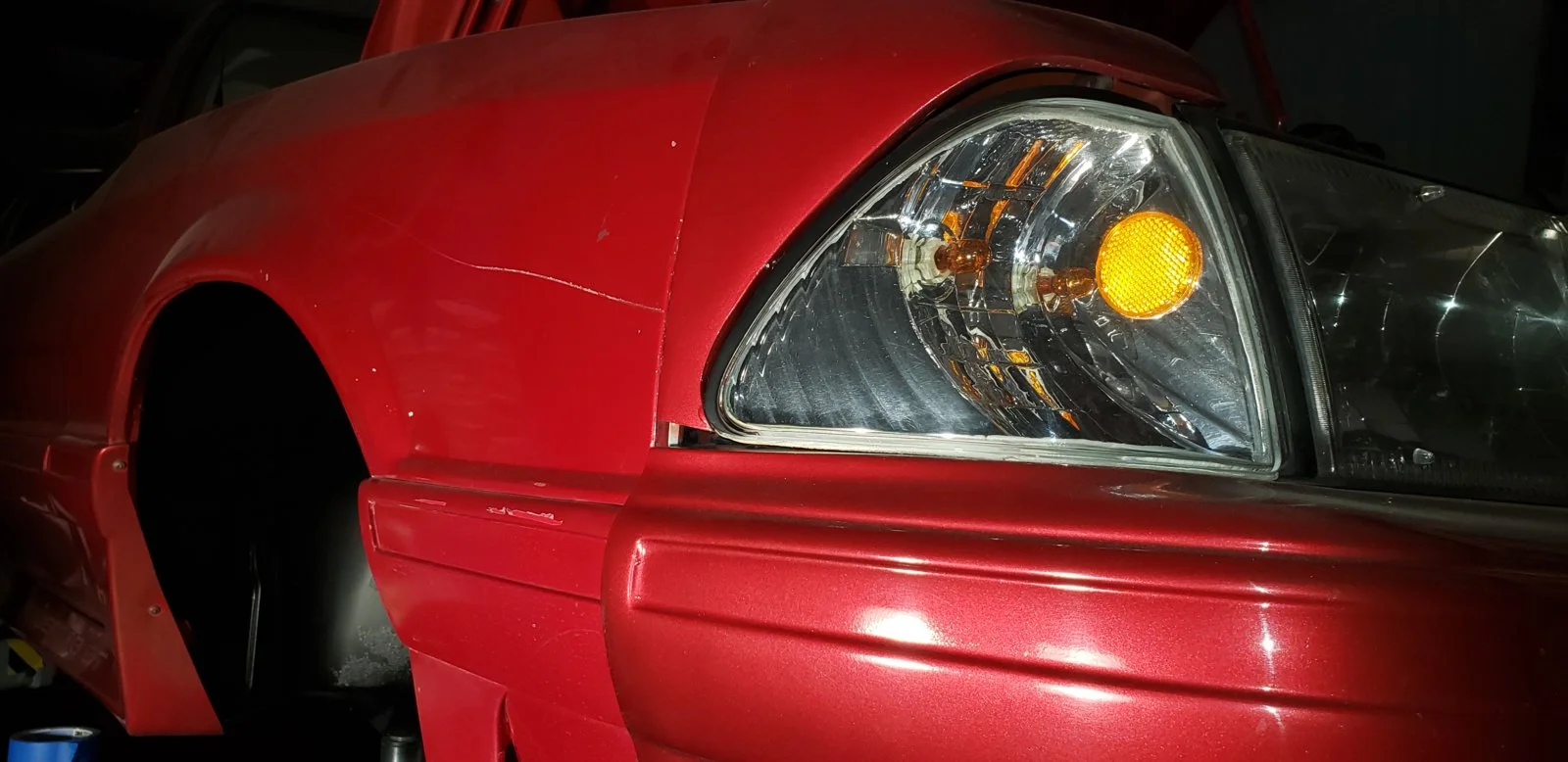

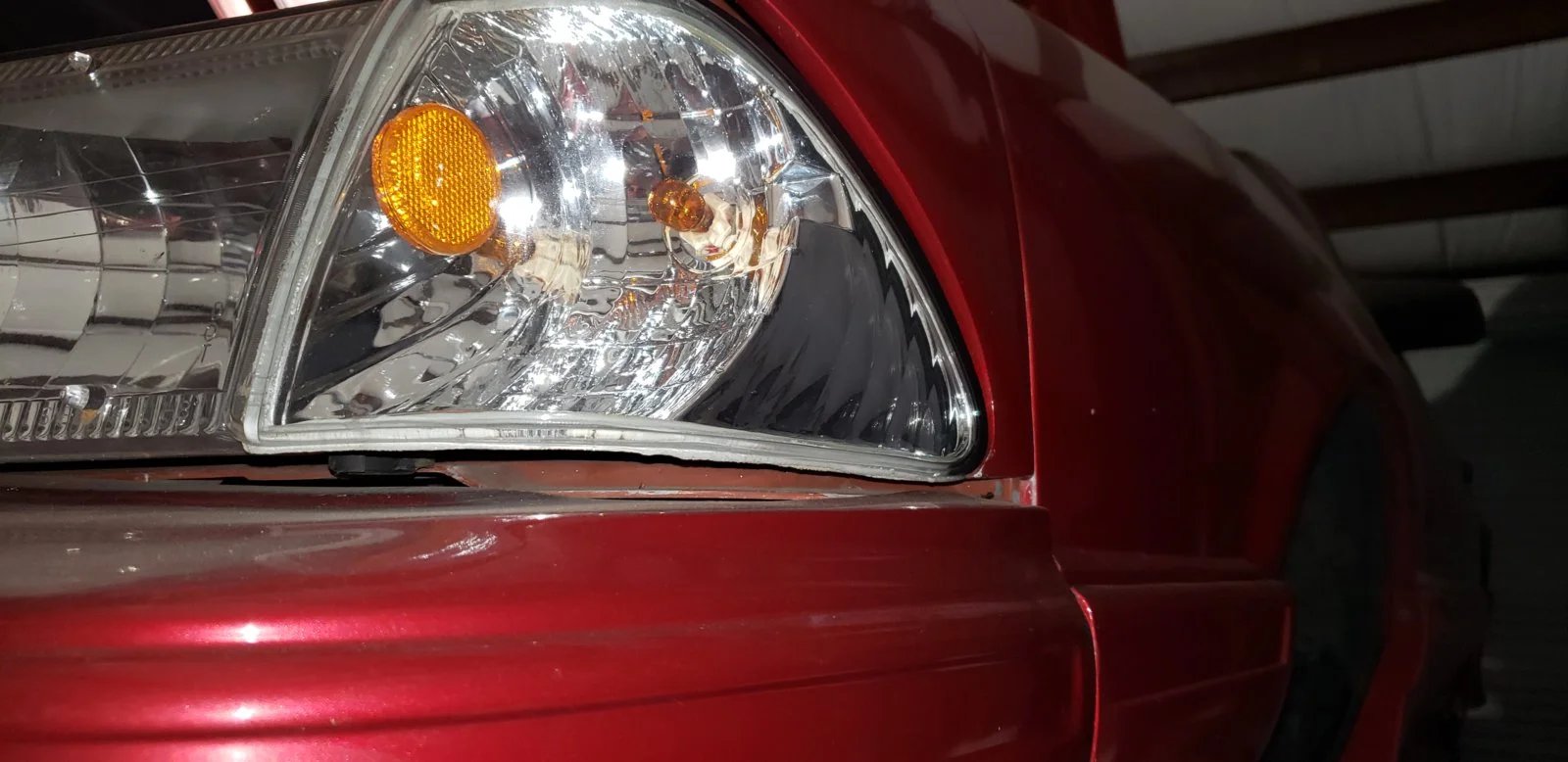

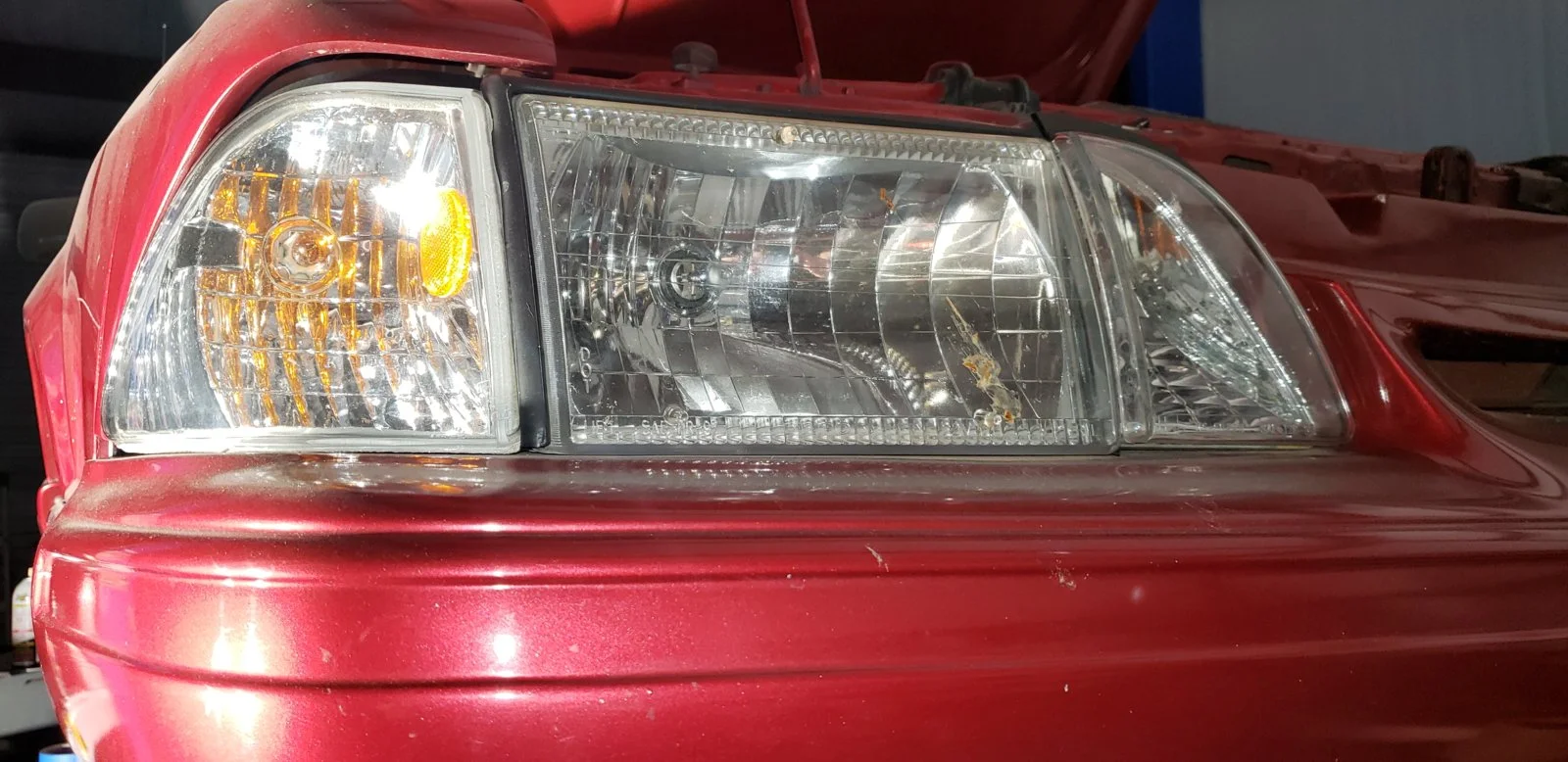

On a side note. The front bumper on my car is all kinds of a bad fit. It sits tight against the bottom of one headlight and has a gap under the other one. Also its split, like it was cut, between the bottom of the nose and where it goes behind the side marker. The car doesn't appear to have been in a wreck I'm just curious if you guys think this is due to bad fitment and cheap parts or if the problem is something worse. Way down on the priority list is to buy a new front bumper cover and paint.

That's a Stalker front bumper. Is yours fiberglass or the yellow polyurethane like an original bumper ? The fitment sucked on the fiberglass ones. Check the bumper supports while under the car.
The bumper on the drivers side should be up and on top of the header panel behind it and under that light. I've seen bumpers crack below the markers on race cars with lots of cam and no front bumper support. There should be braces that go from the core support to the fender where the bumper meets.

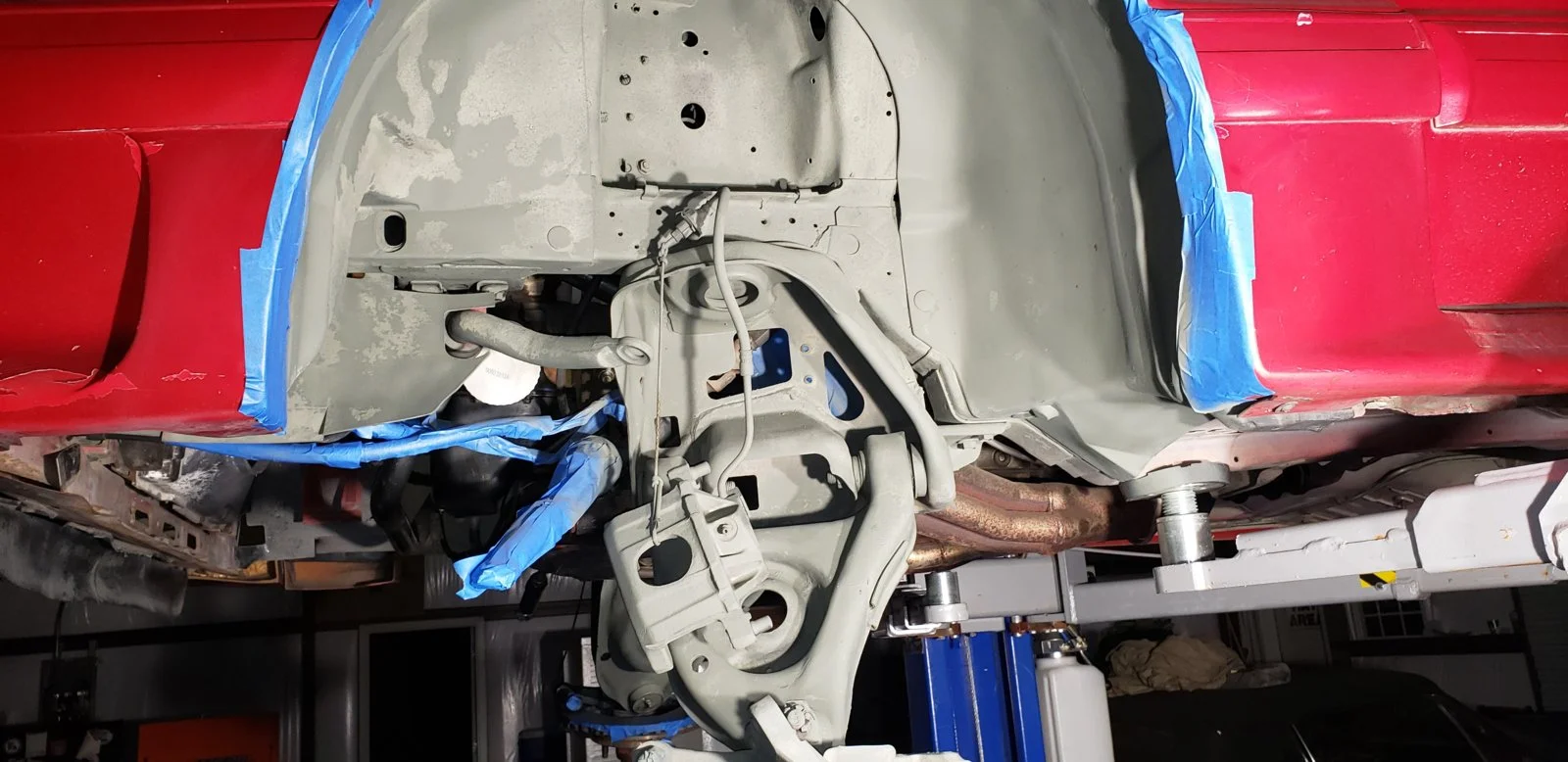

Drivers side primed. Now I've got to wait for the paint I ordered to come in and I'll spray it black.

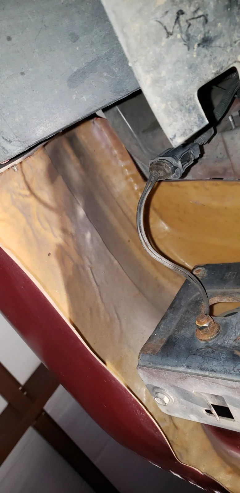

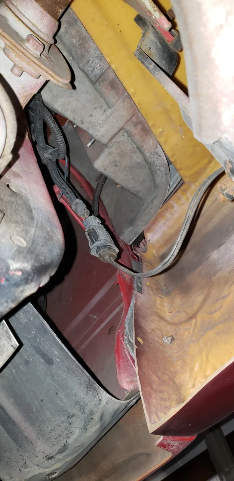

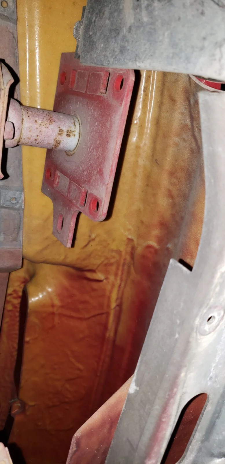

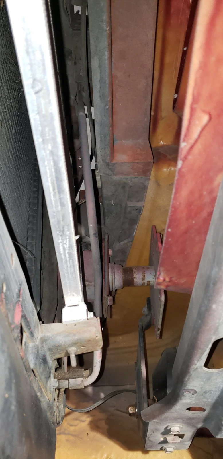

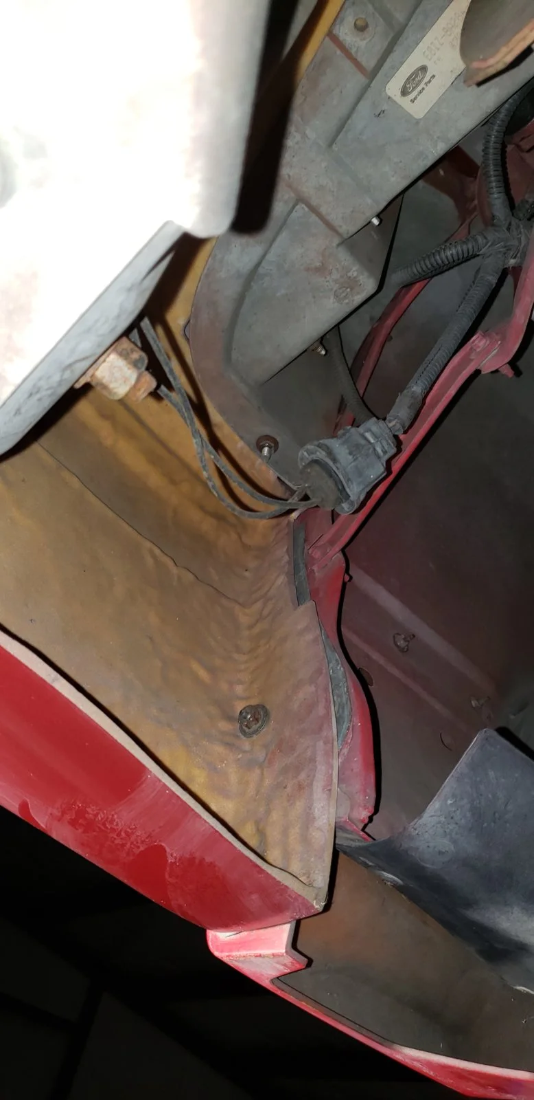

Here are some pics from under the bumper cover. IMO if you dont know what you are looking at it's hard to make things out, but maybe you guys will see if there is an issue.

Looks like the fiberglass? Panel that sits under/behind the light buckets is missing.
Or I am blind. Both are plausible

is bumper impact devices supposed to bolt to something? ie. bumper core?

You would think. The guy I bought it from gave me the bumper core and the factory wing. I think he said he installed the aftermarket headlights. I know he had the front bumper and wing installed, but I dont know who fit them. They are a slightly different color than the rest of the car.
Maybe I should start a thread about two tone cars and bad paint jobs....
This isn't a pressing issue for me at the moment. I just thought if someone knew what I was missing I could start looking for replacement parts. I think I would like to put a Cobra front bumper on it one day. I defiantly want to put different headlights on it. I'd like to get a hold of a set of OEM headlights even if they were in need of restoration. I know they can be had. I just haven't been looking for them.
