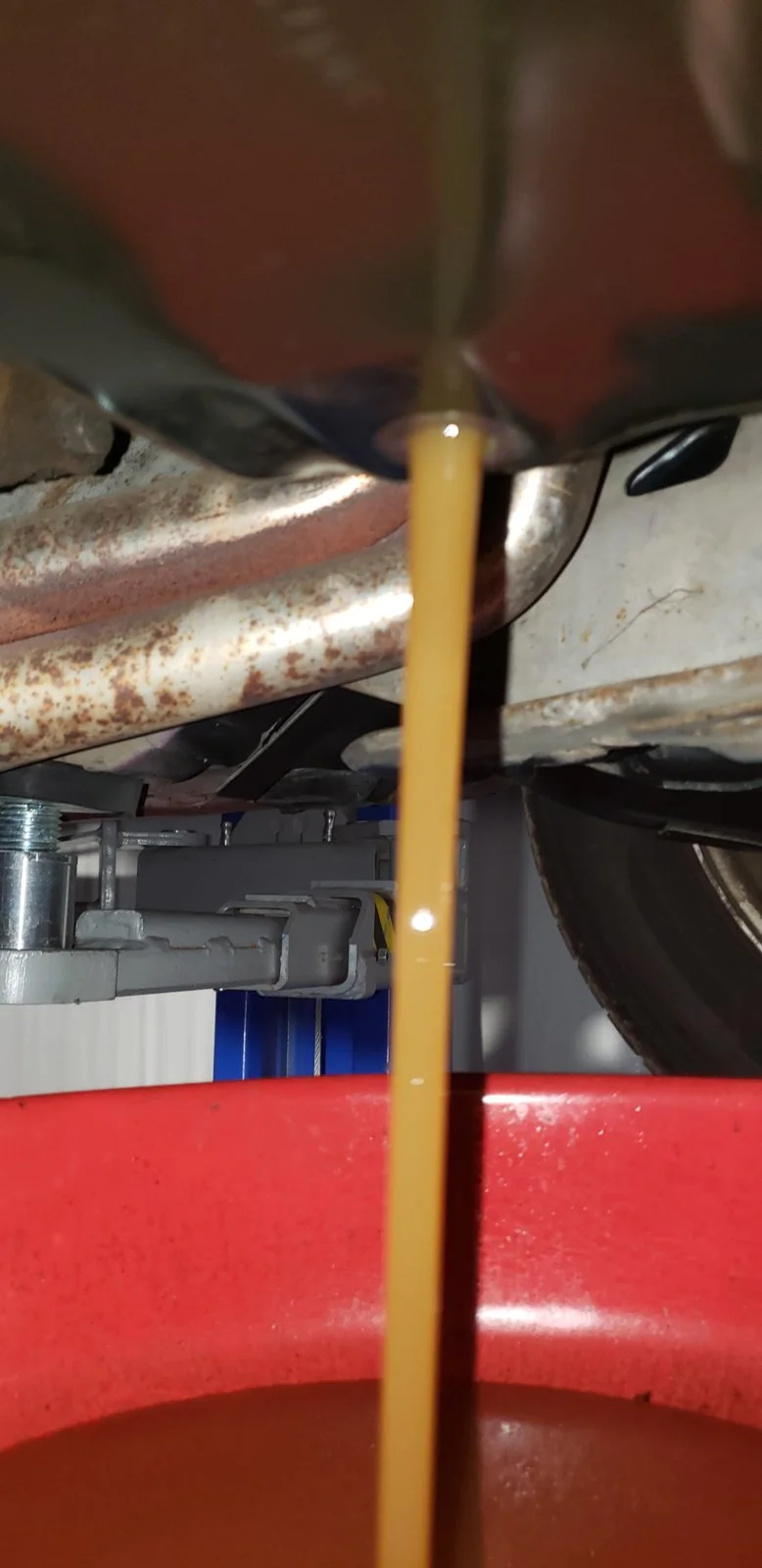

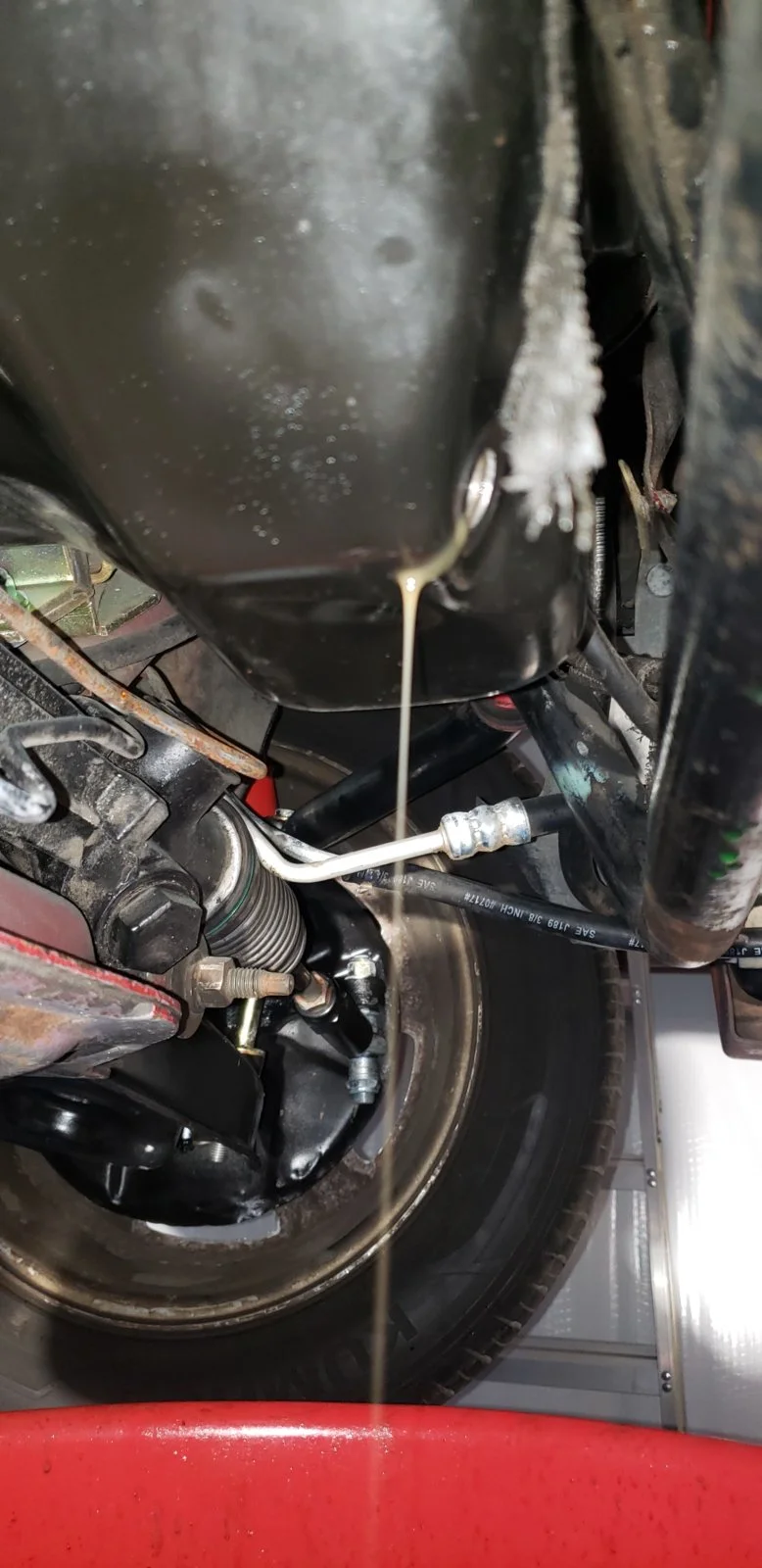

We're not out of the woods yet. This is what came out of the engine.
I'll get some more cheap oil and a filter and try it again.
Oh man!! Fingers crossed for you!! That clip sounded nice. Thought you had it beat.

As far as I know, yes. The only things that have come off of this engine are the timing chain cover, thermostat housing, and oil pan. I just took the timing chain cover off to replace the gasket. I had not sealed it up very well. This time I used lots of this putting it back on https://www.permatex.com/products/g...nge-sealants/permatex-anaerobic-gasket-maker/
I was really surprised when all of that came out. I was expecting some milky stuff but not that much. On the way home today I'm going to get some fresh oil, filter, and rent a radiator pressure tester.
I've done this job before with no issues. I dont know what is going on this time.

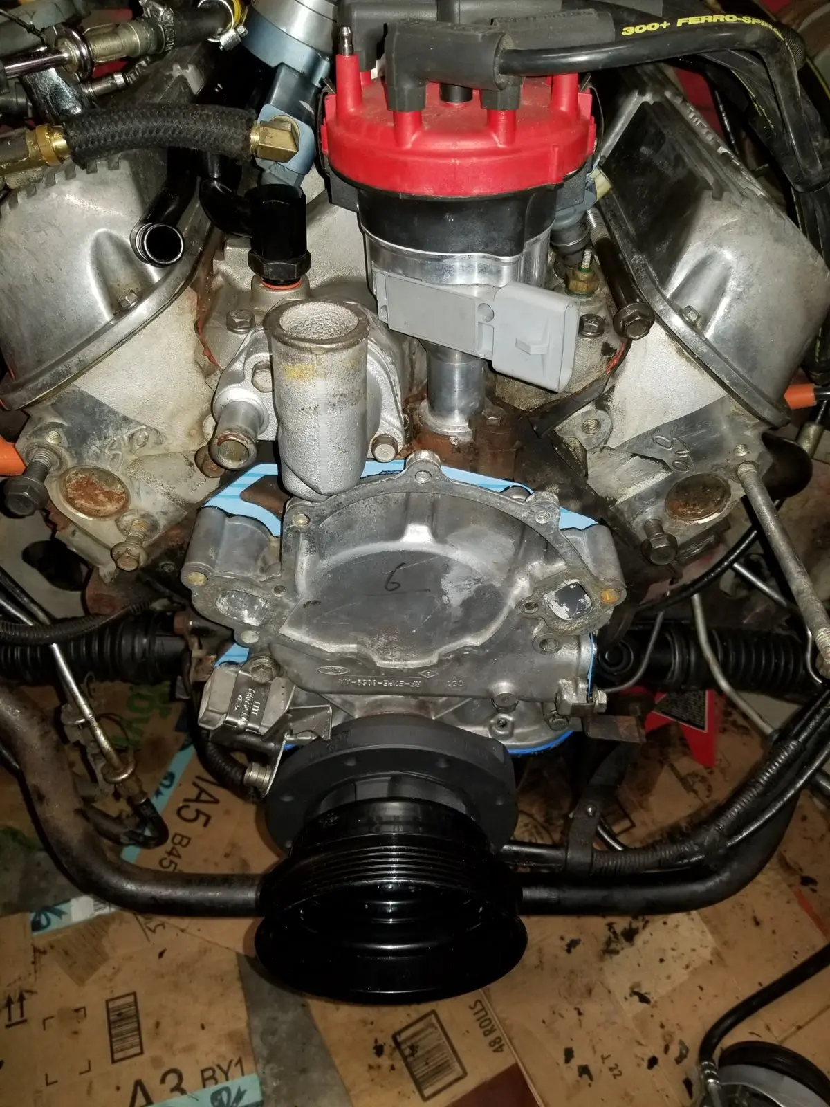

This is so frustrating. I've done this job before and did not have this much trouble. I used a ton of that gasket maker when I put the timing cover gasket on, but apparently it still didn't seal.
More water was coming out of the pan last night as well. The leak showed up when I put a little pressure on the system to test it. I dont know if I'll even mess with it tonight. Need one of those step away from it moments. When I do this AGAIN I'm just going to use excessive amounts of black RTV. If that doesn't work I might have to shoot something.

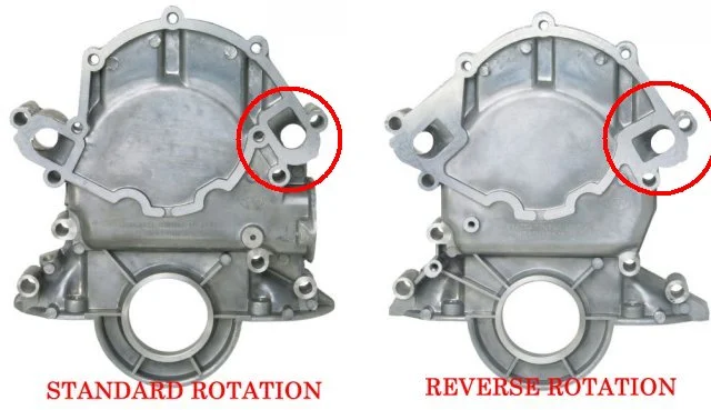

I saw something in your very last pic that leads me to believe I may have found your problem....wrong timing cover. In your last pic I noticed the fuel pump block off plate. I also checked back to the pic you posted on page #2 showing the front of the timing cover with no pump installed. After doing a little digging I found pics of a reverse rotation timing cover versus a standard rotation cover. The one currently on your engine appears to be a standard rotation cover. The water passage on the left side (right side looking at the front of the motor) should point the opposite way (the "D" should face up, not down). Just a thought!

I noticed that too, I also believe there may be a reverse rotation cover that has a fuel pump boss, I know they make one with the boss that is closed off.I
I have seen a few threads (not on stangnet that I remember) that say it does not matter. I don't believe that.
I'd have to agree with ya. My mention of the fuel pump boss was simply to say that's what got me looking back at his other pics. That's when I noticed the water passage differences (and what I believe is a crank trigger mount too). For total transparency sake, the images I posted are a composite of a standard and reverse rotation cover from Edelbrock. It was the best place I could get images to illustrate. I edited the picture to point out the difference I mentioned, The right side passages are opposite too.

Well poop. Thanks for the great information. I'm going to ask a dumb question here so bear with me. As far as the water pump rotation goes for the fox 5.0 are they all reverse rotation? Looking at how the belt wraps around it, no matter what components you remove, it always ends up rotating in the same direction.
Given what I have found as I go through this car it would not surprise me to find that it has the wrong timing chain cover. I'm planning on going to see my folks in NA this weekend and will need to get ready for that weekend trip tonight, so I doubt that I will get to mess with it until Sunday or even Monday. If I do I will inspect the cover and post pics on here.
Its stuff like this that makes this site an awesome community to be a part of. I appreciate the advice and you guys putting up with my ramblings!
Reactions: General karthief
Olivethefet
I will own your nuts! LOL
5 Year Member
May 17, 2018
2,596
1,790
143
45
Enterprise AL
Mar 5, 2020
#676
  • Mar 5, 2020
  • #676

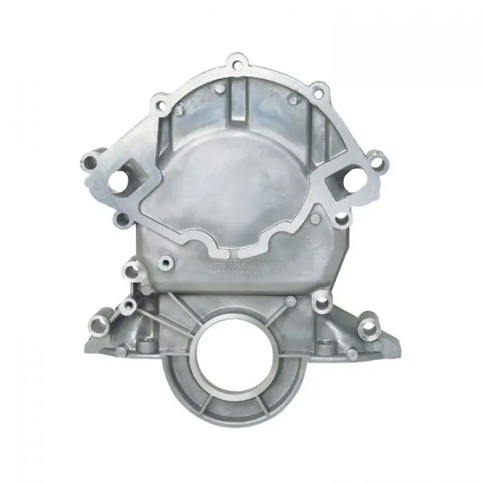

I've been doing a little internet digging during lunch. Maybe my timing chain cover is for a standard rotation water pump. Meaning it is meant for an older v-belt drive application like on a 65. Great good information. However, looking at pics of covers online the major difference in what I need and what I might have is the direction the D shaped ports for the pump goes and the opening for the mechanical fuel pump. The cover I need should be an EFI unit in reverse rotation. What I gather is all water pumps on 5.0 Foxes starting in 83 should have reverse rotation pumps as they use serpentine belts.
All good info. Regardless of whether the cover is for standard rotation or reverse rotation where the cover mates with the block is the same on both covers and should not result in leaks. My cover is currently leaking externally at the block. Not where the water pump connects to the cover.
I've got to pull the thing back off no matter what. I've already got a spare gasket for the pump. I'll go ahead and pull the pump just to verify that it is the correct cover. If it isn't then I'll get the correct one. They are currently sold out on LMR.
Anyway, all good info.
As far as the leaks and water getting into the engine does having the correct direction water pump have anything to do with that? I understand that it could create cooling issues or leaks where the pump mounts to the cover.
OR am I just focused on the water leaking into the engine thing and missing the point that you guys are trying to help me with my possible cooling issue? I get confused easy, so I can see where that is all that's going on.

I think this is the pic from earlier in this thread that you guys are referring to.

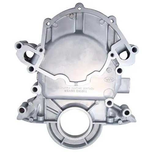

This is a pic from LMR's website of the timing chain cover they sell.
Looks just like mine. This is what Edelbrock has on their website listed for application on a 86-93 5.0.
This is what @JKWilson61 posted earlier. Now I'm really confused.
Jegs has this cover listed for use with standard or reverse rotation water pumps.
JEGS 50300: Timing Cover for 1966-1995 Small Block Ford 289-302-351W - JEGS High Performance
small block ford timing cover, timing cover, ford timing cover
www.jegs.com

I've heard tons of people say it doesn't matter. I know on my 85 when I still had a carb, I replaced the timing cover and drilled out the opening for the fuel pump. IIRC it was tapped for 2 bolts but was cast closed off for the pump. I have no idea what the water passages looked like. I'll see if any pics show just the timing cover before I put on the water pump.

I don’t know nothing from anything, but could the difference in the “d” passages cause an increase of pressure somewhere, causing the water to go somewhere it shouldn’t, due to the fact it can’t flow properly?
