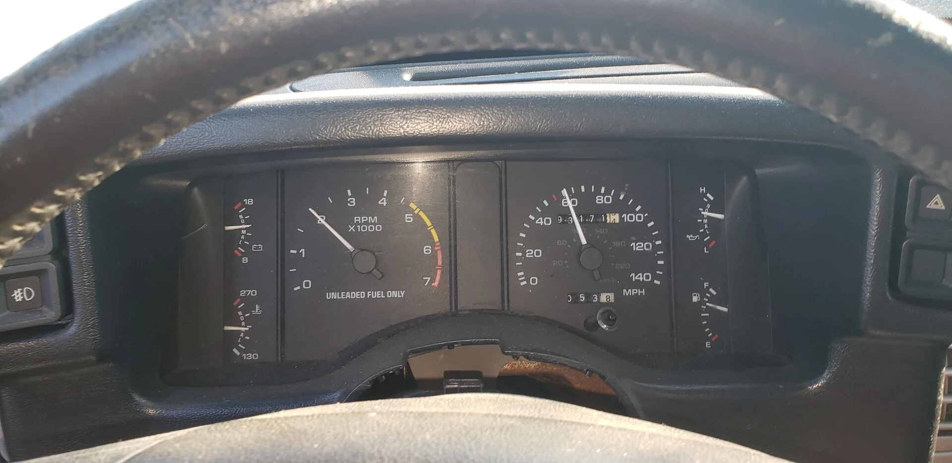

I got to take the car out for a short drive this afternoon. I have a working speedometer! Also I can do strong two wheel burnouts!

I cant drink coffee, shift gears, while doing a burnout, and film it. I know I suck. But I can take a picture to prove it moves! Lol.
The speedometer works!

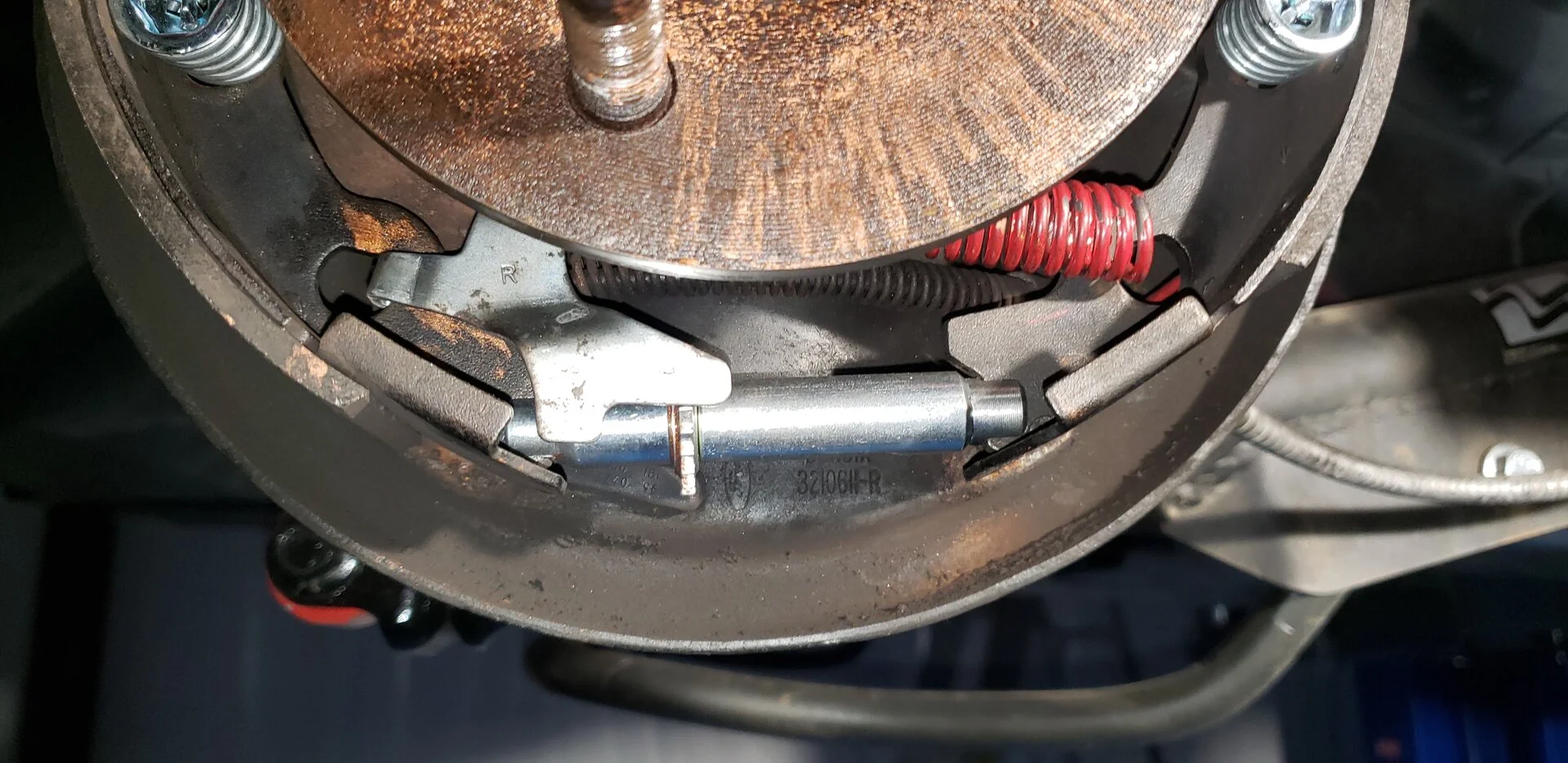

Took the car out again. Everything went great but I still have that noise coming from the rear brakes. I'm going to pull the drums, again, and see if I can find anything wrong, again. If everything looks good I might try a new set of shoes.

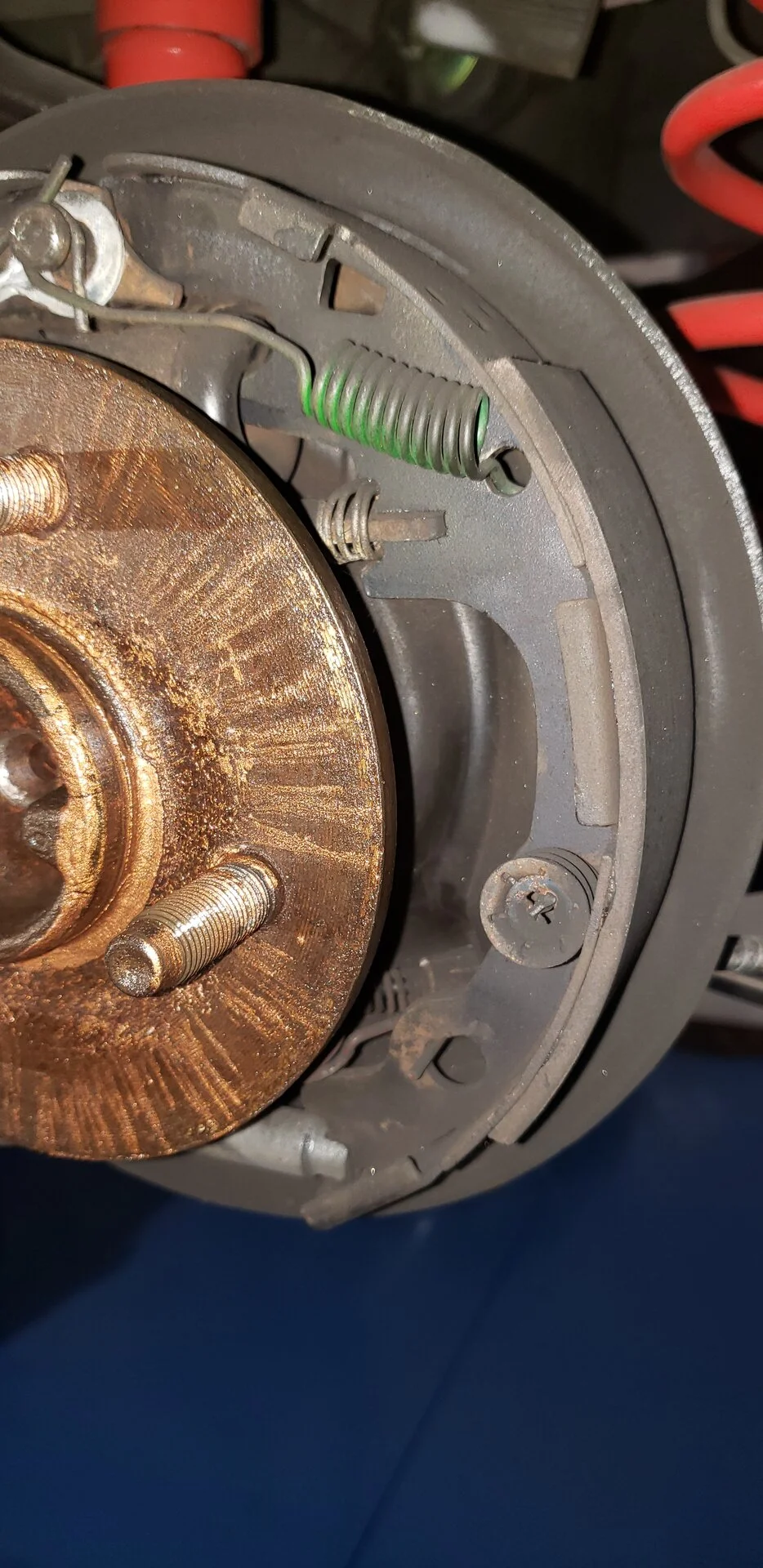

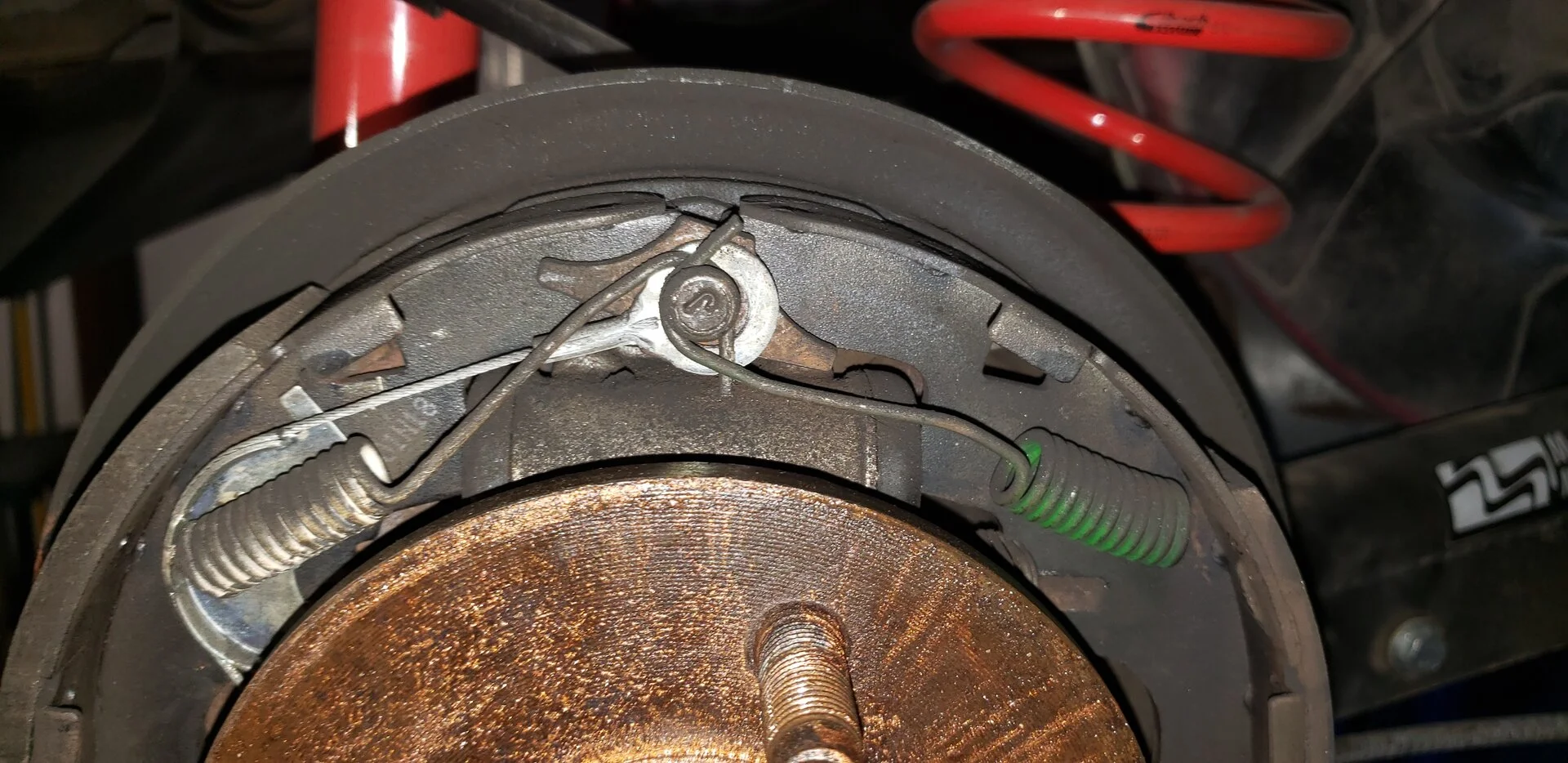

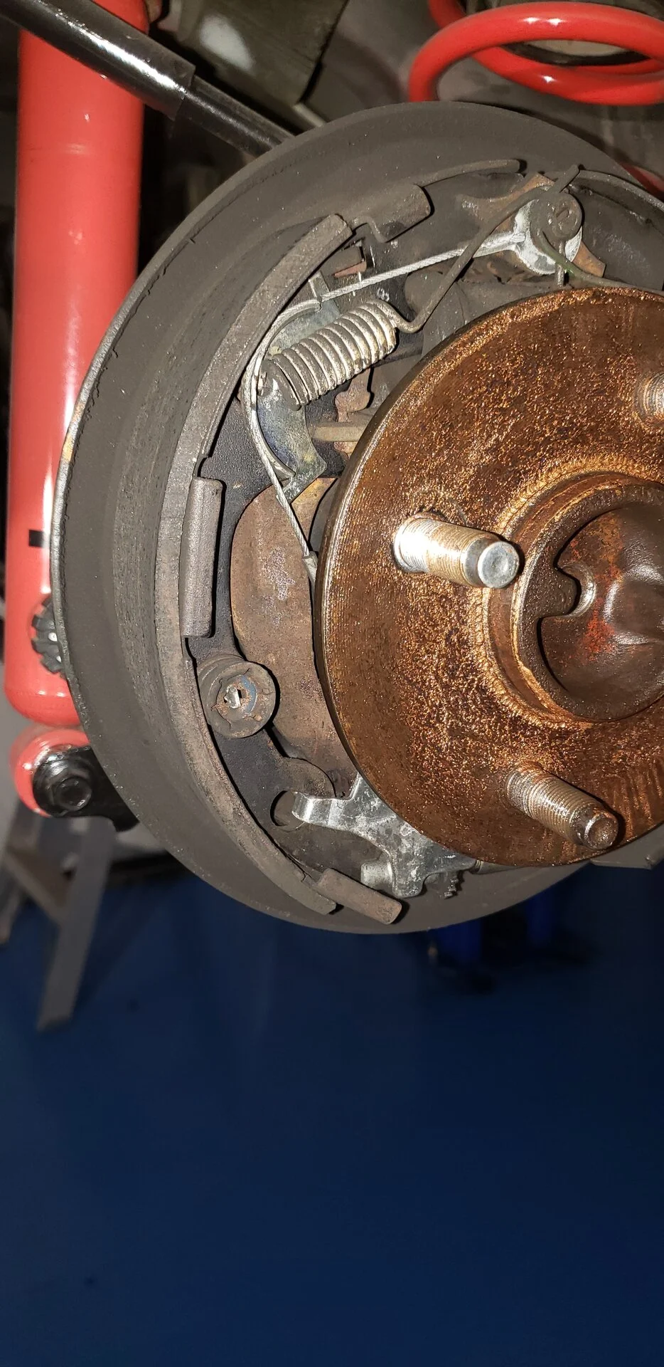

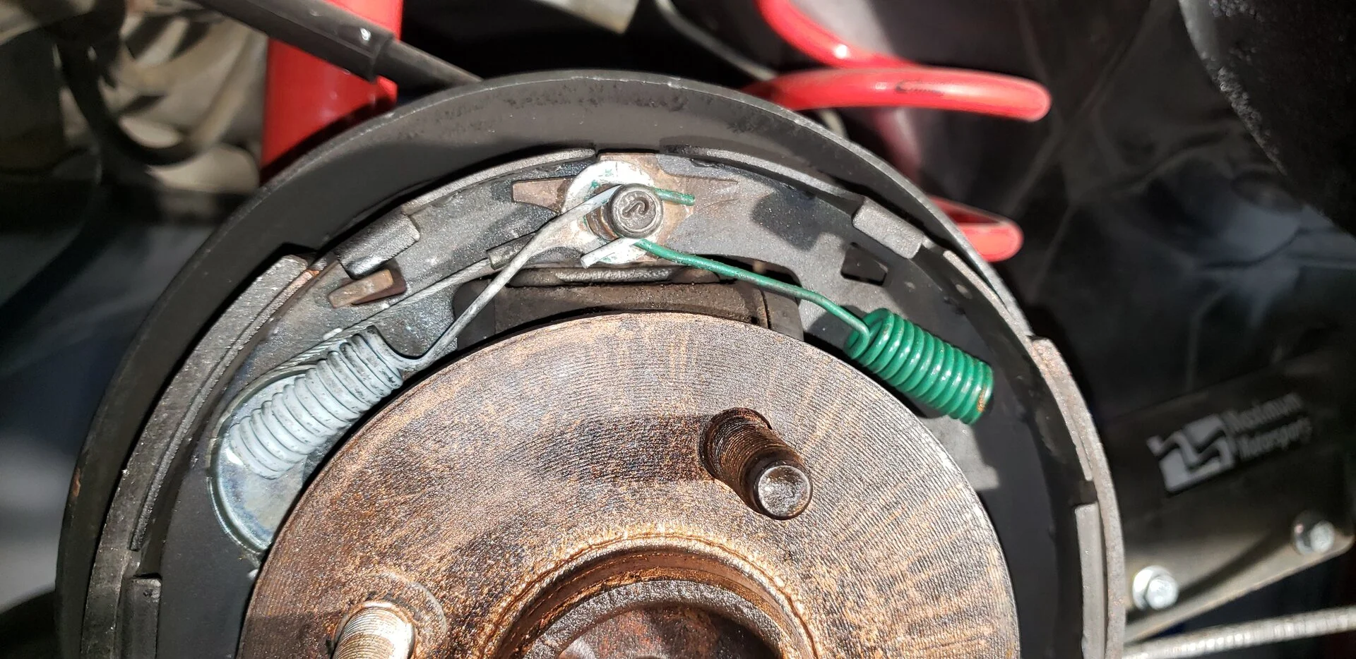

Here are some pictures of the right rear brake. There is a lot of brake dust considering that this has only been together for less than 200 miles. Seems like odd ware as well.

My brain screams when I see pics of you brakes, don't know why, likely just my brain, it does things I can't explain.
One thing that I would advise would be to take the green and white spring ends and squeeze the ends around where it wraps the stud at the top, you want it to wrap the stud as much as possible.

I'm sorry that my brakes make your brain hurt General! I dont like the way those springs look either. I'll get that fixed.

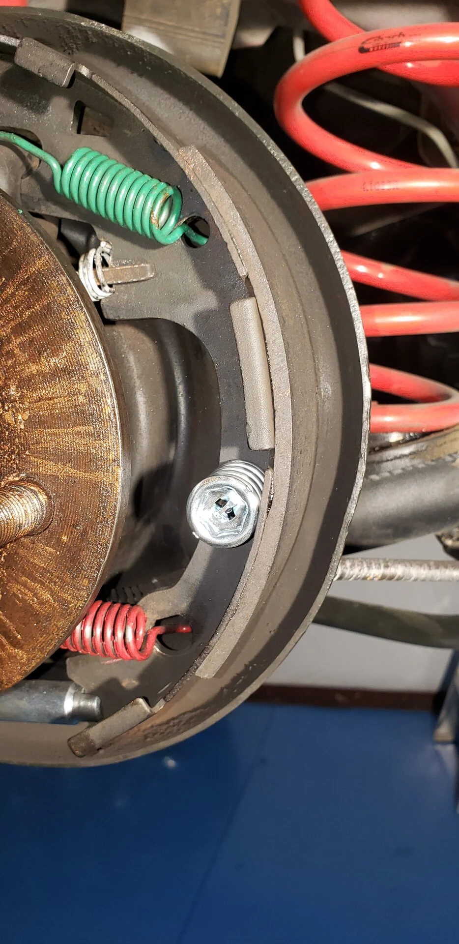

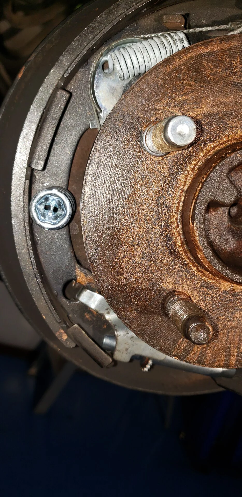

OK, so in an effort to make the General happy, I dont want him to come steal my car, I spent some time redoing the springs and retainers on my right rear brake. I swear I'm not doing this to try to make my car safer, or fix the annoying scrubbing noise. This is all the result of one person not like how my stuff looks.
And now for your viewing pleasure. More pictures of my boring ass drum brakes! Exciting I know.
If anyone sees something that I'm missing by all means point it out. To me this looks a lot better than it did.
