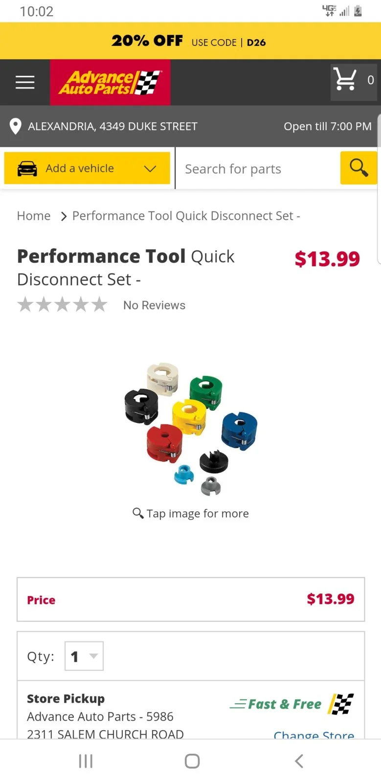

I've got tons of money in tools...but these things are the best quick disconnect tools I have. They just work. A little wd40 or PBblaster on the back side where the tool slides in...a couple twists..and pull. They fit around the fittings so if theres a little pressure it won't spray you. Great for the fuel lines too.

@90sickfox I just check my local Autozone. They have what appears to be the same thing but the name is different. Santech Spring Locking tool set. https://www.autozone.com/test-scan-...ch-spring-locking-tool-set-9-piece/952338_0_0
I have a set of disconnect tools that look like these.
I didn't pay that much for my set. I just always seem to have trouble getting the lines to come apart. I watch people in videos using these things and it looks really easy. I'm sure I'm doing something wrong. I'll pick this set up and see if it works any better for me. I'll grab an assortment of AC line o-rings as well.
Those type have always been an issue for me too. They work in a tight spot but are a real pain. I think it's the way the circular ones can be twisted to get them past the spring...and the plastic is more forgiving. I use your style on fuel filters and stuff like that where the plastic ones are too bulky.

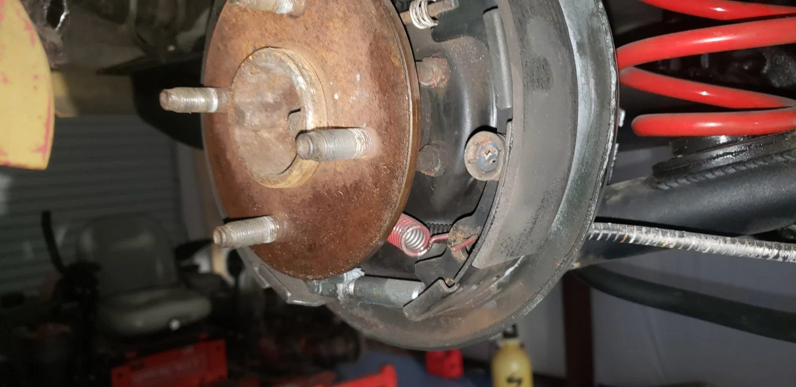

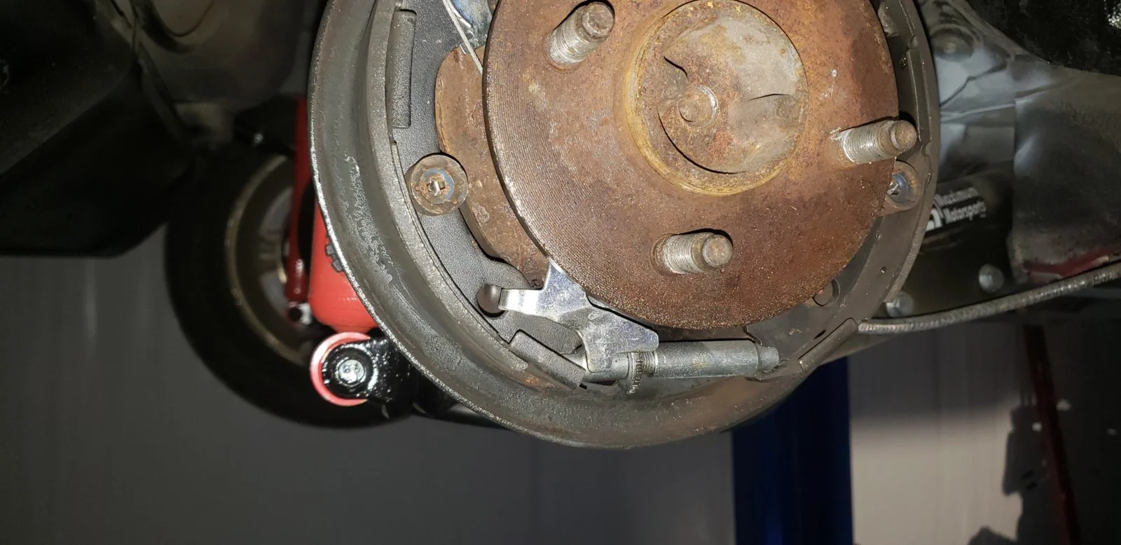

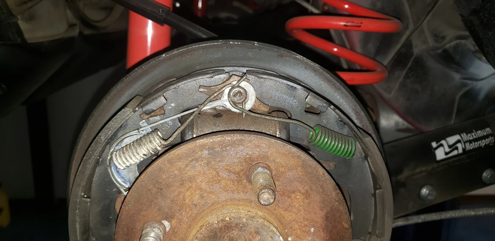

I took the right rear tire off and inspected the brake. Everything looked good. It was loose though. I tightened it up a bit. We'll see if it still has the dragging noise next time I take it out.
When you had the drum off, the hardware was all in its proper place?
When we have that same issue at the shop and pulling the e-brake stops the noise usually the self adjust is not doing its job. If what you did, did not fix the problem. You may need to replace the hardware kit on both sides.

Looks all in the right spots.
  1. Looks dry
  2. Cylinders are not leaking
  3. Thick Shoes
  4. Springs look correct
  5. Adjuster actually looks the newest on there
Do you use the parking brake regularly? If not that can be a cause of non adjusting.
You do have a high/low spot on that shoe. Could be that it was not adjusted right as you mentioned and fixed. Could be the beginning of the drum getting uneven on the mating surface.
I think I just didnt properly set the adjuster. The springs, wheel cylinder, brake shoes, and drum are all new. Less than 500 miles on the whole thing. I do appreciate the input and will check out anything you think I need to.
NOPE, Visually it looks spot on. Get out on the test drive and see if the adjustments solved things. Pull that e-brake handle weekly to make the adjuster do its job as it should. With what you mentioned in the replacement and time frame I am in agreement on the wear pattern being an adjustment issue.
