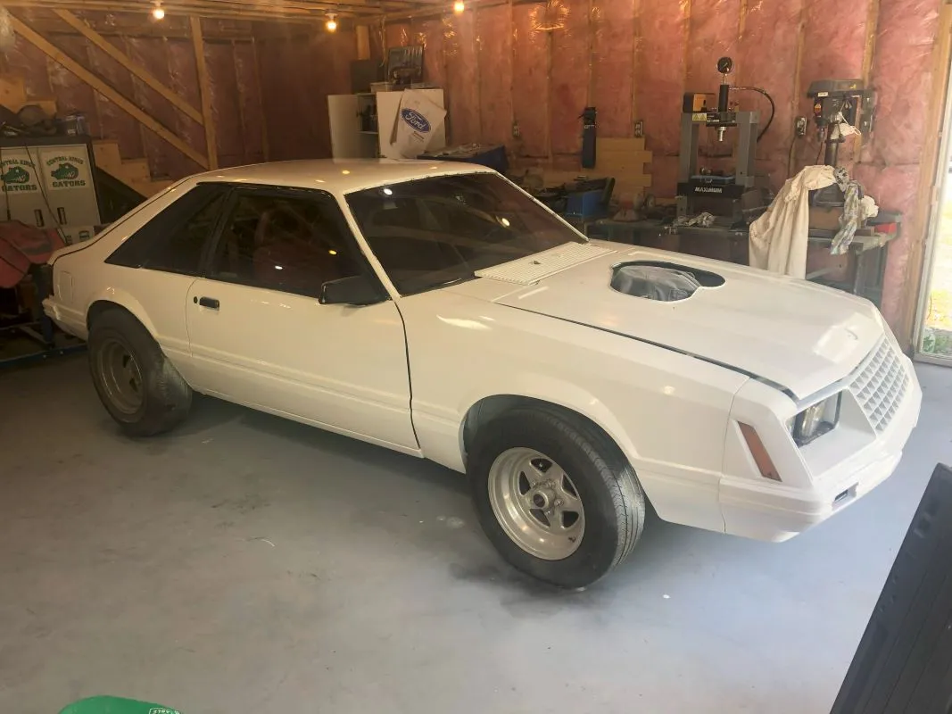

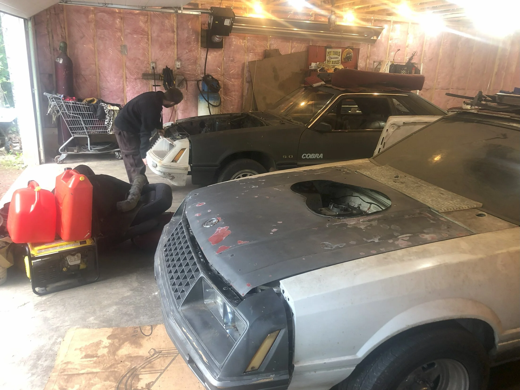

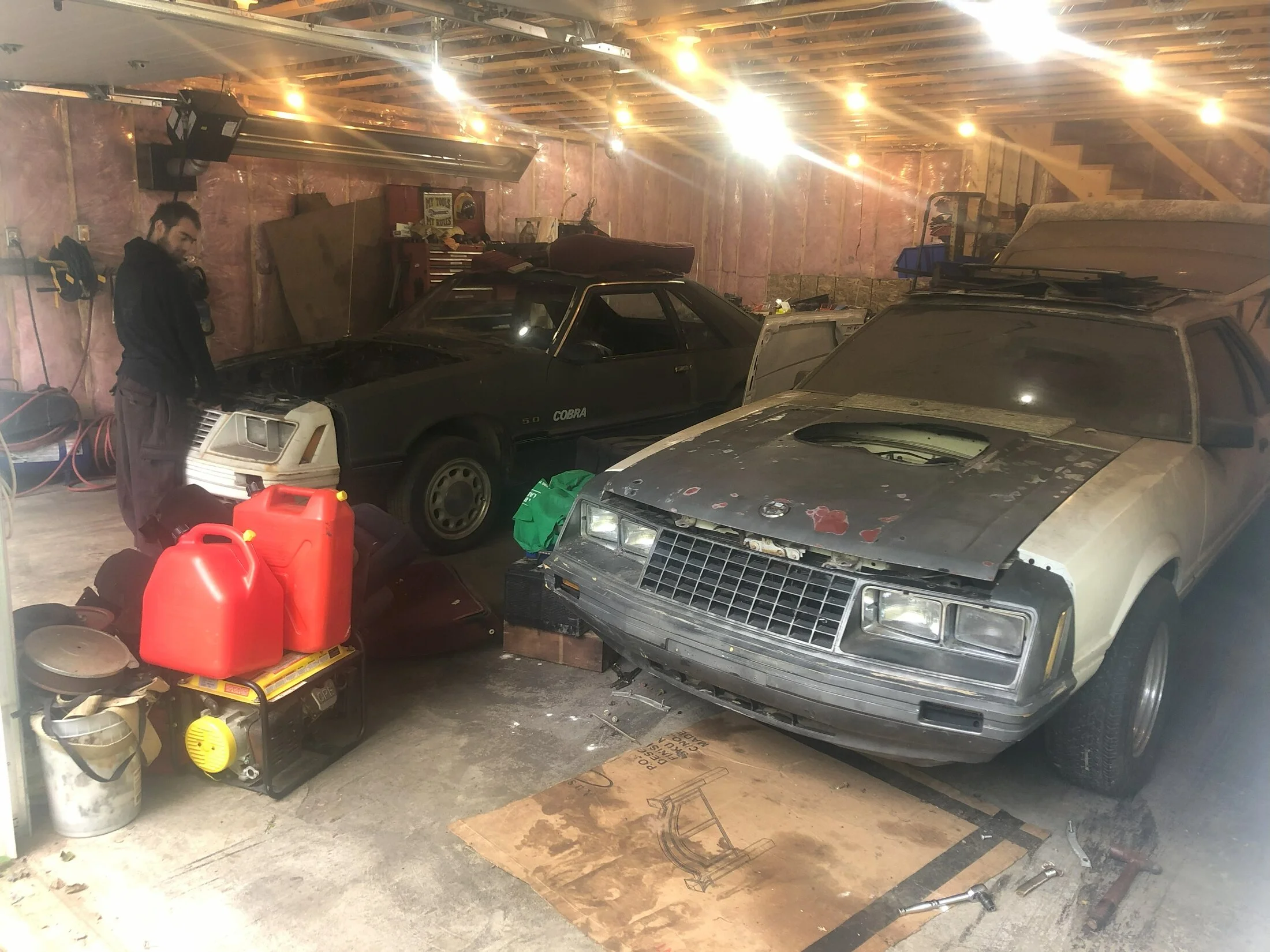

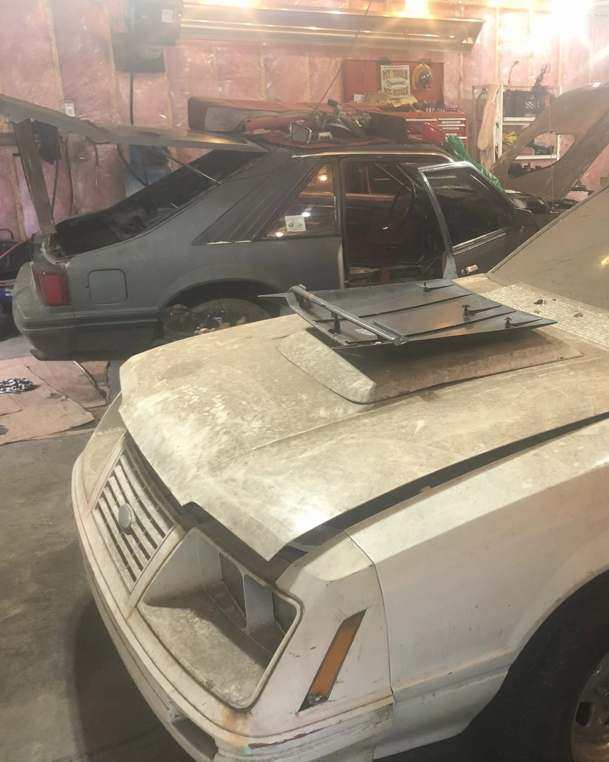

Pulled the 79 in to swap the nose, to make my 83 a 79. More to follow......

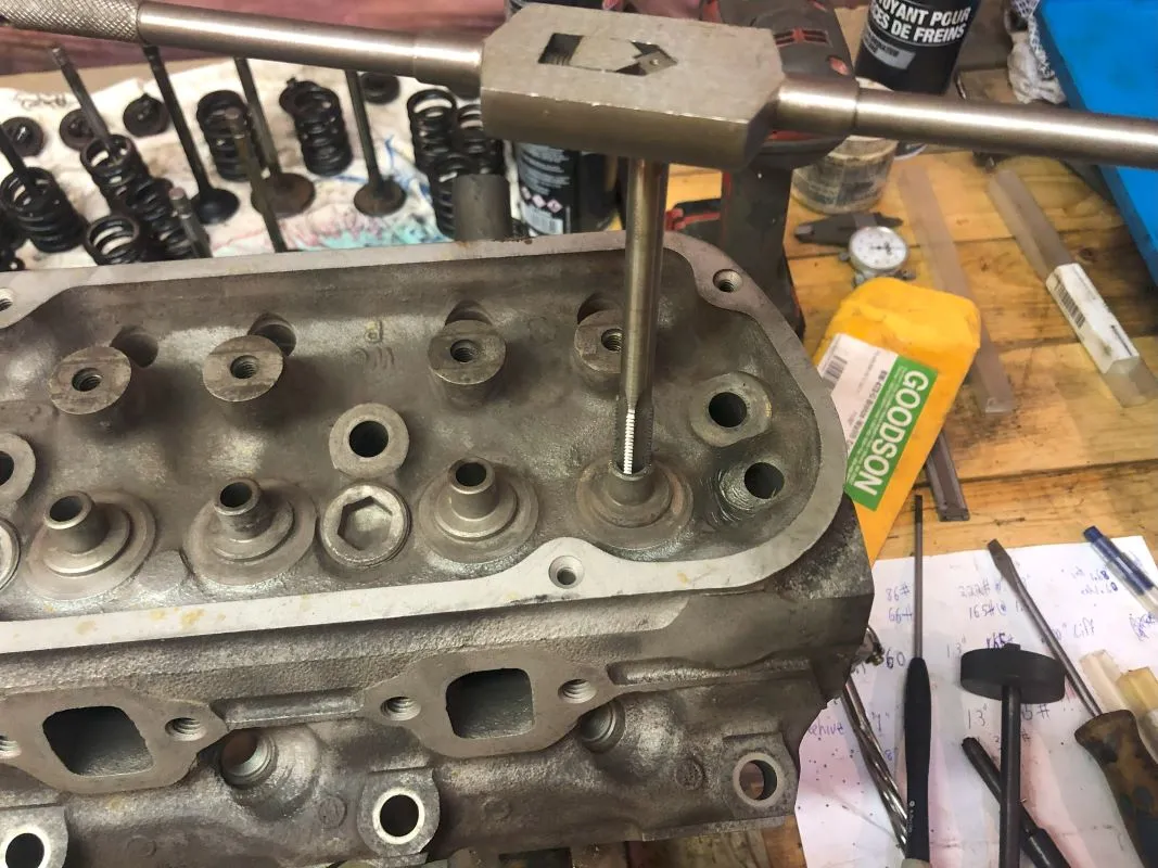

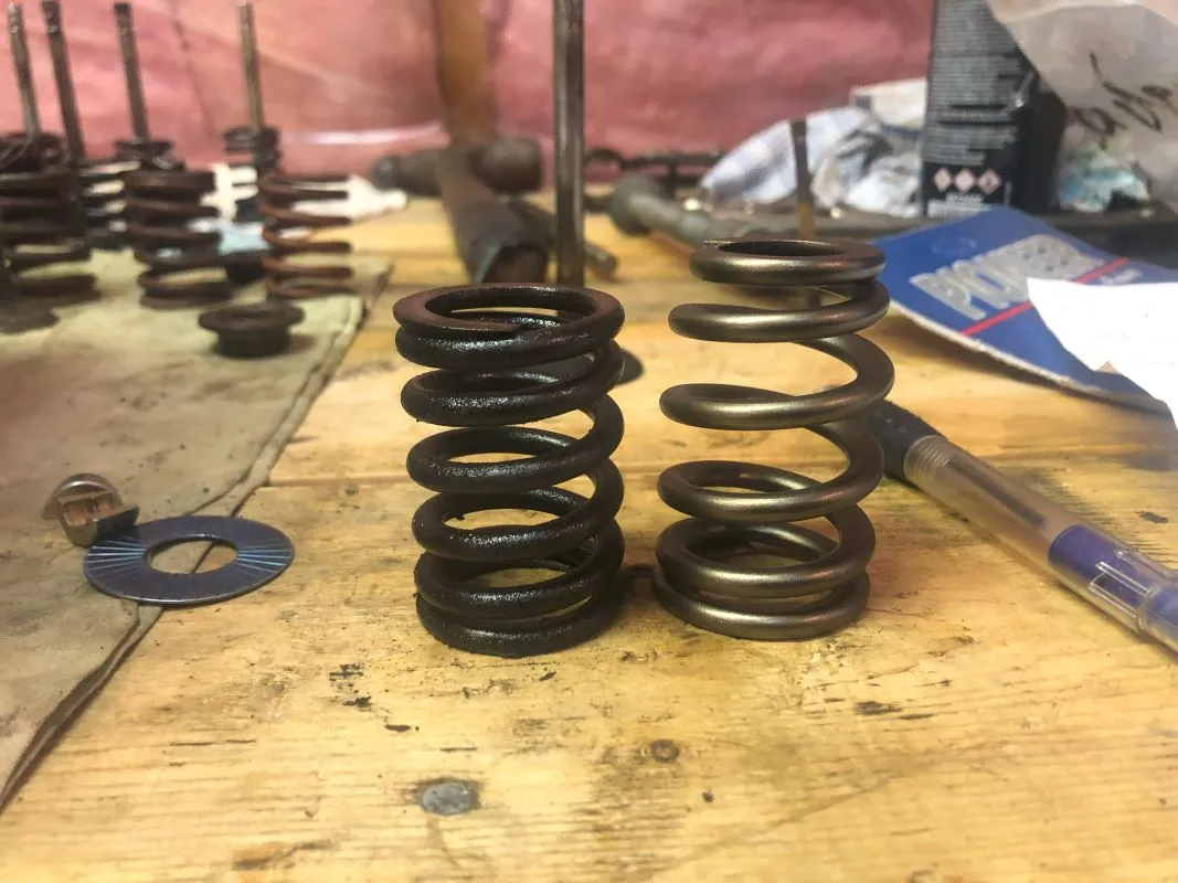

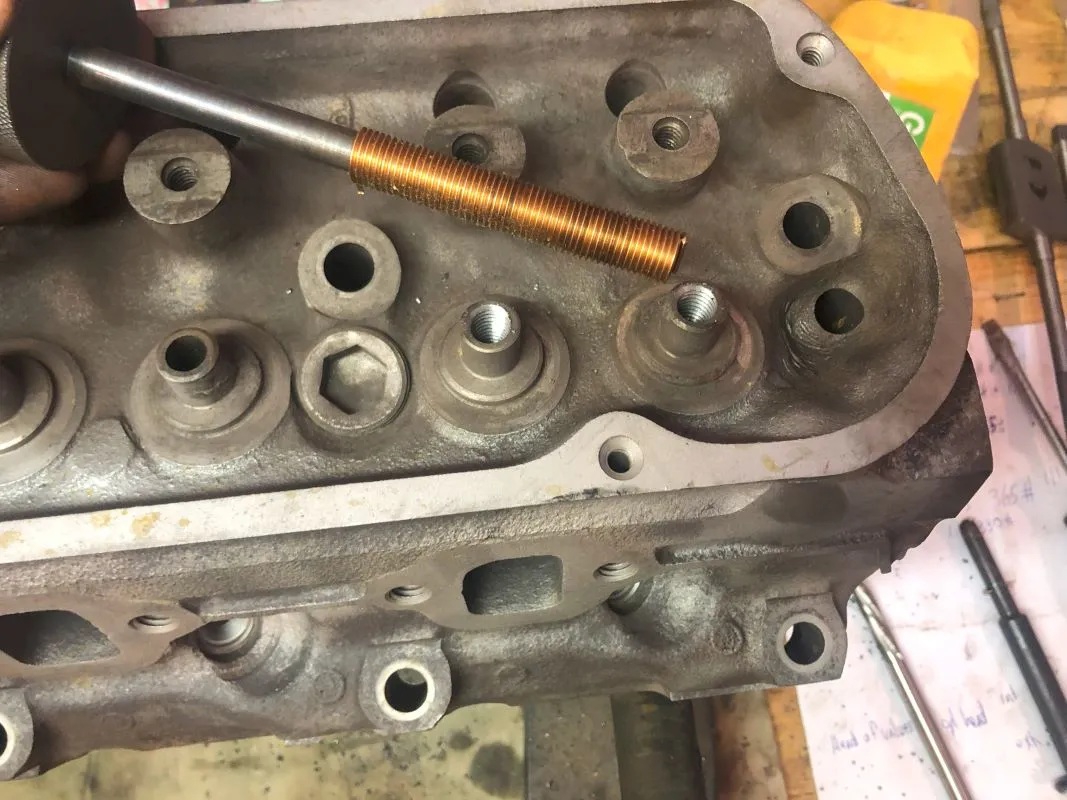

Got some progress done...

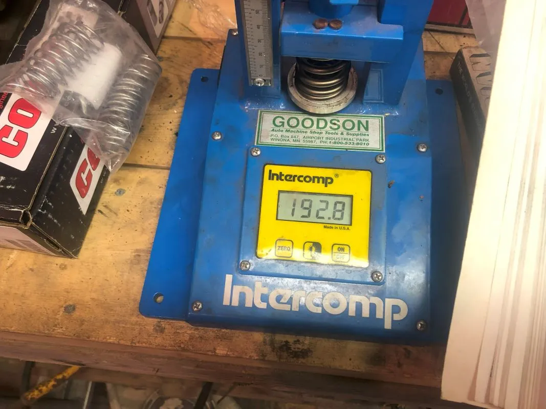

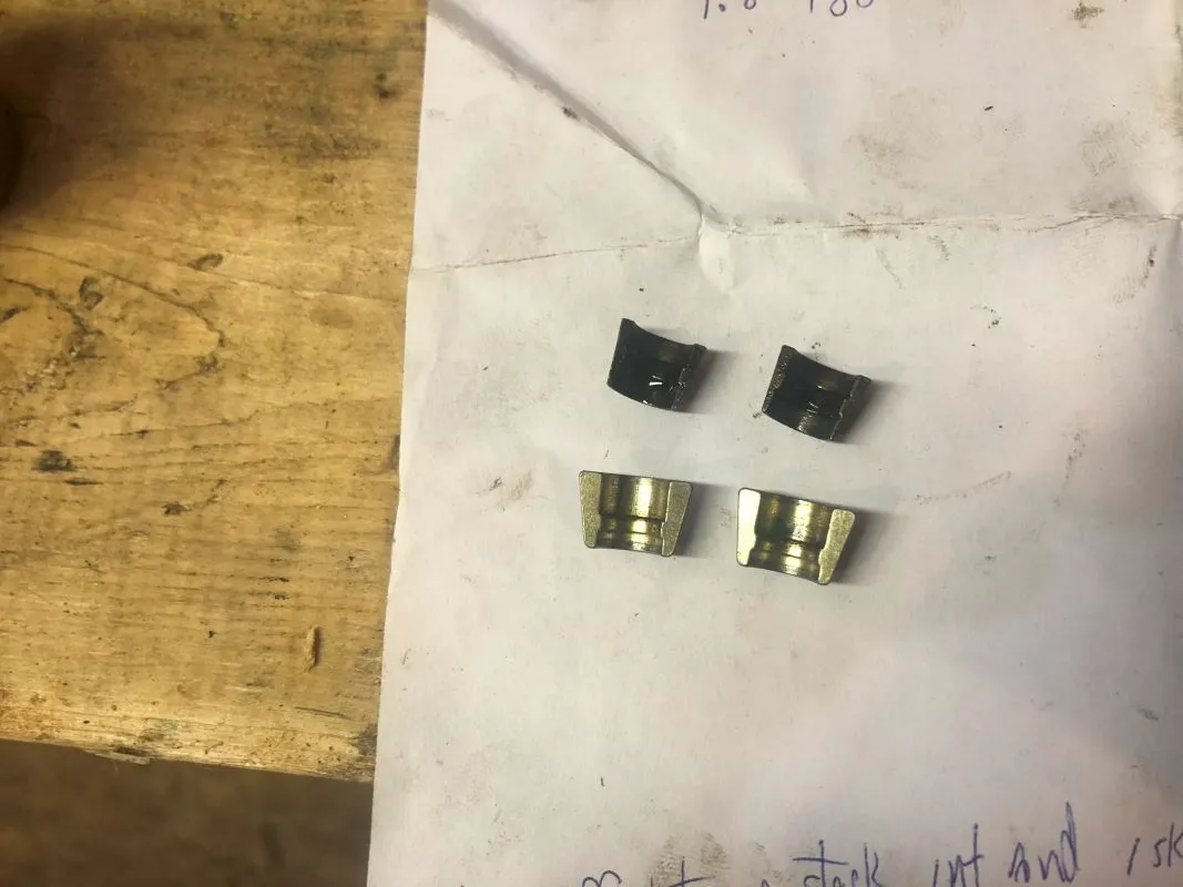

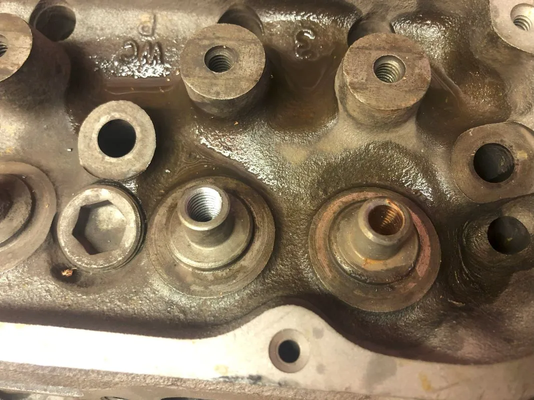

1) Stock "performance" spring compared to a pacalloy beehive spring.
2) Stock locks compared to 7* comp cams locks.
3) 192# on the seat and 350# over the nose.

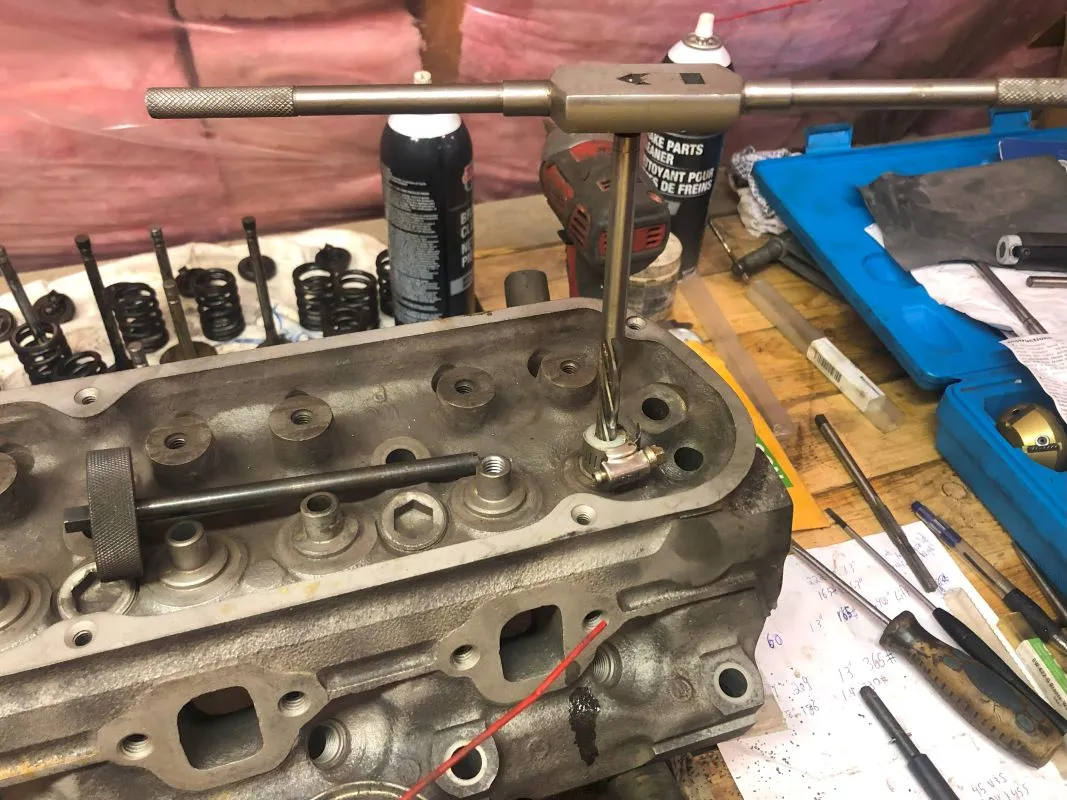

4) Tapping guide to installs new bronze guides
5) Ready to install bronze guide
6) Reaming the guide to correct size
7) One done and next hole tapped

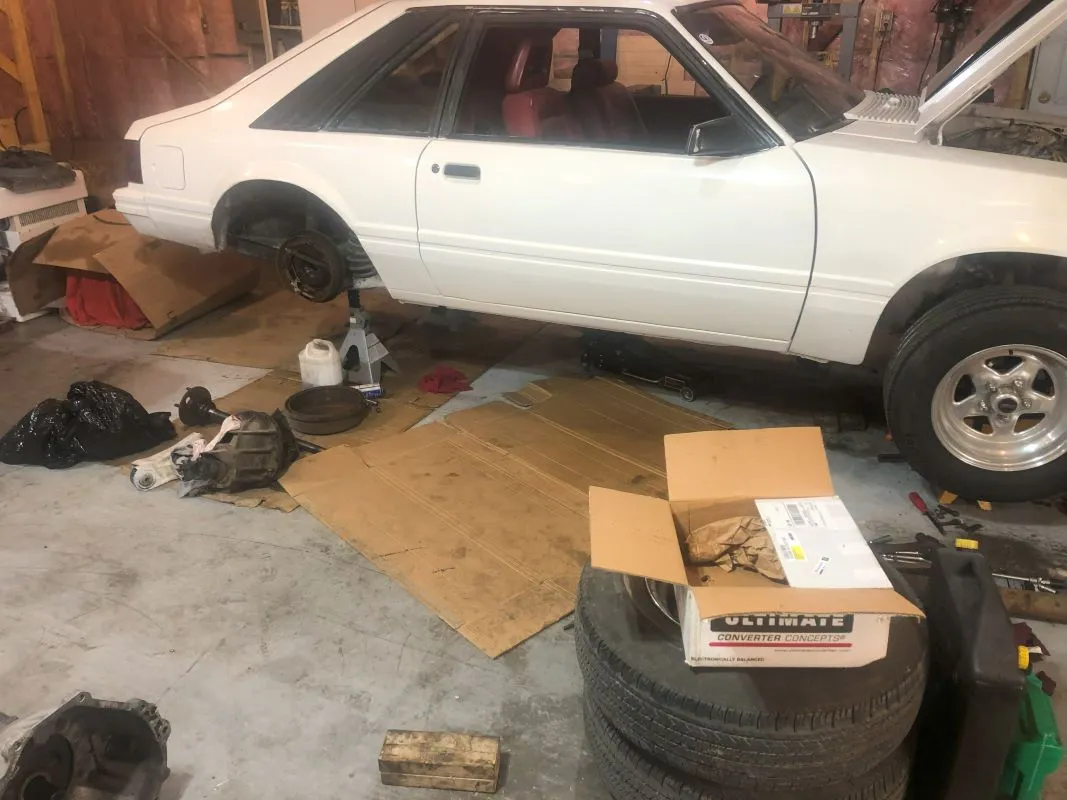

Ok, update, got it together and went to the track for the first time since 1997 (the car, not me) Had a .021 light first hit! Went downhill after that, LOL!
Stupid little bugs;
Shifter messed up, not shifting right
Water pump motor burned out
Fan blowing fuses
Motor won't rev over 5000 because timing light was messed up and I had 50+ degrees starting out, then 38, then about 35 or so by ear since the light seemed off.
Found out the timing pointer on the engine is wrong or the gun is messed up, but tdc is in the middle of the round timing light hole instead of 0 on the dampner.

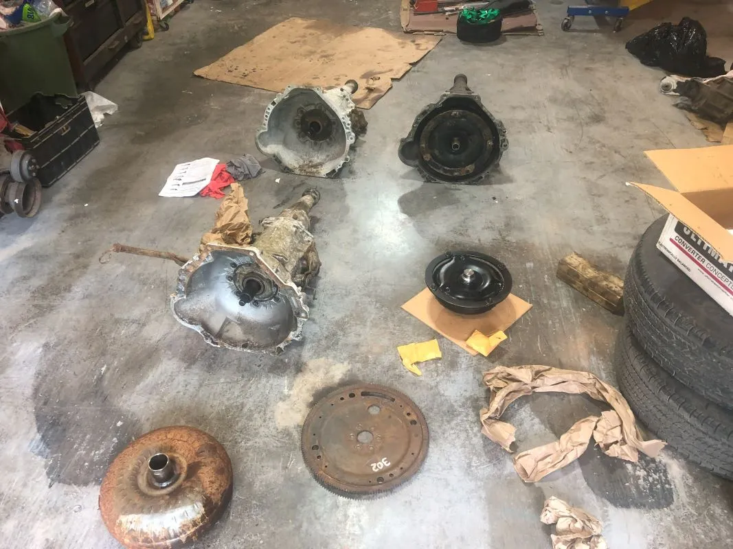

So, pulled the b&m shifter, got a stock shifter and modified it for reverse valve body pattern. Got a reverse valve body from Broader performance in Texas (awesome company to deal with!!!) got that installed then pulled the tranny as I got a 4000rpm stocker converter, so I installed that.
When I had the rear end apart (9") found the 4.86 gears are worn out...bad... so I picked up a 5:14 centre section with a 35 spline full spool. Still waiting for my 28 spline spool to arrive so I can install that too.
Funny/not funny...I have a pan fill, 26 spline c4, 164 tooth flexplate...the 8" converter fits a case fill 26 spline 157 tooth flexplate! I grabbed my spare case fill c4 from out back and...it's a 164 tooth bellhousing too! Bought a pan fill/26 spline/157 tooth transmission only to find it's a case fill with a plug and has a pan fill oil pan on it.
All that to say, holy crap ford, what were you thinking????
24 or 26 spline
case fill or pan fill
140/157/164 tooth flywheels and matching bell housing
2x2x3=12 different possibilities with a c4!!
Oh yeah, installed the adjustable uppers too.
More to follow...
