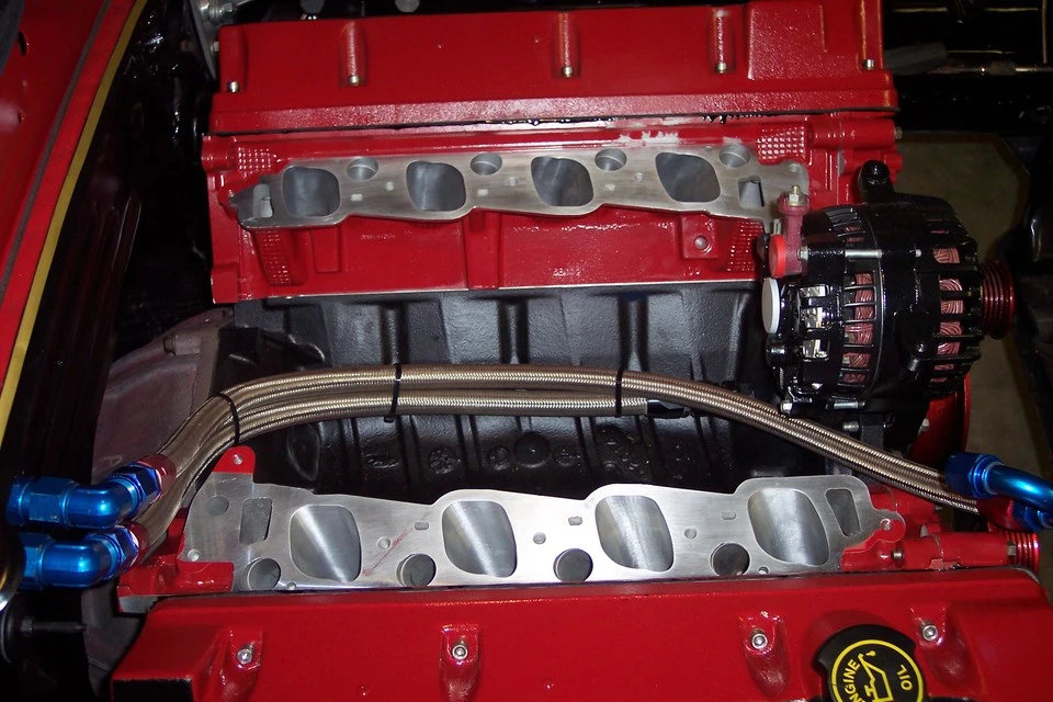

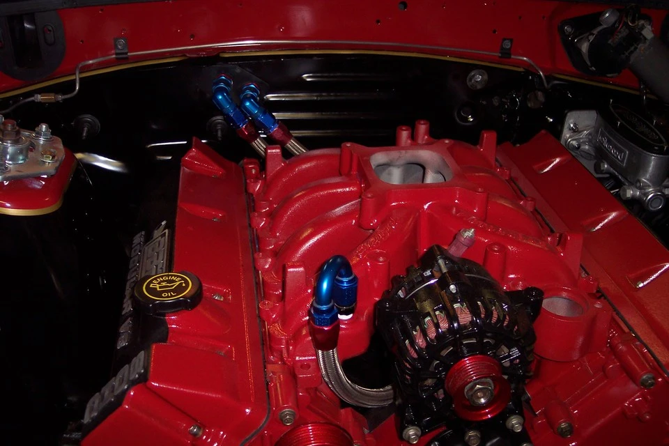

But, speaking of upgrading,... get rid of the stock EFI intake, and replace it w/ a open plenum "carb style"intake, ( even if you intend to keep it injected) and you get this massive dry valley that lets you hide all kinds of jumk under the intake:
Wires; lines; hoses; nitrous; dead bodies, blah-blah-blah.
As for me, I chose to run the heater hoses under it:

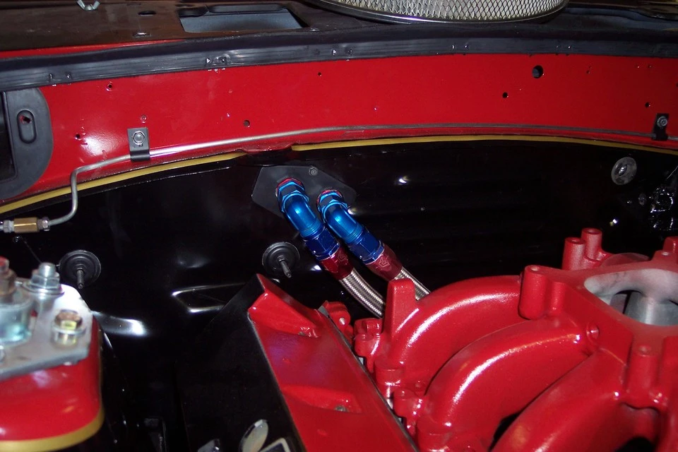

I love the look of the AN fittings coming out of the firewall. Looks super clean.

are you still running a standard heater core?
Yes, There are compression adapters that let you cut the heater core outlets to the length you want them, then slide the compression nut, ferrel, and AN -10 male fitting together as a unit and crank the thing together for a finished look like you see. About 20.00 ea. I tested the thing out of the car w/ a garden hose and whatever pressure my water system has here. No leaks, so far so good.
